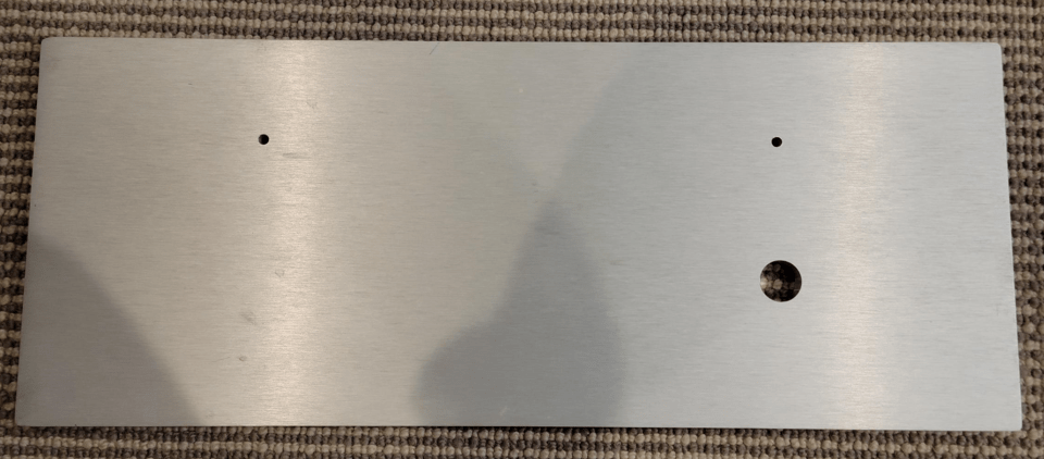

I have a lightly used 4U aluminum faceplate with two holes for LEDs and 1 19MM hole for an MFR# MC010920 push button on/off. Ideal when used with Mark's soft start CB.
I offer this for shipping costs, which have been $22.00 for the other ones I have shipped.

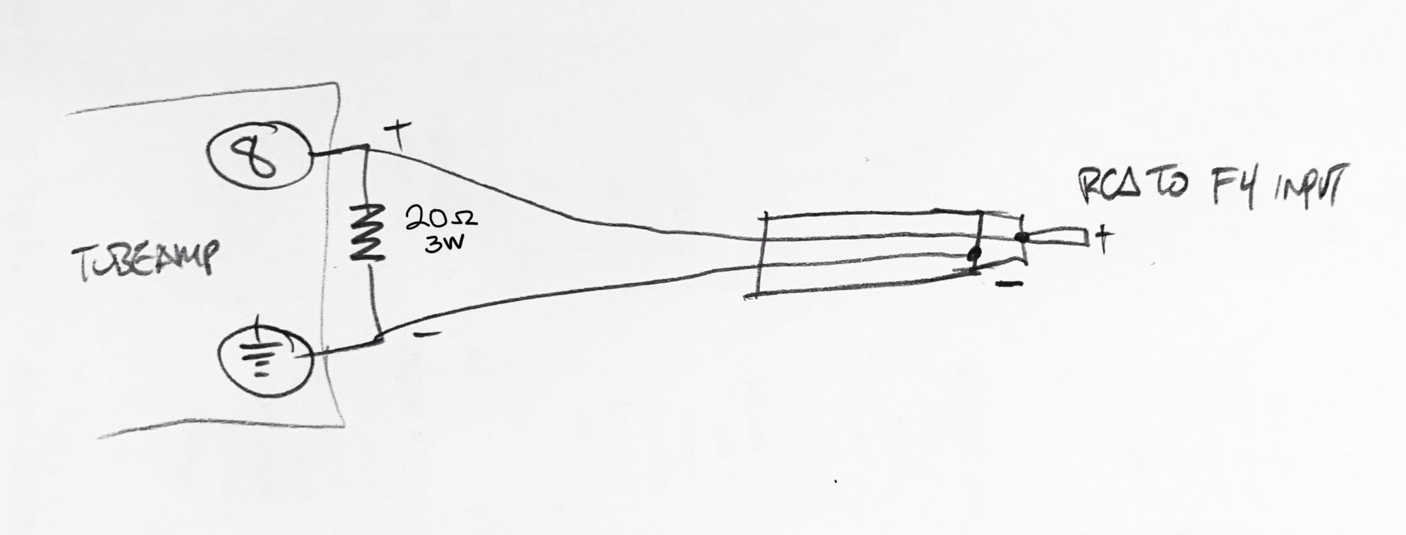

Even after building a Sony V-Fet amp, I still love my F4. Unfortunately, we're down to one set of speakers at the moment so I can only use one or the other - but I plan to fix that soon by building a new pair. This made me wonder about the ways an F4 can be used with a flea watt integrated, as outlined in the manual, but I don't fully understand the limitations of those options. They are unusual ways of connecting amplifiers that I don't think many people do, and I don't want to break an amp I greatly enjoy.
Could an Elekit TU-8200R be used to drive the F4? Directly? Meaning, basically as a preamp? At what point would the flea watt amp be too big?
Or, could a TU-8200R be used to drive the mid/high part of a speaker - with the F4 after driving the woofer, but still running off the output from the TU unit? Would that change the point at which a flea watt amp is considere too big?
I don't understand these things but love tubes, and my F4 - and want to use them together. I'm very sure the results will be awesome but I want to make sure I do it right.

practically, yes to both questions
of course - source amp (especially if tube one) always need to have load, be it dummy (nominal or twice that, if you need some more swing) or mid/high section of speaker
You won’t break anything.
The people who I’ve talked to that have used a flea watt amp to drive F4 have found that a 20ohm 3W resistor loading the tube amp output works the best. Then you attach to the F4 input with RCA.
I used a wavelength 45 to drive lowthers and also drive a f4 driving 15 inch woofers. No problems

20ohm will change the load on primary side see by output tube,normaly lowering distortion ,more damping factor and lowering power ,I will look at bias too no need burn life of tubeYou won’t break anything.
