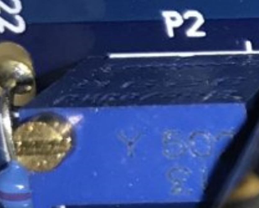

F4 power amplifier
Btw, DC supply is all correctly wired. V+ from PSU to V+ at the channel PCB and V- from PSU to V- at the channel PCB.
I’d start by verifying PSU voltages. If both rails are @ specified volts referenced to gnd, do the following:
1: Confirm P1 and P2 have not been swapped, ie put in the wrong positions. See attached pic. :)
2: Measure voltage on both outer legs of the TL431, referenced to ground.
you can probably leave the parallel 10k for now, and depending on what you get consider snipping it. But where it me, I’d snip on one chan. Quick to replace, plus you should use shorter legs anyhow.
Not telling you this is the final answer, I may be completely off. But it is a start :)
but that is where I would start. Seing as you have lovely sound, my guess is the JFETs are OK.
you seem to have the same issue on both chans. So start with one and see what you get.

Please confirm the value for P2.

Perhaps this is due to the dual 10K in parallel at R9?
I will cut the additional 10K resistor when I arrive at home, this way I was able to change the offset to zero before. This way I can use the amp to play music, only at a bias of 0,06 when cold.
When the correct resistors arrive in a couple of days for P2 I will change them.
If 5K is the issue you should still be able to get the offset down by adjusting the trimmer back to 500R and below. Did you try adjusting P2 through its entire range, both up and down?

Some questions raised during the bias process. I was only able to bias to 0.06V max, so the F4 build guide advised to change R9 to 5K. However, I already reached my personal volume limit when the the preamp was at 0-dB. There is even a possibility to increase the gain of the preamp by +3db, +6db and +12db, but this will let my ears bleed probably.
1. Is it really needed (sound quality wise) to get up to 0.13V when cold or 0.2V when hot?
2. I have seen that distortion figures are better at 0.13V / 0.2V, but is there a downside as well compared to my 0.06V?
Please let me know your thoughts about increasing the biasing to 0.13V/0.2V or just leave it as it is at 0.06V

Was offset good (possible to zero) when you did this (meaning before paralleling an extra 10k across R9).
if so, main issue is still: why are you unable to increase Iq?
If the offset issue first appeared after adding the 10k, snipping is the cure to get back to square one and work from there.

Yes, offset was good before the addition of the second 10K resistor.
I found the cause. The earth wires were not in contact with the terminal on the PSU, now it is working and I can bias more than needed.
Thank you all for your quick replies and support! Much appreciated 😃
