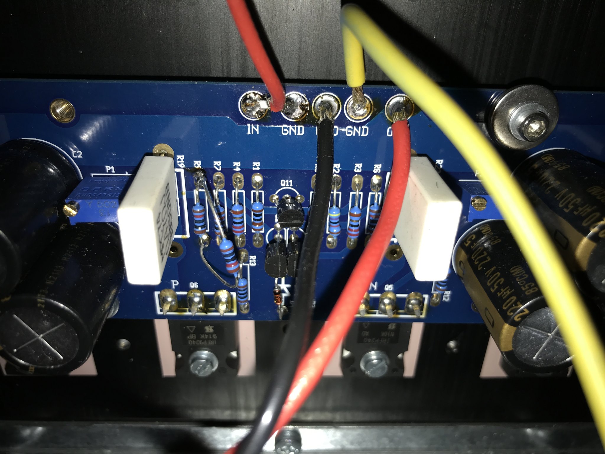

I will post photos of several locations. I will start with the R9. Please find attached.
Is this done correctly, the additional 10K resistor in parallel with the original?

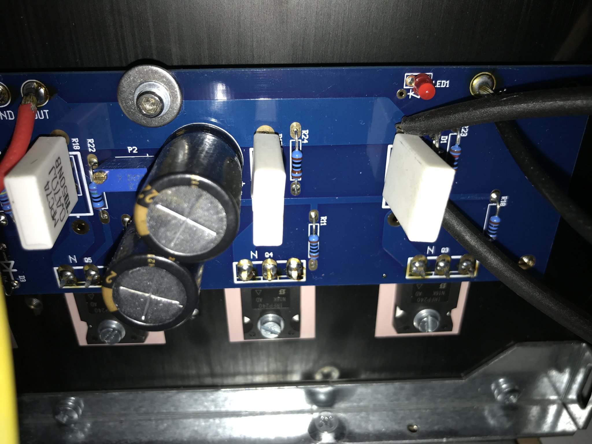

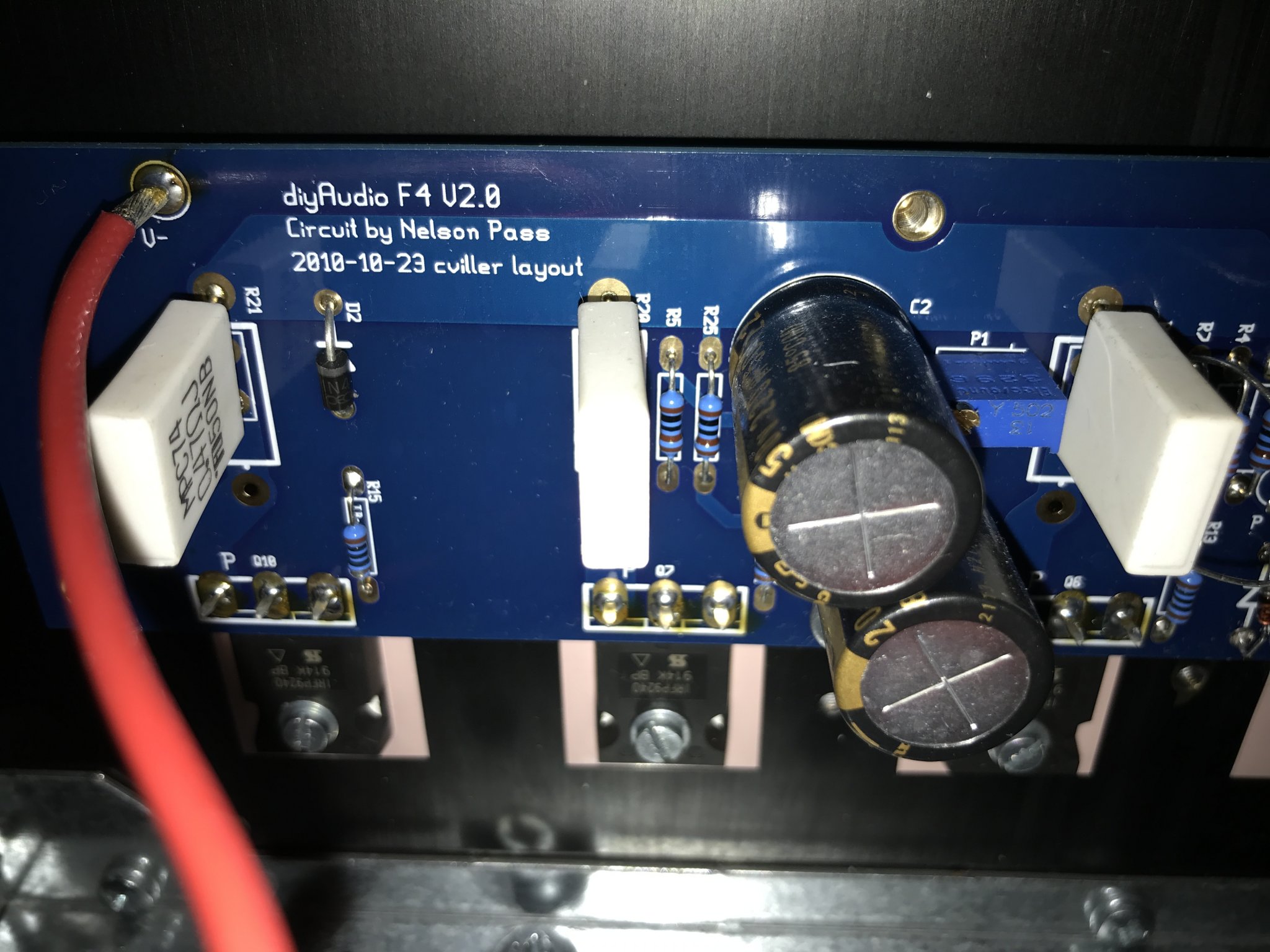

And another three photos attached.
These three photos cover one complete channel. Please let me know if any detailed photo from a specific component is needed.

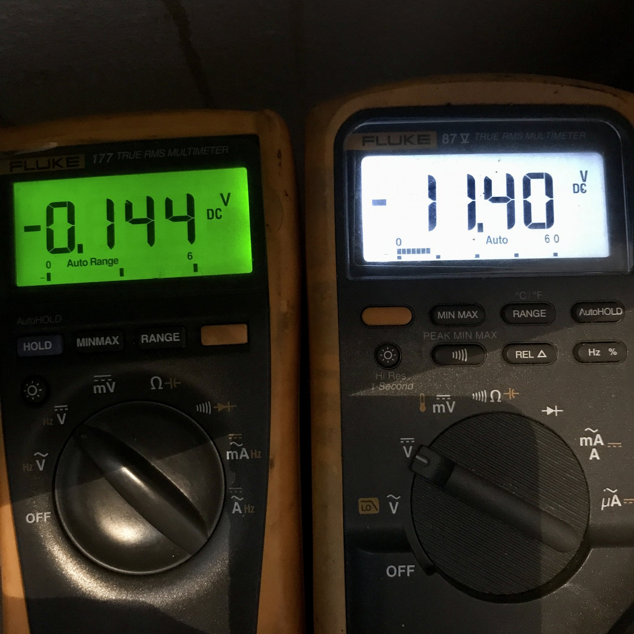

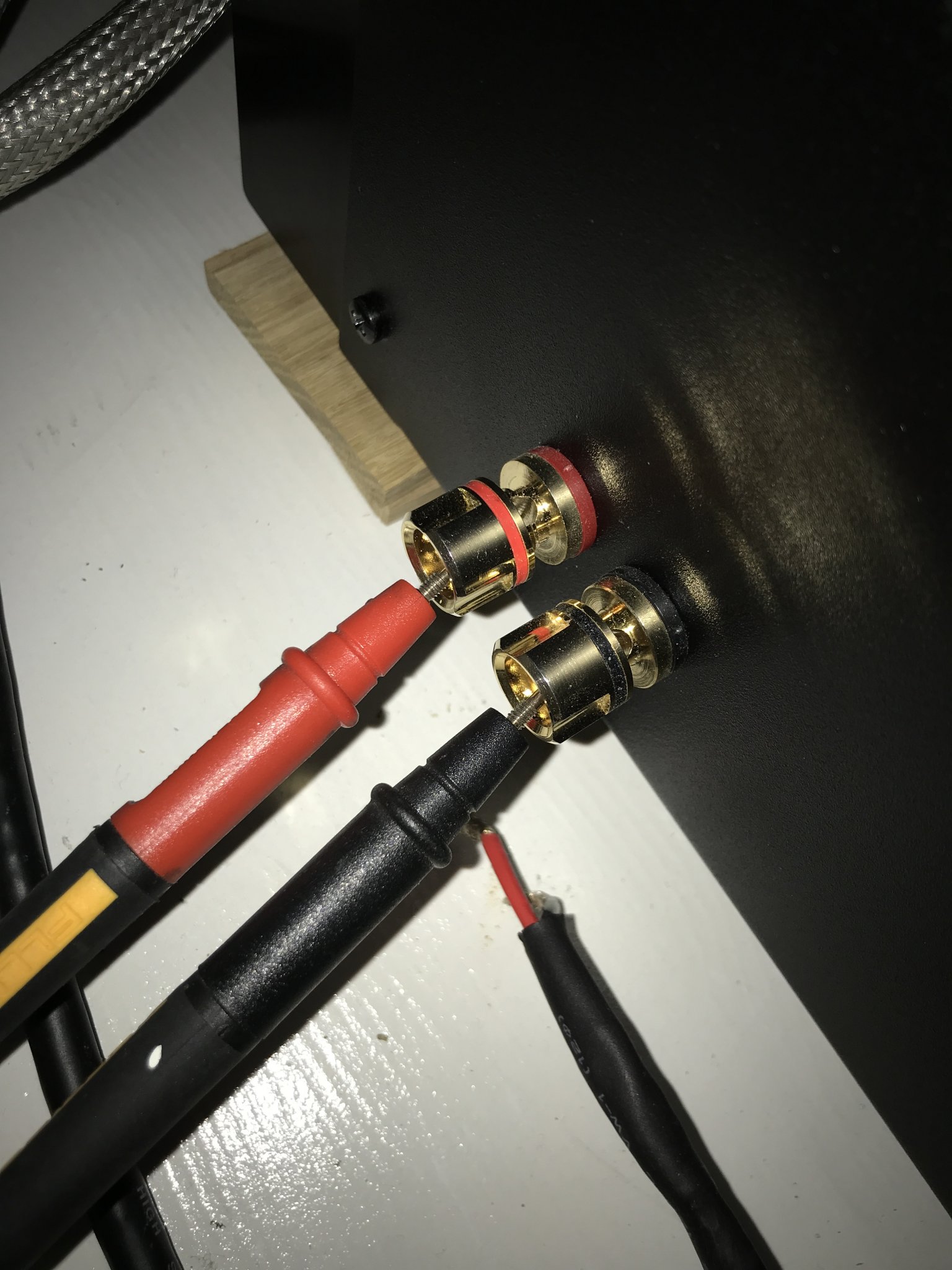

For your information, on one photo attached the the above post you can see the leads of my multimeter across a source resistor.
The strange thing is, I only added one 10K resistor to R9. Before this change I could easily set zero offset. However, I could not get the bias higher than 0.06.
I am measuring the offset between the plus and minus of the output terminals. Please find a photo attached.
This offset is as good as it gets, I am “out of turns” with the Bourns resistor, I hear a clicking noise and the value doesn’t change anymore. Before I heard the clicking noise of the Bourns resistor I was able to change the offset. However, only until 11.40 Volt DC, then the clicking noise came. Probably out of turns / end of stroke.
Yea, out of turns.

It is not the same for both channels. One channels is at around 8 Volt DC offset, while the other channel is 11.4 Volt DC offset.

You have the red dc wire @ V-, and black @ V+. Why? How are they connected to the PSU?
please include overview pics, including wiring to and from PSU and boards and speaker outs, plus inputs.
You are sharp 😃 and correct. Due to insufficient length of wires I had to swap red and black for V+ and V-.
I will post the photos that you are requesting tomorrow.
