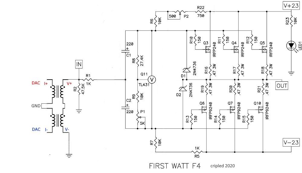

What about these then?

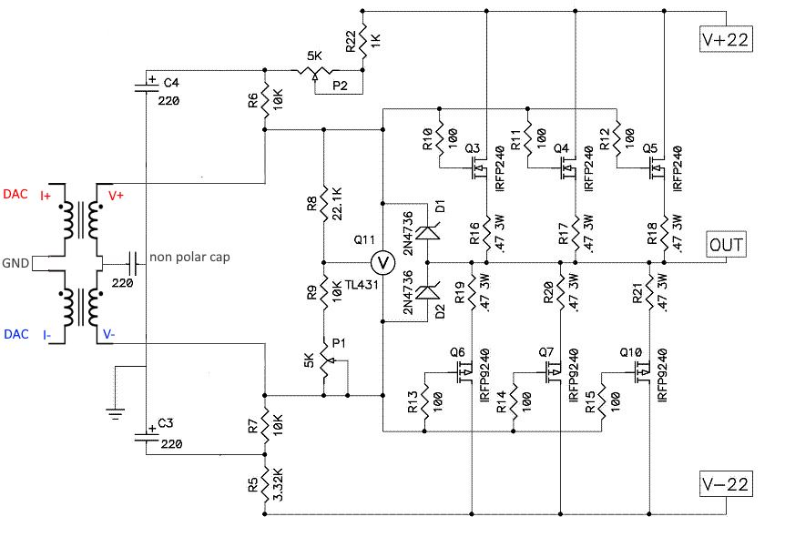

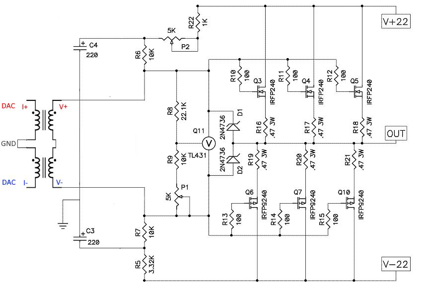

so no way to eliminate AC coupling caps ... ?
What about C3 and C4 value ... Would 10uF polypropylene cap work here instead of 220uf electrolytic?
just build F4 as is
Maybe you are right adason.
Do you know if attached schematic is the last version?
Joined 2009
C1 C2 are coupling capacitors, keep them - the F4 can not be made DC coupled.
C3 C4 are “rail boosters” to make sure that the Jfets have sufficient voltage on peaks.
There’s no real reason to make the values different than as designed.
Got it thank you.
So C1 and C2 220uF rated for 25V are ok? ... I got such of high quality thinking of using them ...
