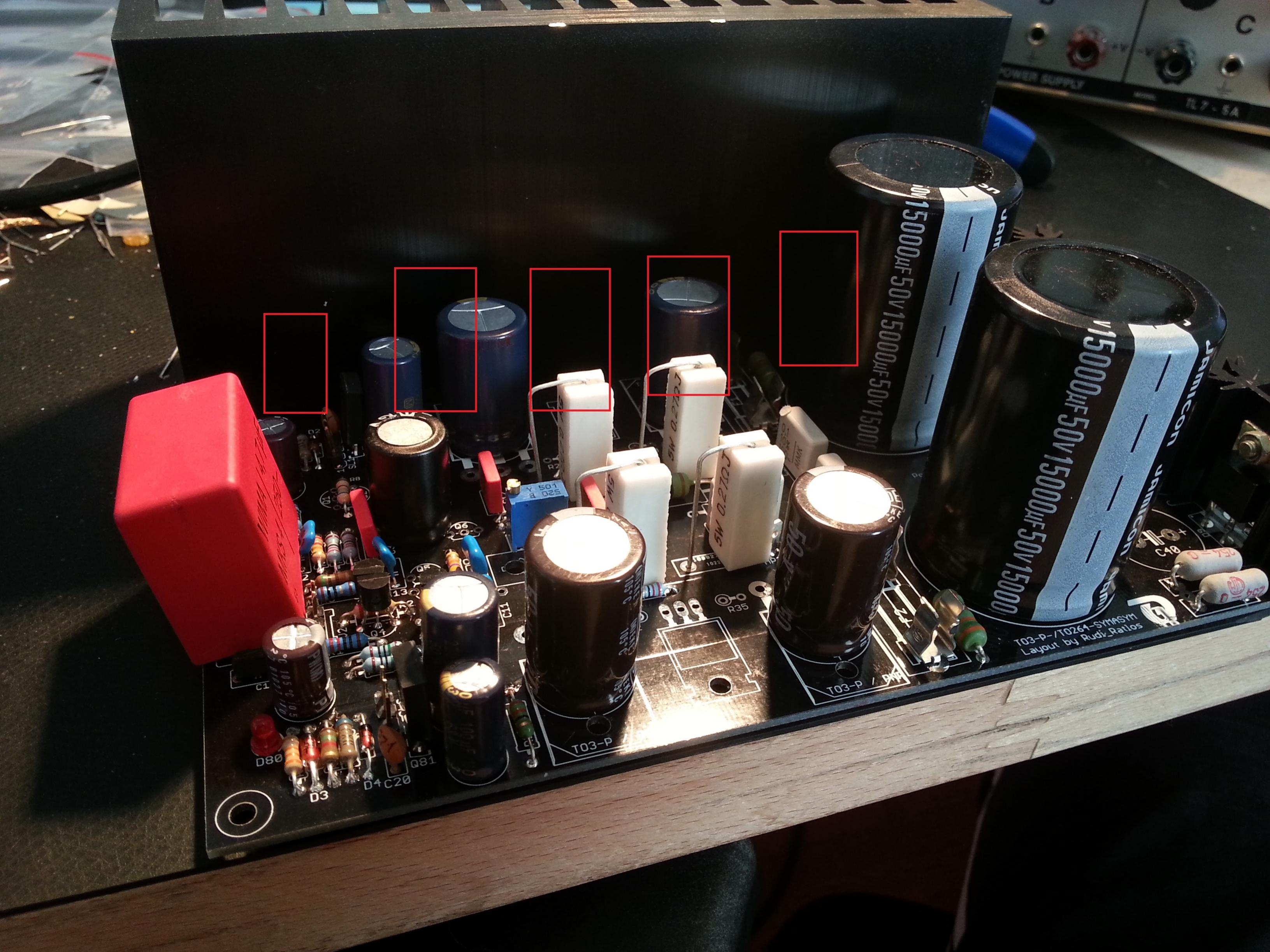

Well then I have a question about the heatsinks, I have a Alumunimum Heatsink with 0,9K/W here, is this sufficient for cooling my Powertransistors ? And can I mount the Transistors with short cables ? Because the Heatsink is not wide enough to support the whole PCB to mount it directly on the heatsink.
I would mount them like in the picture.

The size of the PCB is 210 x 94mm. A heatsink with a height of 100mm is sufficient therefore.
Make sure that your heatsink is long enough to screw the output transistors, drivers and BD139 (used in the temperature compensation circuit) directy to the heatsink.
Do not connect the output transistors via cables to the PCB. Screw them to the heatsink (tap the heatsink) beneath the PCB at the specified posistions.
Concerning the heatsink's temperature properties: if you play the SYMASYM at 30VA (which is very loud in my ears) and you have an ambient temperature of about 25°C,
the SYMASYM will add about 30 x 0.9°C to the heatsink resulting in a total of about 52°C - which is tolerable in my eyes. (This is a very rough formula though!).
If you leave the jumper of the onboard-multiplier open (as shown on your image), the SYMASYM's frontend-voltage is clamped to about 36VDC by the used Zener diode D3.
Best regards - Rudi_Ratlos

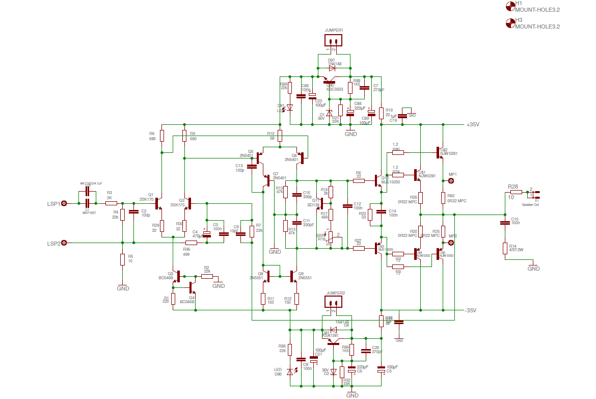

Hello guys,
I hope you can help me. I cant bias one of my two Black-Beauties. I already changed all of the small transistors, because one of them (Q5/6/7) was defect and "opened" the output stage.
Now I cant bias the amp. Between MP1 and MP2 are 0,000VDC and this value doesnt change when i turn R18. I also meassured around 0,1VDC between Speaker-Out and ground.
Sven
P.S.: I also changed the BD139. This reduced the voltage between Speaker-Out and ground (0,5V-->0,1V)

It's cool if you have a working channel! You just have to compare the measurements to locate the error.
Start with the operating points: for example check the voltage on R8, R9, R10, R11, R12.
If the trimmer and Q11 are OK then the problem is probably somewhere "earlier".
Cool, thanks! As it seems there's already something wrong around the LTP.
Check every part around Q1, Q2, Q3, Q4! The tarnsistors with the diode
method (DMM "+" to the base, DMM "-" first to emitter and then to the collector:
correct values should be around 6-700...) And then measure all the resistors
as well, compare with the other channel as well. That's all for 1st step... 😉
