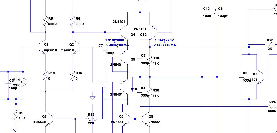

below is the picture after adding Q10

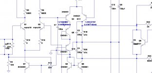

Hi, as Keantoken just mentioned, you have added a diode, made out of transistor, shifting the level 0.7V up on the left side of the diff cascade, making the voltages on the left and on the right more equal with no input signal. Now, see what happens, when there is an input signal - voltage on the right moves up and down, voltage on the left stands still. The fact, that it stands 0.7V higher, does not change anything.
In differential cascade, balance of the currents is much more important. With regards to the voltage difference - Early effect has to be considered, that's why a common-base transistor is already there on the left, serring the voltage of the left diff collector close to the ground level. Plus/minus 0.7V don't make any difference in this situation.
