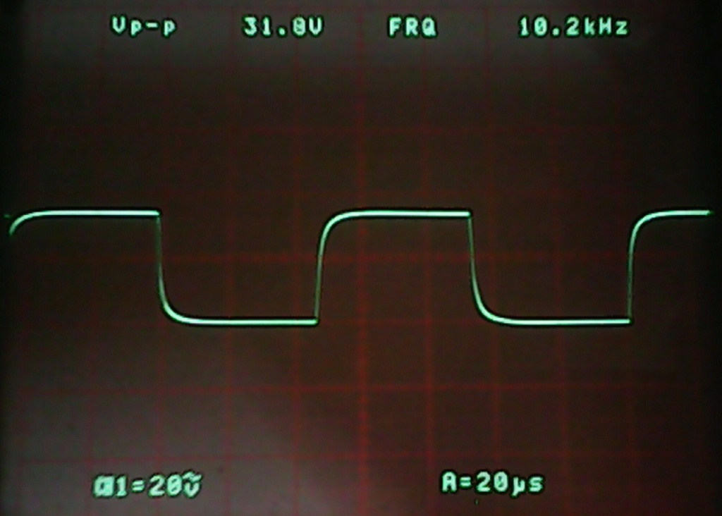

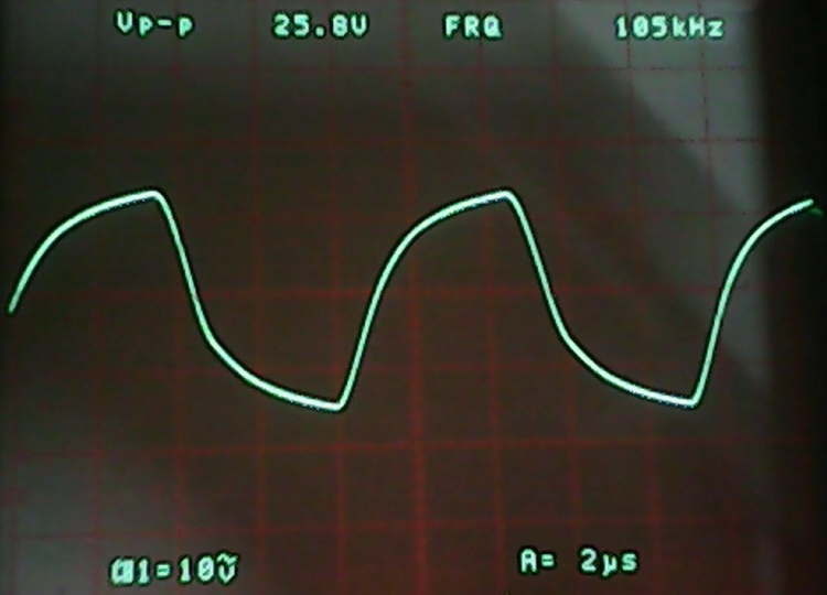

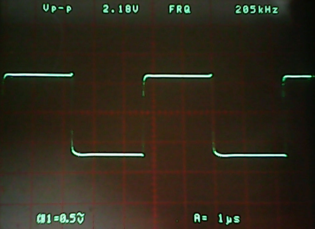

Hi, given thanks for reply, appreciate. i have a scope but don't know what to look for, tested with sine wave from 20 to 20kHz it seen nice and clean sine wave at the output and test with 1khz square wave is same clean no rigging or over shoot ( don't have signal gen the square wave source from the scope cal 1Vp-p, and test it with low volume... is late, middle of the nigh ) ... did i miss some thing? please take a look the picture i take.
BTW i have change the sysm transistor .... input Q1/2- 2n5551, T1- C3421, driver A1837/C4793, output C5198/A1941 and C14-10pf compare to the sysm befor, i more like it the old sysm, this new transistor sound more wide and the old more solid. maye be will change it back tomorrow ( don't know the news transistor is fake or ...). any suggestions should i change the C19-470uf (ELNA Cap)...

Omg .... after more then a month checking, is not the symasym problem. is the 50K volume over kill.....
after changing the volume control to 25k, symasym work good. bass and detail is deep and clear.
It is good you didn't gave up..! (That's why I use 10k pots wherever possible...)
And its a good example when just a little component can ruin a whole system.

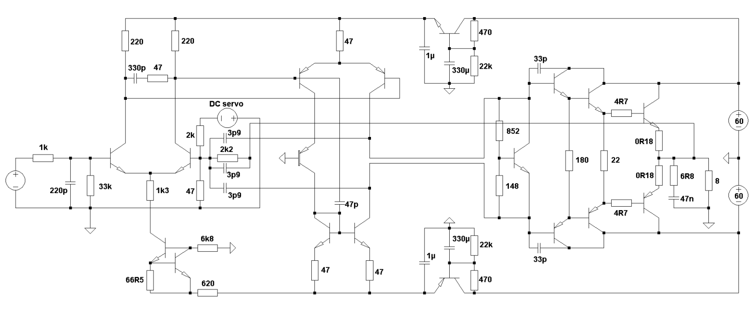

BTW: I just played around with an own symasym implementation: 60V, EF3, 2P OPS, different Iq, faster Qs, HF comp, DC servo, compact PCB, etc...

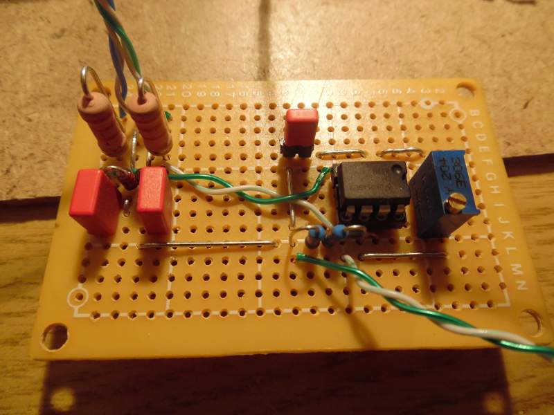

I have a 1MHz function generator, but before that I made a simple sq. generator with a very fast opamp used in "comparator mode".
As I remember it was very good as a source. I'll take it out from my drawer to check it for you.
I found it..! 🙂
It's something like this:
Square wave generator using uA741
I built it for 1kHz, I dont know wether its ideal for 100kHz range.

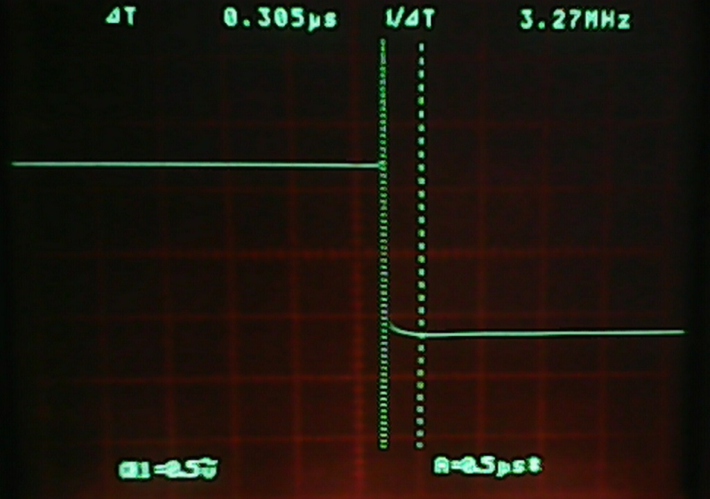

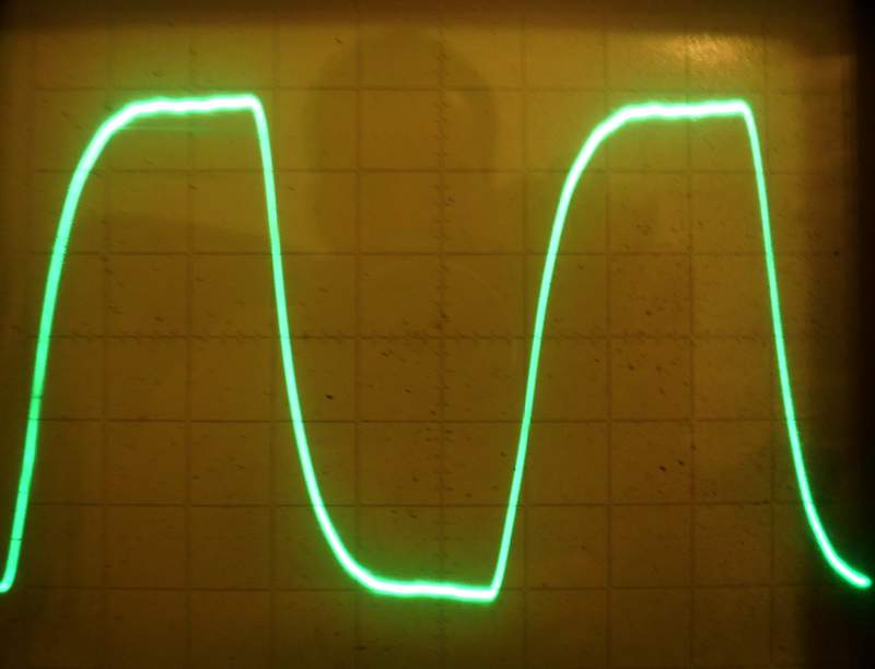

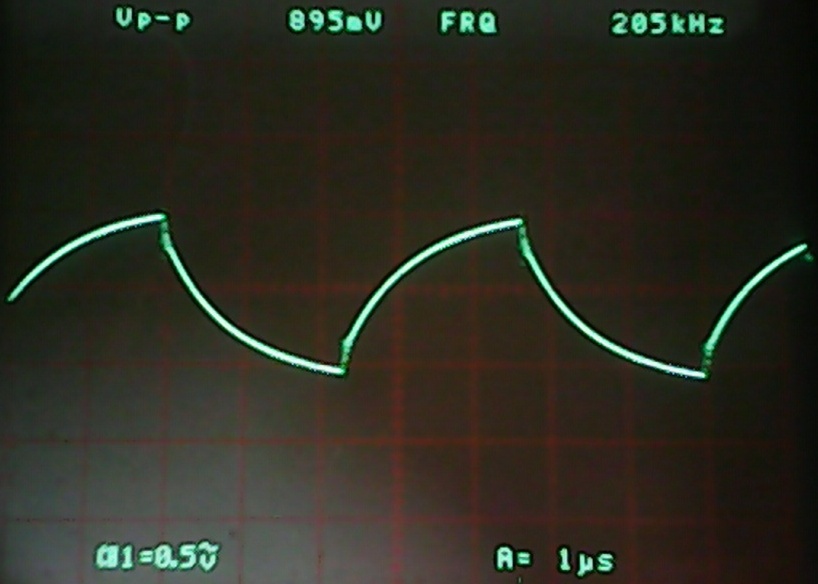

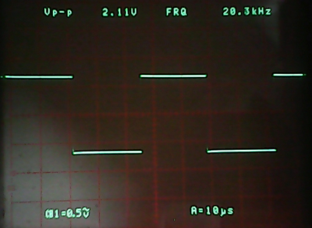

Advanced Symasym tuned a bit... 😉
IPS only! (With input filter: 1k + 68pF)
Just small signal tests... (0.2V/div)
Results: 200kHz, 400kHz, 800kHz.
I hope the OPS will be fast as well... 🙂

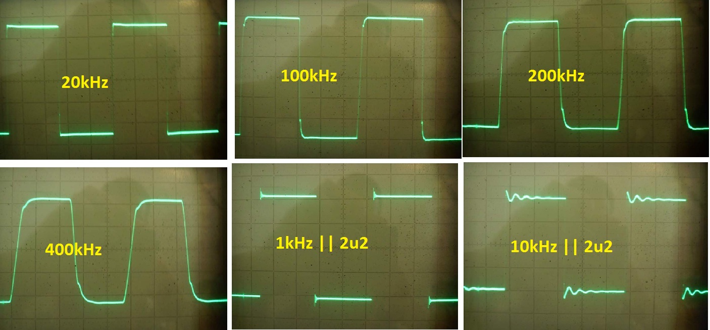

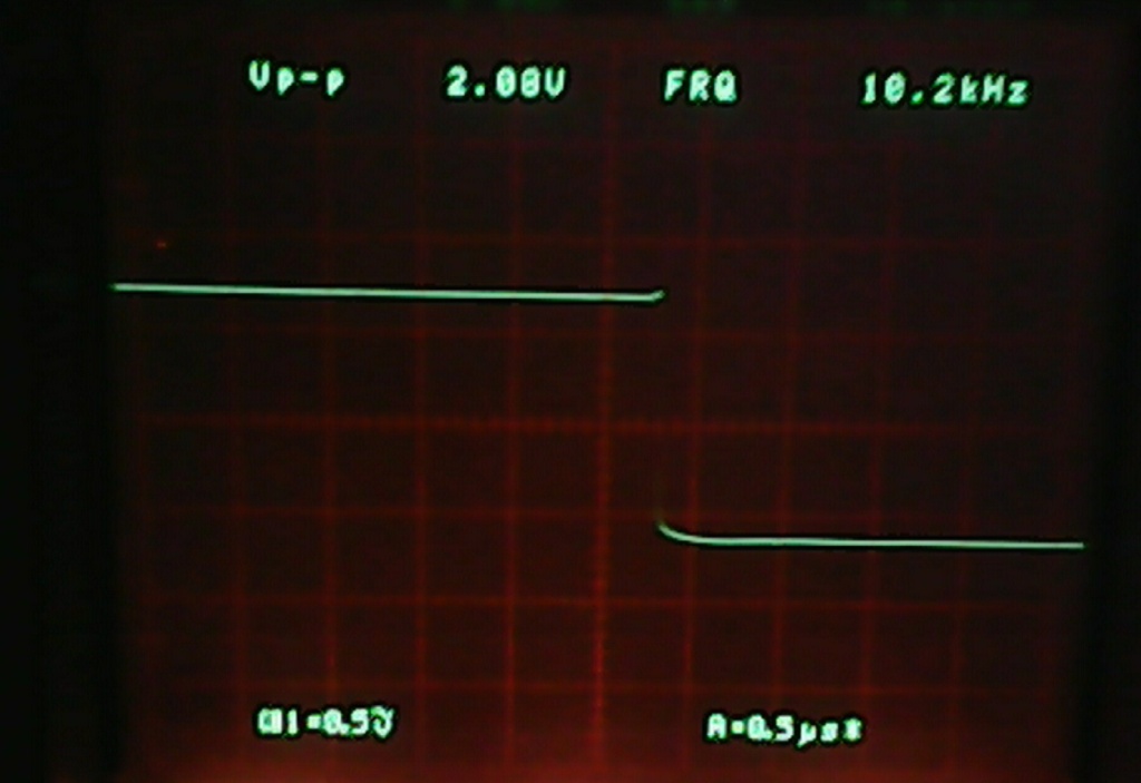

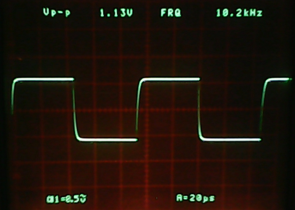

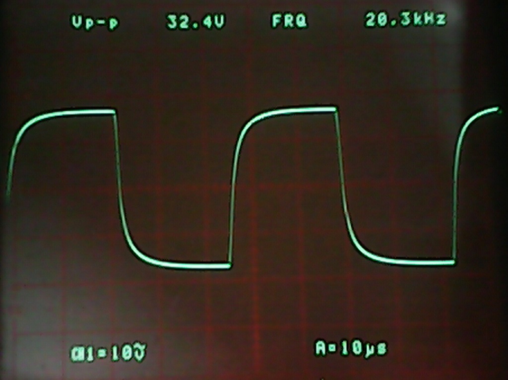

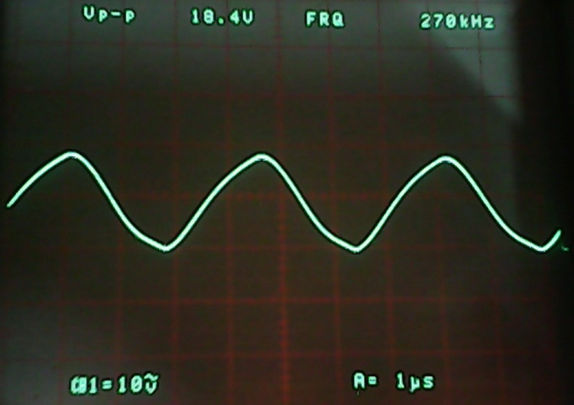

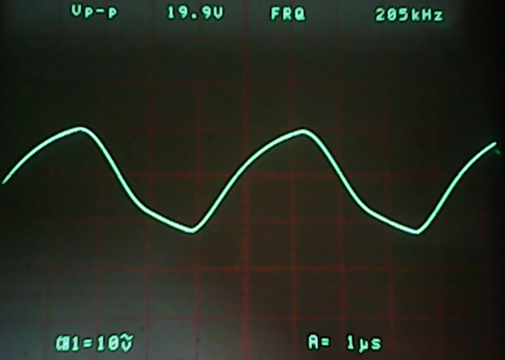

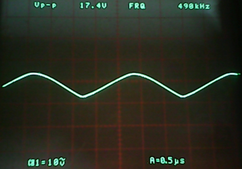

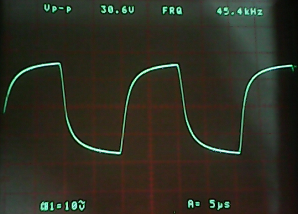

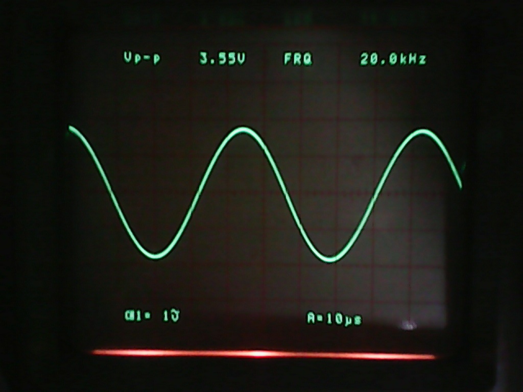

hi, my test result ....
do you matching all drivers and output transistor ?
best regard
best regard
Cool, thanks ychan!
No, I didn't match them.

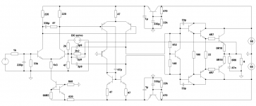

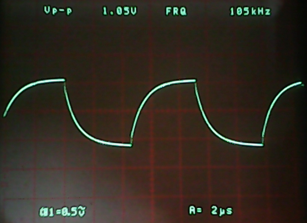

I attach my final results and the scematic to this thread as well.
They has been taken with input cap 1k-68pF. With 82pF even that small wave disappeared as well around the corners.
What kind of signal generator did you use finally?

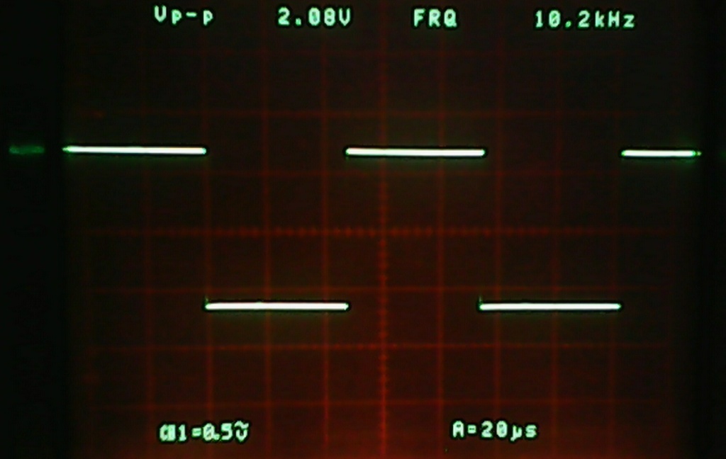

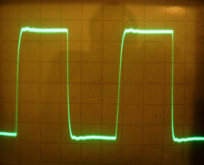

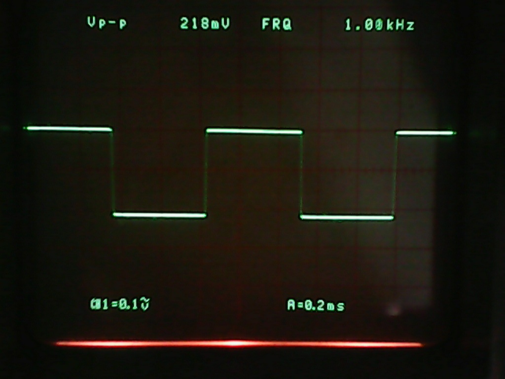

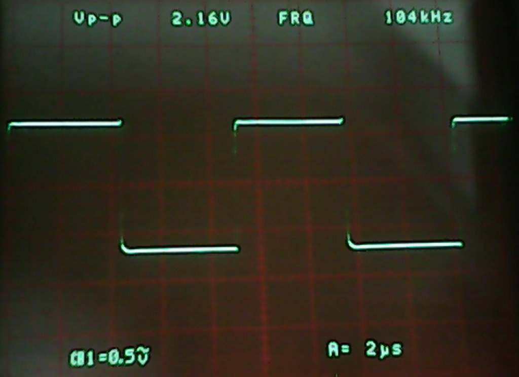

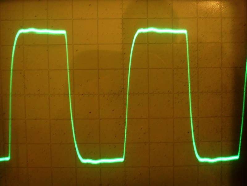

Hi, i'm using Elliott Squarewave Generator (tuned a bit) the link ... Squarewave Testing
the Generated wave
[image][/image] [image][/image]
and below is the image Generated wave before load / loaded with sym
[wiki=[wiki= ]%[/wiki]]%[/wiki]
the Generated wave
oop's
the Generated wave
and the image Generated wave unload / loaded with sym
anatech is right 741 is too slow, but IMHO i don't think going high SR and high fq will make the amp sound sweet...
[image][/image]
the Generated wave
[image][/image]
