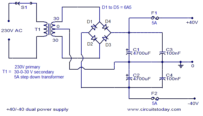

Another important thing missing in this thread is how to get a 36V symmetric power supply? Where would you buy one? How could you make one?
Dual secondary 25Vac transformer, bridge rectifier and two smoothing capacitors

square root (2) = 1.414
2 x 25Vac will give you 2 x 25 * 1.414 Vdc = 2 x 35Vdc (after rectifier and capacitors)

Does the power supply I added as an attachment look good? Only using 25 VAC input instead of 30 VAC.
Hi Andrew, I've seen in other posts that you don't agree with the use of c3 and c4.
Can you please explain why.
Also what you you think of the 10nF in parallel to each Bridge diode sometimes seen.
Or is a RC snubber better, if so what values do you use, I'm on 220V mains of that matters,

Increased risk of ringing in the PSU.
Local Decoupling needs to be at the client circuit, not at the PSU.
Capacitors across the diodes changes the frequency of the ringing.
I guessed at 47nF and 100r, until I read Hagerman.
Remove C3 and C4.
Find out what your circuit does if one fuse ruptures.

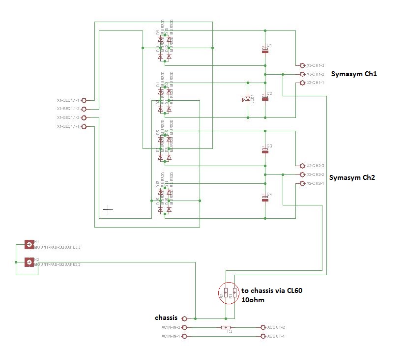

Hello
Maybe i`m right here.
My symasym drives my -nuts / crazy / what ever
I have a Stereo amp.
The Problem is: If i connect both cinchgrounds from the 2 pcbs together
(like it is usual with cheap cinch cables) i get hum.
for test i`ve connectet only 1 channel (with same cheap cable) amp is silent.
First i had one PSU for both channels thought this is the Problem.
And changed the psu to a "quasi dual mono" -pic-
Problem still remains.
Now i dont know where i should look at?
Someone has an idea / same Problem -> with solution😀
good amp but with HUM no FUN
thank if someone could help me.

This symptom is typical of all stereo amplifiers fed from a stereo source that has a common Signal Return for the two channels inside the source.
A single interconnect, be it a coax or twisted pair, makes a single grounding connection along the return conductor.
Equals no interference.
Two interconnects, make a pair of grounding connections into that commoned signal ground. That makes a loop.
If you make the loop smaller the interference pick up is smaller.
If you increase the resistance in the connections at the power amp bigger, then you make the interference current smaller.
Every year we see the Daniel Joffe paper being linked that explains the methods of reducing these interference currents. It was posted (yet again) last week.
I'll try to find it and post a link.
