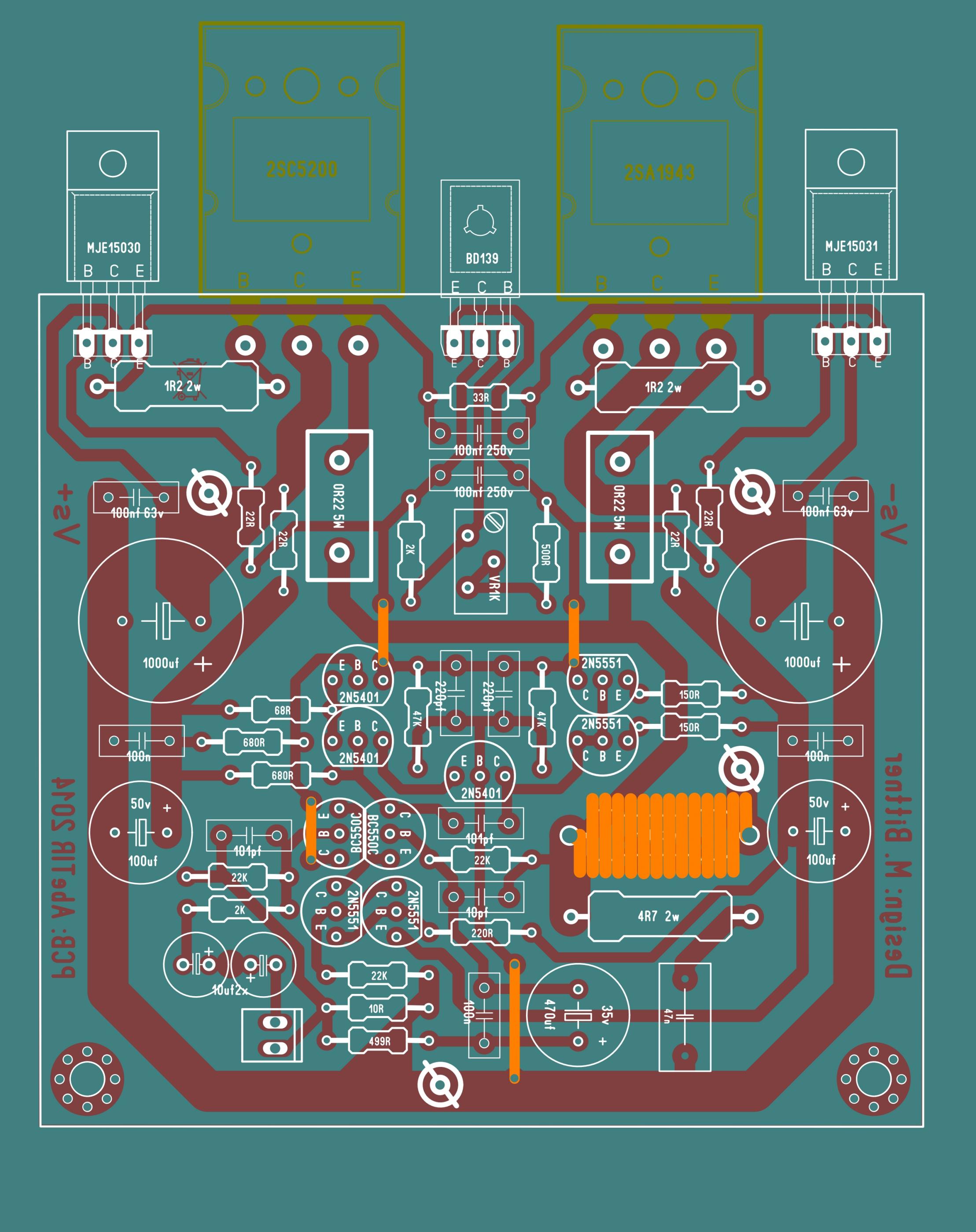

Hi all,
...just thought I could share my SYMASYM pcb lay-out, SYMASYM was an old project I was wishing to build. The design was N0T TESTED yet (need to buy more time for my audio hobby ) Anyone interested to get their hands on it, pdf files attached. Schematic used was M. Bittner's original but I suggest to follow Pavel Macuras mod if using 2SC5200/SA1943 for the outputs.
Regards!

Very neat but quite a radical departure from Michael's layout. I note that Michael said at the outset that layout was critical so interested to know if you've built and measured performance yet?
A couple of observations in the meantime: as you're paying attention to Pavel's suggestions did you not want to put parallel reversed diodes around R2?
Are your MJE15030/1's too far away from their pads? Their legs aren't very long. So if you're mounting, for instance, on 3mm angle aluminium you need to allow for this, plus the board thickness plus half the thickness of the transistor itself in order to have enough of the leg poking thru to solder.
R1 and R3 don't need to be more than 0.5w according to post 3142. I've sourced Welwyn 1 watt MPF1's for these which at 6.3mm long are much smaller than you have. You could lose several mm on each side of your board. Even the 2w MPF2's are only 10mm.
Is there a compelling reason for making a bipolar cap out of 2 electrolytics at C1? I know the WIMAs are impossible to get at 4.7uF outside of Germany but why not use a single reversed electrolytic as Micheal suggests at post 2279 and 2438. Or are we doing this just because that's what Carlos did with Blame?
Did you not want to use 2SK170 at Q1/2?

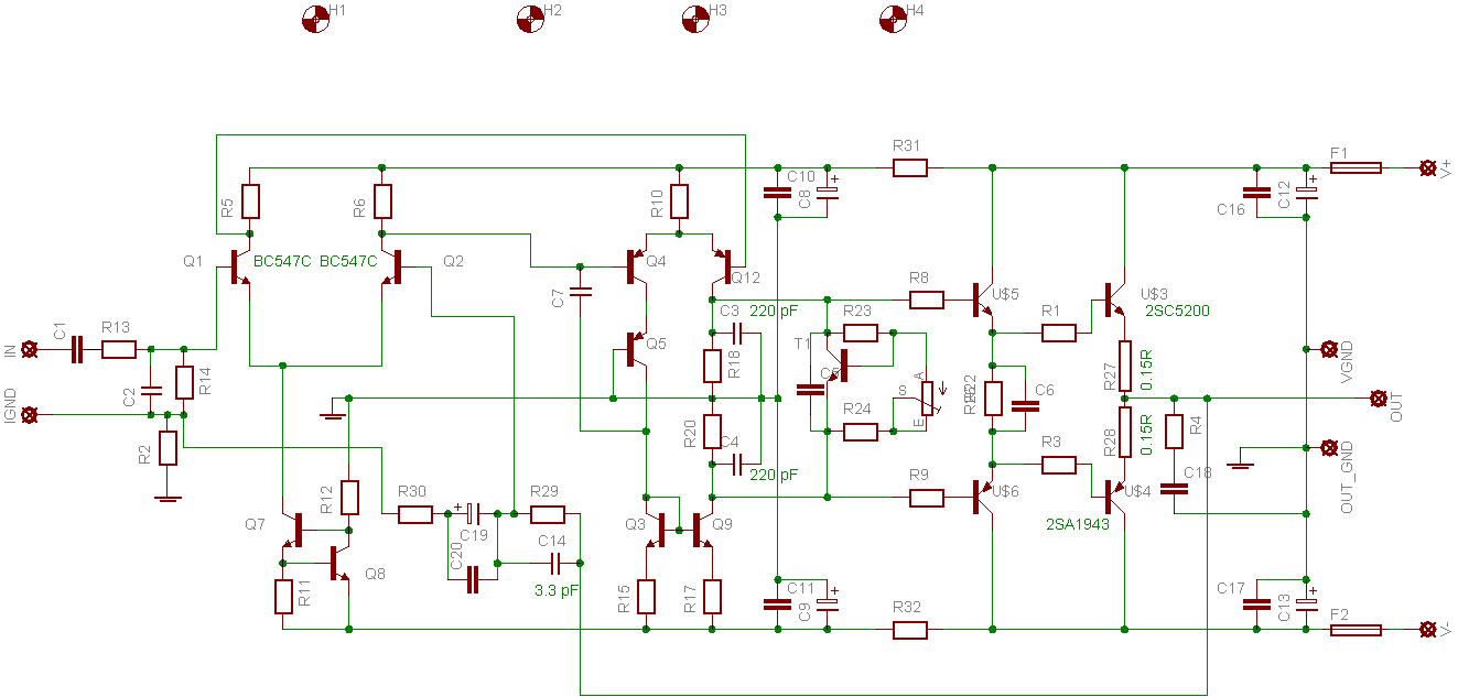

Hi, i have finished build Symasym 5.3, output DC-offset is 0.0~0.1mv, tested running 2 hours Vbe is steady +/- 0.002V. running in high volume heatsink still cool (i'm using a thin heatsink with cooling fan.) no pop sound when switch on and off, no humming or noise. this circuit is realy stable (Great!!! is a good Design).
ok, sound output is clean and good ...... but i'm expect overtone and more liveliness or dynamic.
Don't know my amp is oscillating or not (any idea how to check it?) highly appreciate any help.
my sym ... bd139 as Vbe multiplier, mje15030/15031 as driver, NJW0281-0302 as output, 3.3pf feedback cap (too samll ?), and winma mk4 Type capacitor as input cap.
