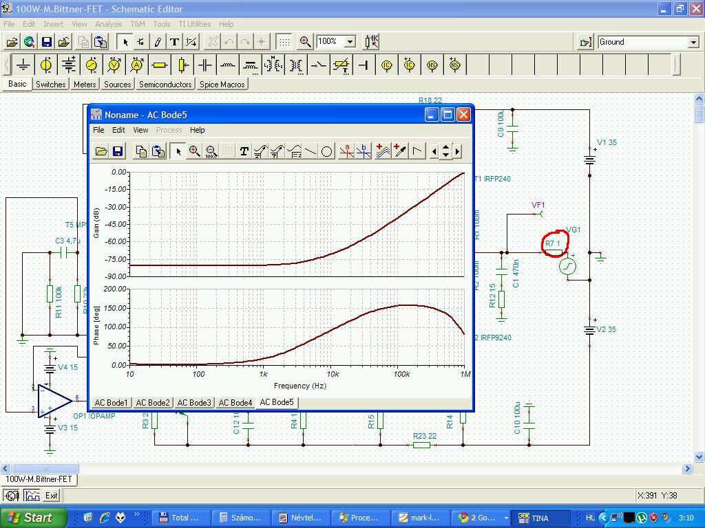

It would be better to ask the output impedance and how it varies over the audio band.
Would it matter if the 1kHz Zout were 50mr or 70mr or 87mr?
Would it matter that the 100Hz Zout were 3 times the 1kHz value?
What are you going to use these Zout values for?
Damping factor is dependent upon load impedance.
If you don't specify this your question cannot be answered accurately.
The calculation is calculated on a 1 ohm. The picture shows the output impedance. The correct damping factor calculation was divided into 4 ohms, 4, 8 ohms divided by 8, ect, ect. and calculate the inverse.

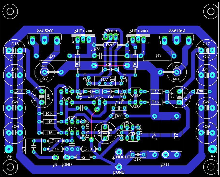

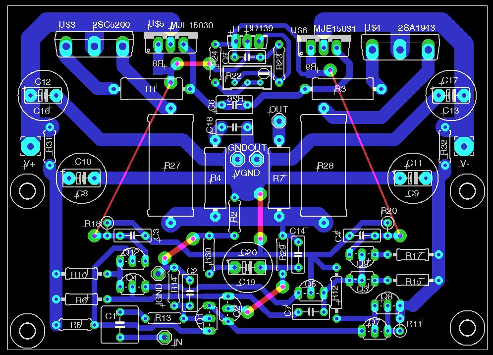

I built a symasym some years back and I'm considering building another.
I thought I'd change some little things on the original PCB before starting (change the trimmer, remove the fuses, thicken some traces to make it easier to self-etch, etc.) and, one thing leading to another, I ended up in Eagle with a quite different PCB.
So, here it is. Does it seem ok or should I go back to the original one ?

It is not the best. e.g. R29 should be connected at the jumper so also R7.

The ground pins of C10 and C11 should be as close to the ground connector as possible. You've put them as far from it as you can.
Why not put the reservoir caps along the space behind the power transistors? This would take the small-signal circuitry out of the magnetic loop and decrease radiated distortion. Power ground wouldn't be at the other side of the board so you wouldn't need to run the power output trace through the small-signal section.

Thank you for the comments... there's much work on my plate after that.
Some questions in order to clarify things in my mind.
- I had some trouble understanding what you pointed to, as I deleted that jumper by running ground tracks left and right... and then I remembered that the evolution in between 5.2 and 5.3 was precisely the opposite
- I like the idea a lot, especially wrt the magnetic loop.

- What's the problem about R7and R29 ? This part is coming straight from the original layout.It is not the best. e.g. R29 should be connected at the jumper so also R7.

- Well, it was kinda on purpose. C10 and C11 are the reservoir for the small signal circuitry. If I put them close to the ground connector, they'll be connected before the power reservoir caps and see all the charging currents. In a ground bus, isn't it better to have the sensitive circuitry after the big stuff ? Or am I missing a step ?The ground pins of C10 and C11 should be as close to the ground connector as possible. You've put them as far from it as you can.

The ground trace from the reservoirs is a long resistor. The charging currents create a voltage gradient across this resistor. The voltage difference will always be smallest closest to the source. By putting the frontend reservoir ground at the other end, you are injecting rectifier and switching noise into the frontend rails.
This hasn't much left in common with the starting point. I tried having power ground at the middle and keeping the feedback path as short as possible. A bit of a problem to bring the signal to the drivers though... Wires under the board ?
If it isn't worth pursuing, I'll just etch the original board with some little changes (especially put a decent trimmer onboard and add decent test points for bias).
