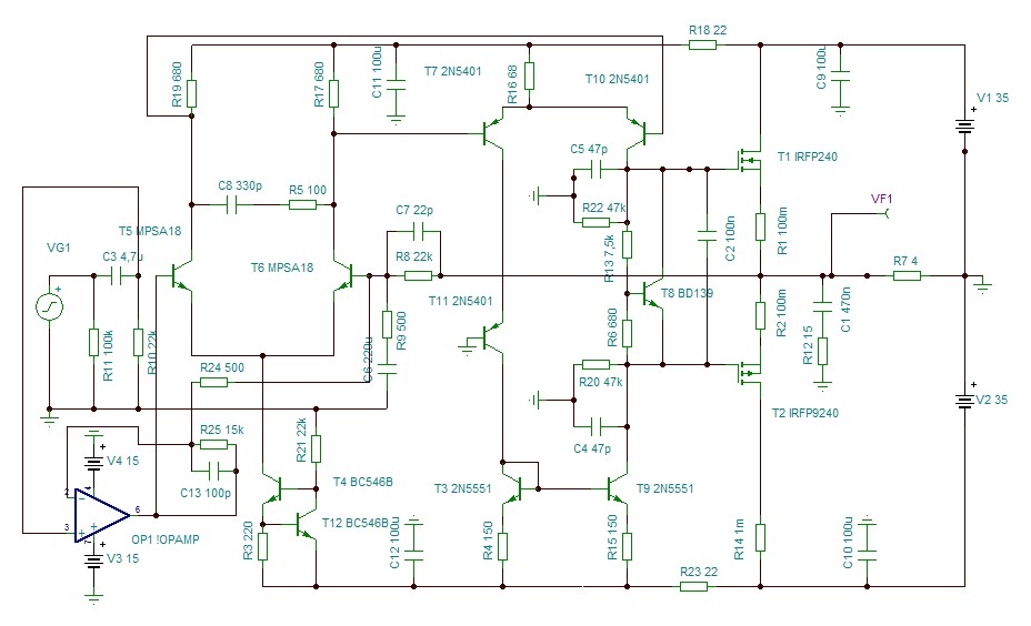

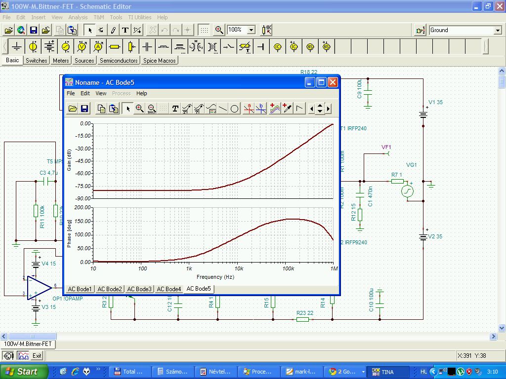

Simple modification. The operational amplifier increases the useful signal 0dB, 30dB signal the error. In conclusion, the bias decreases 20dB
