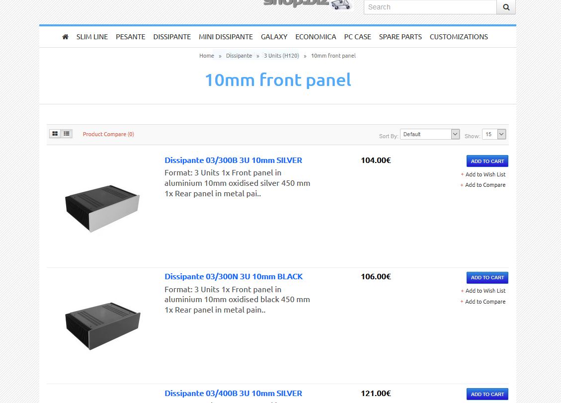

I just found this website that have many size chassis maybe you will like it
🙂 Modushop by Hi-Fi 2000

Thanks Vargas, but I already knew this website. Its just a bit expensive for a student if you know what I mean. :/ ( with the shipping costs ) But such a Peasante would be a very nice piece of chassis. And do you maybe know a website for power switches like those in yamaha amplifiers? I never saw such a switch/button available. :/

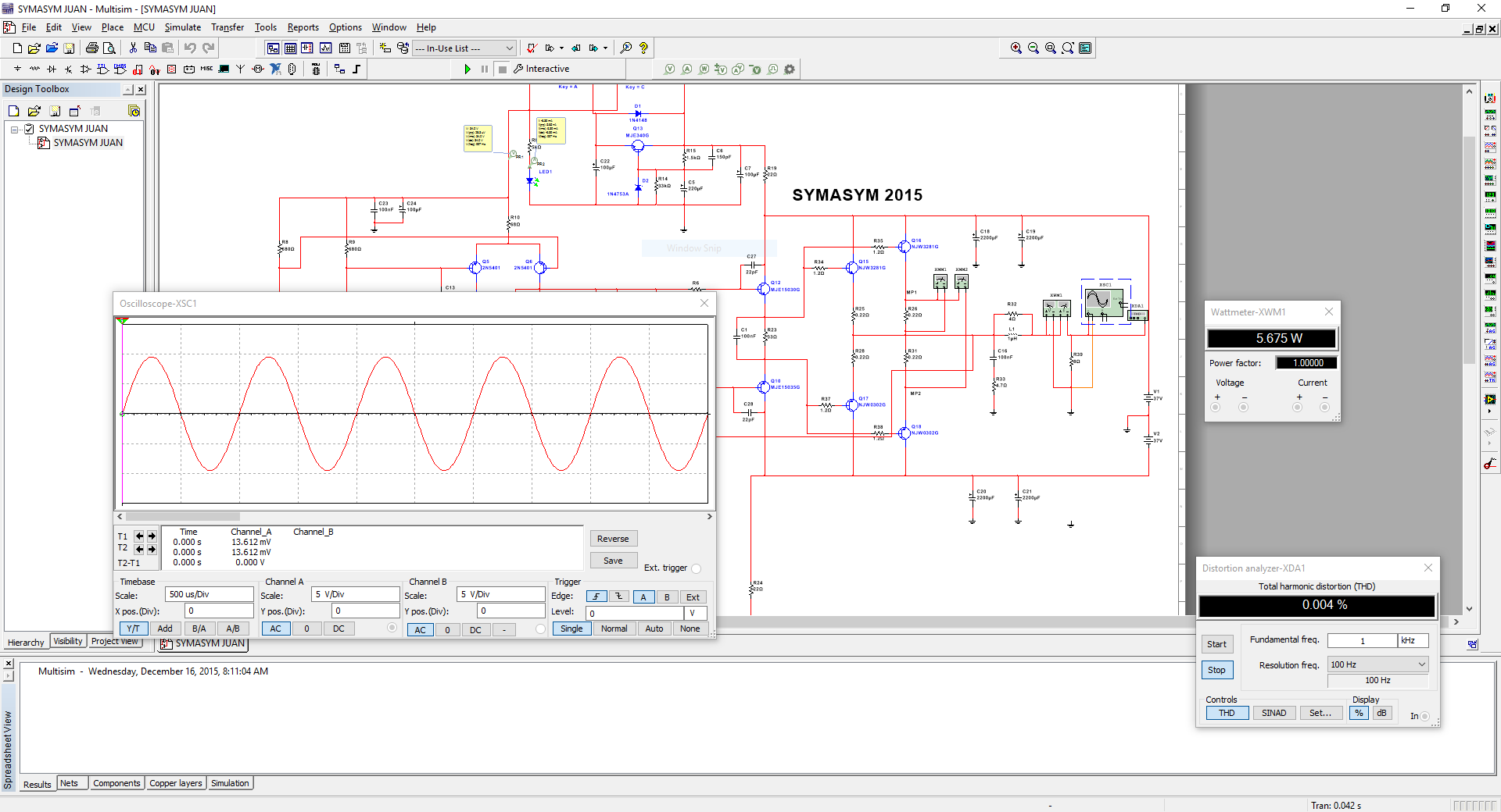

Hello sir I haven't but I do have plans to order a few mister Rudi's design I have a clone PCB but "only for personal use" I already simulated and responds really well bias adjustment and all that good to go 🙂
Regards
Juan

I use multisim 14 a free version from Mouser or sometimes I use LTSpice, but LTSpice is a bit more configurable than multisim 14 , I only do simple simulation to see how many watts and to see the bias adjustment and frequencies respond but no too do really more complicated task circuit analysis 🙂 I leave that to the experts jejejejeje
Regards
Juan

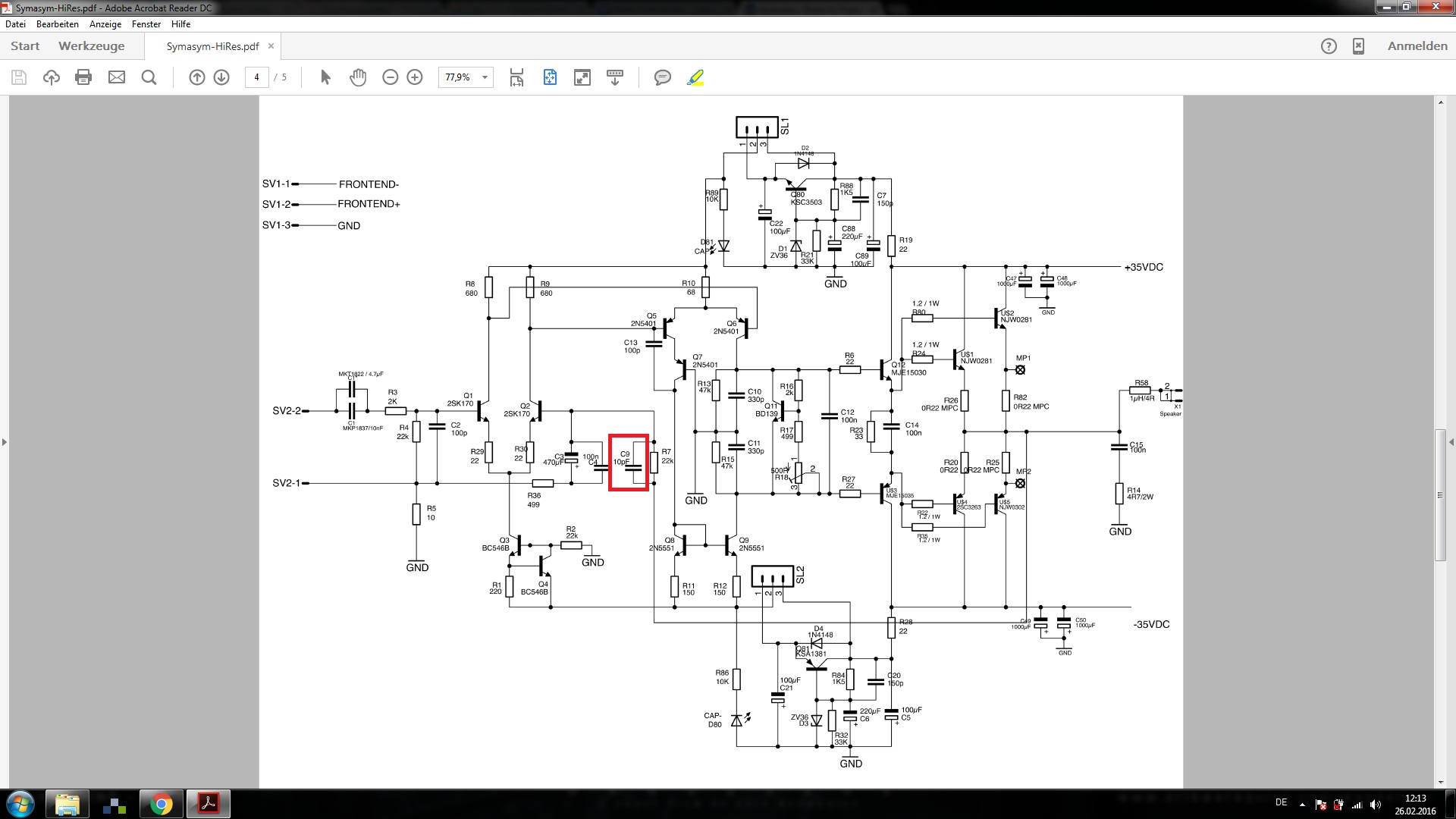

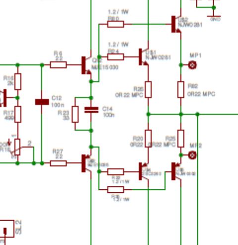

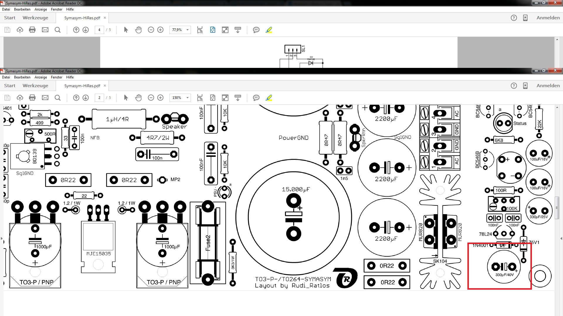

Hey Guys,
I have a question about the Resistors R22,35,24,80
R14 , R40 and R42 because in the reichelt Chart there are only 4 Resistors 1.2Ohms 1W instead of 8 in the silkscreen of the Black Beauty PCB. Which Resistors do I need for these 7 Resistors ?
Yeah, all info you could give would be great, not leting me do the search... 🙂
Here is the Link ...
http://anleitung.diy-audio-shop.de/SYMASYM-BB.pdf
And I have an another question. Can I use MJL3281A/1302A instead of the NJW series ? In the PDF is the MJL4XXXX series listed but I heard that the MJL3XXXX is in some points better than the 4-series. I think the Power is in both cases more than enough (200W MJL3XXXX and 230W the MJL4XXXX) 😕
Help 🙁
PS: I use 2x 27V 200VA Transformers if this helps...

Sorry, still hard to find all resistors with a blurred schematic like this.
And there are more version of the PCB as well in that 40 pages long doc.
So please prepare your question with as much info as possible
with screenshots and the critical sections marked with paint, etc.
It's really time consuming to search for the info with this much of info.
MJL: yes, they should work as well!
But if you change some of the components use the bulb method to check for oscillation, etc.

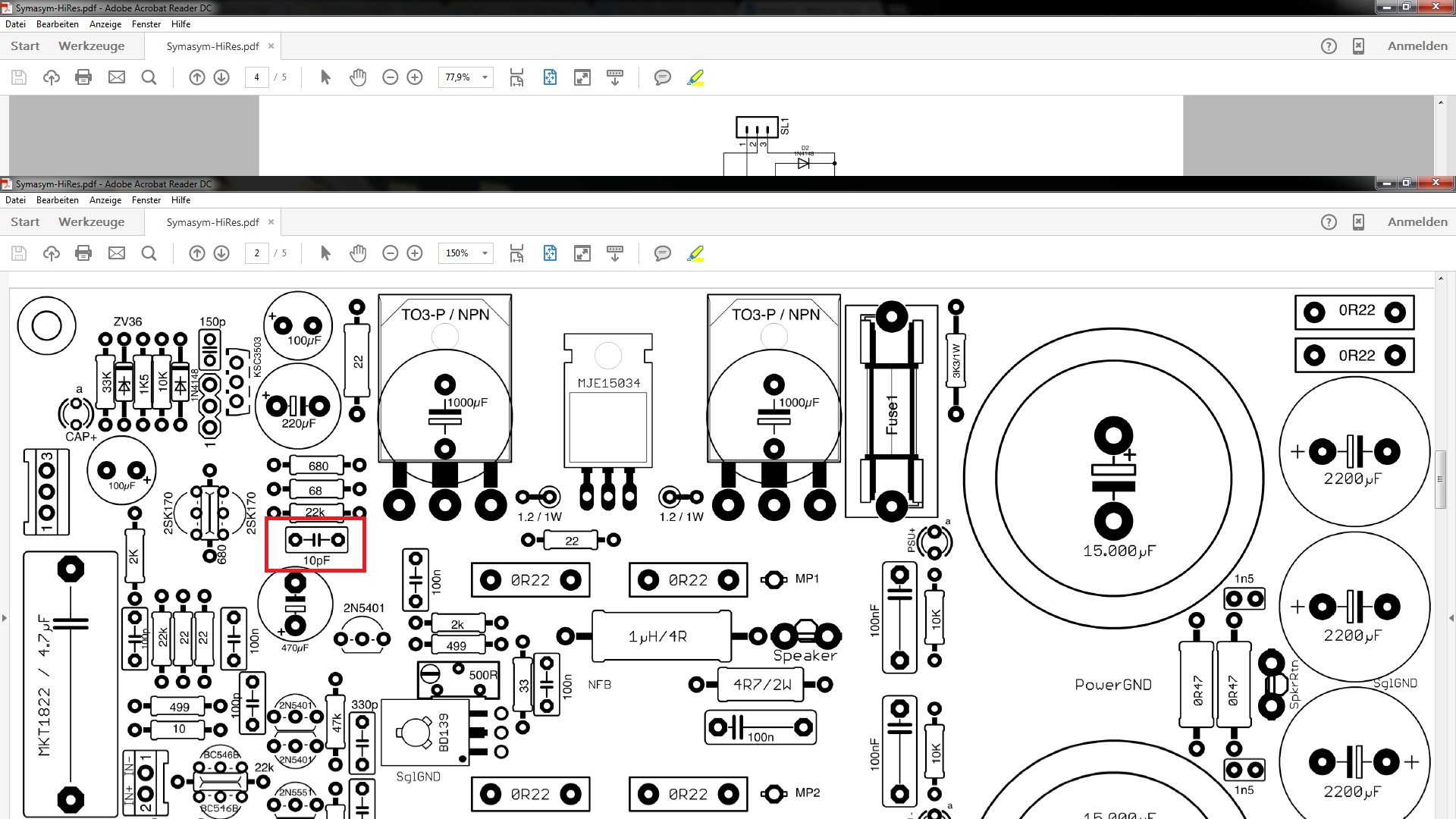

Alright, thanks. Btw I found the right resistors so the last question is obsolet now. But I have another question can i change this capacitor marked in my screenshots with a 22pF one ?

Most amplifiers are very sensitive to small changes in that feedback capacitor.
One well regarded amplifier was OK with 22pF there.
When built with a different output device pair, the amplifier oscillated.
The 22pF had to be reduced <<10pF
Some amplifiers will only tolerate a 4p7F here to maintain adequate stability margins.
You have to check your as built stability margins.
Adding a resistor in series with the capacitor may help, but agian you need to check your stability margins.

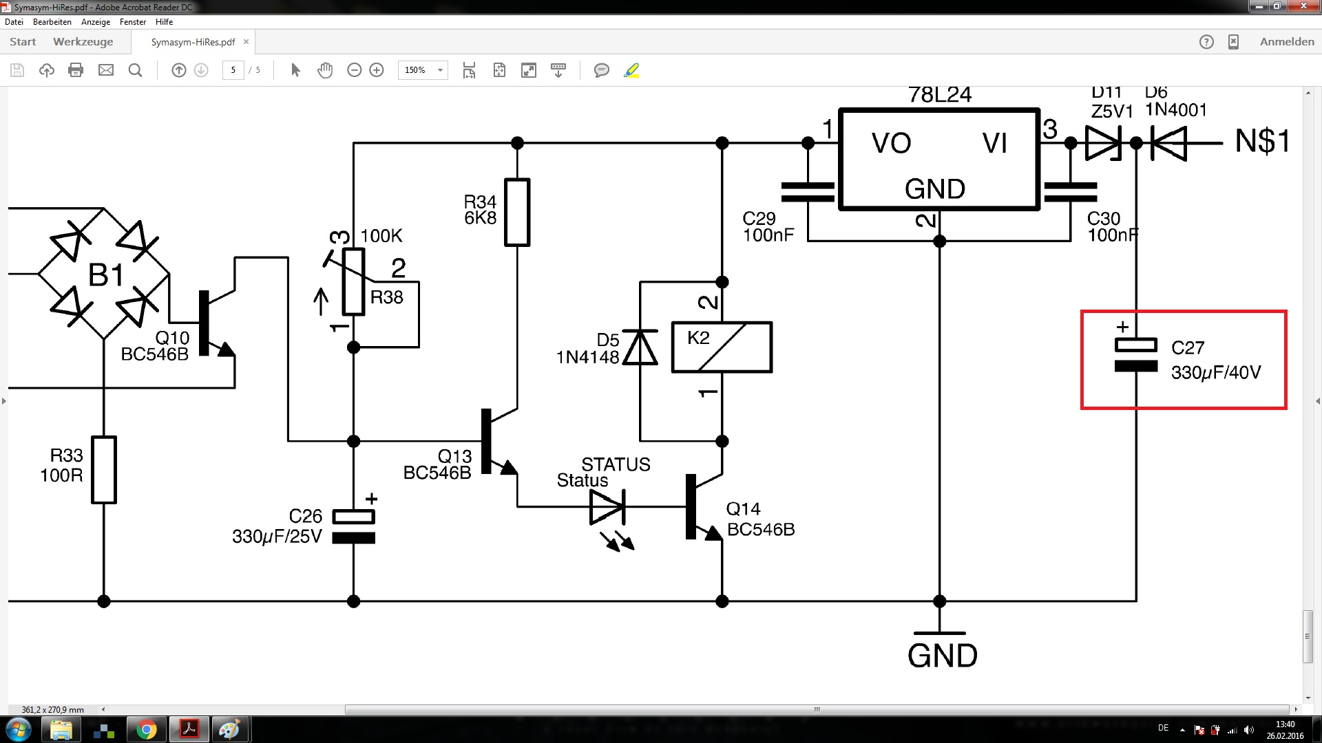

Ok thanks, 10pF then, another question, can I change this Capacitor to 470uF 40V instead of 330uF 40V ?
PS: I have a second question before I forget it... Which function has the Potentiometer R38 with 100Kohm ?

Check your as built stability margins. I don't properly understand amplifier DESIGN and cannot tell anyone why that capacitor is so sensitive in the way it affects the outcome. I do know that a reactive load can inject a signal back into the -IN via that capacitor and that may be a clue to why it can dominate stability behaviour.
Yes that input capacitor just provides a bit more ripple attenuation before the regulator. But it would do that even better if there was some resistance between the supply and the capacitor. Add in a resistor in series with D6
VR38 adjusts the time delay.
C26 charges up via VR.
The time constant is VR*Capacitance.
It reaches ~2/3rds of the 24V supply in one RC time constant.
The timing transistor starts to switch on when C26 charge reaches ~ VbesatQ14+VfLED+VbeQ13
that voltage is ~3.3V. This is only 14% of the supply, so the transistor turns on LONG before the capacitor reaches 16Vdc.
The current through R34 must be sufficient to saturate Q14. I calculate IcQ13 ~3mA.
Will that saturate Q14 for the relay you intend to use?
BTW, the circuit does not need bc546. These are 60Vce0 and the regulator is 24V.
Any 30V to 50V Vce0 will do.
C26 must be reformed slowly before assembly.
Otherwise leakage will ruin the timing which will constantly change over some weeks as the capacitor reforms in circuit.
Personally I would use a fixed value for R38 @ 300k to 1M and use an MKT for the timing capacitor. Much more reliable. 1M0 would require a higher gain transistor for Q13, try hFE >200

Wow!!! thank you for that much information, so step for step,
For the R38: I have a 0,6W 480Kohm Resistor here will this do the job ? And on which two pins must I solder the R. ? between 1 and 3 ? (Sorry to ask but it's my first amp. project
Q14: yes
BC546B : Yeah I see but I have many of these trans. so why not 😀
Q13: Which type should I use ? I have only 546B and 2N5551 here 😕

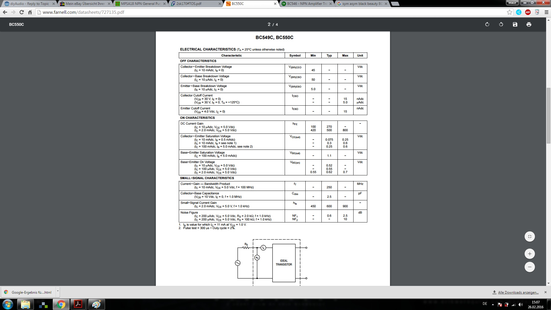

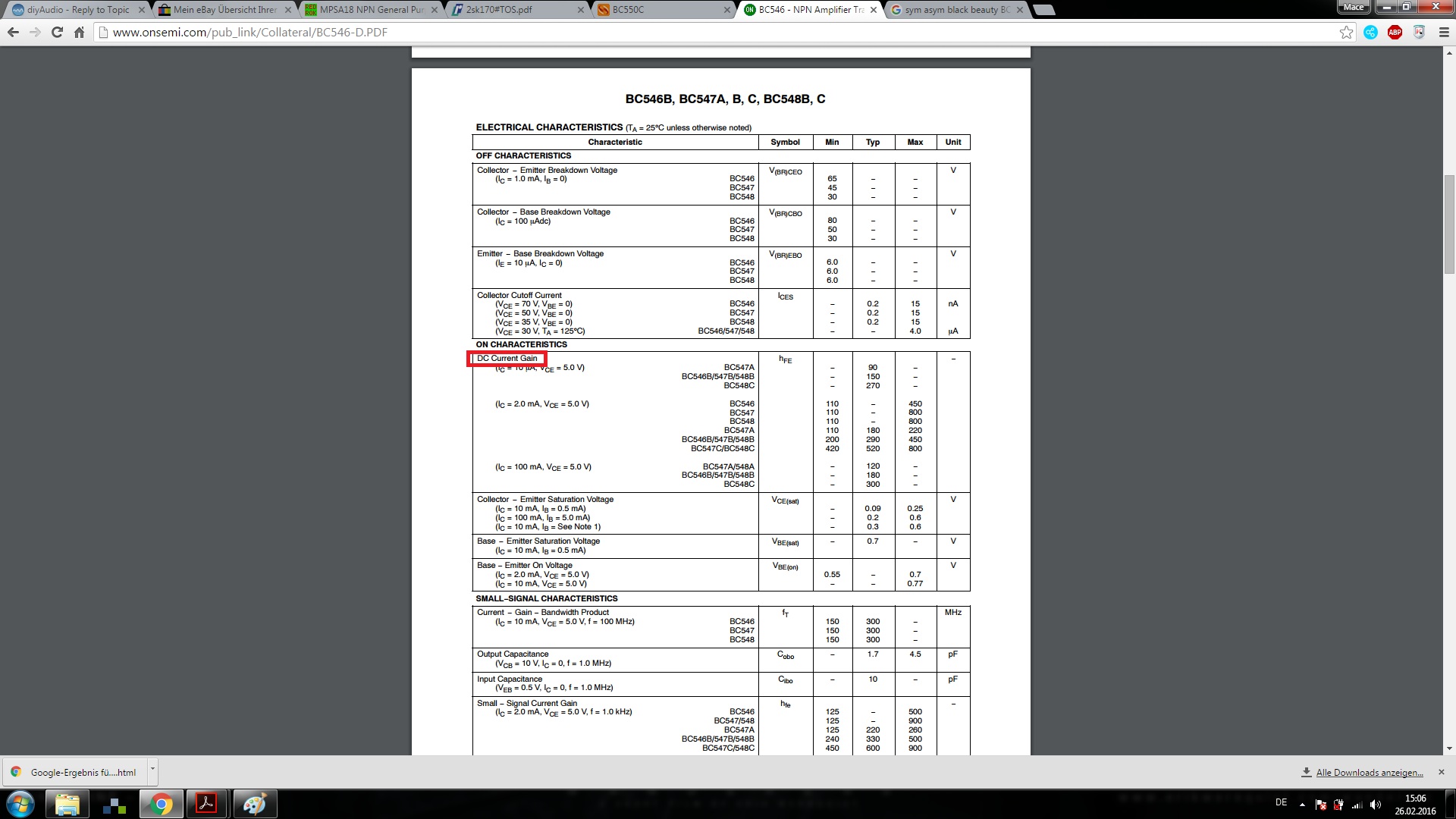

What about the Input Trans. Q1 and Q2, in the PDF is listed that I can use 550C 2N5551 ... but I only have the BC546B here is it bad to use it for the 550C?
In the Datasheets stands that they have similar properties only the hfe is lesser than the 550C ...
