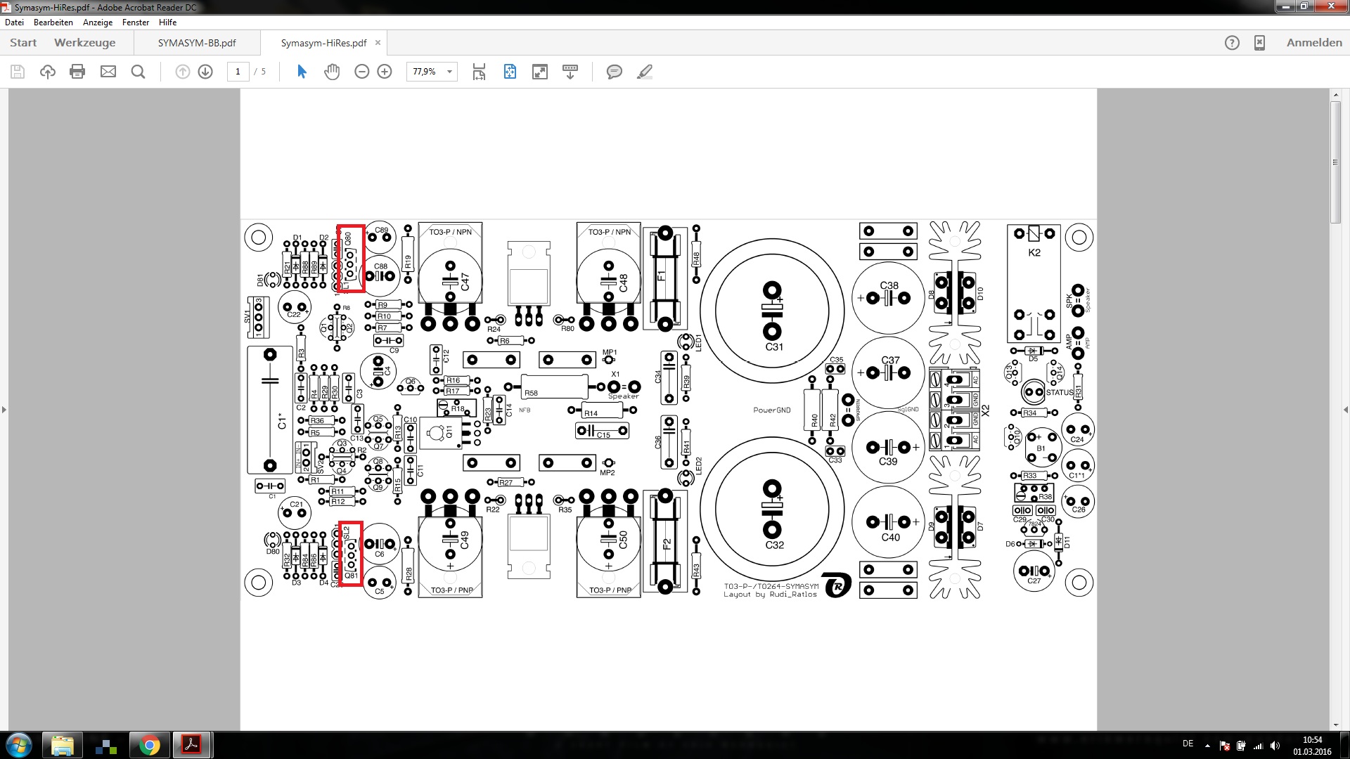

Must I screw the Transistors Q80 and Q81 on the heatsink too ? Or is it enough to solder it directly on the PCB with air around it ?

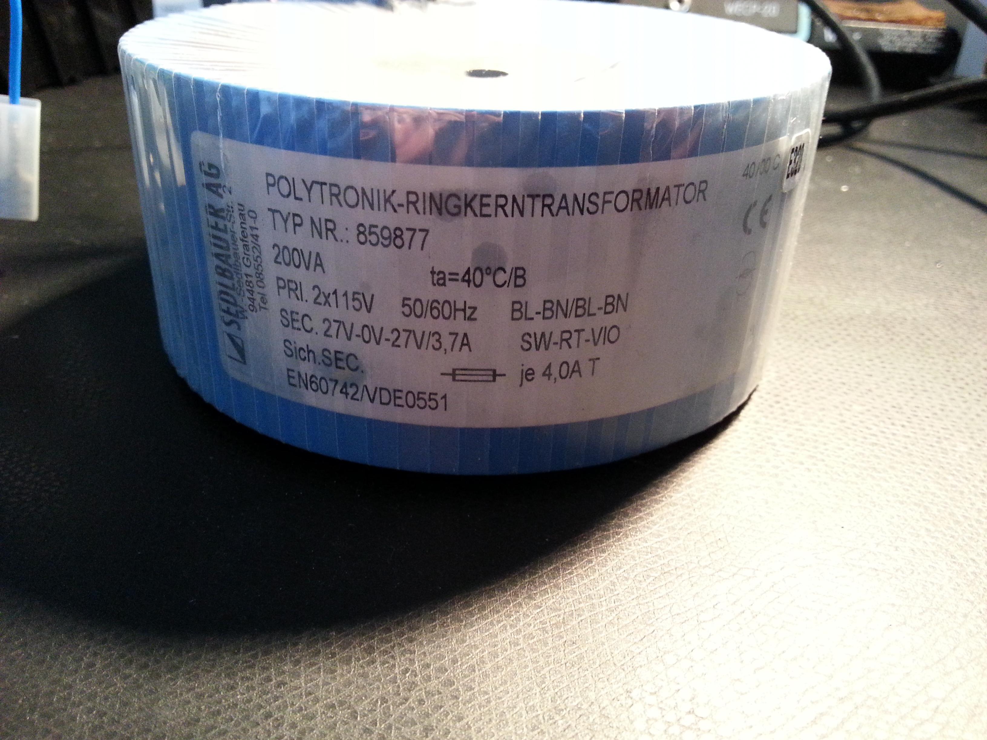

I have 2, 200VA Toroid Transformers here with 3 Pins out blk/red/vio (SW/RT/VIO) and now how do I connect them to the SymAsym ? I would say RT is my GND (0V), SW +27V and VIO -27V ? Or am I wrong ?

It's a dual Primary.
Your first question since it is potentially more damaging when you get it wrong is:
How do I wire up the dual primary?
Fit the three leads into separate terminals of an insulated terminal block.
Power on via Mains Bulb Tester.
Measure across the three leads and record the AC volts. Three measurements.
Present your results.

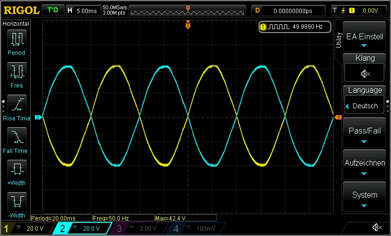

Well I measured it with my Scope. CH1 (yellow) is measured between the Black and the Red wire and CH2 (blue) is measure between Violet and Red.
Is black then -27V because it's a Cosinus (180°) ? And violet +27V because of a normal Sinus ? (0°)
Between Black and Violet i measured 58V with my DMM

As you measure 2X27V A.C, NOT + OR -, then you have connect primary on the right way.
Transformer voltage is A.C.
You must use a rectifier connected to secondary coil to take D.C voltage.
Then using big electrolytic capacitors this D.C filtered enough.
The amplifier will be connected after capacitors

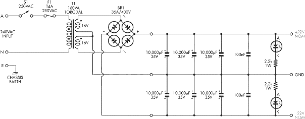

Look an examble here.
The only way to connect the A.C voltage to an amplifier is the rectifier and filter capacitors are included on amplifier pcb.like this on post #4061.

You omitted to tell us you wired two of the secondary tappings together.
How can we approve your wiring if you don't tell us what you are planning to do, or have done?
And take on board that AC does not have +ve nor -ve.
AC1, AC2, AC3, AC4 would be the four tappings. Assign those colour codes.
Is AC1 and AC2 on the same winding?
Is AC3 and AC4 on the same winding?
Is AC1 isolated from AC3?

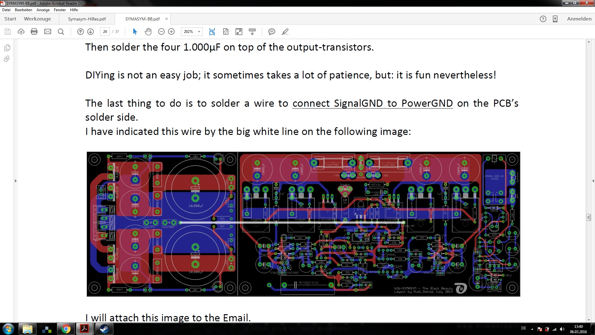

It is always good practice to separate "Power GND" from the frontend's "Signal GND".
Solder a wire as shown in the Builder's manual (in your picture).
Regards - Rudi_Ratlos
Okay I soldered a wire between PWR GND ans SGL GND. But I have an another Problem now. I checked the whole PCB if I made some failures but there isn't. When I connect my Transformer with a 30W Bulb (for current restriction) on the PCB the Bulb shines, so there must be a short somewhere ... I connected it for 5 sec. ca. Then I connected a Power Supply (+20V -20V) on the Pins from SV1, the LED's D80,81 shined so the negative and positive Voltage is there. Then I tried to decrease the Poti R18 but on MP1 and MP2 is just 0mV. Is there anything I can check now where the failure could be ?
