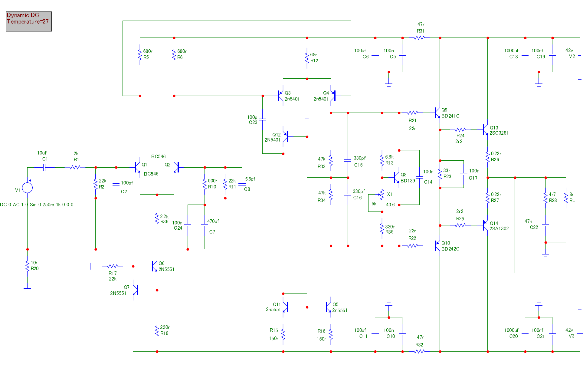

Hi guys!
Going back to my SymAsym build, I can't make the bias adjust to work
It worked the first time I power the amp, set it to a low 20mv across both 0.22r just for a test run. Following the other day I cannot measure any dc voltage across the re and at the bases of the drivers, totally zero, none. Playing music with it, it will work and I can get DC voltages but without music it goes back to zero. I thought I messed up the vbe 1k trimmer because I am hearing faint clicks while repeatedly doing the process.

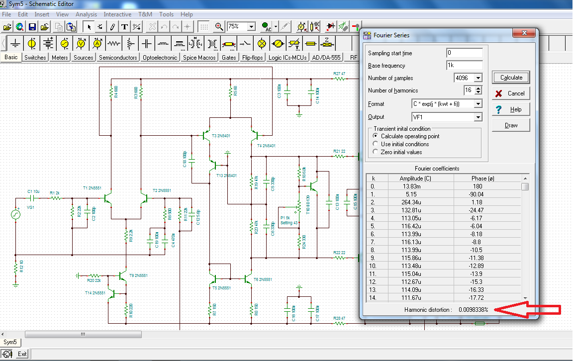

I decided to run a simulation of the amp and made new values at the bias circuit for use with a 5k trimmer (believing I busted my last 1k trimmer but never bothered to check it off board) but after placing the new values on board and adjusting the trimmer per simulation result, it still didn't work. 😕

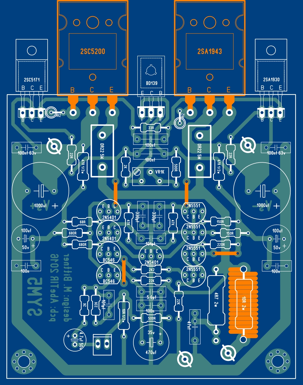

Attached is a revised pcb lay-out and my schematic. Notice the addition of a small resistor at the ltp emitters (R36), this reduces a few CCS current because DC transistor condition in sim shows that one trannie is hot (Q6 tied to 22k-ground). The 2.2k addition seemed to lower the THD figure (in simulation).
My actual build is working nicely, sonic is very good, dead silent and no turn on/off thump... I just can't figure out why biasing stopped working or is not working. I have check the drivers, vbe bias and output trannies but found no indication of any defects....any ideas what has gone wrong and where to check for possible fault?
BTW I am using c5200/a1943 and c5171/a1930(drivers), DC offset is -12mv (no matching done).
Regards!
Albert

It is in one channel only, the other channel is still incomplete.
Vbe of Q8 - you mean measured voltage? I made a resistance check between the trimmer and collector of Q8. also trimmer to emitter of Q8. Result is confusing as the trimmer resistance does not seem to add to the series resistor of base to collector and also base to emitter.
Are you having this problem in more than one channel? What is the Vbe of Q8?
just made a measurement at this moment voltage bet base and emitter of Q8 starts at 0.5mv then drops to zero. when a player is plugged in there is a 0.7mv across both output re.
To give a short answer the value of R13 is too high to allow enough current to flow from the emitter of Q8 and out of the base - so this transistor is not able to turn on. In that case ( if on) it would have a base to emitter voltage drop of close to 0.6 volts.
I suggest you review the values of R13, X1, and R35 looking at various versions of this circuit posted on this thread. In early versions R13 is 2k2.
