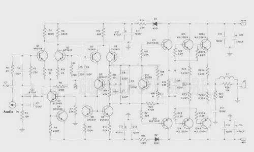

Hi I am going to build the Symasym 5_3. I have a nice case and a very good twin power supply already. The hitch is the supply rails are +-43.5 volts. Can anybody tell me if this a major problem ? Could somebody kindly advise as to what I need to change / swop to handle the higher rail voltage ?
Hi Simon,
I think design center was for 35 volts. Just look at your parts and substitute any that won't handle the 97 volts they will see. 100 volt parts are cutting it too close, so you might want to look at 120 volt parts as a minimum. If the diff pair is cascoded, you can get away with much lower voltage parts.
It wouldn't hurt to look at the power dissipation for some parts also.
-Chris
I am not sure why you want to change anything ? I built version 5.3 2 weeks ago, and yes this is a seriously nice amplifier. Works very well in my system, just love listening to the music and yes this design is very musical ! Great grip and resolution of lower chords, clear mids and highs. But what sets it apart is that it does this so well whilst keeping you involved with the rhythm of the music.
I did use a twin +-42Volt power supply and had to swop the MPSA18's for 2N5551 and the BC546 for 2N5401. That said I guess it shows going to higher rail volts is not a problem. Anyway I highly recommend the amplifier easy & relatively cheap to make also.

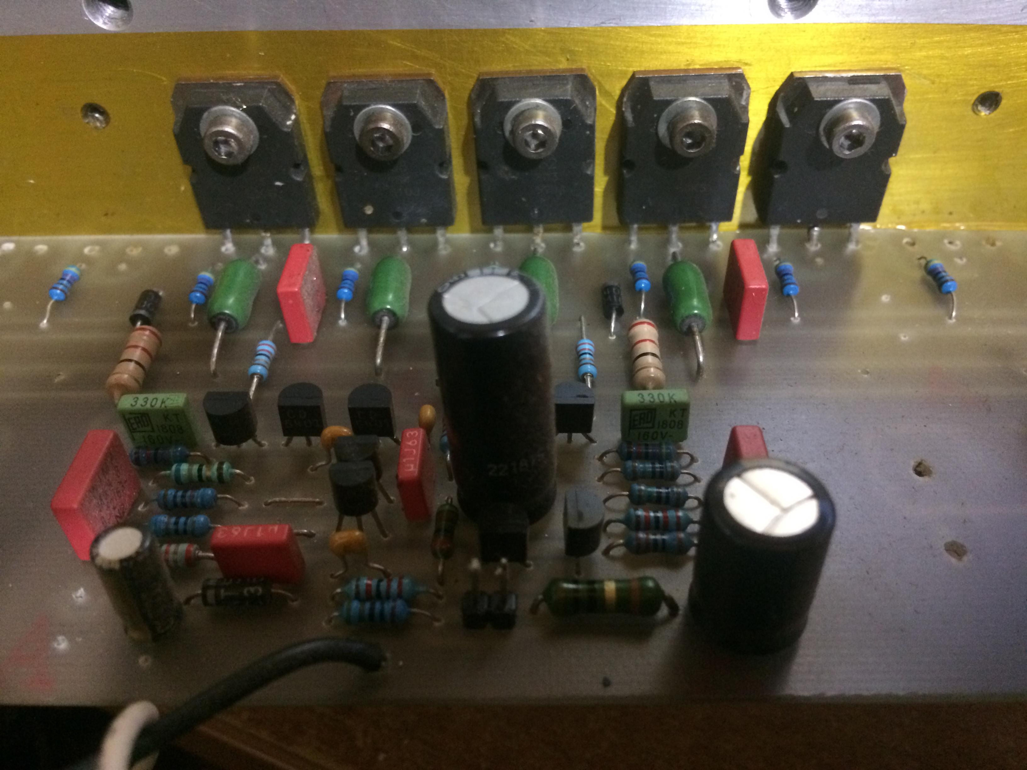

Hi caglarm,
Now we see the picture of what we assume is the schematic you posted. It is "very dicey" indeed. So, do you have a layout, or was this just wired out on some kind of basic "amplifier PCB"?
Working very well means that it sounds good to you. Were you able to take any measurements for distortion and power output at various frequencies? I'm not putting your amplifier down, just trying to quantify what you have there. I think it's great that you were able to simulate a circuit, and then build it and it worked as it simulated.
