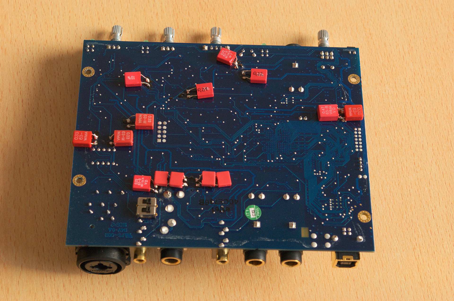

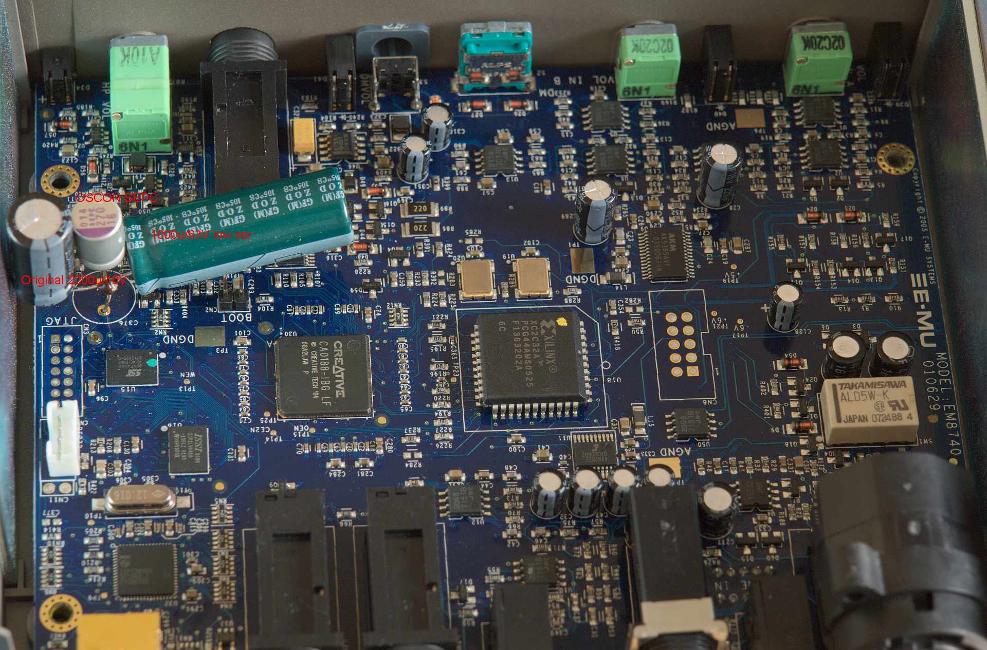

I have been using this DAC (E-MU USB 0202) from 2006 but the sound caused listening fatigue after ~1 hour of listening.
I decided to tweak it and added additional WIMA 0.47 caps in parallel to original electrolytics on main board. To main original 2200u/10V cap I soldered 2 OSCON SEPC 270u/16V, one 1000u/63V low esr, 0.47 and 0.33u/63V WIMA. All of those operations took ~15 minutes.
The results are OUTSTANDING!
With StalthAudioPlayer using high quality audio files it plays much better than my moded cdplayers with tube I/V at the output.
The sound now is detailed, relaxed and calming with plenty of the details.
I am highly recommending this dac with tweaked power caps.

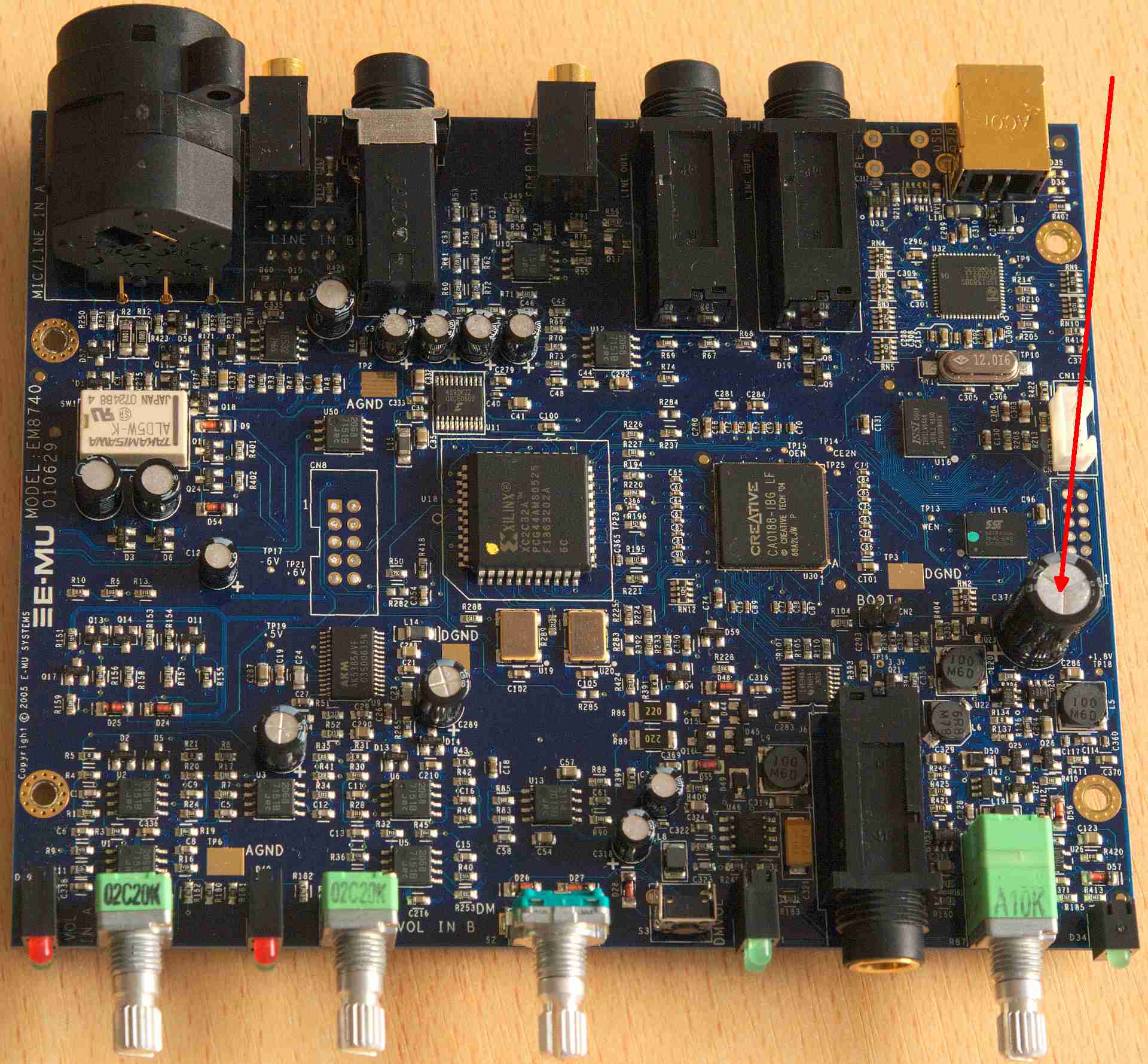

There are some serious design flaws in this DAC.
First is that the contacts of the muting relay are wrongly configured (nc and no contacts are swapped), resulting in a click-sound when switching from/to mute.
Second is the relay circuitry is not able to provide the full 12Vdc coil voltage and sometimes the relay doesn't switch to unmute.

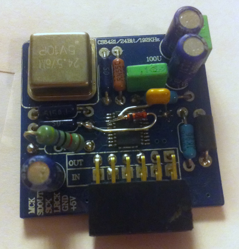

Third is that the chip on the 192KHz sample rate converter board (CS8421) is powered with 3V3 digital core where the specs mention 2.62V max.
This finally killed my upsampling chip by switching the DAC on. I modified the upsampling with a 1N4148 diode providing 2.6V at Vd (pin 3).
Altogether, the DAC really sounds nice :king:
I've attached the jumper settings and schematics for the one who's interested (multipart zip files, remove the last .zip from the filename).
