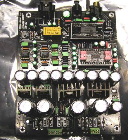

Experience with this DIY DAC ?
Got this DAC from ebay.
No sound when using quad speed setting!
Need help.
How do I source a192K digital stream ?

This DAC is based on CS4398 and CS8416. The CS4398 sampling rate is controlled by 4 dip switch to (manually) set M0, M1, M2 and M3 to ether HI or LO for sampling at 41K with de-emphasis off, 41K with de-emphasis on, 96K and 192K. It works with all setting except setting the control to 192K. When setting to 192K sampling, there is only hiss..
Wonder if anyone has experience with this DAC or is able to explain how to get the 192K sampling to work

I did some research and it appears that in order for the 192K sampling to work, the input to the DAC has to be at some higher rate than the norm 44.1/44K. There is mentioning that source to the DAC has to be something like DVD-A output. What I do not understand is that DVD-A is an encoded format and it will be required to decode the DVD-A data stream to PCM to feed into the DAC for it tow work. Do you know if that is the case ? If so, when DVD-A is decoded to PCM, what sampling rate the PCM signal is at ?
I think John has hit the nail on the head. The CS4398 can operate in 3 modes - single, double and quad, as mentioned. These modes control the oversampling function built into the device. If the appropriate mode is selected the CS4398 will oversample accordingly for the best performance. 128x in single speed, 64x in double speed and 32x in quad speed.
Single speed works with sample rates up to 50KHz
Double speed works from 50KHz up to 100KHz
Quad speed works from 100KHz up to 200KHz
So, for 44.1K input (which I assume is what you have?) the best mode is single speed because the DAC will internally oversample to the maximum extent possible. It appears that you have got it working in double speed at 44.1KHz but this is below the rated minimum for this mode. It's actually only if your source has greater than a 50KHz sample rate that you have to switch it into double or quad modes.
Now, if you have a 96KHz source you would need to manually switch into double speed mode. Automatic switching can be achieved by making a connection with pin 16 of the CS8416, as the 8416 detects incoming sample rates above 96KHz.

To answer Puffin's question, the oversampling is as follow:
Single speed mode: I/P sampling rate up to 50K - 128x oversampling
Double speed mode: I/P sampling rate up to 100K - 64x oversampling
Quad speed mode: I/P sampling rate up to 200K - 32x oversampling
I think Kevin is right on in saying that the best configuration is the single speed mode and I am not sure why it works when I configure the DIP switches with double speed mode when the I/P sampling is at 44.1K though?

One other note - I did change the capacitor values for the PLL for this DAC. It appears that the stock capacitor values are the ones recommended for CS4397. If you look at the spec for the CS4398, the PLL values recommended are different from those that are mounted in the stock board.

The CS8416 outputs a "96K" signal that indicates if the incoming sample rate is above an arbitrary threshold that's somewhere between 48k and 88k but to determine the input rate exactly would require some additional hardware as far as I can see. This would be required to switch the DAC into Quad speed mode for inputs above 100K.
Sounds like a microcontroller driving a display on the front panel, counting the sample rate via one of its' timer channels and configuring the CS8416 and CS4398 according to what it sees. 😉
