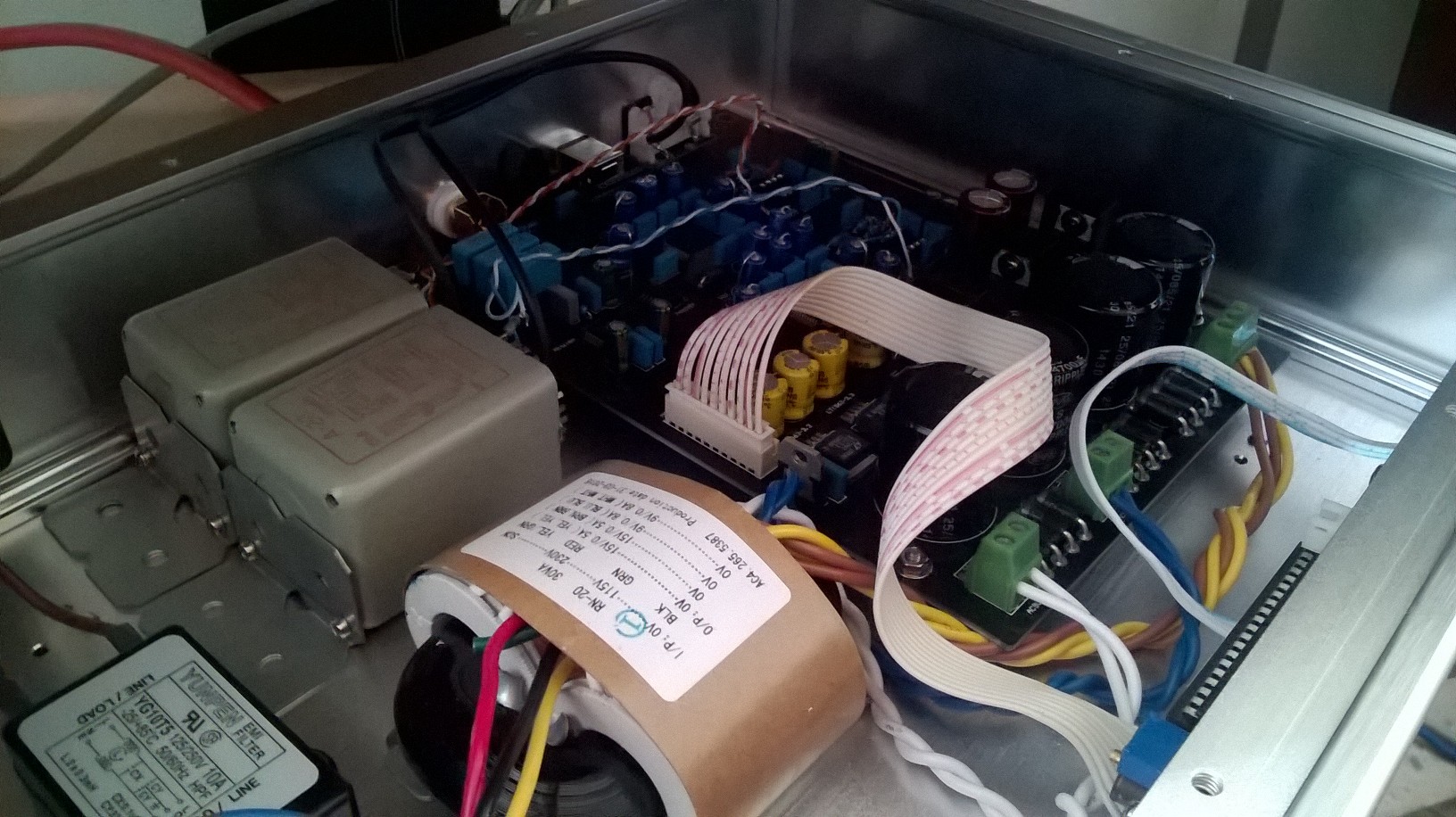

I bought this board
AK4495SEQ Dual Parallel Soft Control Board Assembled Support DOP DSD-in Amplifier from Consumer Electronics on Aliexpress.com | Alibaba Group
and have just upgraded to a rasberrypie3 running Piecoreplayer to Hi-Fi Berry DIGI + to Tubleab SSE amp
so using SPDIF for the moment will be goin to I2S later
I started with the LME49720 it was a good upgrade...but I just love the sound of the UTC A20's connected to any DAC I don't now why maybe it suits my tube amp🙂
Still more work to be done, boxing Rasberry3 etc

I know this board, but didn't own or listen to it. Doesn't have I2S input, so you have to create it yourself.
There's something with those boards (and 99% of other AK4495 based boards, even very expensice AK449x based dac's,,,,) you can change to get a much better SQ, especially in low freq.
Article at Hifiduino:
https://hifiduino.wordpress.com/2014/12/07/akm-verita-4490-dac/
You have to put bigger caps (in Parallel) between VREFHL/VREFLL and VREFHR/VREFLR Try at least 2200uF, or, if you can, 4700uF.
This really makes a big difference. Probably your design has 100uF only......

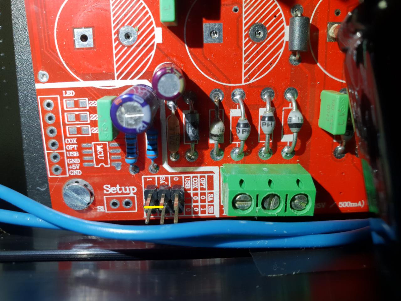

Hello together,
its been quite a while since people got the Gigaworks DAC from ebay, I hope I still can find help here:
I was using the coax ouput now for many years but now I need to switch to USB. Connecting the DAC via USB with my computer works fine and the DAC gets recognized. So far everything is fine, but somehow I have no sound output.
I know that I have to use jumpers, now my question is, which configuration is correct. Can someone maybe confirm the connection like shown in the attached picture?
And: Are any other changes required to use the USB input?
