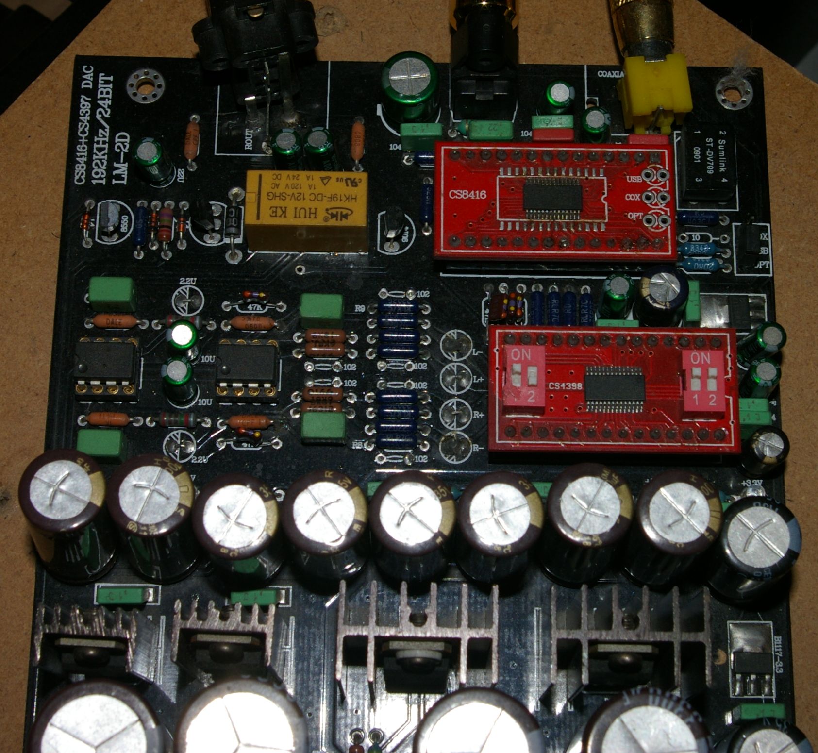

Hi
In the attachment is my DAC
Best regards

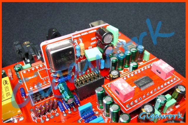

Gabriel, from the picture, your DAC board version LM-2D does not have the headers for the ASRC upsampling option board, which is needed for 192kHz operation (see attached pic of a version LM-3 DAC with vertical ASRC card).
Although the chips can do 24bit/192kHz, it's a bit of false advertising- you have to do mods to get your board to take 192kHz input. Even then, the stock op-amps (NE5532's) are not well-suited for DAC filters and they sound awful here- a limiting factor.

I still have the same issue, can't play 192k files when the upsampling board is plugged in. If I pull the board and put the jumpers back it works, but then I loose upsampling capability on <192k files. Is it due to the wrong PLL values on the CS8416?
I believe I have the last version of the board. I am bypassing the op amps and using transformers.
Yes, you can not bypass CS4398 oversampling modes:
"4.4 Oversampling Modes:
The CS4398 operates in one of three oversampling modes based on the input sample rate. Single-Speed mode supports input sample rates up to 50 kHz and uses a 128x oversampling ratio. Double-Speed mode supports input sample rates up to 100 kHz and uses an oversampling ratio of 64x. Quad-Speed mode supports input sample rates up to 200 kHz and uses an oversampling ratio of 32x."

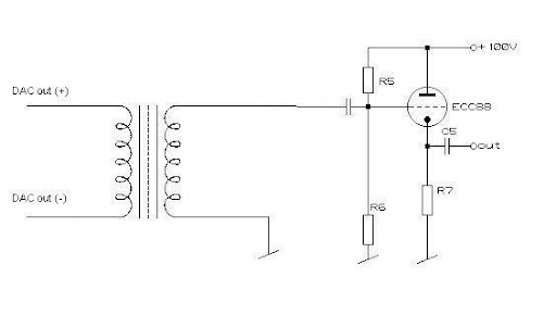

I have the Gigaworks Big DAC using a transformer output stage but I'd like to try a tube output stage after hearing the potential of the Jolida Glass FX lately.
Is there an easy "walk through" and/or parts list somewhere does anybody know? These threads are so large I can't see the wood for the trees.
