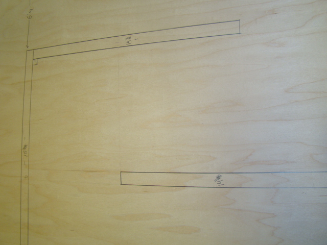

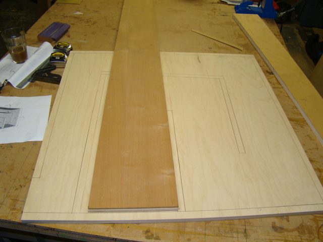

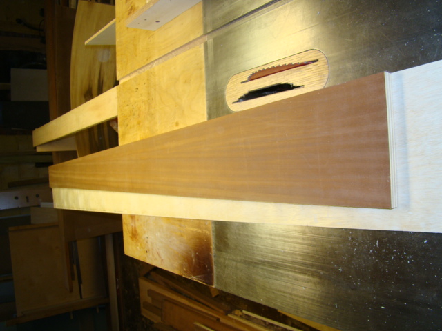

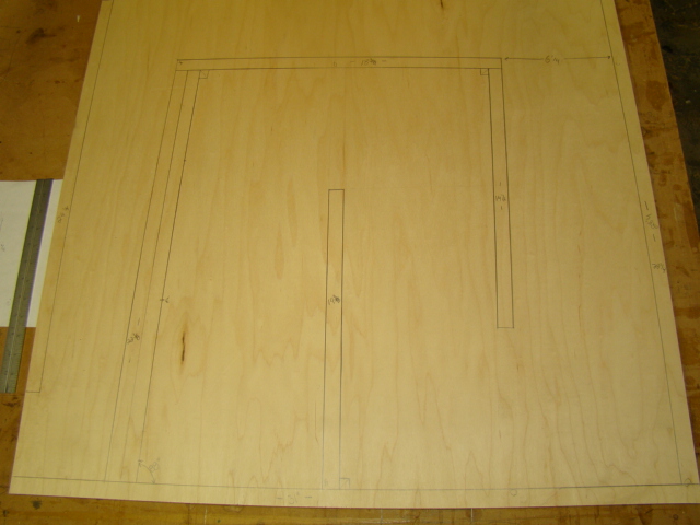

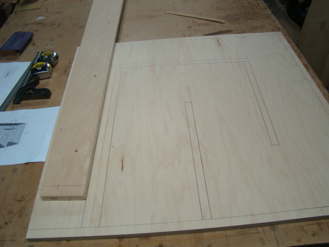

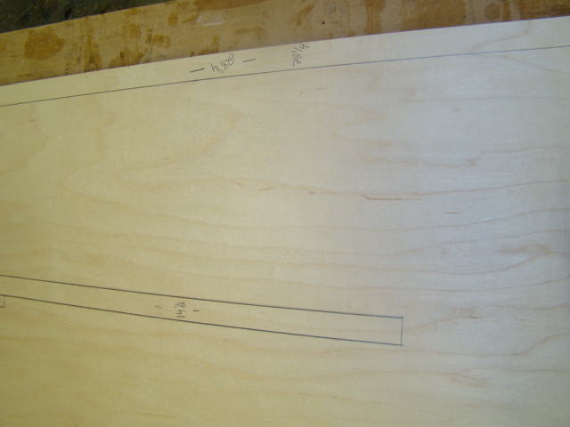

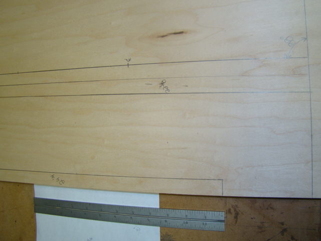

a few progress shots.
First I made a tapered piece of ply to use for layout and later for braces.
Next shots are of using the tapered piece to layout the sides.
and lastly the sides with some measurements written in.
Over all the sides are 29 3/4tall by 31deep The pieces that make up the horn are 16 3/4 wide.
I'll get some more done this evening.
Evan
Evan

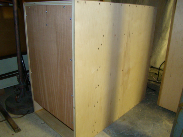

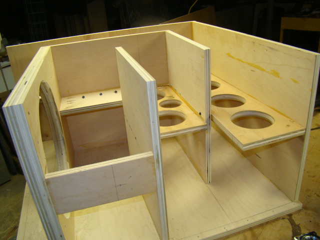

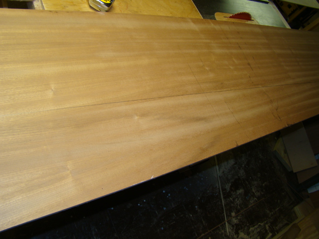

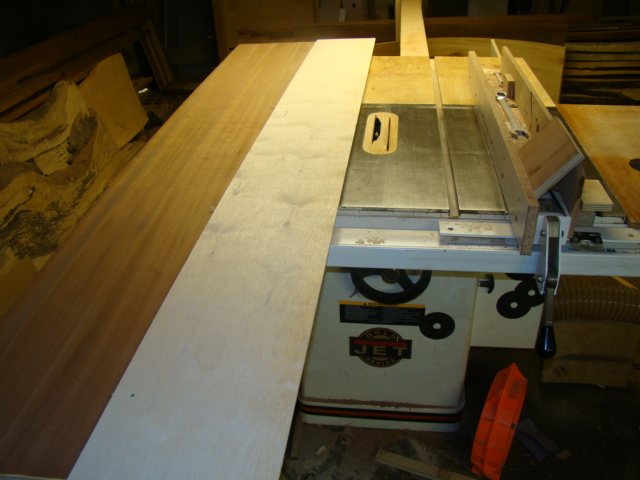

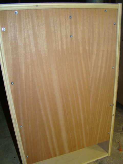

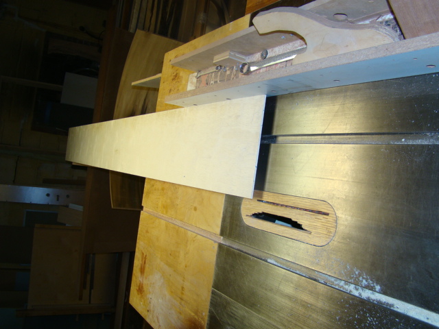

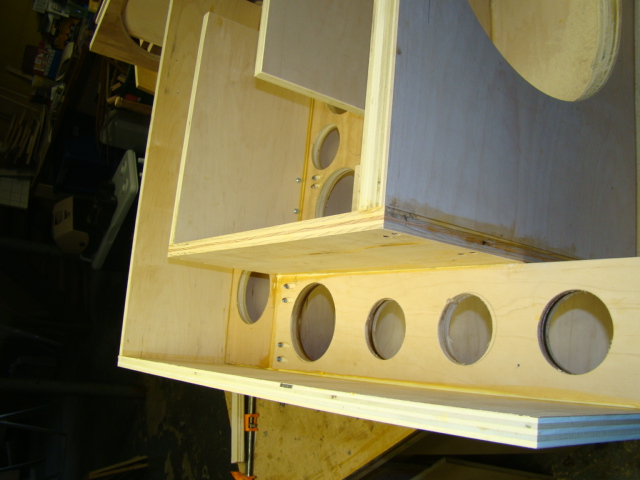

A couple shots of the bracing and the assembled box.
I tried it out hooked to one channel of a crown ce1000 (450w at 4ohm)
There is a little bit of chuffing. I hope this might be helped if I round the plywood at the exit of the horn. Otherwise it sounds good.
I'll try to get it outside over the weekend for some measurements.
I have all the parts cut for the second box so it shouldn't take too long to put together.
Thanks again to all, Evan

Construction looks great as expected.
You sure it is chuffing? Not motor noise? Have you tested the motor free air and listened for noise? Area of the opening looks decent...but maybe try cutting a spare piece of wood with a slightly larger opening and retesting each time to see if it goes away...while not negatively effecting output.
I have not tried the driver in free air. I will. Since the front panel is removable I am going to try rounding the edges and if needed a bigger outlet. I have a umik microphone from mini dsp so I can measure and see what is happening to the output. My daughter and I are going out for a surf and I'll play with "stereo stuff" later today.
Evan
Evan
Art has mentioned that a smaller mouth (on a tapped horn at least) will result in more LF, less upper. Larger is the opposite. So try it out and if there is no loss in LF, there ya go!
OK I decided since time was short today that I would just finish up one box and try it out...no measurements just listening. I rounded some edges and doubled up the removable front to reduce flex. Holy cow....just one of these at high volume makes me worried about the integrity of my house. Played at a reasonable level the sound is superb. Palpable Bass without being boomy. I will try to get outside for measurements for those interested but it's safe to say for the cost this driver is excellent.
Evan
Evan
Evan
