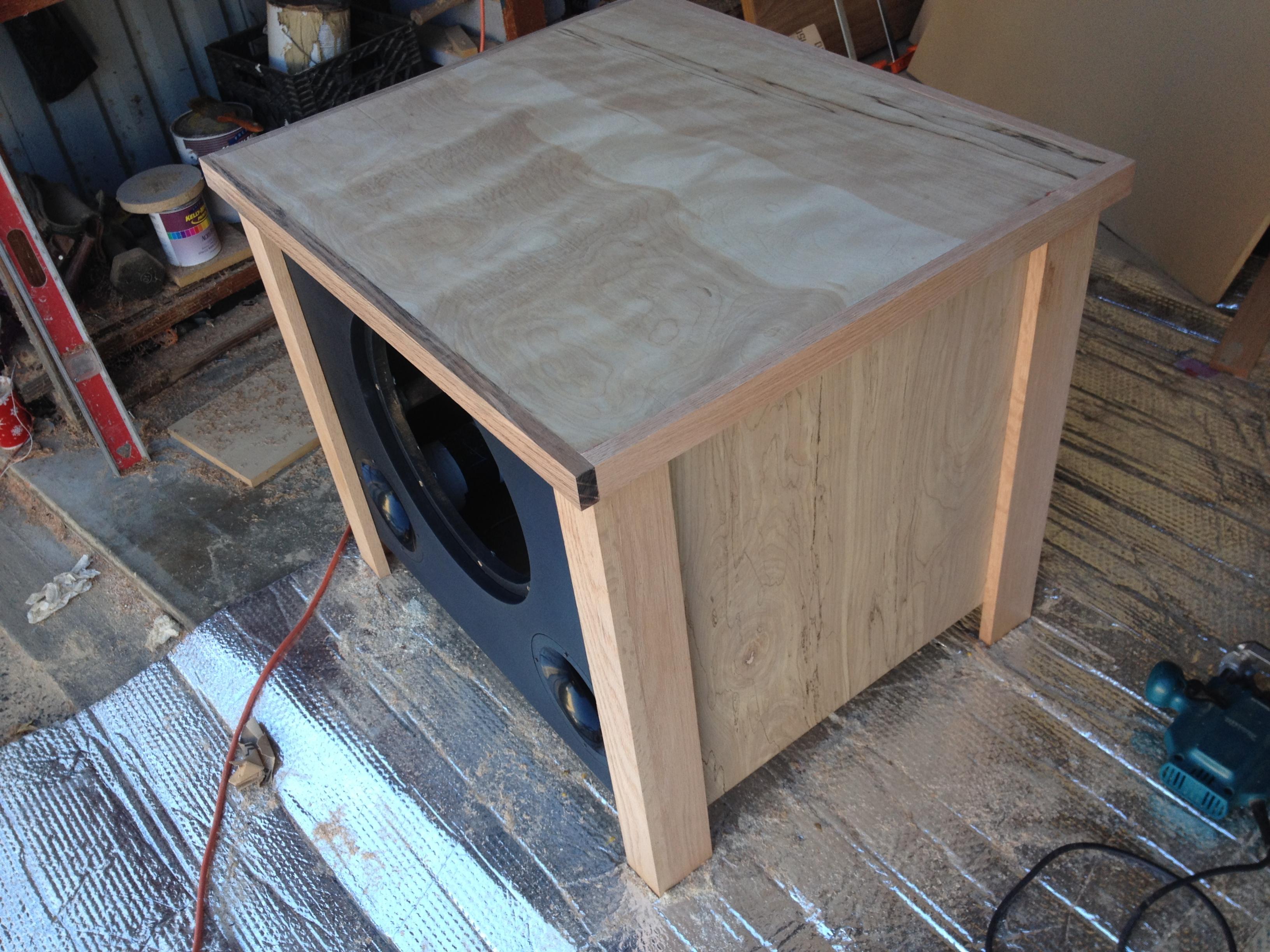

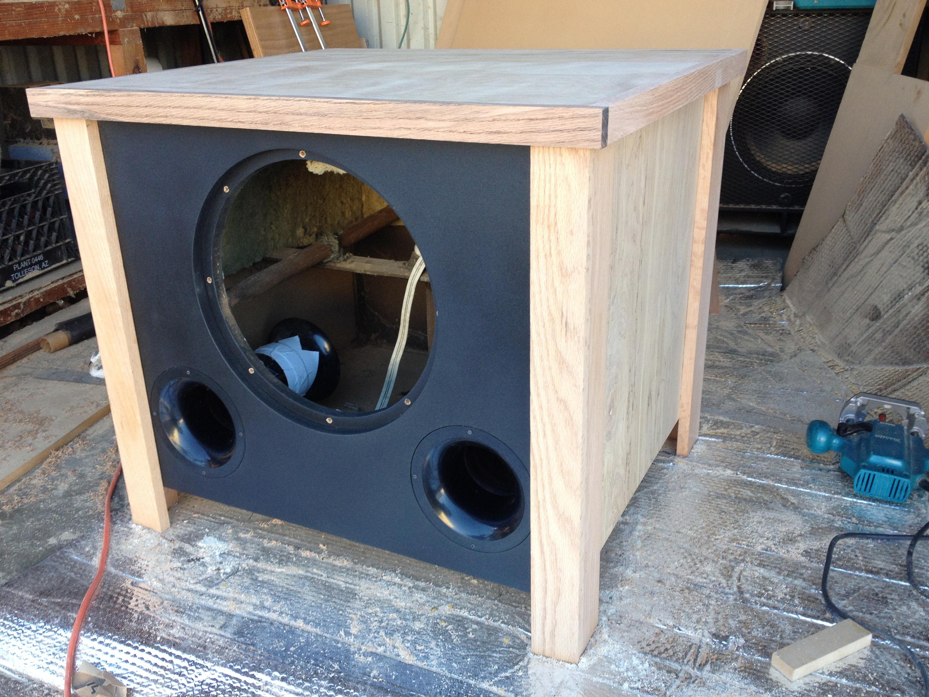

evan, this is good news! i should have had a finished box a bit ago, though i could still drop the driver in and test it out. what started as a simple box ended up turning into a piece of 'furniture', i.e., my first veneer job, and use of solid oak...and all i have is a router and a 20 year old skil saw...it's more of covering up mistakes atm, but something good may come of it all yet...

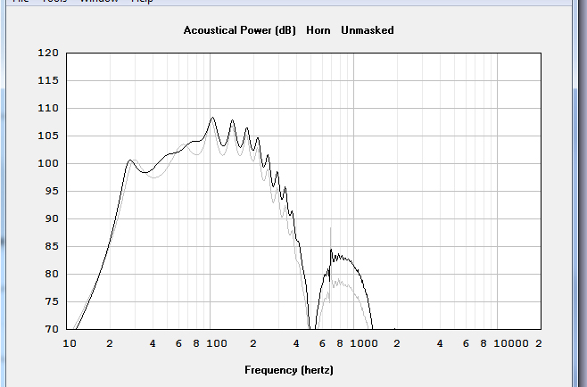

heres my estimation sim (advanced centerline). Grey is original lab15 in a 27" wide t60. black is the 4 ohm lab15. both shown 2.83v. the 4 ohm lab15 is much smoother overall (higher fs, lighter cone, less motor "ripple"). it does appear to be a bit less sensitive (slightly less overall output down low), but overall, I would rate the t60 pretty well suited for the 4 ohm lab15 (particularly if you increase rear chamber size up to about 90 liters, which is totally possible givin the nature of the design).
Is your top sensitivity graph shown for 2 cabs or 1?

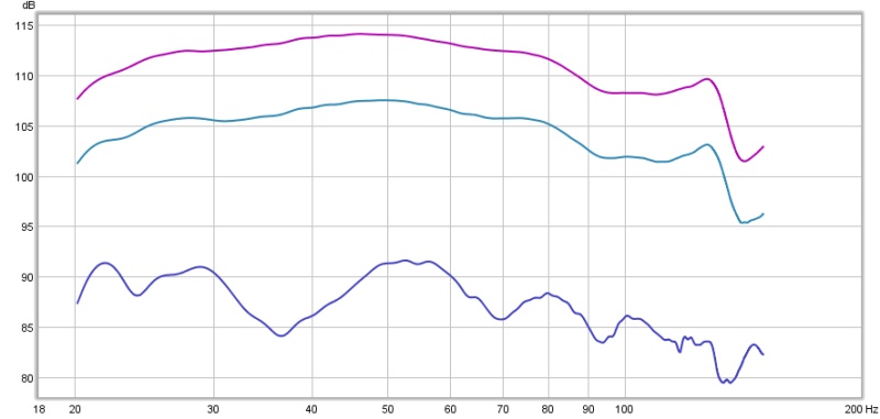

I measured one of the cabinets I built based on bjorno's design in post # 46. Please bear with me I'm new at the measuring thing. I used a umik1 from minidsp. Cabinet is outside. Purple and teal are close miked blue is about 2 meters away. No smoothing

Single cab at 2v, for a nominal power of 1w.Is your top sensitivity graph shown for 2 cabs or 1?
That's actually a surprisingly decent result in the T60. Better than I had expected. I might just save the hassle of designing my own horn and build it.
Mind posting or PMing me the hornresp record to play with a bit?
of course I'll pm shortly.

Honestly if that's fired into a corner, it won't ever show a sign of being a speaker. Good job!
thanks guys. i ended up rounding the top corners slightly (very sharp otherwise). the thing was too heavy for me to handle alone, so with the help of a co worker, got it home and a driver in. it produces a very muscular, clear present bass, neither flabby or boom-ish. still some tweaking with bass management, but very please atm.
