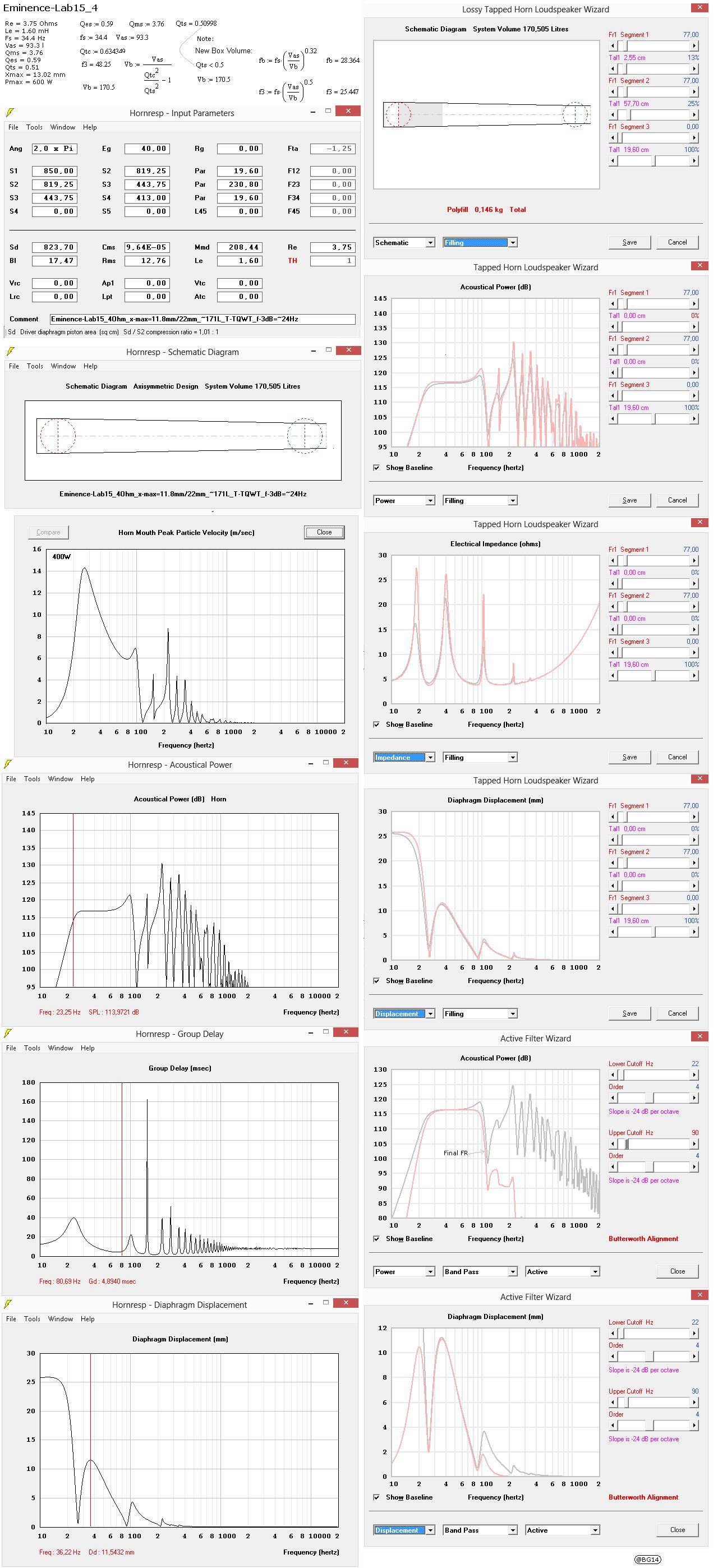

looking at that post, i don't know what you were trying to show. sorry. so the box is smaller than what winisd shows, or...? i don't need to plum the depths, so to speak, but a larger bass voice to match my simple maggie setup. after hearing that maggies in general are power hogs and not aggressive... i would have to disagree in my situation. i don't want 'loud', i want 'big'. i guess i'll try that big box ported option....I already posted a 27 Hz BR alignment that sims ~120 dB/m/600 W from ~25 Hz-up in half [2pi] space.
GM
I attached the Hornresp design for you/whoever to download to HR’s IMPORT file and open it in HR to view the design and if you don’t like it, then use the Loudspeaker Wizard to ‘slide’ your way to an alignment that you think will work better for you.
I don’t use WinISD, though I do use the Pro version since it’s more full featured and is more accurate in some ways.
Anyway, Its default reflex alignment is an extended bass alignment rather than the T/S max flat alignment most freeware programs use as a default and basically what I simmed in HR. As such, it calculates a larger cab tuned lower, which in turn reduces its peak power handling capability, but is a higher sound quality [SQ] alignment as reflexes go, so to the first approximation it’s the preferred one for your app.
If a steep 100-110 Hz XO is acceptable, then bjorno’s TTQWT would be better still.
