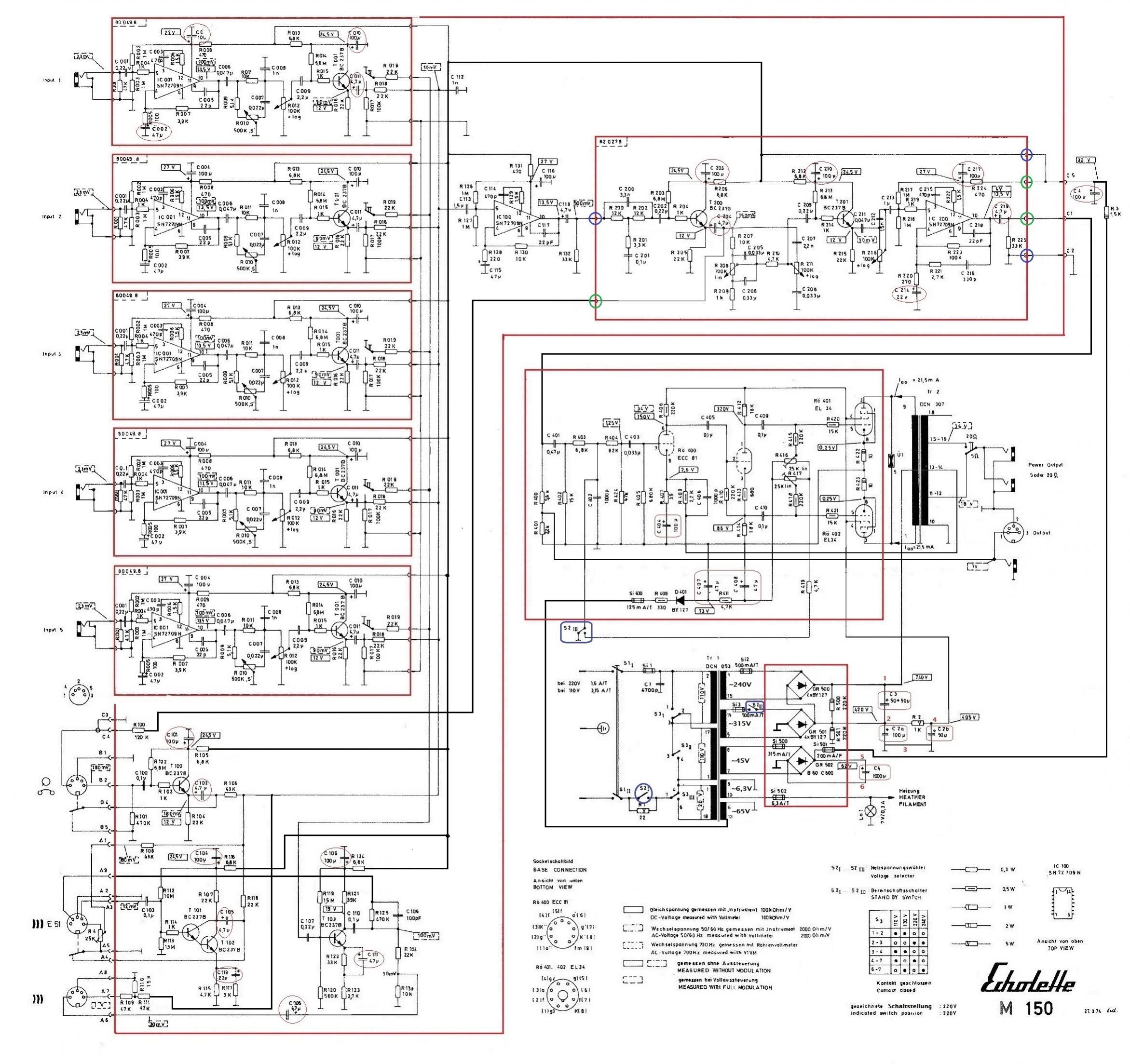

With EL34 you can also higher performance with a correspondingly high anode voltage. easier to buy as NOS tubes.
el34 is used in a lot of guitar amplifiers and with high anode voltages!
Snapper,
Looking at your attachment, have you seen anyone getting around 55 watts on the tubes you highlighted?
Thanks, James
I have a vintage echolette M150 at home, 80W sine, 110W music !
the table comes from this project:
KT 88, KT120 PP amp with the ATMega 48 on Board PCB + ATmega 48 | eBay
version without autobias:
El, 34 6L6, 6550, KT 66, KT 88, KT 99, KT 100, El 509, 5881-PP AMP PCB | eBay

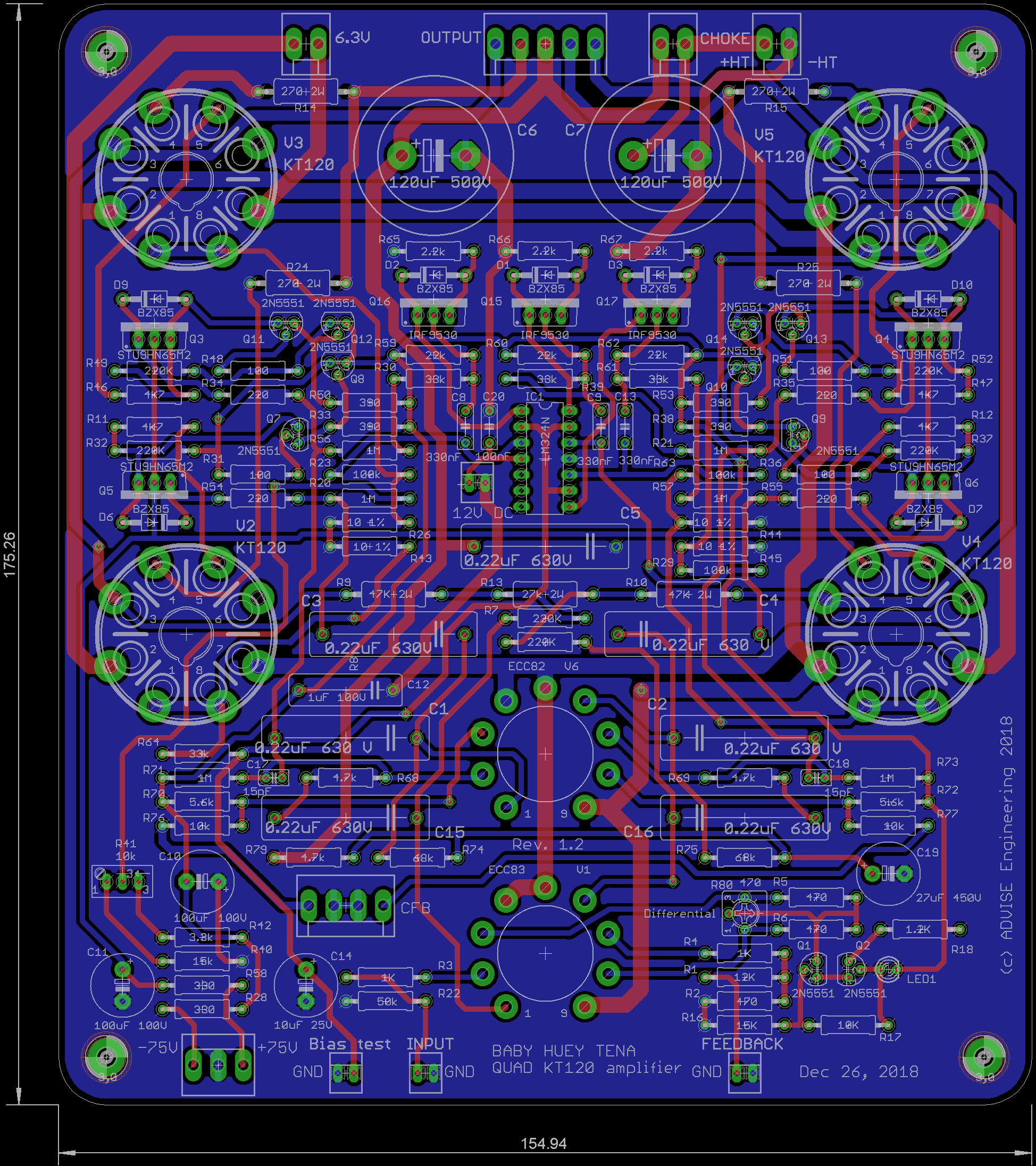

I remember the BH TENA presented here, which was unfortunately not developed to the end and, unfortunately, there was no pcb to buy
