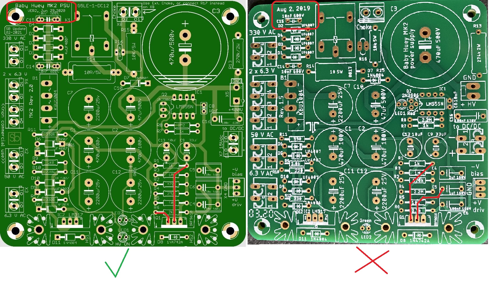

PSU:
If you have the corrected (MOSFET leads) PSU PCB Mk2 you are fine, else heed the fix discussed a few posts earlier here. Same for the values of R1, R2 and R6.

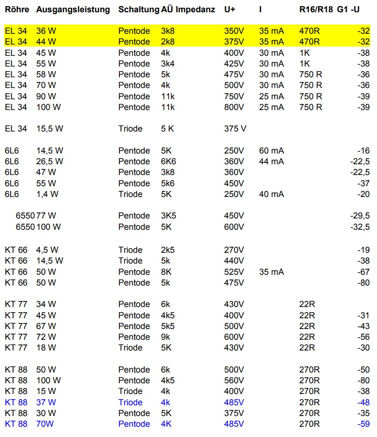

I am just looking for the highest wattage possible before anything starts clipping or producing any damage to the tubes.
Bfpca suggested not to chase power per se, but to keep an eye to the tone, and in his experience 400V gives less power but better tone than 450 or 500V.
If you are still interested in absolute power, higher voltages (or parallel another pair of tubes) is the easiest way.
Be aware that 550V and 630V PSU caps are more rare and expensive, and most probably won't fit in the standard board, so you'll need to arrange an off-board setup.
IIRC with KT88 and 500V B+ it is needed around 55V for bias, -150V and +50V for the driver and a 4 kOhm Raa transformer. Again, maximum power can be obtained if you reduce UL from 40 to something less.
But IMHO maximum power only, is not the best goal to chase.

With EL34 you can also higher performance with a correspondingly high anode voltage. easier to buy as NOS tubes.
el34 is used in a lot of guitar amplifiers and with high anode voltages!
Is it the Mk2 Rev 1.5-1 that needs the fix? The Mk2 Rev 2.0 is the fixed version? Trying to determine which one I have for sure, but I think it needs the “fix” Gingertube detailed.

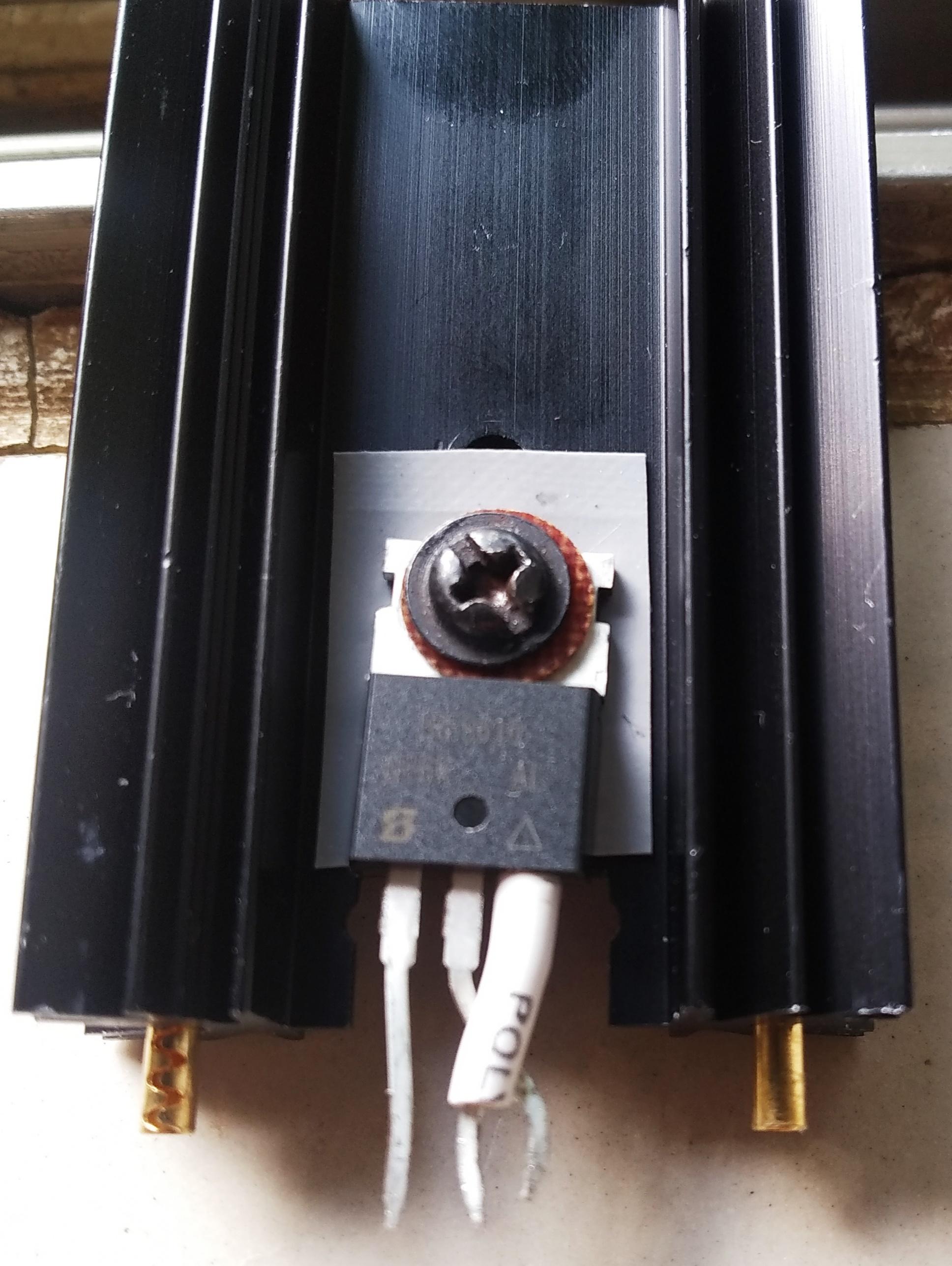

it is easier to turn gate and source on the mosfet,
https://www.diyaudio.com/forums/tubes-valves/351919-oh-baby-huey-el84-build-23.html#post6675749
