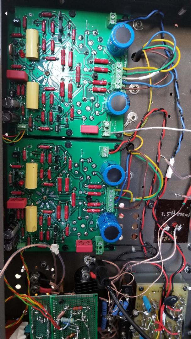

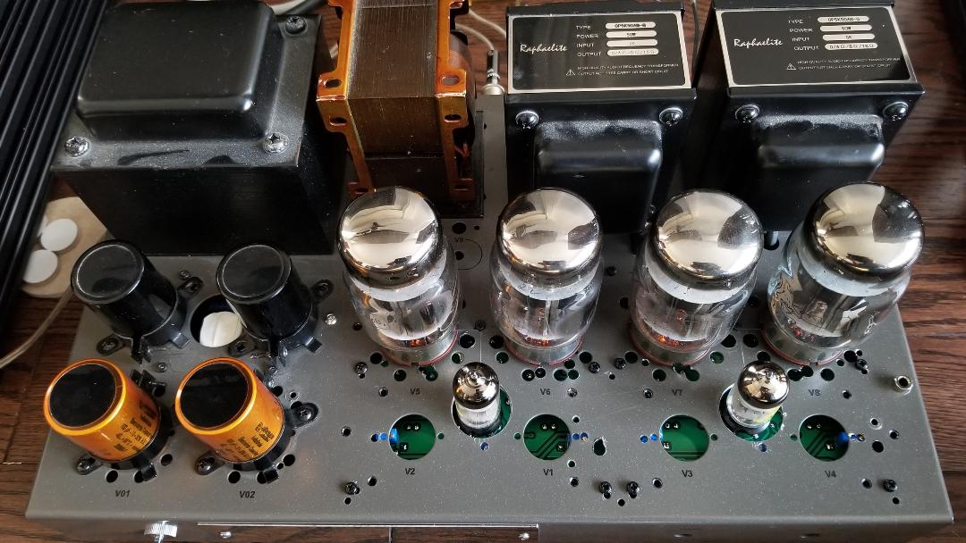

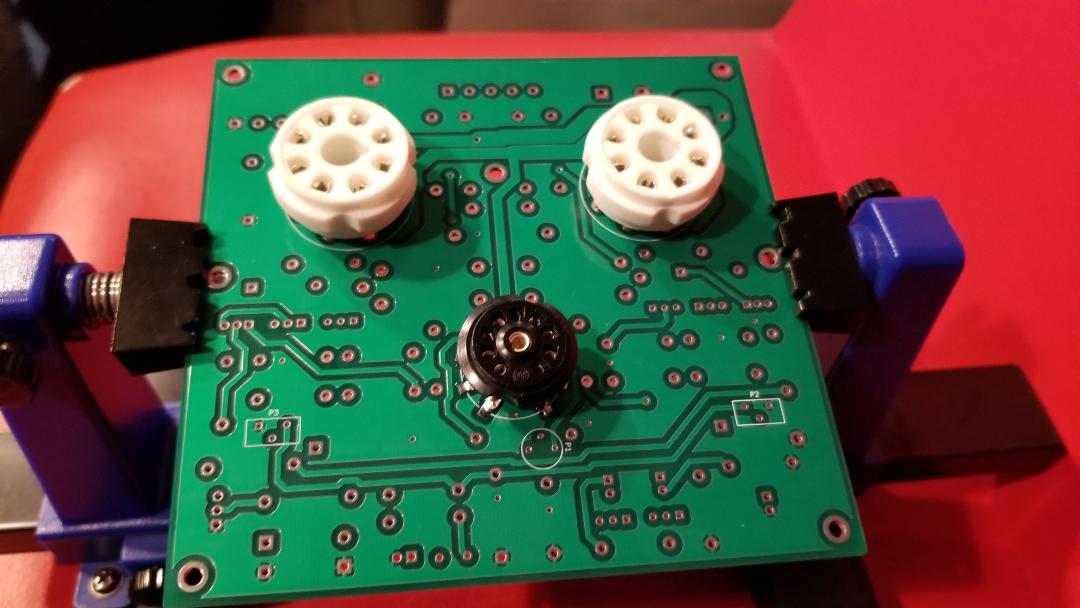

can you give us some feedback on how it sounds and how you set the amp for KT88?
I see you have 5k Raa, what is the voltage you used?
I would guess around 420V at 70mA idle, with around 55 Wrms per channel.
How do you changed other details?
Sockets seem quite close. Is the suggested 4 inch inter-socket respected?
Thanks!
Thanks!
zintolo,
Your guess is very accurate. H+ is 425V, Ia 70mA. But I will increase a little bit higher.
I use an existing chassis and socket layout for the same tube under higher H+ and larger Ia. The distance between the tube is 65mm.
Another mod is the two MJE340 instead of 2N5551 so I can use larger current for driver. The current is 3.5mA.
I don't use H+ on delay. So I modified -Vbias circuit to make sure it gets full -Vbias before the tubes are heated up.

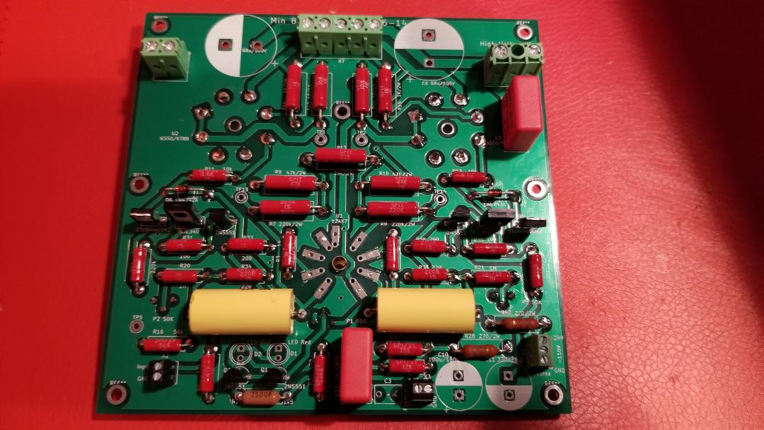

Hi Zintolo
How did you go about fitting the MJE340 transistors to the PCB, the pin spacing is quite different?

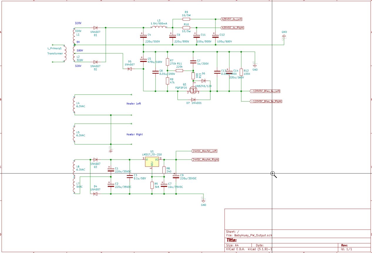

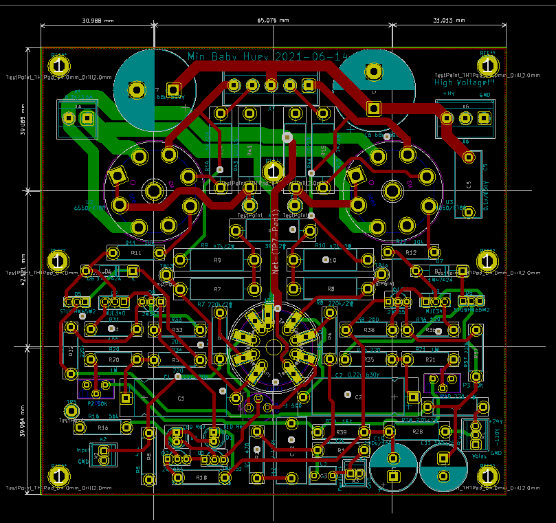

I'm ordering the transformers from Toroidy for a 6550 or KT88 amp.
460V B+, -140 to +50V for the drivers
4kRaa with 23% UL taps (it simulates very similar to my EL84 version in terms of harmonic ratios).
Q1, Q7 and Q9 substitued with MJE340 that have a safer Vce of 300V ( 404 - File or directory not found. ).
C1, C2 and C5 now rated at 630V
C6 and C7 offboard with multiple 220uF 500V
C10 now rated at 200V, C11 is ok like that.
Hi Dagwood,
mount them on the opposite side of the tubes, insulating pins to safely cross them.
This question aside, most probably during the winter I will try how a cascoded version of the driver will sound. This could be an upgraded version (with proper spacing for KT88 as well) of this project.
But before that, I want to try the PP version of the unset with shunt cascode driver.
Hi Zintolo
Yes, plan to mount all but the tubes and the bias pots on the top, all other parts on the underside. Ok I pulled the datasheets and the 2N5551 is EBC whereas the MJE340 is ECB, so you suggest to extend, insulate and reform the pins to EBC format?
Thanks again
Thanks again
In most cases with most tubes it is not needed to switch to MJE340, so before doing it just consider if you exceed the Vce or it is needed to have more current for any reason.
With EL34 or KT77 it is not needed, with KT88 at that voltage (bias should be around -47V), working in AB1, you need around -140V on the negative side and +40 on the positive side, so yes, the top 2N5551 on powerdriver should be substitued with something beefier, but not strictly the MJE340 (I used them because I had them). A TO92 with an higher Vce can be used.
Let's also be clear, it's not totally necessary to substitute them to support KT88s. Maybe it's better, but it's not required.

It depends on how you set the amp.
At 420V B+ with a plate dissipation of 35 W, KT88s' grids swing from -100V to few volts above O. That means that it should be better to have -120V and +40V that is on the limit of 2N5551.

Yes, with KT88s I'd always use another BJT for the top of the CCS for the reasons explained above, but it is not mandatory to do so.
Back on mods, with B+ in the 420-450V range I've experimented two solutions for the PI:
- 220k plate load and CCS set just over 1.4mA
- 270k plate load and CCS set just below 1.3mA
The latter has more gain and keeps the tube out of the grid current area.

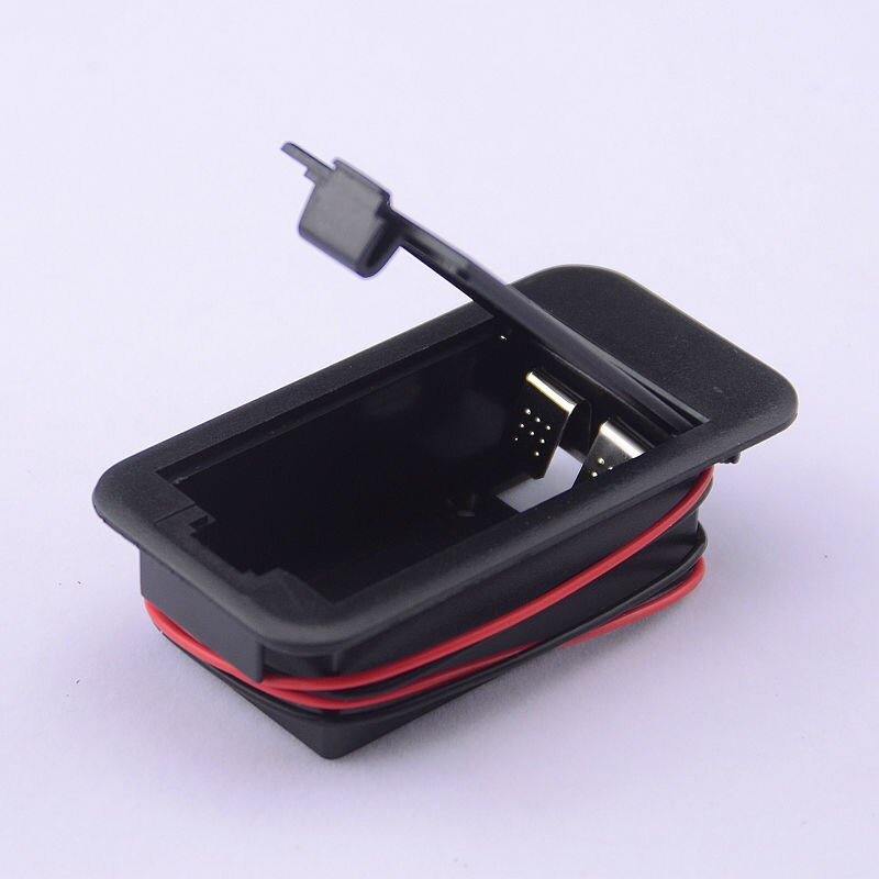

My current BH build is stock EL34 monoblocs with a few of Ian's (gingertube) tweaks. I've used a 9v battery to power the bias LCD so just waiting on the holder to arrive and I'm done
Idh Flat Mount 9V Electric Guitar Bass Battery Case Box Holder Cover Black-buy at a low prices on Joom e-commerce platform
Cheers

I'm very slowly proceeding in designing the pcb for the hybrid cascoded BH, including the power supply on the pcb as in the first run of the BHEL34 (with bigger caps), and separate positive and negative supply of the powerdrive to easily allow different voltages (in module). This will allow to run big tubes even in AB2 with less than 1.5Vrms at its input.
I will post updates when available.
