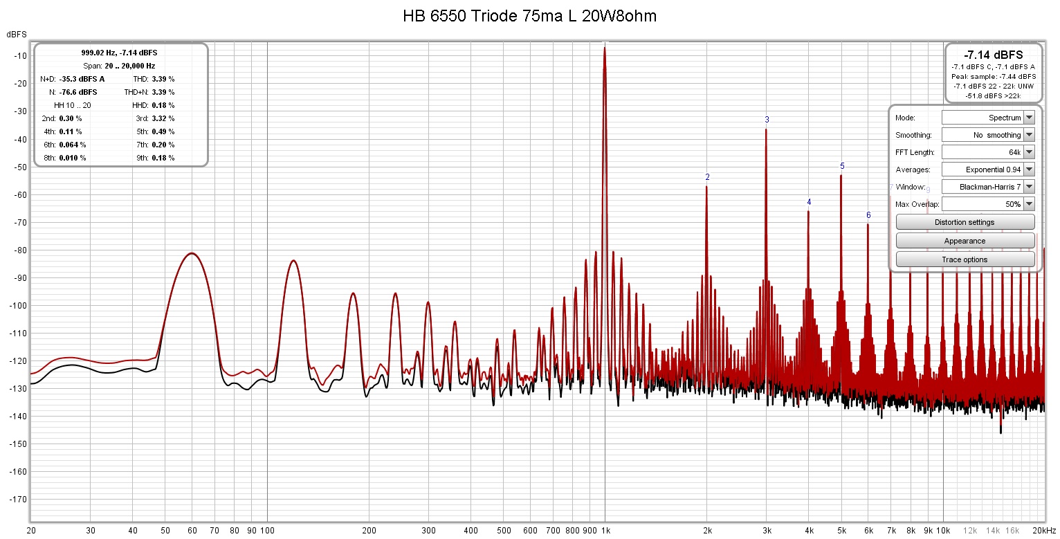

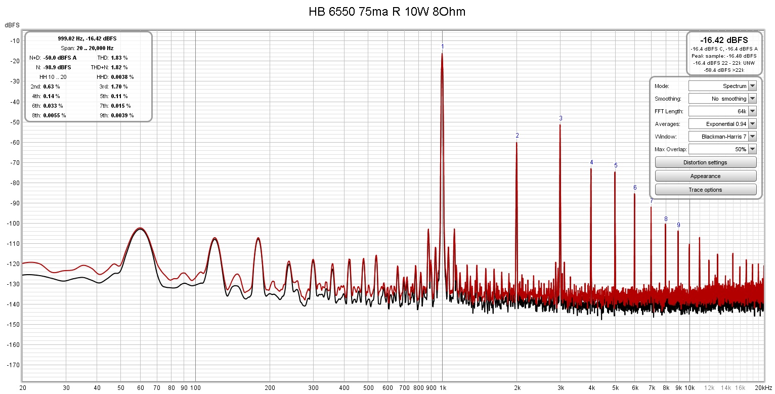

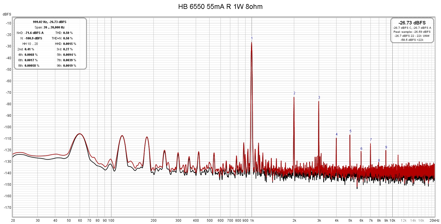

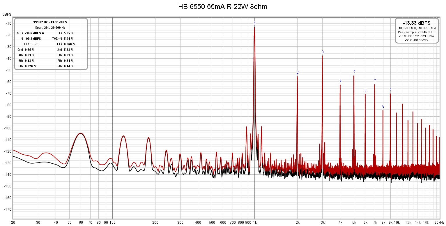

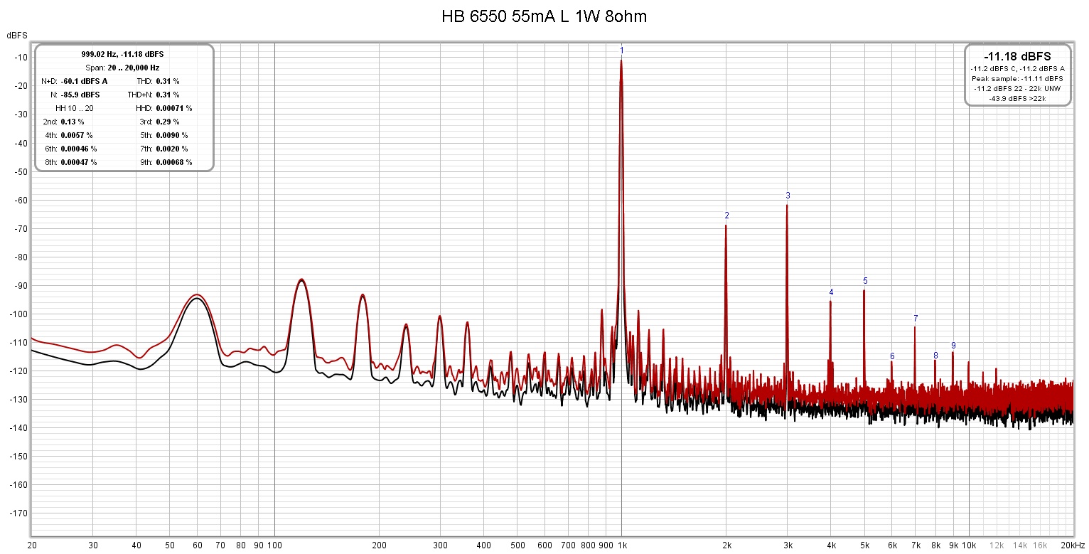

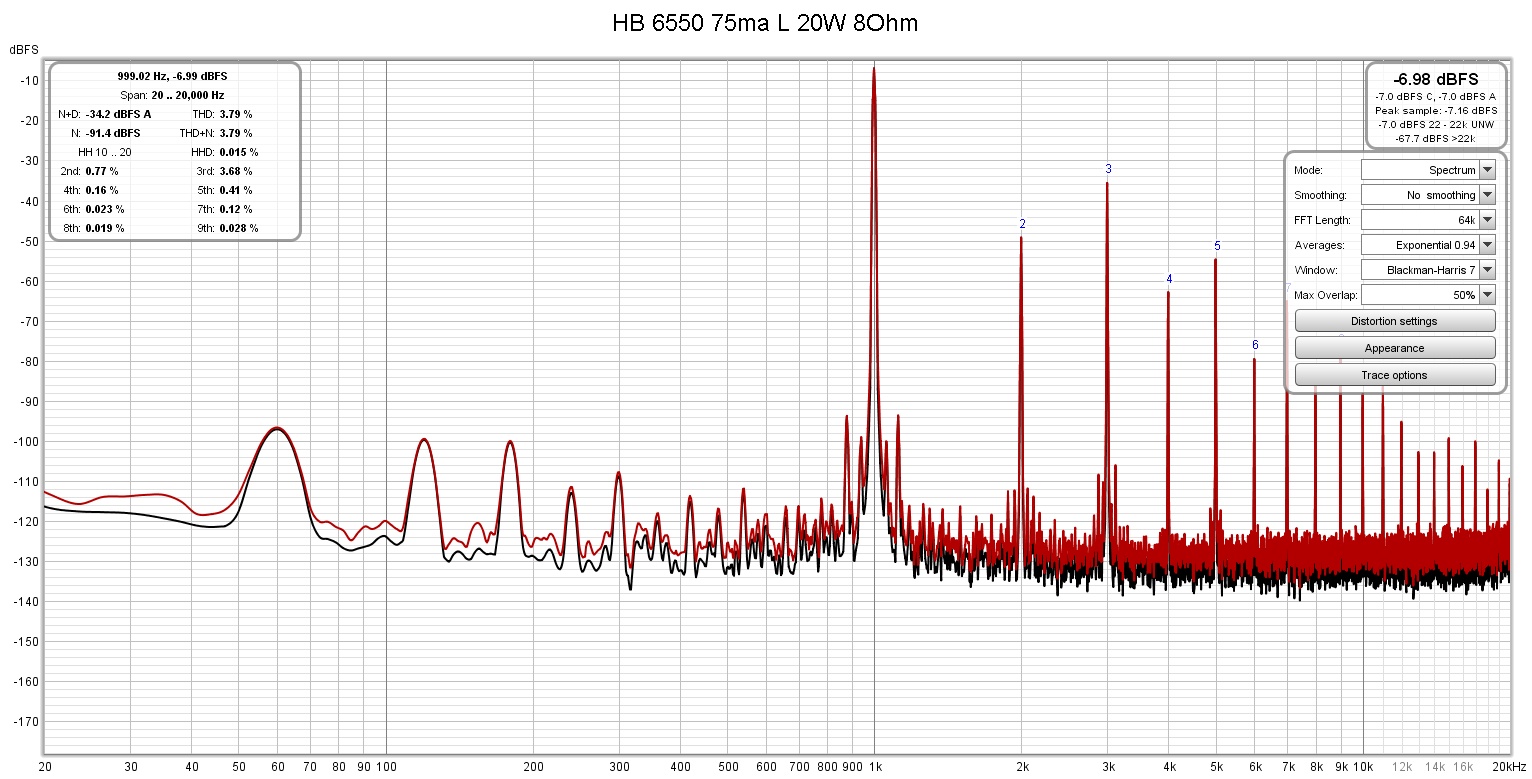

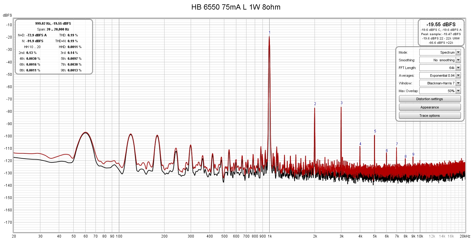

Some measurement of BH 6550 at 1W and 22W
Tube 6550 Winged C, 55mA Ia 425V B+. The gain is about x7.
the THD+N is large at 22W.
Also I noticed, if Ia increases to 65mA, it starts Oscillation.
Hi wwwtttwww,
this is absolutely not normal, you should get that THD above twice that power.
Is it happening on both channels? Are TP3 and TP4 in the right range?
Also the 7x gain is quite low, you should have almost twice that.

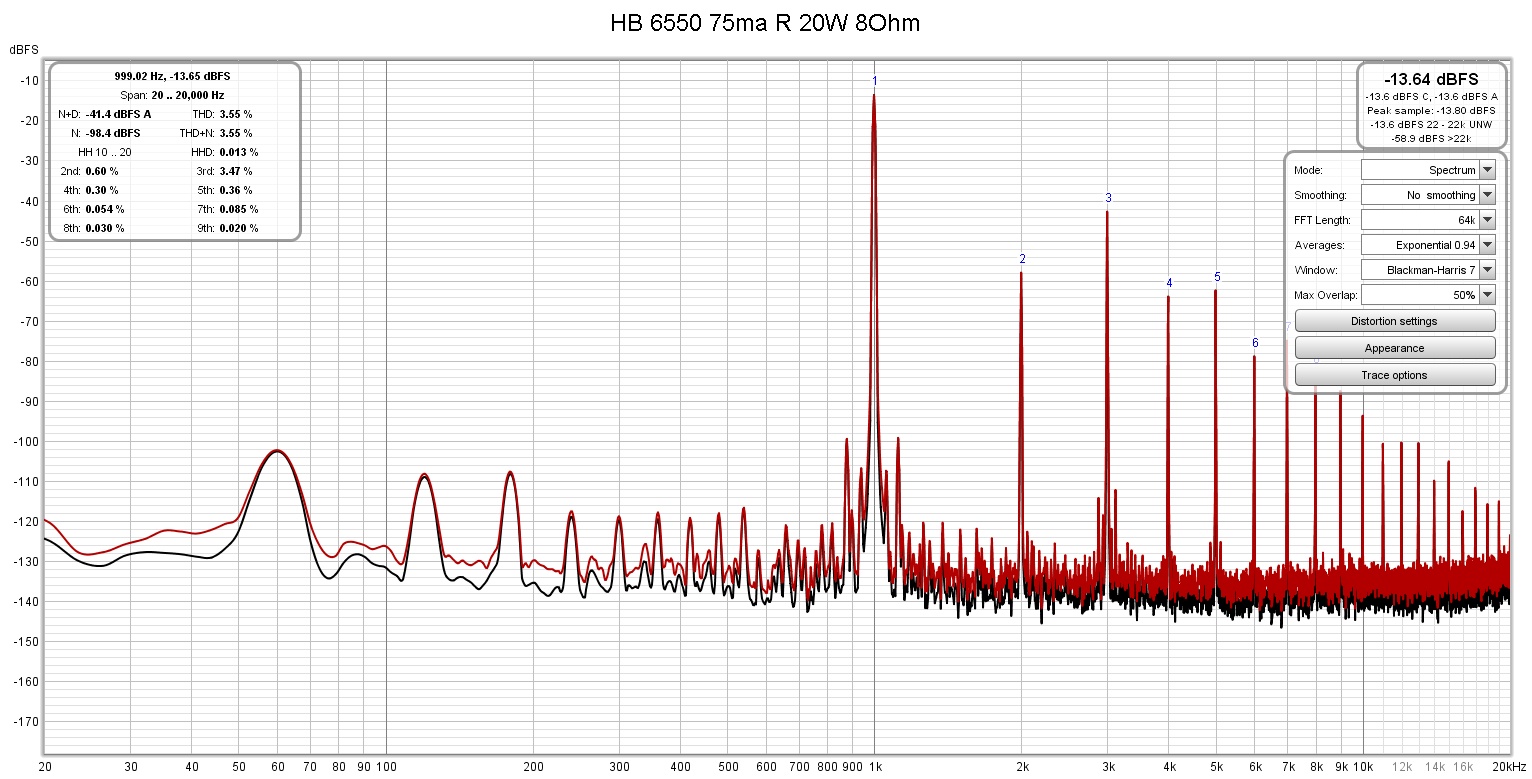

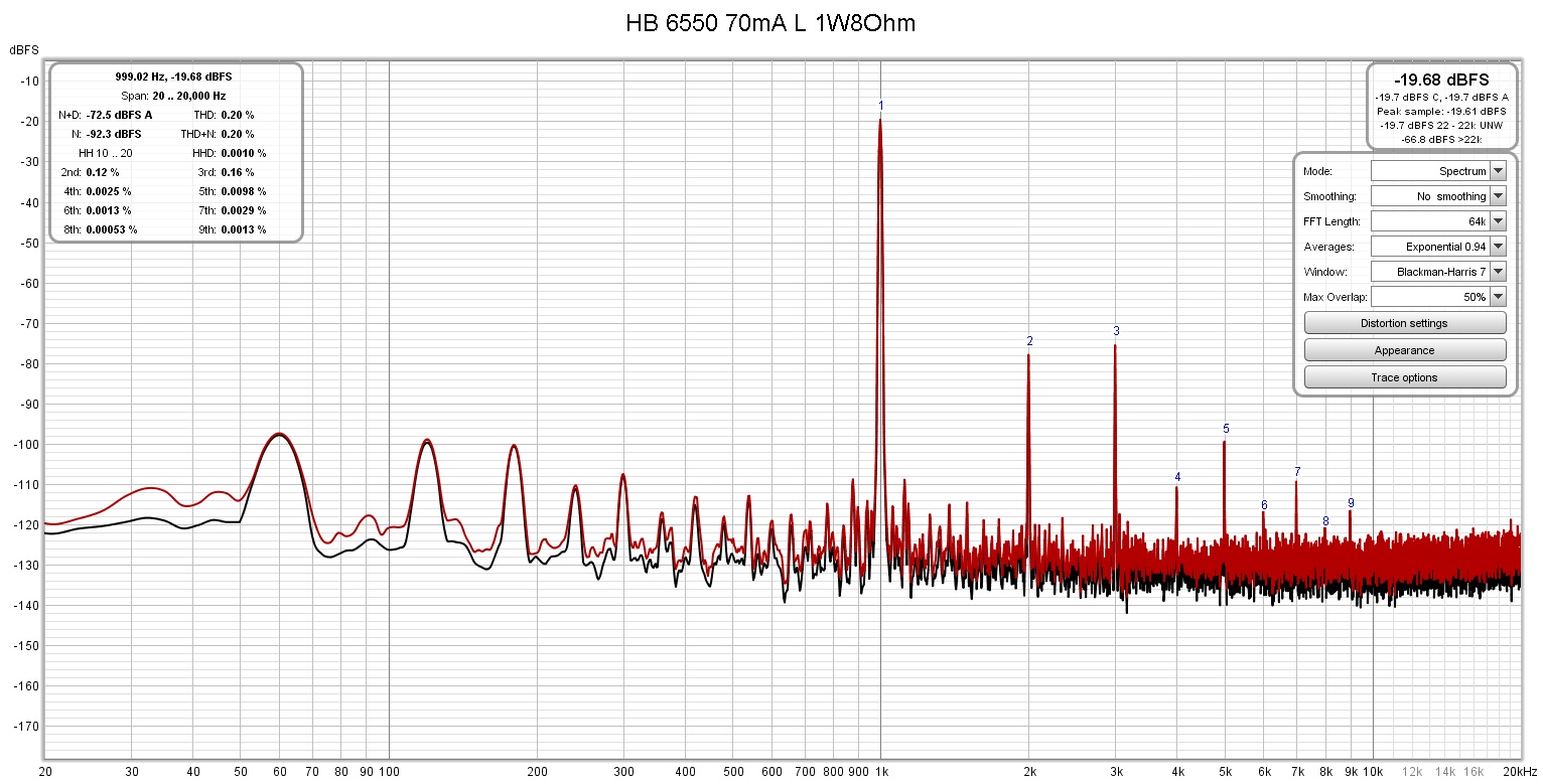

In the test, when Ia increases to 75mA, the amp has the lowest THD+N, and sounds better than 55mA. With 8 ohms 50W resistor for measuring, there is no oscillation when Ia from 55mA to 75mA. But when speaker is connected, it starts to oscillate when Ia>65mA. The oscillation is audible like few khz.

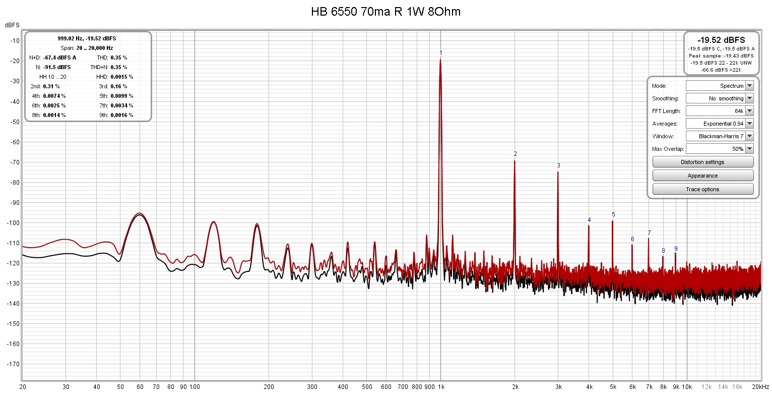

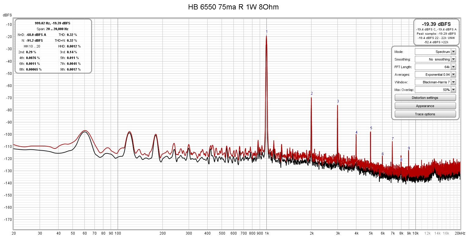

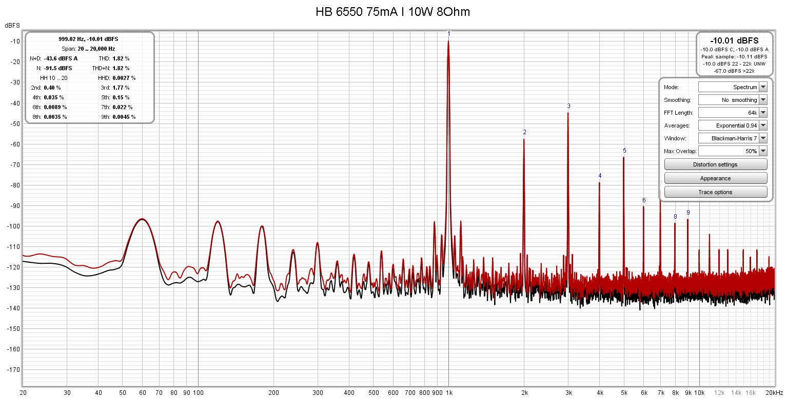

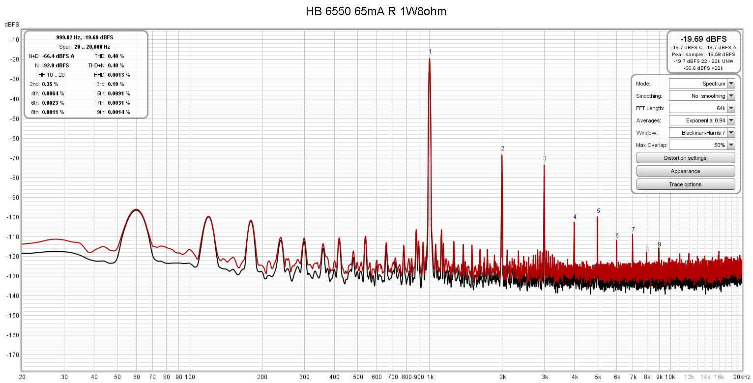

more measurements R channel
measured with resistor. no oscillation.

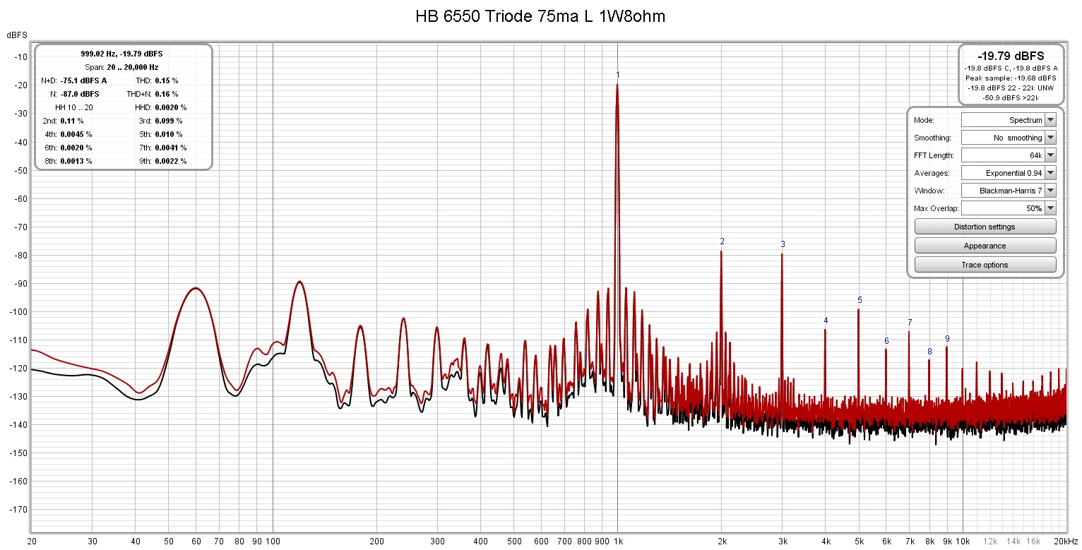

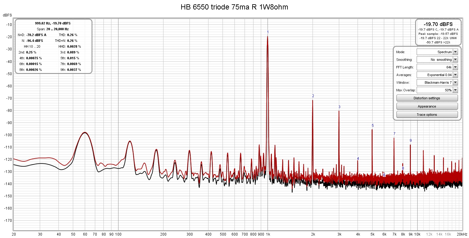

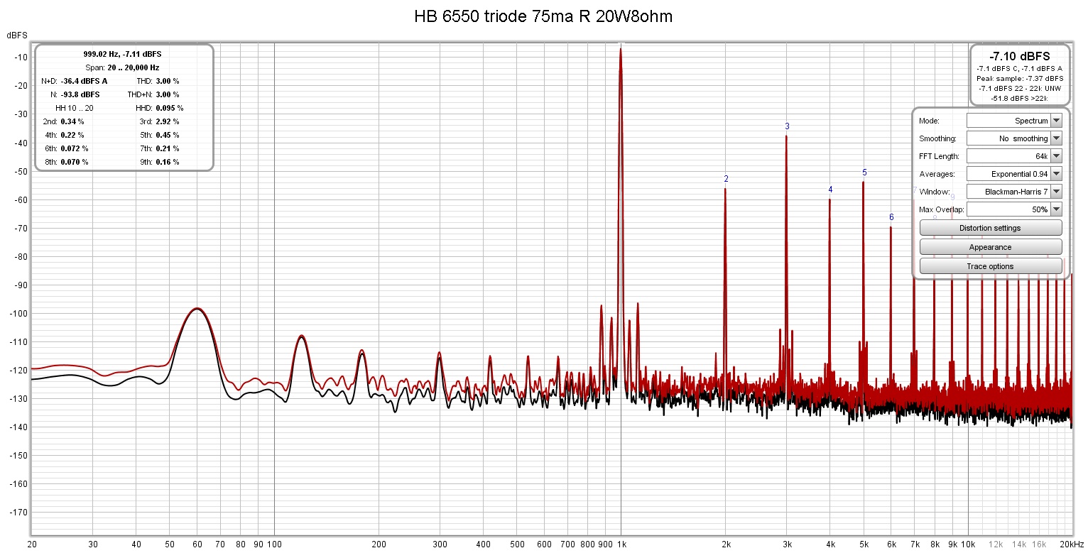

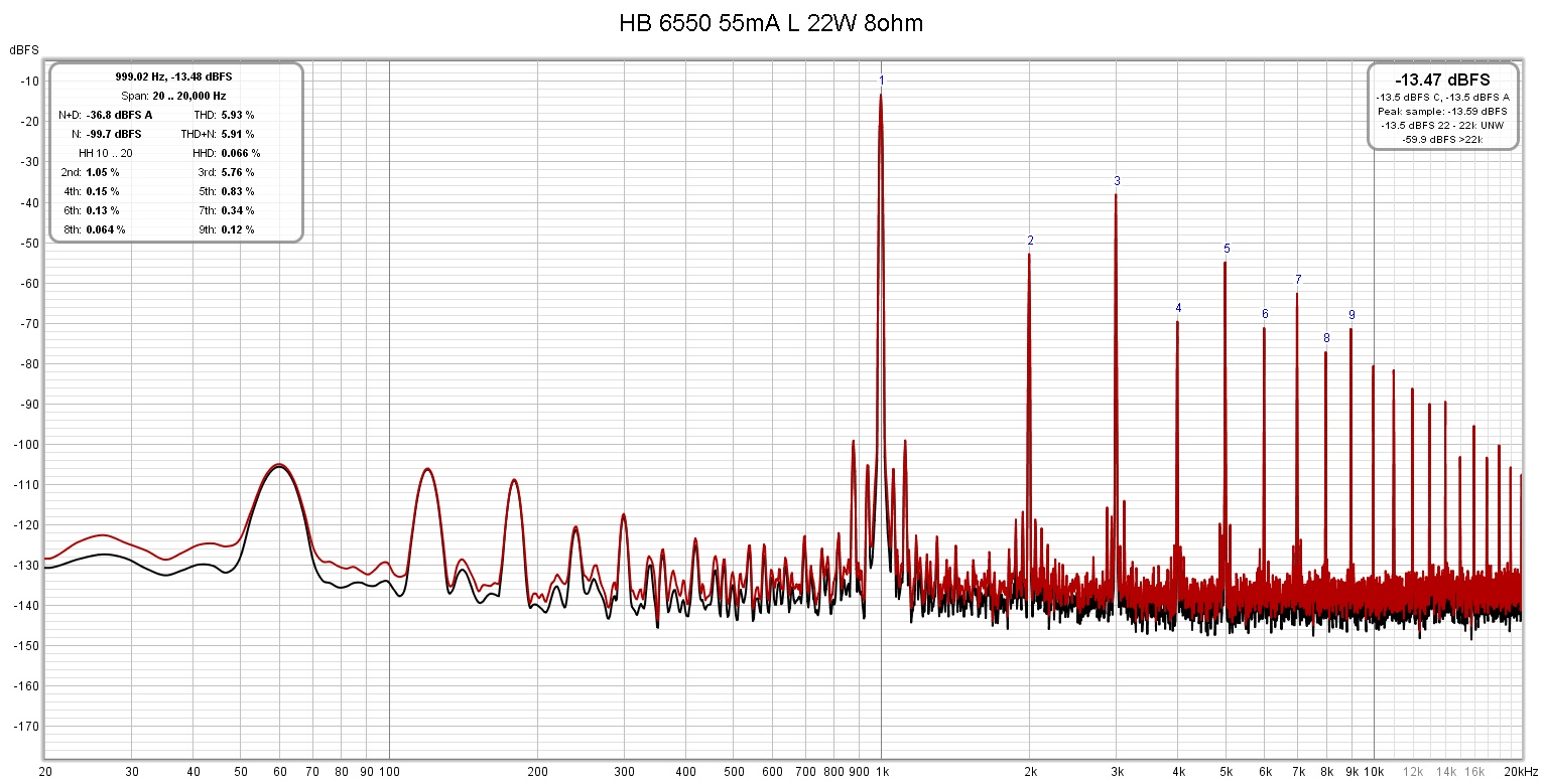

Baby Hue with 6550 triode mode
Changed the BH 6550 from Ultra linear to triode mode.
I found the triode mode has much better anti-oscillation capability.
All high frequency oscillation around 30khz-50khz is gone.
But something looks wrong with the left channel.
that is called "funny business", did you try screen grid stoppers, say 470 ohms in ultra linear mode?
Hi wwwtttwww,
It seems to me that something is not correct, because you should get better distortion figures. Have you double checked everything? Would you report your voltages on different parts of the circuit to compare them with others?
Hello Zintolo,
6550 B+ 425V, the voltage cross R43 and R44, 0.75V
Both 12AX7 B+ 208V,.
I looked thru the whole thread. Very few people posted THD+N pictures.
The number is little bit too high.
I am not too sure about the quality of my current OP transformers and ordered a pair edcor ones. But it may take months to come.
B+ at 425 V and 12AX7 at 208 V means 217 V across 267 kOhm so 0.813 mA each, so 12AX7 cathodes at around 1.8 V, that means you have around 0.9 Vp before grid current occurs, so (depending on the feedback you set) around 50 Vp of swing at 6550's g1.
I'd try to reduce the current through the 12AX7 at 0.7 or even 0.65 mA first.
Then I'd try also pentode configuration for the 6550s, trying screens at voltages between 250 and 300 to find the point where you like it most. A bit of gnfb could be needed together with local feedback.
