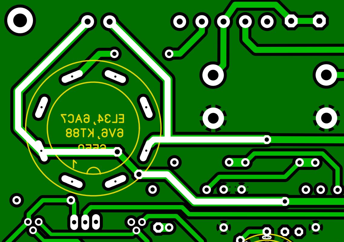

Hi all,
A while back I started working on an "Engineer's Baby Huey" - taking the BH design and trying my best to simplify the BoM and also adopting some of Pete Millett's techniques that he applied in his Engineer's Amplifier / DCPP.
Having built a DCPP (in daily use) I was keen to make something that used valves that would be available in 10/20 years' time - I've struggled to get the valves the DCPP uses here in the UK.
Seeing some of the recent discussion, I thought I'd share the below link:
amps/HiFi-BabyHuey at master * tristancollins/amps * GitHub
It's very much a WiP - still to do the layout properly and undecided on certain aspects of the circuit. It'll be my summer project. Schematic attached.

Tristan,
Did a quick once over. Looks good.
The shunt feedback set resistors R323, R423 are 18K in my amp (with KT77s). Fairly sure 39K is too big, as you increase that resistor the amp does clean up a bit but starts sounding "dry" and solid state'ish. It also throws extra demands on the diff amp front end and sound is likely to be more determined by the front end than by the output tubes.
In the EL84 version I ran 16K for these resistors and for the 6V6 version with 39K resistors from the output tube anodes (instead of 47K) I used 13K

Hi Ian, what a pleasure to read your interventions once in a while.
EL34 standard feedback resistor as per BOM and PCB is 39k.
I've done some tests and 39k is very clean but I feel it's too much.
I like it around 22k, or 33k for some harder music genres. 39k gave me a strange harshness on top when pushed, that I supposed (not measured) it was due to the driver. For sure has a better Zout.
KT77 have better curves on UL than EL34, so a lower value is possible (and preferrable). I still prefer the tone of the EL84 in this BH configuration, with 8k load and 23% UL taps. I haven't tried them with KT77, but I will do it with russians 6V6 shortly.

Thanks Ian. Noted. I'm tempted to use (shock, horror) a couple of turrets as the footprint for this component to allow "select on test" without lifted pads / easier soldering etc. That or a bit of free-style point-to-point from resistor-lead-clippings-as-temporary-turrets.Tristan,

My transformers have arrived from Primary Windings and Toroidy, so just layout and a PCBway order to go. Heater current requirements may require a 2oz copper order and wide traces for certain areas.
Tristan
tristanc: Heater current requirements may require a 2oz copper order and wide traces for certain areas.
Hello
70u instead of 35u makes the board significantly more expensive, at JLC e.g. 10 times the normal price. it is also not possible to implement only certain tracks in 70u. When laying out, I remove the solder mask where it is necessary so that you can apply additional tinning, if necessary, solder an additional wire. in places where it is possible, you can also arrange the tracks on both sides of the board.
Hello
