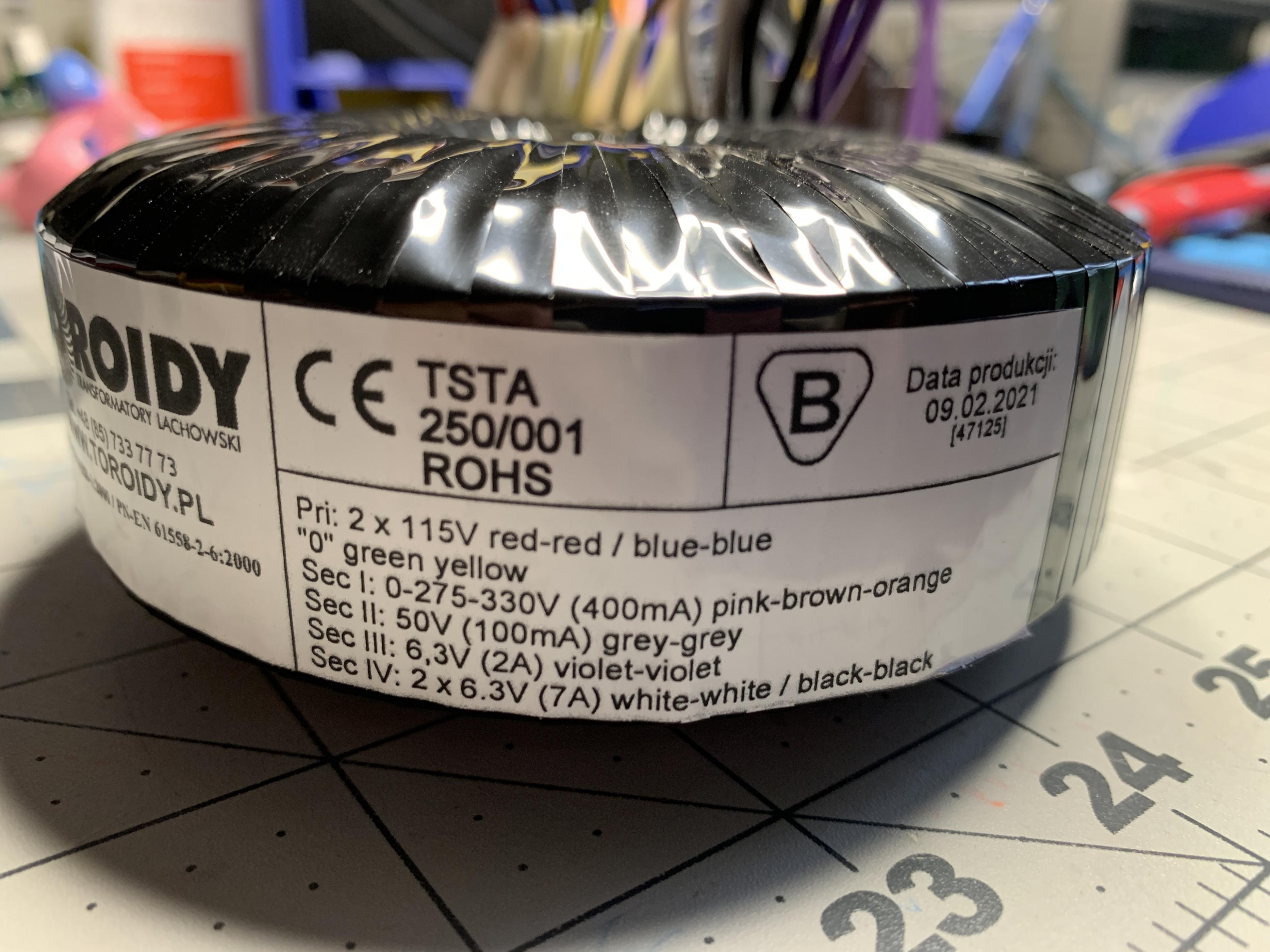

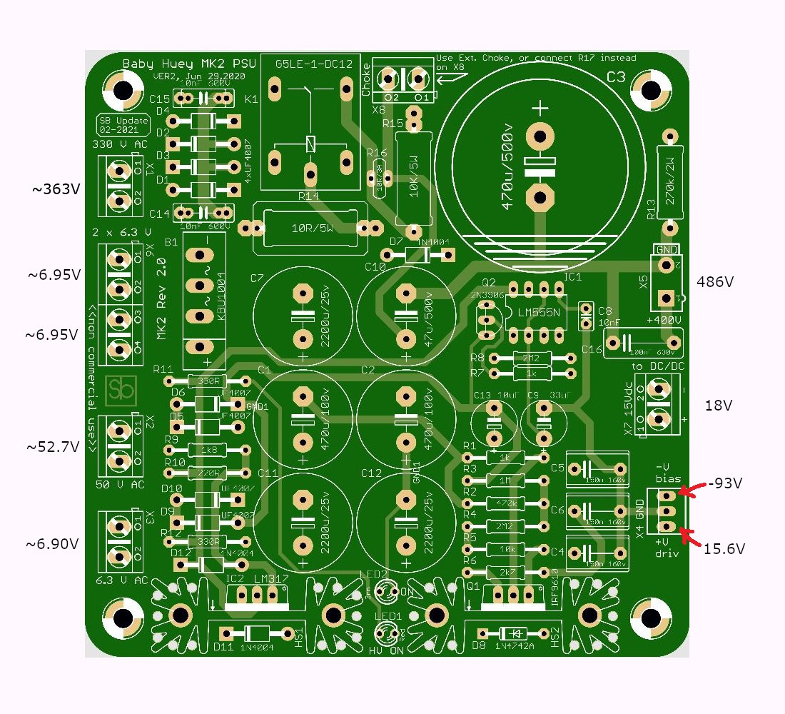

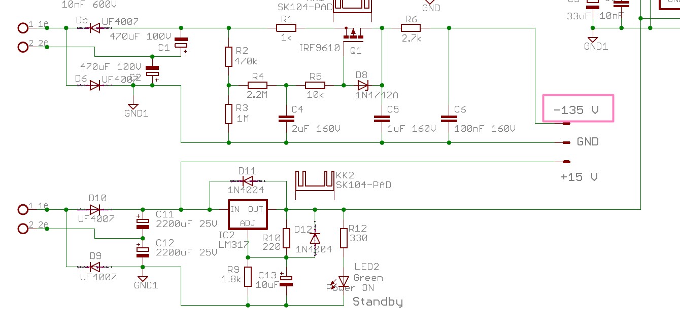

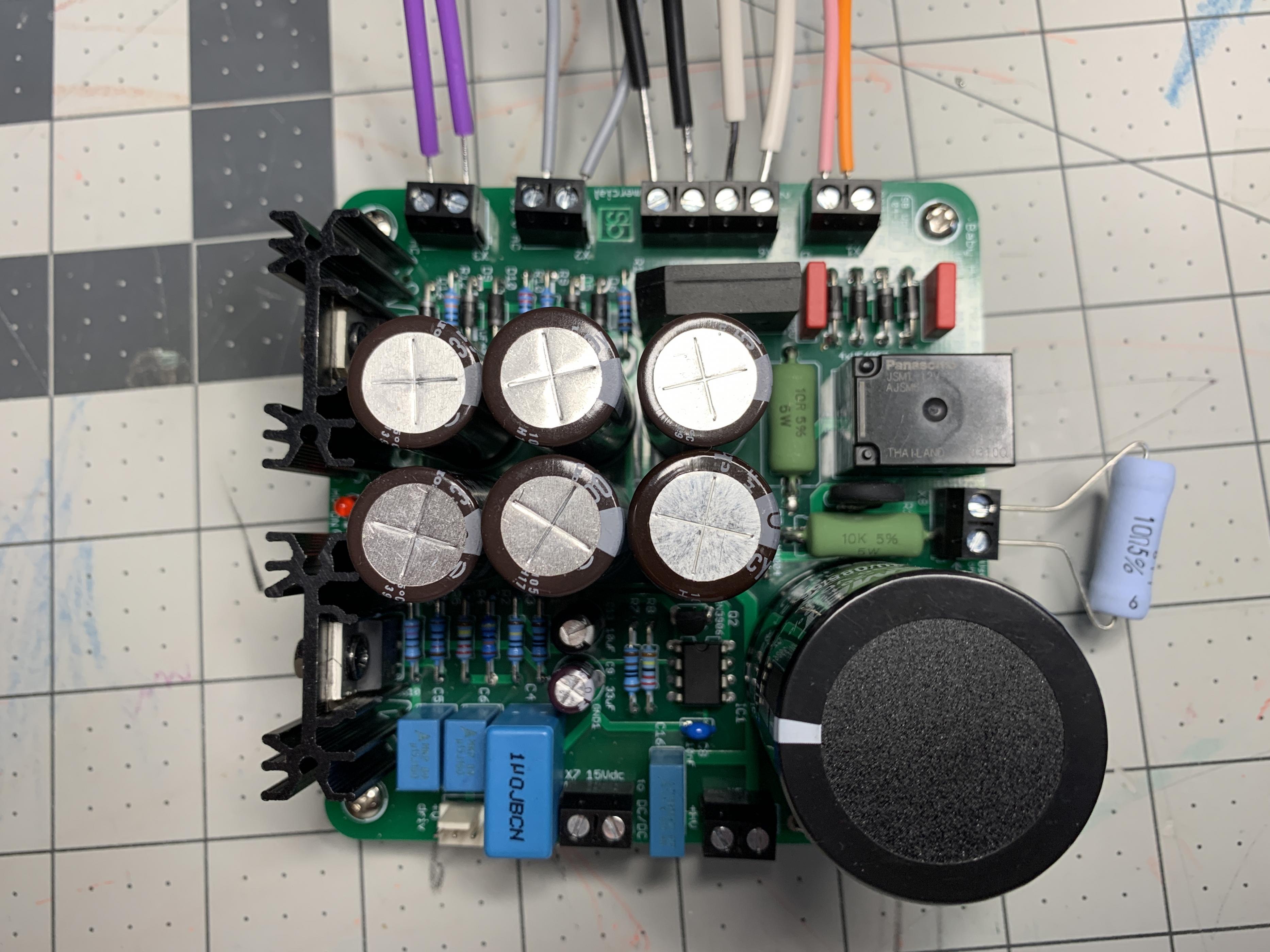

I am building the EL34/12AX7. Just finished building and powered up the PSU (Power Supply MK2, Rev2.0).
Line Voltage: ~119V
Transformer: TOROIDY TSTA 250/001
No load voltages are below in the picture. A few questions :
Line Voltage: ~119V
- The HV voltage seems a bit high at 486V.
- The -bias voltage is -93V , The schematic I have seems to indicate this should be -135V
- Do the overall voltages look good to connect to the Amp boards? Is there a better way to test the voltages.
- I hope the transformer hookup is fine.
Line Voltage: ~119V
Use the Pink-Brown wires from the transformer instead of the Pink-Orange.
gabo
Hi Gabbar
• Try changing the orange (330v AC) lead to the brown (275v AC), that should bring your HT down to within range. Remember to cover/isolate the orange lead for safety
• -93 seems low, think I'm getting 110v DC
• See attached , also in the tread a member posted a schematic with voltages on the amp under test. Will find tonight and repost.
• Yes all correct
• Yes all correct

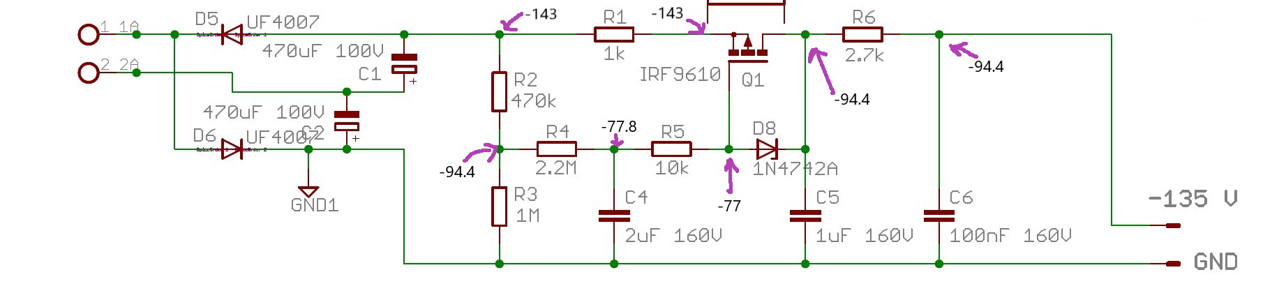

Did that and I am seeing 408V. Think that's in the safe zone. Whats the max the setup can handle ? Will I loose some power due to the lower voltage.Try changing the orange (330v AC) lead to the brown (275v AC), that should bring your HT down to within range. Remember to cover/isolate the orange lead for safety

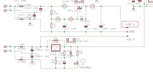

This is still an issue. Added a picture with voltages measured at all junctions. Maybe that will give a clue. Resistors seems to be all placed correctly.-93 seems low, think I'm getting 110v DC
No luck form my side as well.Also in the thread a member posted a schematic with voltages on the amp under test.
Thanks for all the help!
Can you try to change R2 to 220K?
Also -143V input is kind of too low for -135V output. It needs to keep difference big enough to make sure it works all the time.

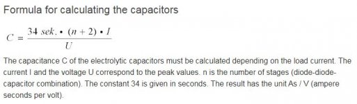

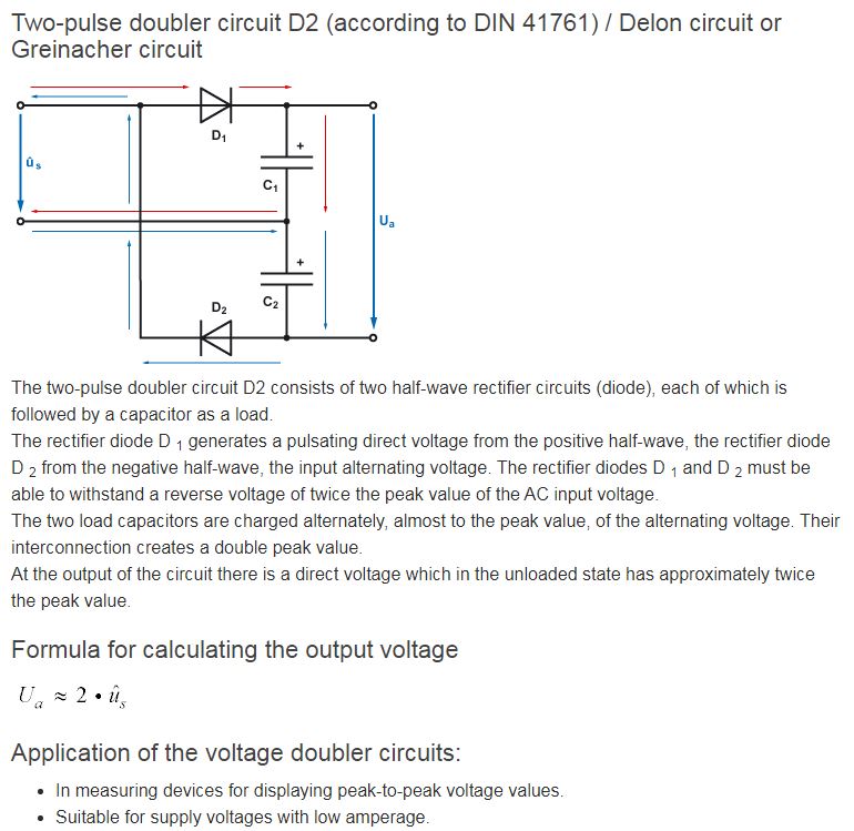

a voltage doubler cannot do magic either, as "doubler" already says, that should be clear to everyone. In addition, you should only measure under load and not while idling, see also
I did not remove R2 but put another resistor in parallel to the 470K I have. I am seeing the below boosted voltages:
470K in parallel : 112.4V
330K in parallel : 116.6V
100K in parallel : 128.6V
I think I am going to replace the R2 with something like a 68K to cross the 135V threshold. I don't have any 0.6W in stock, not sure a .25W will be fine here.
Are there any ill effects of a lower R2 value ?
-Gab

gingertube did recommend 22k for R2 , but had much different R1 and R6 values as well, both 100R. Re-positioned the Zener etc., that will need some track surgery.

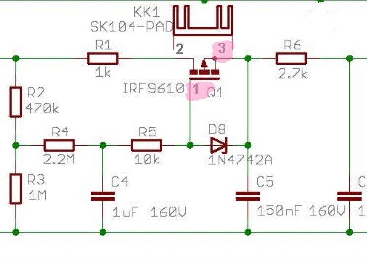

This relates to the IRF9610 pinout error on the 2019 PSU PBC.You need to read post #738 where Ian (gingertube) explains this mod, it's very easy to complete and a must do.gingertube did recommend 22k for R2 , but had much different R1 and R6 values as well, both 100R. Re-positioned the Zener etc., that will need some track surgery.
Have you read through the entire thread? if not I suggest you do
Just remember that those value are just guidelines and AFAIK nobody yet shared a full BOM for every kind of tube and class the amp is working on.
General guidelines are that for the drivers you need three times the bias voltage on the negative side, and on the positive side at least 25V more than the maximum voltage you want to have on g1 of the power tube. So If you stay in class A1 or AB1 it is ok to have let's say +30V, in you want to go into A2 or AB2 you need to raise it.
When voltages increase, just consider Q1, Q7 and Q9 maximum allowed voltages across them, and the possibility to upgrade those BJTs to higher Vce ones.
I got the PCB from the recent Group Buy organized by Algar_emi . This version seems to have the pin out issue fixed. Zener D8 is between the Gate and Source of IRF9610. I matched the actual board layout to the schematic below. I think previously I was referring to a older version of the schematic. It's a bit confusing as there are multiple versions floating around with subtle changes and creation Date/TS not being updated.This relates to the IRF9610 pinout error on the 2019 PSU PBC.You need to read post #738 where Ian (gingertube) explains this mod, it's very easy to complete and a must do.

Hey Gab,
Probably a typo in the quote, but for the PSU values of R1 & R7 are now 1k, R6 is unchanged at 2k7.
The -135V bias was to accommodate “big tubes”, your build with EL34s should be fine with what you have now. On the other hand, maybe you want to try KT88s in the future, and then you do want closer to -135V.
