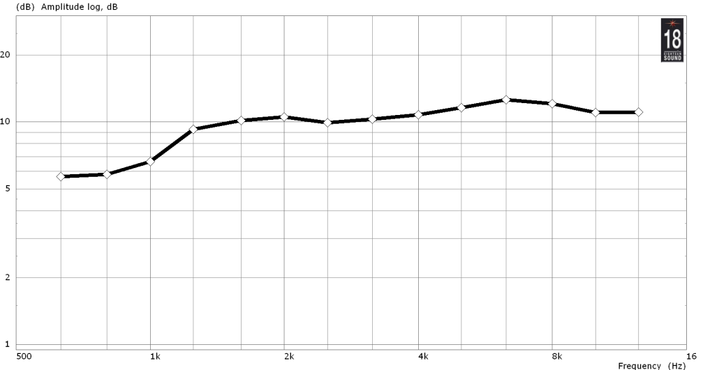

Looking for constant directivity horns I found the XT1464C. Its datasheet (https://www.eighteensound.it/media/W1siZiIsIjIwMTkvMDcvMTkvMTBfNTdfMzlfMzgxX1hSMTQ2NEMuUERGIl1d) shows a fairly constant directivity of 10dB above ~1.1kHz.

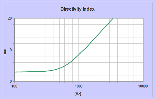

I found a plot for the directivity of a woofer (https://greatplainsaudio.com/wp-content/uploads/2017/07/TL_237.pdf). I also found an excel file that calculates it (http://www.tonestack.net/software/speaker-directivity-simulators.html v1.03)
12" woofer:
A 15" woofer has a directivity of 12-13dB at 1.1kHz, a 12" is at 10-11dB. I don't have a feeling for these numbers, but a 12" seems a better match.

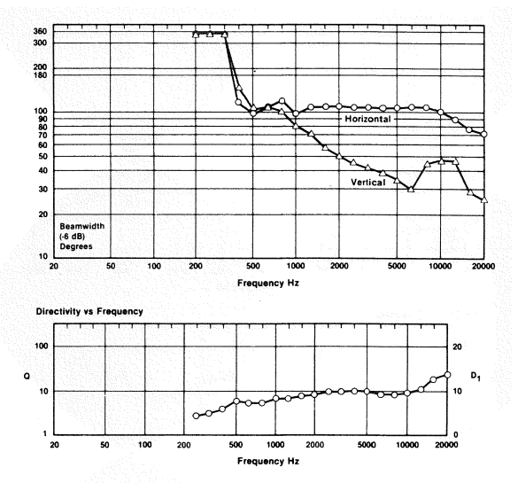

See post 5 lines 7,8,9. A 15" woofer + 7"x17" horn crossed at 1200 hz maintained +-3db evenness over 22.5 deg from straight ahead. 500 hz to 16 khz. Peavey SP2-XT. See also Pispeaker 4 pi referenced above. Directivity industry wide is determined -6 db, I hear differences of 3 db so I'm more interested beam witdth at that level of flatness. Using 12" instead of 15" woofer means 54-100 hz is difficult to maintain - 3db. Crossing above 1200 with 15" means some beaming as you see in your post. Some CD drivers will down go to 1200 hz or even 800 hz with significant watts rating. Going 3 way also stop the mid-range beaming, but with 70 & 100 watt compression drivers available that go to 500 hz, not necessary. 3 way introduces more sound modifications in crossover and much more cost (passive) in coils & MKT caps than a 70 W CD and a one point passive crossover. 2 way 12 db passive crossover is 2 coils, 2 capacitors, 2 or 3 tweeter level (reduction) and protection parts. With 54 hz - 3db, I live without a sub amp consuming electricity 14 hours a day.Watching video's by Toole and Geddes have pointed my towards (constant) directivity. You guys mentioned it also, but it took some time for me to sink in.

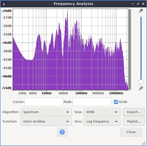

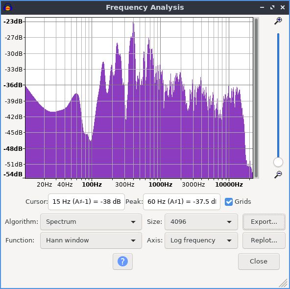

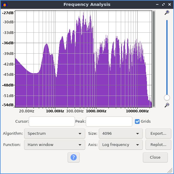

I did some tests to prove/disproove theory that backing speaker up to hard wall stops bass droop of the box itself. My SP2(2004) drops about 20 db from 54 hz to 30. In my music room backing op to hard wall reduced droop to about 6 db. Response below 30 hz is a low hum from some diesel sewer pump somewhere. Left chart is back of speaker against wall, 2nd is one foot from wall. 3rd is 3 and half foot from wall.
