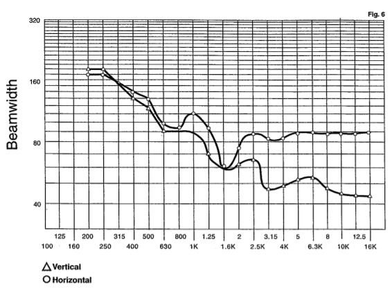

The directivity of the Peavey is strange, the DI is pretty flat through most of the range but the horizontal and vertical are all over the place at certain points. The Pi H290C or the Celestion 9040 are smoother and more even overall.Here is how even the dispersion can be with a 70 w 1.4" CD + a 15" driver. See page 3 of SP2-XT spec. Peavey brags about 6 db dispersion, but -3 db dispersion according to the charts is +-22.5 deg from center 500 hz to 16 khz, and +- 10 deg vertical (pointed down at the heads of the audience).
One doesn't need 90 deg directivity unless one is standing 2 m from speakers 2 m apart. I admired the -3 db +- 22.5 deg response horizontal and +-10 deg response vertical measurements: Which cover sitting or standing from 3 m away or farther. Mr. Kamphuy's room is 4 m long. I walk around my music room from 2.5 m to 5 m away, sideways 3.6 m, and the sound didn't change. Not much different 11 m away in the kitchen through 2 double door openings.The directivity of the Peavey is strange, the DI is pretty flat through most of the range but the horizontal and vertical are all over the place at certain points. The Pi H290C or the Celestion 9040 are smoother and more even overall.
That chart is 6 db response anyway, which would be an annoying change. The polar plots have 6 db circles and the 3 db point is about half of one division.THe 4 pi response curve which is 15" + horn looks worthy of copying. But response only plotted out the 40 dg, which is all you need anyway.
The Peavey has a 90 degree horizontal beamwidth over much of it's range. It's not about the angle you need to cover the area of listening, more the direct to reverberant ratio. A 90 x 40 horn will sound different to a 60 x 40 even within the area where both are very even. This comes down to personal preference.One doesn't need 90 deg directivity unless one is standing 2 m from speakers 2 m apart.
Beamwidth by convention is taken at the -6dB point, important to know when comparing the coverage angles listed by manufacturers.That chart is 6 db response anyway, which would be an annoying change.

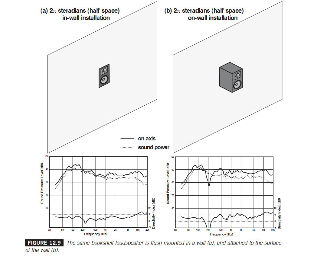

If you are struggling a good place to start is Floyd Toole's Sound Reproduction, that covers a wide range of material from directivity to room response etc.
Putting speakers nearer to walls is often a good option when EQ is available to compensate. I do that myself. You do have to be mindful that shoving the cabinets directly against the wall is very rarely the best place for them due to the boundary dip ending up in the worst frequency range to have one.Speakers shoved up againt the wall don't need baflle step compenation for lost bass. Speakers 1 to 1.3 m into the room do, need all 6 db of it.
Graphic attached from Floyd Toole's Sound Reproduction

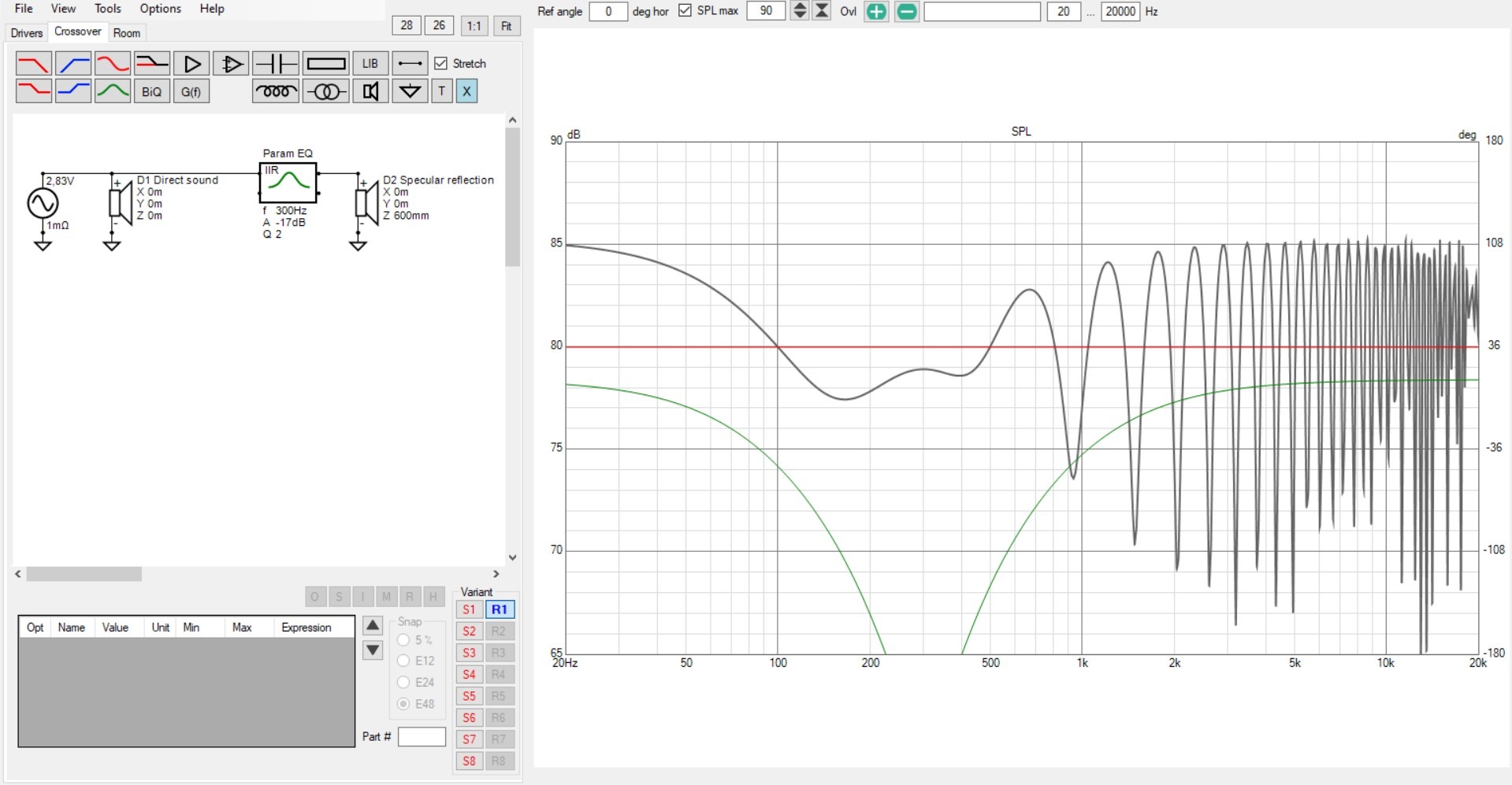

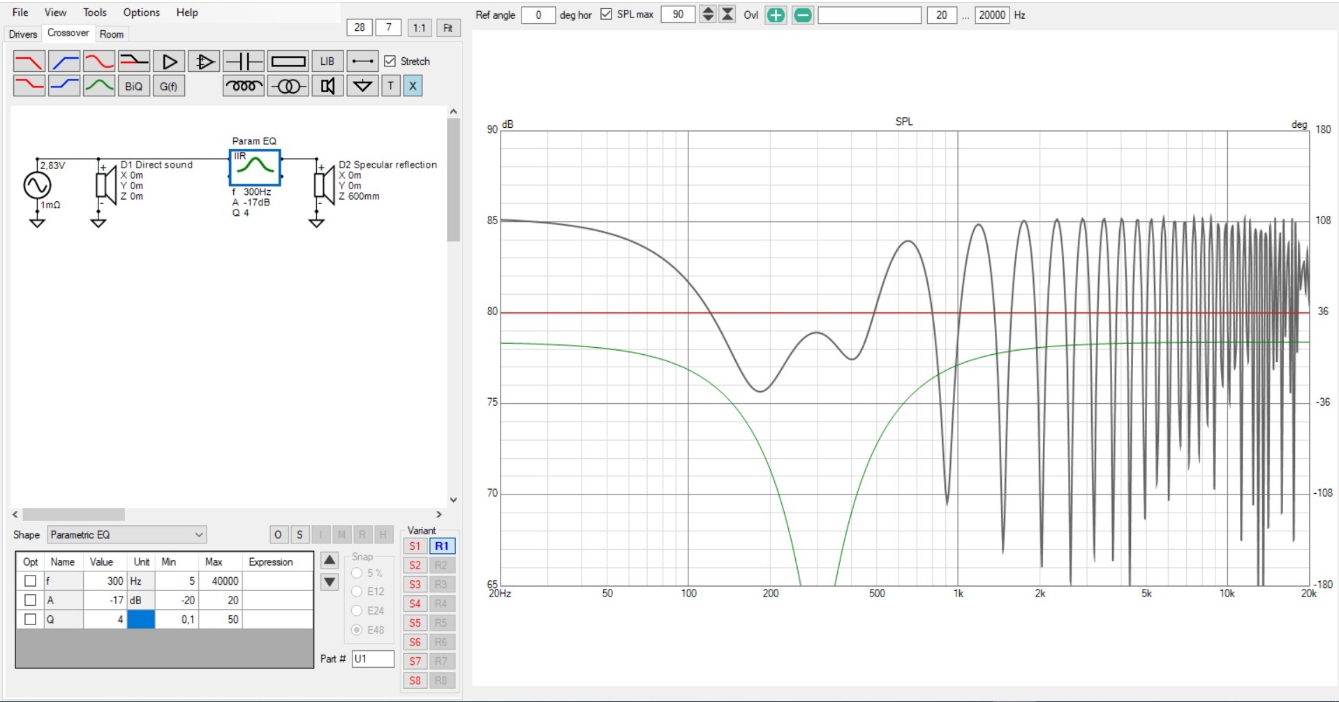

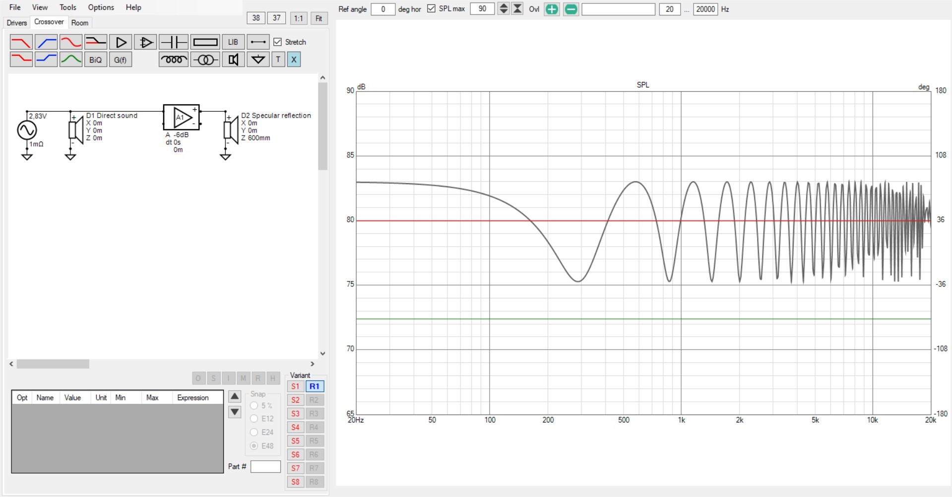

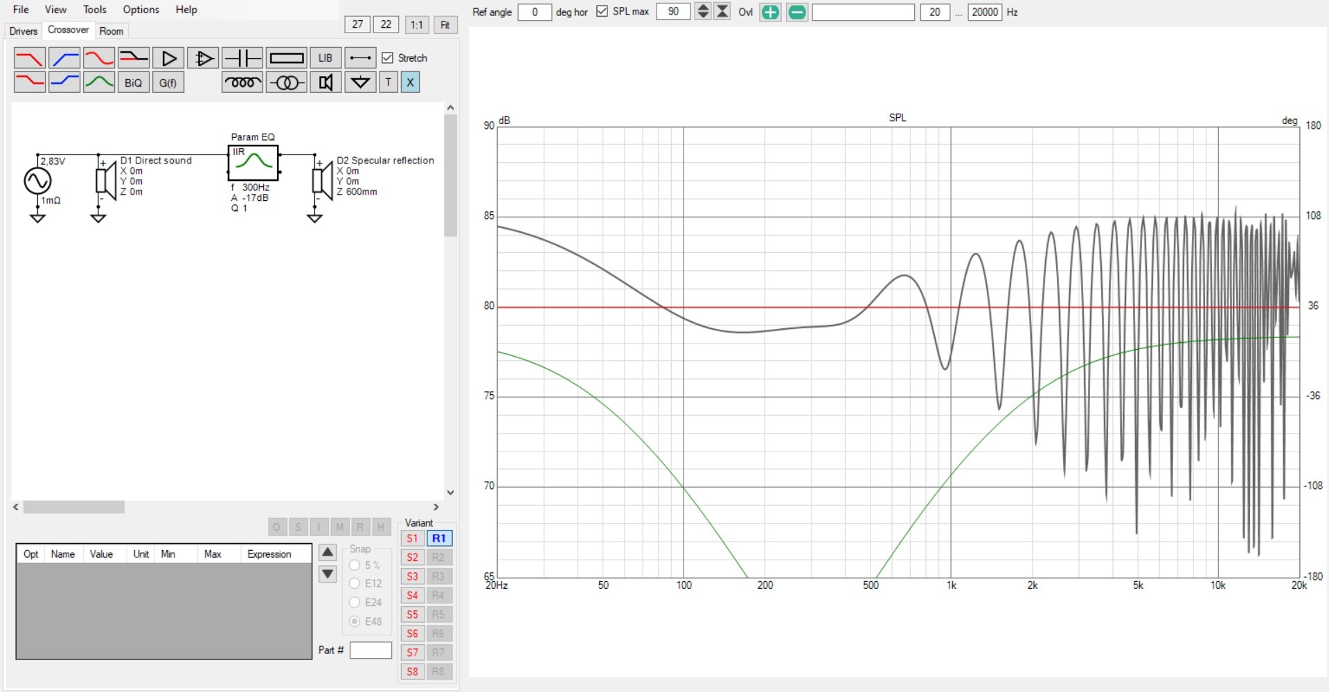

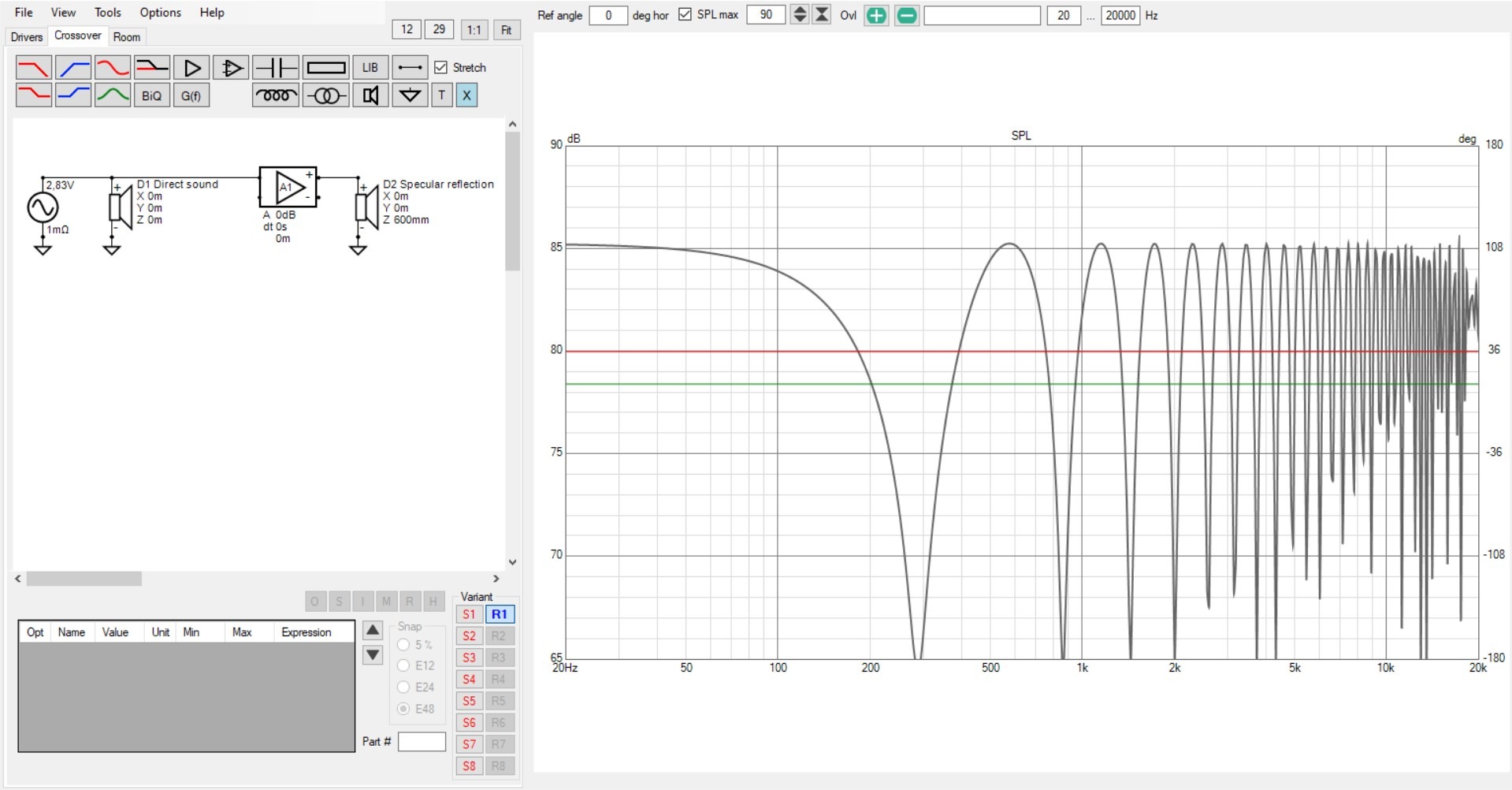

Here are some additional info for the interested without going into details like perception and taking account other boundaries in room but trying to connect the reflection into practical things. Thought to make new thread for this kind of stuff but I'll just post it here:

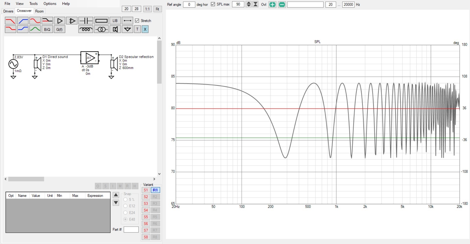

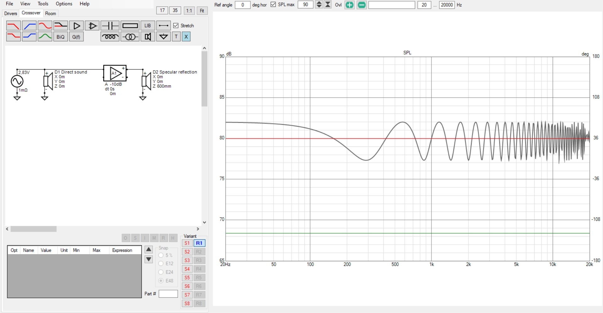

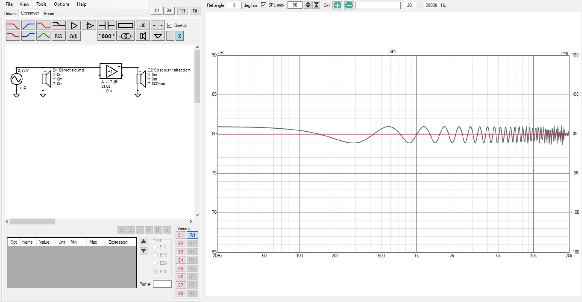

I found it very interesting how much attenuation is needed in order to lessen the effect of reflection, the interference. Here is series of attachments with ideal direct sound and likewise ideal reflection whose path length is ~2 feet longer, roughly situation if the speaker was 1 foot deep pushed against front wall. Red line is direct sound and green the reflected sound response (both ideal flat). Interference measured at 3 meters is the black line.
In this case, inspected from 10 feet away, it takes about 17dB of attenuation to get the interference to +/- 1dB!
Notice there is constructive and destructive interference (black line above and below the red). To effectively get rid of "a interference dip" both need to be cancelled. Hence narrow band filters won't make too much difference to the peaks or dips in the interference. Here 17db notch at 300Hz with Q of 2 and 1. The destructive interference is almost gone, but the constructive interference both below and above still remains and there is just wide platoe dip.
How these numbers relate to real world speakers? Attenuation due to baffle to back side of speaker, to specular reflection point on front wall, seems to be about this magnitude (10-20dB) roughly from baffle step and up. Waveguides can exceed this easily on frequencies they have influence on but this is also above baffle step. Waveguides can help limit radiation to other boundaries though, like the side walls, floor and ceiling. MTM can have strong attenuation to a (vertical) reflection points but it is only about octave wide. Dipole/ OB stuff can have very deep very wide bandwidth attenuation to first reflection points.
Let's see if my math checks out. Never really got the feeling for dB's, even though a lot of my colleagues use them all the time for radar stuff. I guess I should divide by 20 (10 doesn't get me close):
10^(63/20) / 10^(80/20) = 0.141...
10^(81/20) / 10^(80/20) = 1.122...
So it's about right, right? Constructive interference should result in 1.122, which is the direct sound (1.0) + the reflected sound (-17dB = 0.141).

Perhaps, not good at math either, just looking at the graphs 😀 Assuming your math is correct, error / difference in your calculation to my approximation is explained with some attenuation in the path length difference (there is some extra attenuation to the inspection spot, from the further sound source) as well as accuracy of my eyeballing.
