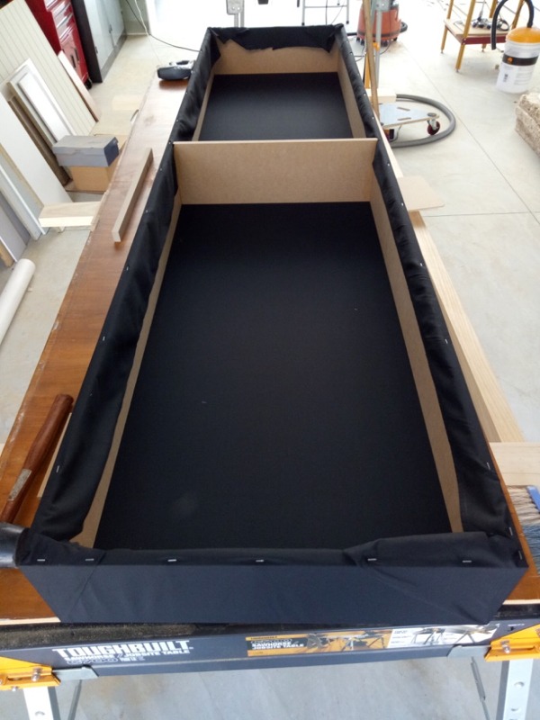

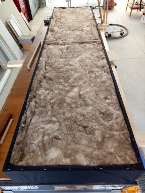

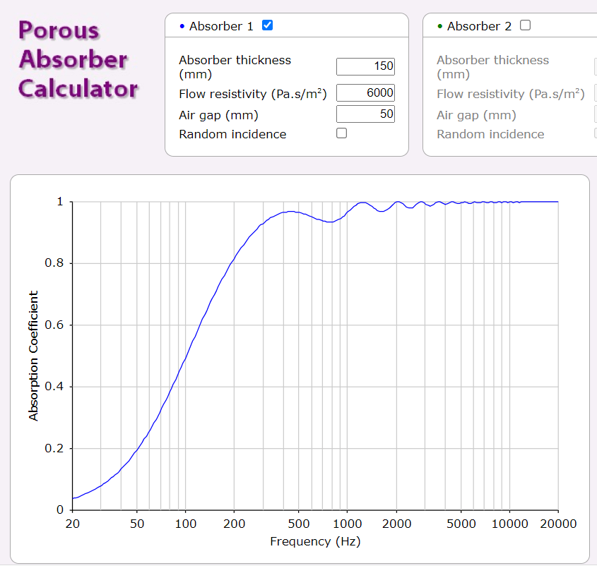

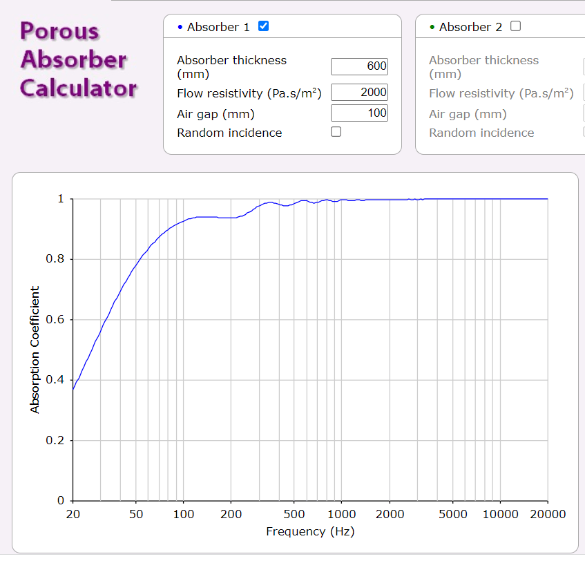

600mm Low Density Fibreglass, with an air gap which makes a big difference, not OC703 (which is quite high density). Not very practical but quite effective
A more practical size for a panel behind a couch, 150mm medium duty with a smaller air gap, example build attached below

Thanks fluid. Interesting to see the low density absorber's the cut off is much steeper than 703's. I'm not still sure about room mode correction with DSP, but this topic would never end and it is off topic anyway, so I just shut up.

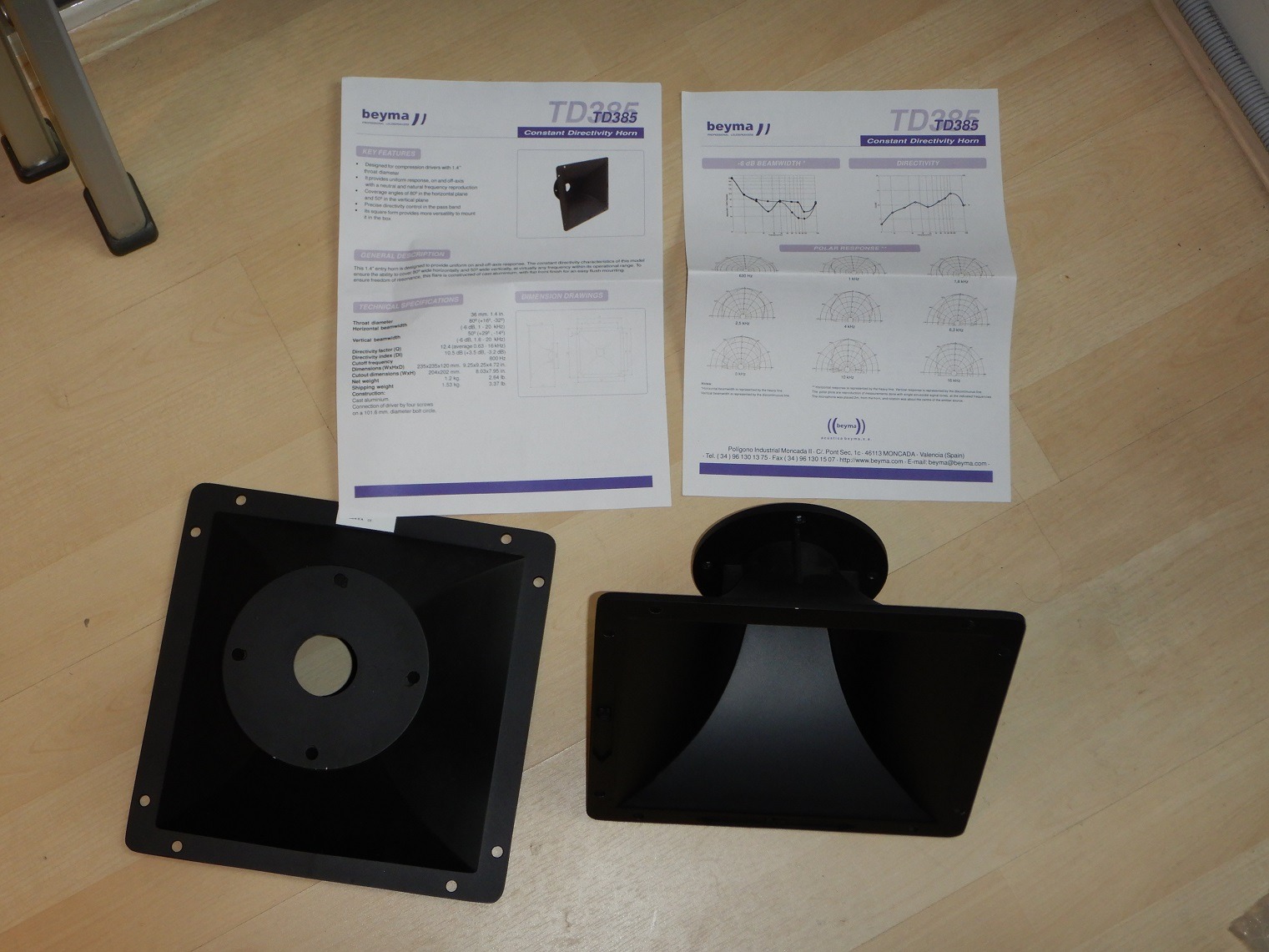

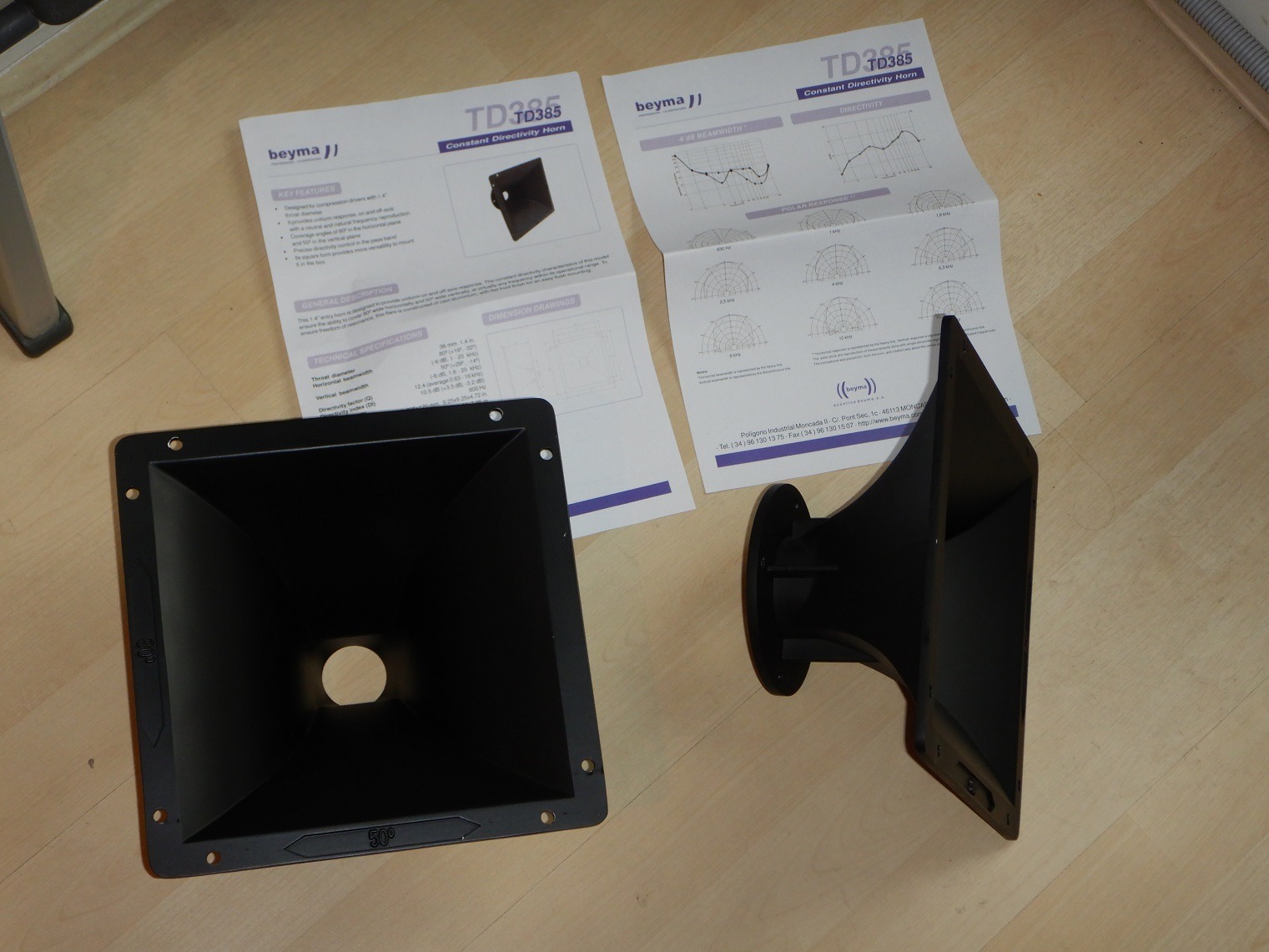

Good evening Tom,
noted that you were looking for a 1.4" horn.
I have a (new) pair of Beyma TD365 (https://www.beyma.com/en/products/c/horns/1TD365/bocina-td-365/ ) doing nothing here as i use only the drivers and not these horns.
Maybe these can be of use to you ? Just let me know. These horns are metal (gegoten aluminium) and no funny plastic.
Looking at your name i guess you're from the Netherlands; this should make things easier as i'm from the same country (Elst; near Arnheim).
If interested just let me know.
