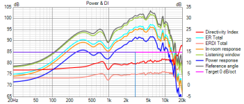

I did some prelimary measurements with the SM57 mic, just to get used to the new measurement process and the use of it in VituixCAD.
The measurements are very repeatable and the weird preringing that happened every now and then is gone. I do get weird measurements when the speaker is turned towards the wall and I guess the reflected signal gets stronger than the direct sound. That problem will go away when I do the measurements in the barn.
In VituixCAD I get nice directivity graphs for a crossover frequency from ~700Hz to ~1000Hz. It seems very forgiving. I didn't pay attention to the FR flatness as the SM57 doesn't have a flat response.
But when I enter a 400mm offset between the woofer and the waveguide, I can't get the directivity smooth.
Is there a magic knob I can turn to improve this? I've tried all kinds of parameters in VituixCAD, but I didn't succeed.

Hard to answer on a theoretical level. You could share your VCad project with measurement data.
I cannot see any proper bass response, you have not merged nearfield with far field data yet, correct?

I will. Will take some time. Keep in mind the data isn't perfect. I hope it is good enough.Hard to answer on a theoretical level. You could share your VCad project with measurement data.
Correct.I cannot see any proper bass response, you have not merged nearfield with far field data yet, correct?

With Vituix it's always a good idea to RTFM 🙂I mixed up the Z and Y axis. And I'm the coordinate system guy at work. Not good for my career. But who uses left-handed coordinate systems?!
Problem not completely gone, but I think I need better measurements to be sure.
