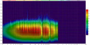

I measured the woofer with the microphone very close to the cone as explained in https://www.audiosciencereview.com/...ents-spinoramas-with-rew-and-vituixcad.21860/
This is the result:
Low frequency roll-off is as expected (VituixCAD). The dips around 500Hz and 1000Hz I can't explain. Any ideas? And what can I do about it?
Then the waterfal and spectrogram: I know what they mean in a mathematical sense, but don't know if they are good or bad, what causes certain features nor what to do about any bad signs.
Any clues?

Those seem to coincide with impedance plot humps, which is convenient. Would another frequency response dip appear around ~300Hz if you were to remove the blanket inside? How is the blanket positioned inside by the way? Since it was effective for lowest mode inside the box it ought to have reduced all higher modes as well. For this reason perhaps the 500Hz and 1000Hz humps aren't modes inside the box but something else.
Perhaps they are cone resonances? I believe surround resonance is first to appear (I really have no knowledge, just faint memory from some forum posts) where cone surround is decoupled from what the voice coil does, moves in opposite phase and then there is dip as the Sd was now reduced and even works against the rest.
On the other hand it might be just artifact from the measurement, path length from cone edge to middle (for 15" driver) is roughly half wavelength of ~1kHz so that could be it. Did you measure far field? I suspect at least the 1kHz dip goes away little bit further away.
If these are cone resonances, then there is hardly anything you can do other than change driver. Which driver it is by the way?

It’s a close range measurement, so likely you’re seeing standing waves in the enclosure. Cone breakup normally will show a rising pattern with rising frequency and surround problems don’t show up that easily on close range. It’s not bad btw. But you’d have to investigate that 500Hz dip. Is there a corresponding dimension internally?
The ~500Hz impedance peak and frequency response dip seem to be at a different frequency; nearby, but not equal.
The blanket is positioned with the blue side up ;-) I just put it in in such a way that it makes a kind of bridge in order to get the blanket material away from the bottom in an attempt to get it where the air is actually moving.
Clearest indication that it is not a mode is that the bumps are already present in the impedance measurement of a free standing woofer. The plots from Faital Pro do not show them though. The woofer is a Faital Pro 12PR320.

I don't think so. Impedance plots with standing waves indicated with * are a few posts above.It’s a close range measurement, so likely you’re seeing standing waves in the enclosure. Cone breakup normally will show a rising pattern with rising frequency and surround problems don’t show up that easily on close range. It’s not bad btw. But you’d have to investigate that 500Hz dip. Is there a corresponding dimension internally?
Tom, nearfield measurements are only usable up until just before the first dip. The nulls at regular intervals are an effect of the nearfield technique. The nearfield needs to be spliced or merged with a far field measurement to create a composite. You also need to compensate for the baffle diffraction which is absent in the nearfield measurement.

I tried to calculate what is happening. For low frequencies the phase of sound coming from all places of the cone is roughly the same. You get constructive interference and maximum signal. As the frequency increases the phase differences increase and the edge of the cone is contributing less and less and even starts to interfere destructively/ At even higher frequencies you end up with a contribution of the woofer (area) like this:
A lot of rings that for higher and higher frequencies average out more and more.
For the total output at the microphone 1cm away from the cone as a function of frequency, I get this:
This does not agree with the measurement. Initial reaction is to deny reality, but I'm old enough to realise that I might have made an error. But when I look at the image in the Keele document, it says that the first minimum is at a/lambda = 1. As 'a' is the radius, that would mean 343/0.12 = 2850Hz. That value is very close to my first minimum.
What am I doing wrong systematically?

Well, a cone isn’t a true piston. Even in metal cones, the speed of sound in the material will have influence on the radiation.
Arta does get close to 500-600Hz:
Formula gives (343/(4x0.15=) 570Hz.
