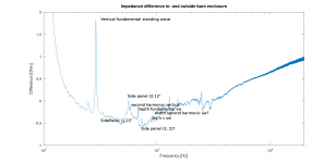

'Bare metal' prototype enclosure is ready. Kept it as simple as possible: no bracing, no damping, no vents, loudspeaker not recessed. Everything to learn as much as possible.
As a first step I measured the impedance of the woofer:
Internal box dimensions (and mode frequency):
Height: 58.4cm (294Hz)
Width: 36.4cm (471Hz)
Depth: 25.0cm (686Hz)
Peaks at 294Hz and 686Hz are clearly present. Cause of other peaks still unknown.
551Hz
1023Hz
1284Hz
2230Hz
2450Hz
2850Hz
Crossover will be around 1000Hz, so I guess these higher ones are not that important.
It looks like I need some damping. What is best practice? What material should I use? I plan to add 2 vents btw.
What other measurements can I do to find more flaws or causes for the other resonances?

Make an impedance measurement of the raw driver in free air to compare against the one in the box then you can see which resonances are in the driver and which come from the box.
Sealed and bass reflex need different damping strategies. In a sealed box you can stuff it quite heavily but doing the same in a reflex box will turn it more aperiodic and reduce the port output.
Insulation material used in houses works well for box damping, fibreglass and the more recent polyester types. Polyester is tricky because it does not all behave the same. Pillow stuffing material is next to useless at damping resonances. Ordinary acoustic foam is OK and Basotect or melamine foam is better. Reconstituted felt in a purple or green colour like the type used in car sound absorption works really well. In a reflex, lining some of walls with that or some foam can be a good compromise.

I think the theory says this about the side panel modes (mdf, 60x40x1.9cm).
Now I only have to find a way to measure them and hope I don't have to reject reality and substitute my own.
😀 you can use logic with the data, use bracing so that aspect ratio of free panel increases. If you had one brace for panel like in your image, you'd want to put it horizontally on not vertical.
See top middle image mode, it would happen if you had vertical brace on the middle that attaches middle of the panel firmly. The panel is now divided in two, whose aspect ratio is about same or bigger than the original and it shows 350Hz mode in this case. If you had horizontal brace instead, aspect ratio of the two panels is now bigger, the left column middle mode would happen, resonance is much higher at 560Hz. Even better, two horizontal braces, even greater aspect ratio, bottom left situation. Lowest mode is now out of band.
This is the difference between in and outside of the enclosure. I did match them globally by adding a constant resistance to one of the two measurements.
labels with first letter at the frequency.
I added labels for resonances that could be close. But there are a lot of peaks and a lot of possible resonances, so they all might just be random coincidences.
