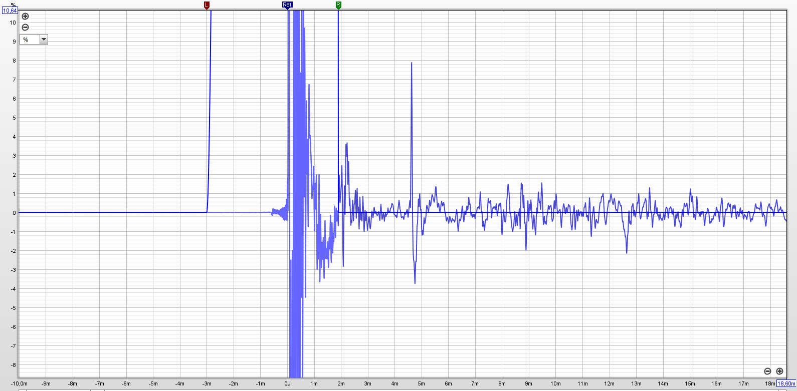

It took me a while to notice that the directivity is high. It is higher than expected around/below 1kHz. I'm having troubles with my crossover design.
The measurement is still plagued by too early reflections. To get to the 6.5ms of reflections free time (mentioned in the asr guide) I will need to go outside. And more importantly, I will need to upgrade my speaker stand.

With only 2 ms of data there's almost nothing reliable under ~1 kHz. The DI won't be actually that high, that would be too easy 🙂
Based on experience, all should match the simulation quite accurately.

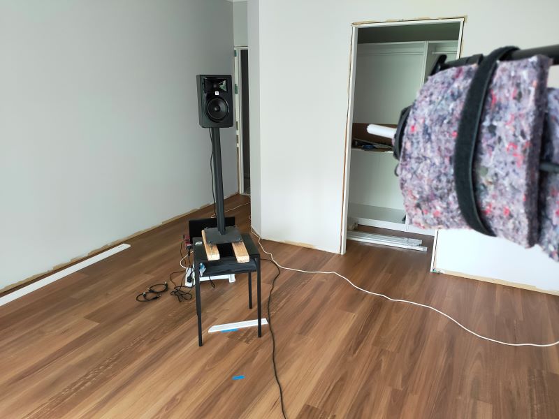

measuring can also be done with mic on the ground, that way you dont get reflections form the ground and other objects might be further away like that

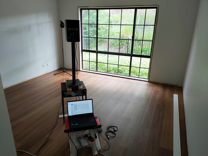

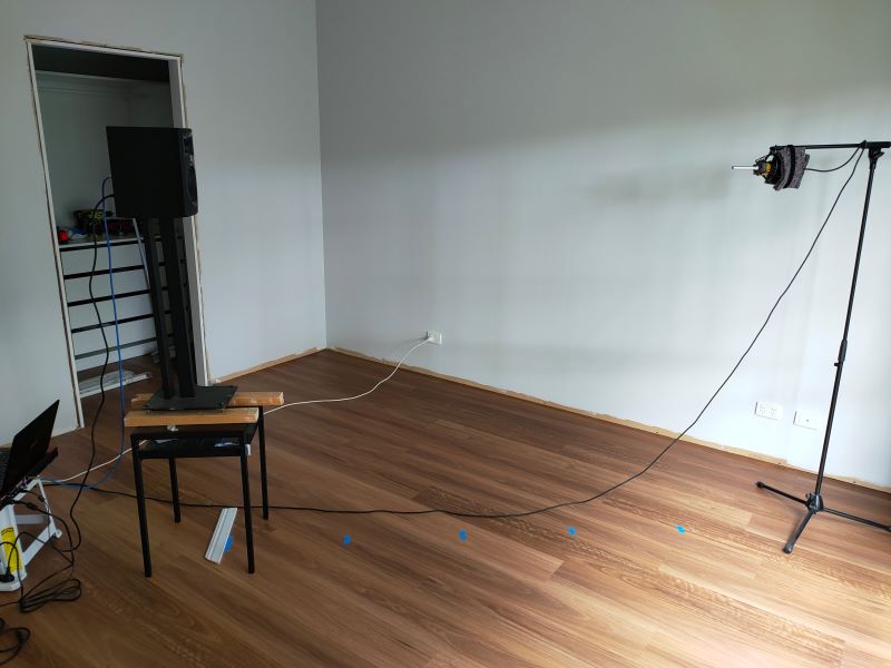

Does anyone have tips to minimize reflections inside the 6.5ms window, so speaker and microphone stand?
Is it possible to position speaker and microphone above each other? What are the pros and cons? How would I make it rotatable?
Does anyone have photo's of their setup?
Any tips I didn't ask for? 🙂

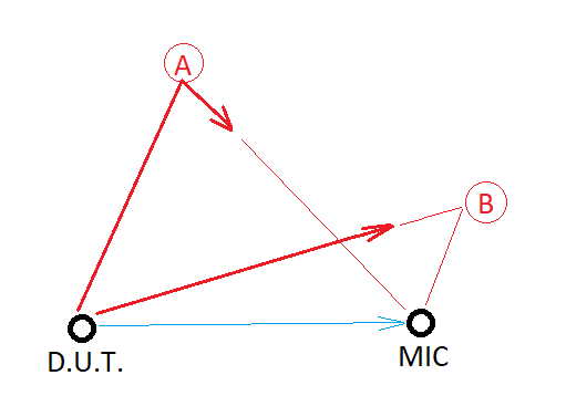

As has been said, it's all about free space around the source and the microphone.
- In the following picture the direct sound from the DUT (blue arrow) just arrives to the microphone. Now the clock starts ticking and your reflection-free time window lasts until the first reflection arrives. In this case it will be the reflection from the obstacle B, so this is the limit of the setup (which makes the obstacle A irrelevant as its reflection path is longer).
(Typically, the closer you place the DUT and the MIC the longer time window you're able to get.)

I don't get your reasoning here. Typically you want to place both DUT and MIC half way of the room height above the floor, as it's typically the ceiling or the floor that is the closest reflective surface.
Sure, try to minimize the supports inside the ellipsoid but don't be bothered by thin rods or common speaker/mic stands. Some damping certainly won't hurt. I don't use any myself.

I once constructed an XLR-connector on one end of a metal broom stick. That stick fitted onto my mike stand and thus reflections from the mike stand or clip were reduced and delayed.
Are my photos not good enough 😉Does anyone have photo's of their setup?
Putting the mic in a longer tube to keep reflections off it interfering is worthwhile some information on my 3D printed parts for that purpose here

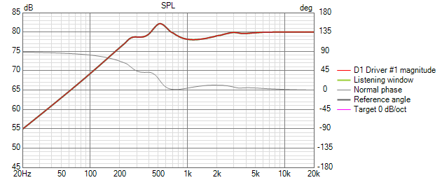

I did a new measurement with a better setup; only the 90 deg FR. The impulse response was way cleaner and that was visible in the FR (of course). I still had this bump around 700Hz. I think I know where it comes from:

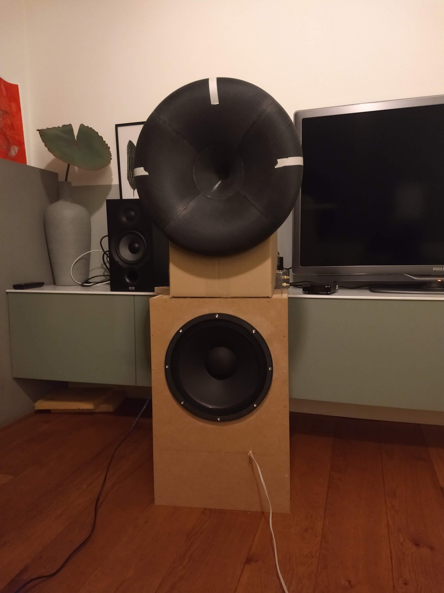

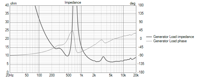

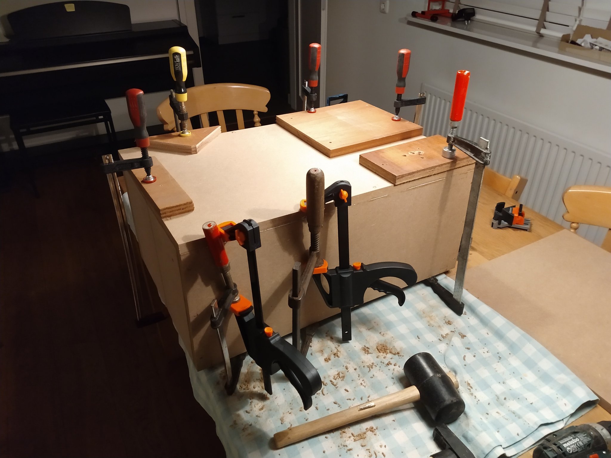

'Bare metal' prototype enclosure is ready. Kept it as simple as possible: no bracing, no damping, no vents, loudspeaker not recessed. Everything to learn as much as possible.

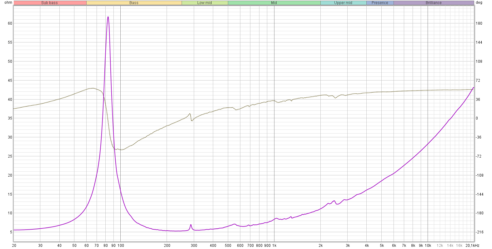

As a first step I measured the impedance of the woofer:
Internal box dimensions (and mode frequency):
Height: 58.4cm (294Hz)
Width: 36.4cm (471Hz)
Depth: 25.0cm (686Hz)
Peaks at 294Hz and 686Hz are clearly present. Cause of other peaks still unknown.
551Hz
1023Hz
1284Hz
2230Hz
2450Hz
2850Hz
Crossover will be around 1000Hz, so I guess these higher ones are not that important.
It looks like I need some damping. What is best practice? What material should I use? I plan to add 2 vents btw.
What other measurements can I do to find more flaws or causes for the other resonances?
