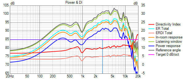

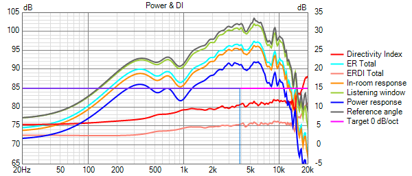

I did some prelimary measurements with the SM57 mic, just to get used to the new measurement process and the use of it in VituixCAD.
The measurements are very repeatable and the weird preringing that happened every now and then is gone. I do get weird measurements when the speaker is turned towards the wall and I guess the reflected signal gets stronger than the direct sound. That problem will go away when I do the measurements in the barn.
In VituixCAD I get nice directivity graphs for a crossover frequency from ~700Hz to ~1000Hz. It seems very forgiving. I didn't pay attention to the FR flatness as the SM57 doesn't have a flat response.

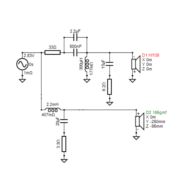

But when I enter a 400mm offset between the woofer and the waveguide, I can't get the directivity smooth.
Is there a magic knob I can turn to improve this? I've tried all kinds of parameters in VituixCAD, but I didn't succeed.
Any other remarks?

I will. Will take some time. Keep in mind the data isn't perfect. I hope it is good enough.Hard to answer on a theoretical level. You could share your VCad project with measurement data.
Correct.I cannot see any proper bass response, you have not merged nearfield with far field data yet, correct?
This thread might help you to understand the inherent problemBut when I enter a 400mm offset between the woofer and the waveguide, I can't get the directivity smooth.

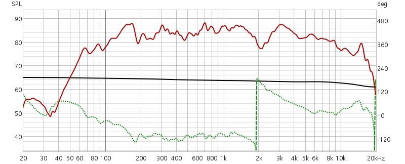

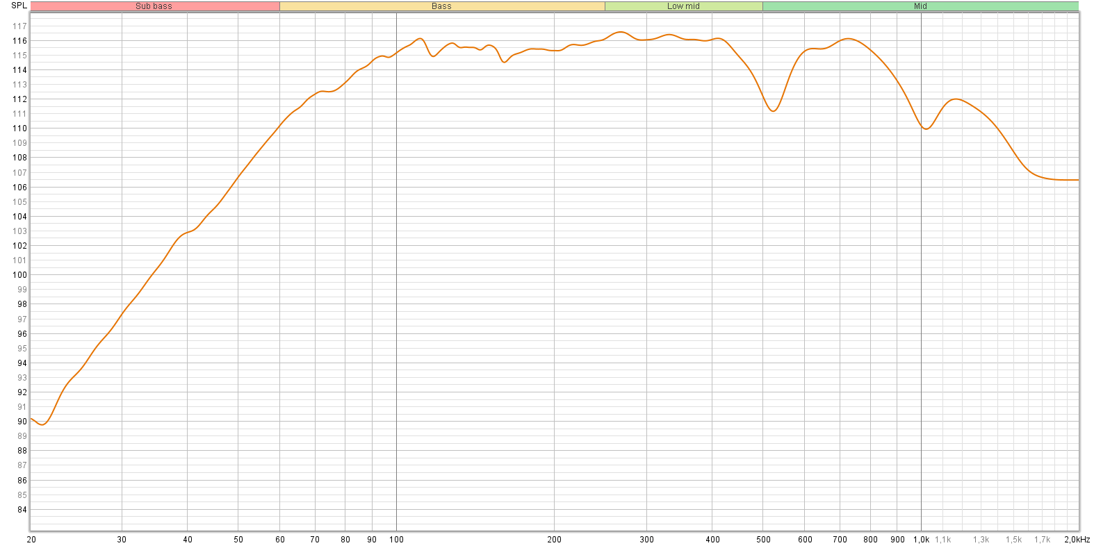

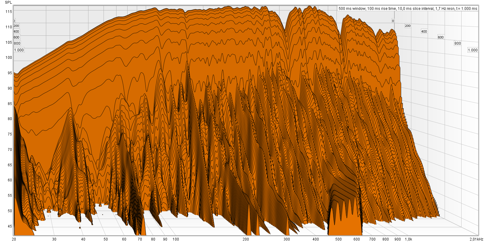

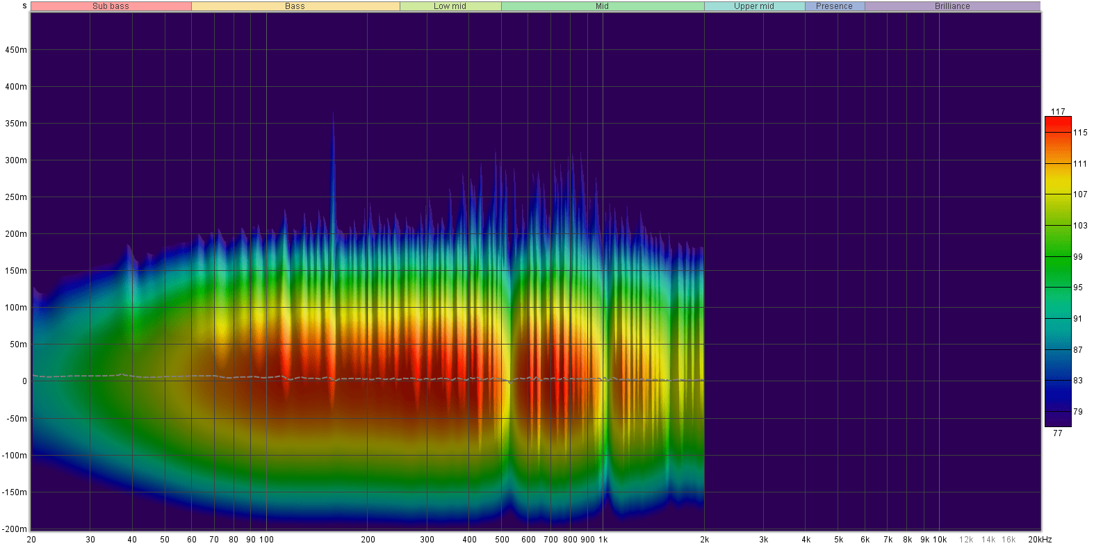

Hi very interesting thanks Why not test the driver mounted on a open baffle ? if i understand well the enclosure has always an impact on the driver responseI measured the woofer with the microphone very close to the cone as explained in https://www.audiosciencereview.com/...ents-spinoramas-with-rew-and-vituixcad.21860/
This is the result:
View attachment 1139977 View attachment 1139978 View attachment 1139980
Low frequency roll-off is as expected (VituixCAD). The dips around 500Hz and 1000Hz I can't explain. Any ideas? And what can I do about it?
Then the waterfal and spectrogram: I know what they mean in a mathematical sense, but don't know if they are good or bad, what causes certain features nor what to do about any bad signs.
Any clues?

The enclosure has an impact. I want the response of the driver in the enclosure.
I don't know how the data sheets are measured. "Assumptions are the mother of all ......" (my favorite quote )
I kinda moved on, but I realise I have some loose ends.
Usually they are on an IEC baffle at a specified distance, but sometimes they are in a reflex box or anything else the manufacturer thinks will make the response look better. So you are right not to assume.I don't know how the data sheets are measured. "Assumptions are the mother of all ......" (my favorite quote )
Measuring the driver in the enclosure you plan to use it in is exactly the right way to do it when designing a speaker.
