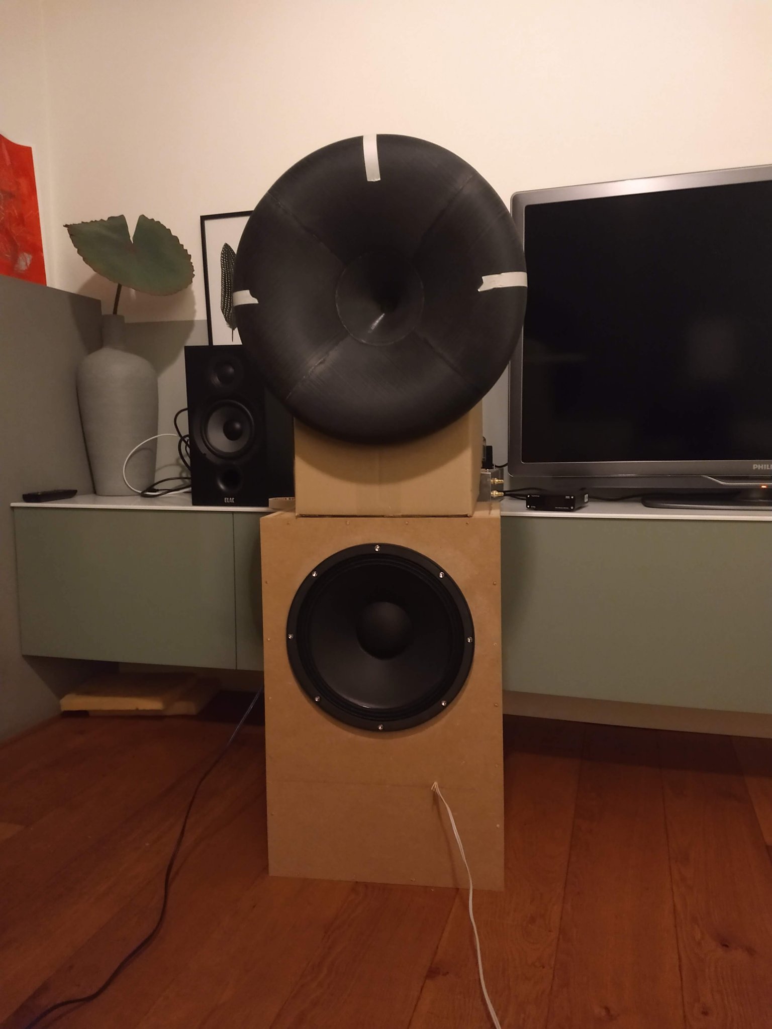

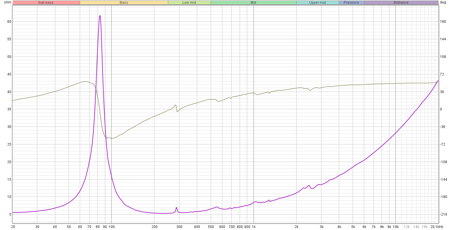

As a first step I measured the impedance of the woofer:
Internal box dimensions (and mode frequency):
Height: 58.4cm (294Hz)
Width: 36.4cm (471Hz)
Depth: 25.0cm (686Hz)
Peaks at 294Hz and 686Hz are clearly present. Cause of other peaks still unknown.
551Hz
1023Hz
1284Hz
2230Hz
2450Hz
2850Hz
Crossover will be around 1000Hz, so I guess these higher ones are not that important.
It looks like I need some damping. What is best practice? What material should I use? I plan to add 2 vents btw.
What other measurements can I do to find more flaws or causes for the other resonances?

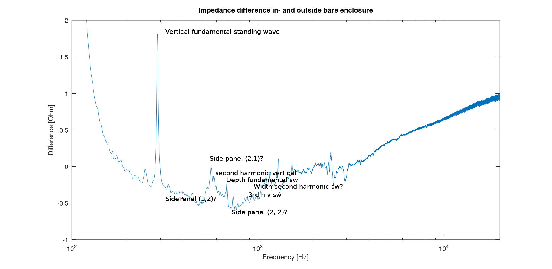

Make an impedance measurement of the raw driver in free air to compare against the one in the box then you can see which resonances are in the driver and which come from the box.It looks like I need some damping. What is best practice? What material should I use? I plan to add 2 vents btw.

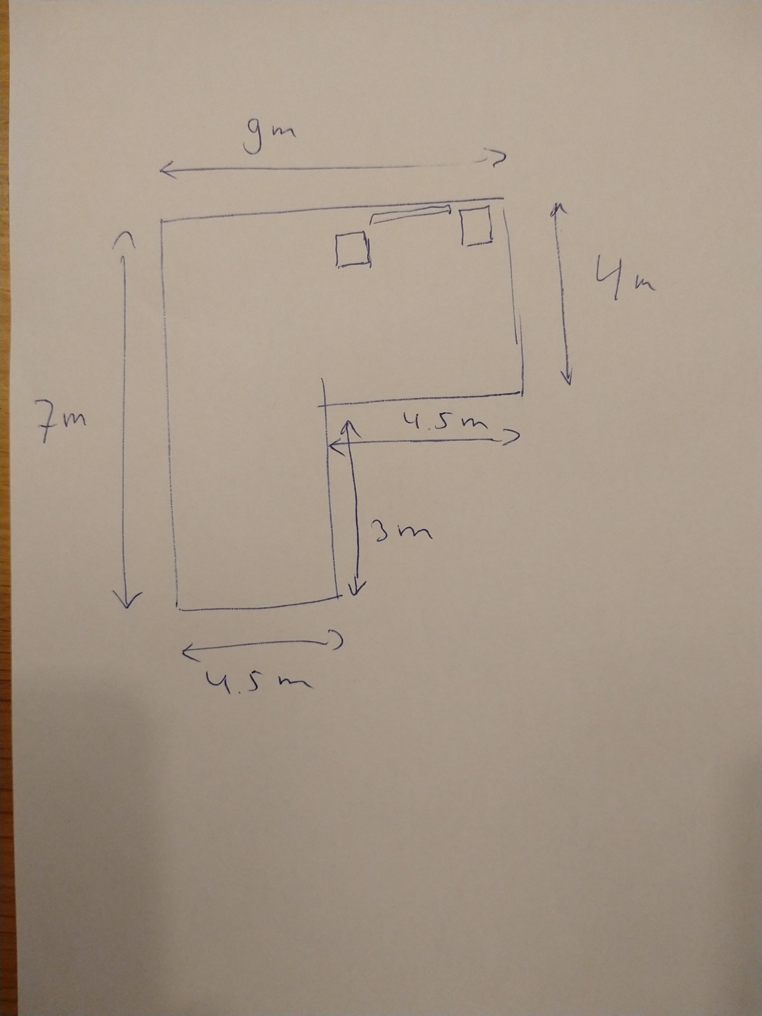

Hi, its bit of a philosphical advice to remind there is always some trade-offs one is dealing with. There is nothing special to it, its just that while calculating box size with box simulator one is mainly dealing with low knee of the system, its Q. This is important because good bass is mandatory, but the simulator doesn tell anything about midrange and how its performance changes as you change parameters. Its designers responsibility to know what he is dealing with and what matters and what not and what is the trade-off if I do this or that, in system level.
For good bass, in my opinion and yours might differ, we need as much cone area as possible, which usually means guite large boxes, which means all kinds of issues with the boxes and drivers get lower in frequency which limits "clean" bandwidth, so midrange performance is getting traded-off just by sound wavelength alone.
It all comes to sound wavelength. Bass is room sized wavelengths has room sized problems and need room sized solutions, so to optimize for bass is to make a big system that deals with the room. This is again just philosophical stuff how to get very good sound reasoning from wavelength, trying to push wavelength related issues out of band, take trade-offs that don't affect system performance (too much). Conversely, if you want really good system it means you haven't sacrificed anything, traded-off anythin important. It is not based on actual listening and experience what sounds good but to reasonable logic to make a problem free system from ground up based on physical property of sound, the wavelength. So just a philosophical guideline. hope it helps 🙂

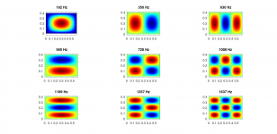

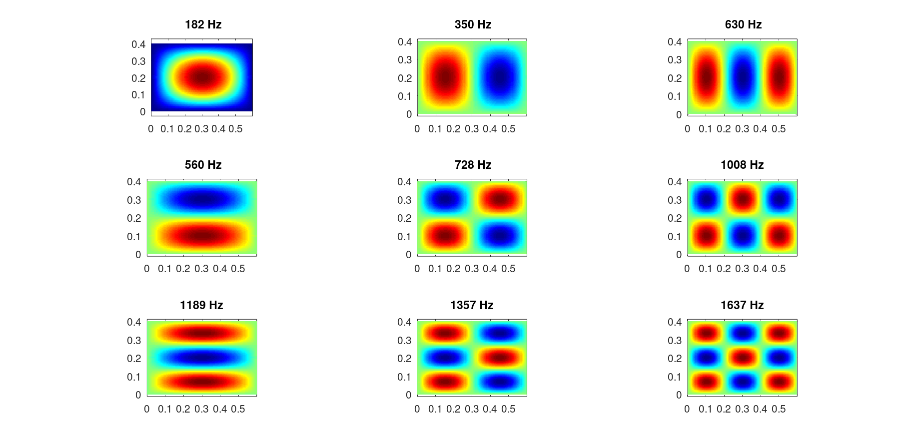

😀 you can use logic with the data, use bracing so that aspect ratio of free panel increases. If you had one brace for panel like in your image, you'd want to put it horizontally on not vertical.
See top middle image mode, it would happen if you had vertical brace on the middle that attaches middle of the panel firmly. The panel is now divided in two, whose aspect ratio is about same or bigger than the original and it shows 350Hz mode in this case. If you had horizontal brace instead, aspect ratio of the two panels is now bigger, the left column middle mode would happen, resonance is much higher at 560Hz. Even better, two horizontal braces, even greater aspect ratio, bottom left situation. Lowest mode is now out of band.
This is the difference between in and outside of the enclosure. I did match them globally by adding a constant resistance to one of the two measurements.
labels with first letter at the frequency.
I added labels for resonances that could be close. But there are a lot of peaks and a lot of possible resonances, so they all might just be random coincidences.
