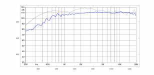

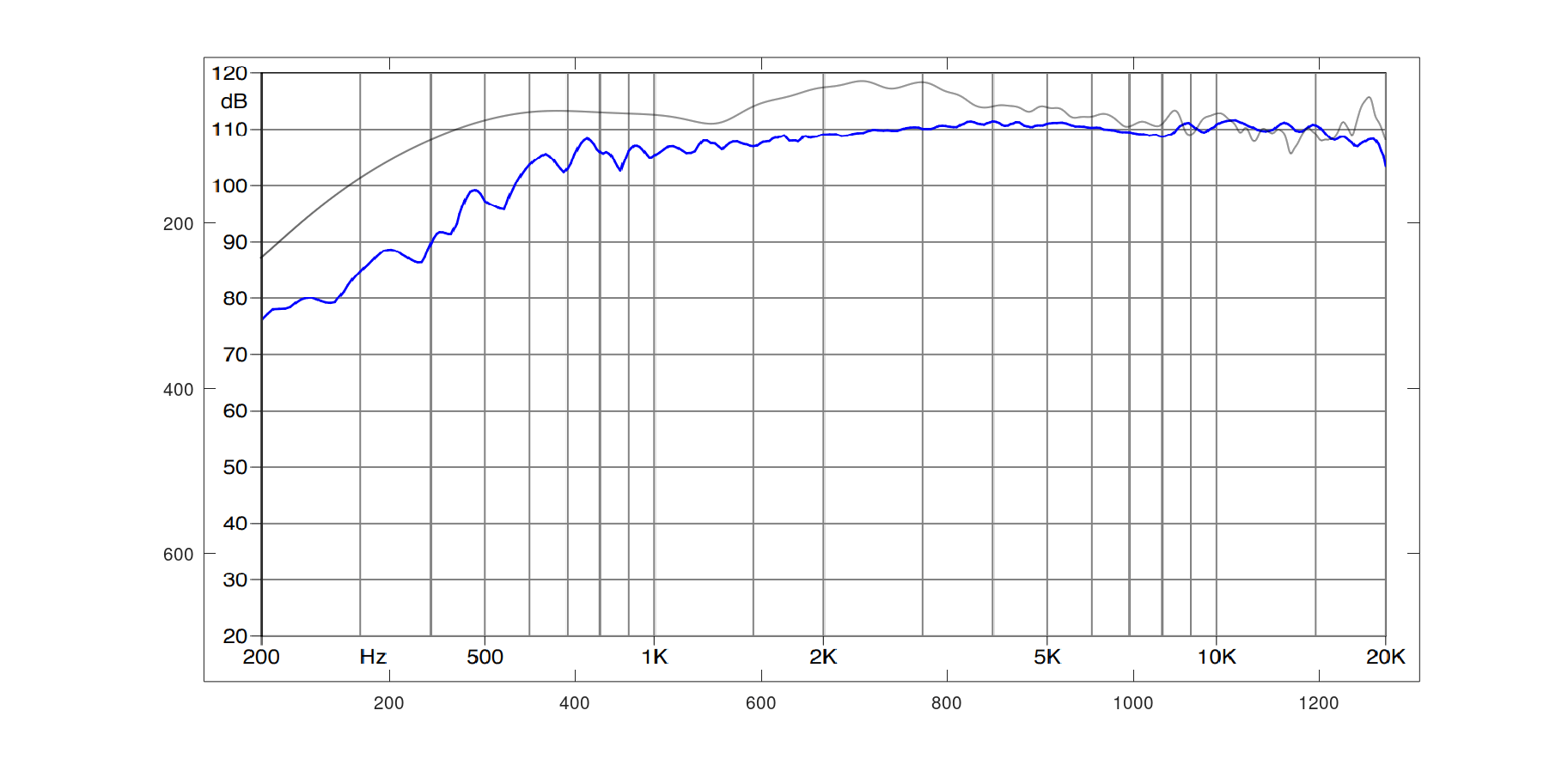

I tested the new waveguide, still in my living room and only on-axis for now. I did do 8 measurements at different distances in order to average out reflections. I did the measurements quite close to the waveguide to minimize relative reflection strength and maximize 'echo'-time. I'm afraid that as I'm quite close, that might have averages out diffraction-wiggles also.
Here is the comparison with the Faital (HF108) factory data:
Looking through some global differences, I think I see quite a good match in the wiggles (scientific term...), although somewhat shifted around 10kHz. Or do I want to see that?
So, what can I learn from this? That seems to be a recurring question. I measure something, I do some processing, and then... blank...

Personally, for a cost conscious design I'd chose the Dayton PA310, Celestion H1-9040 WG (depends on coverage needed) and the Celestion CDX1-1745 driver crossed around 1500 (depending on xover sim results). The PA310 goes pretty low and plays cleaner higher up than most 12s in its price range. 2 cu ft ported puts you in the low 50s hz cutoff range with good power handling if you want to use it with subs in an active system.

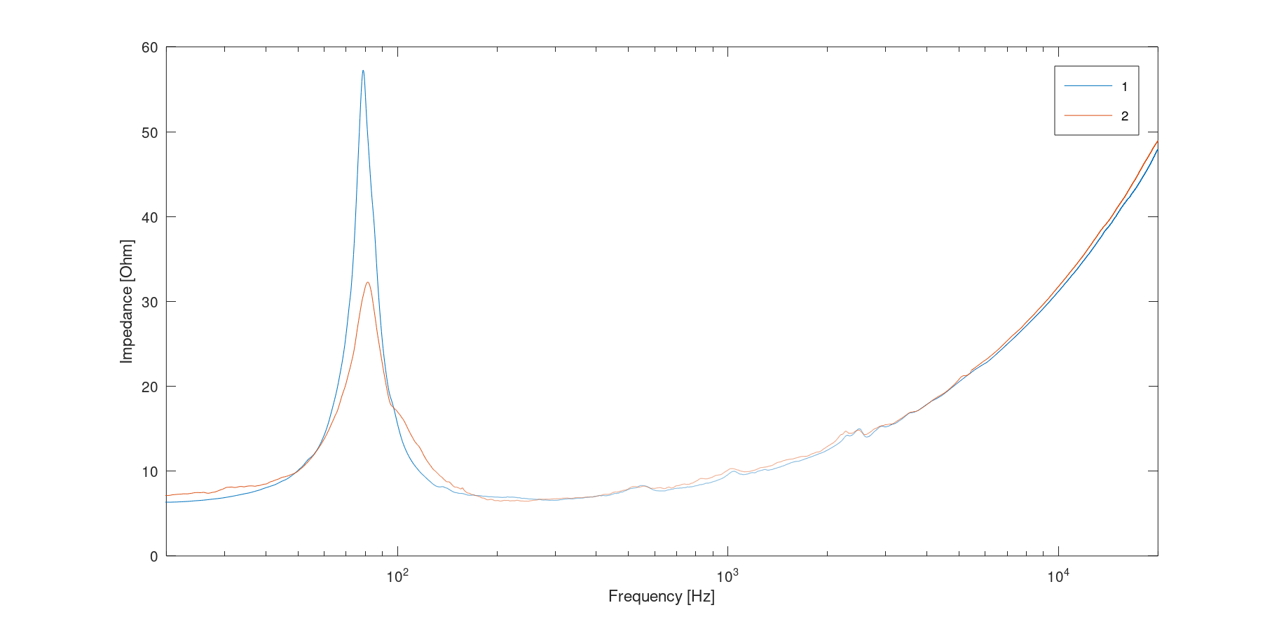

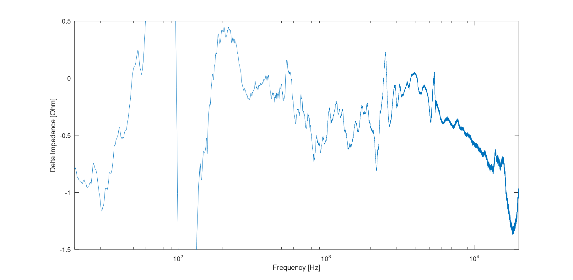

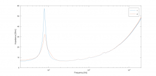

Here is an impedance comparison between the two prototypes:
And here is the difference
It is clear that impedance peak is much lower. A second peak has become more clear. If you look carefully, it is already present in prototype I. Where does that come from? Is it good or bad? And why should I strive for a lower impedance peak (with a low output impedance amplifier) at all?
Given the amount of damping, I was hoping for a very smooth impedance graph, but I think Prototype I has a smoother graph, although it might all be insignificant.

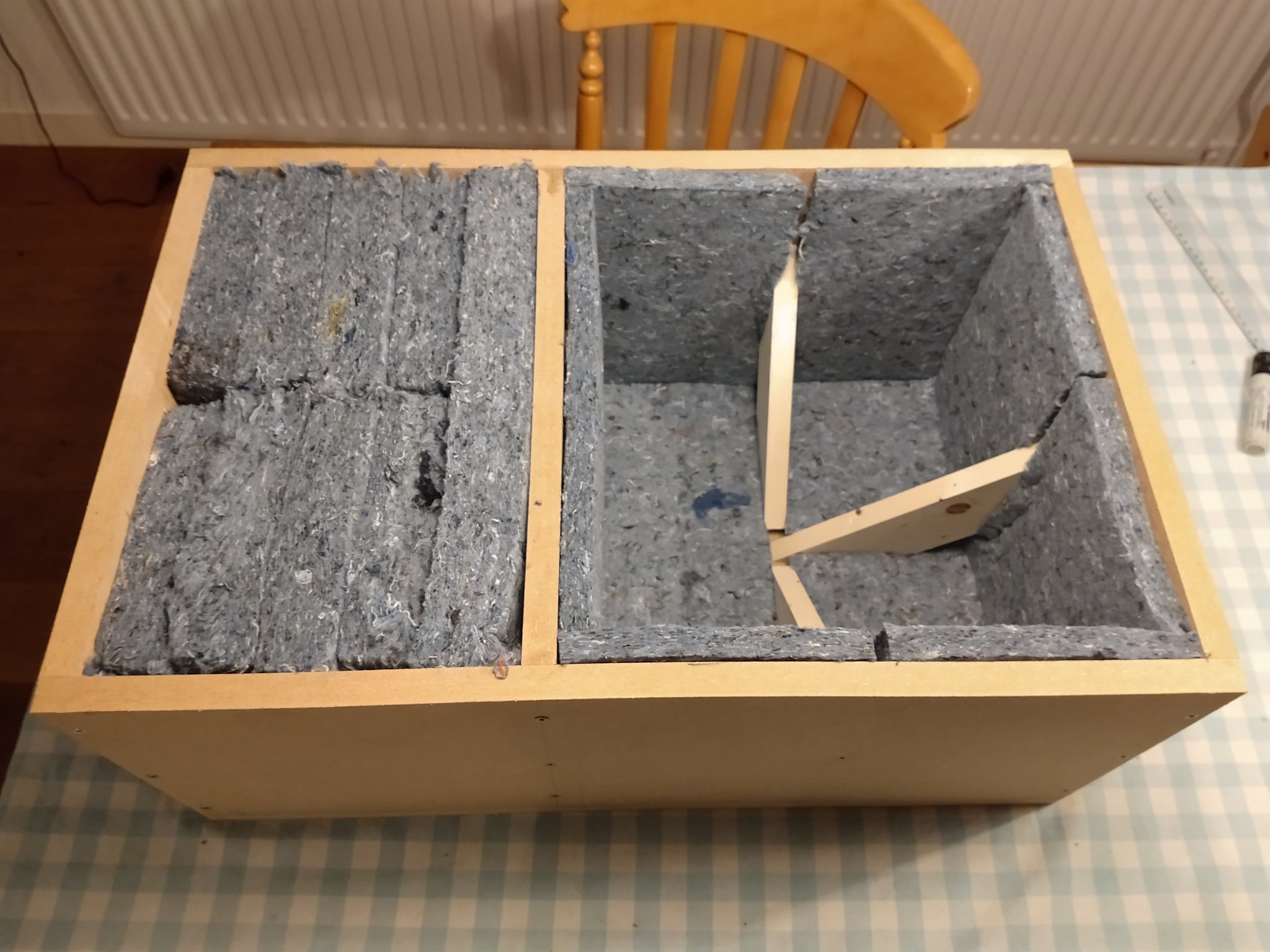

Btw, the double baffle (+ brace) is a no brainer. Virtually no vibration (at low level playing...) vs. clearly 'feelable' vibrations for Prototype I.

Lower peak means more damping. Causes: differences between units (exchange them), leaks in the enclosure or differences in internal damping. I'm too lazy for that now, but you can calculate the Qtc from both peaks and decide if it's problematic. Honestly, I don't think you will notice the difference with your ears alone.

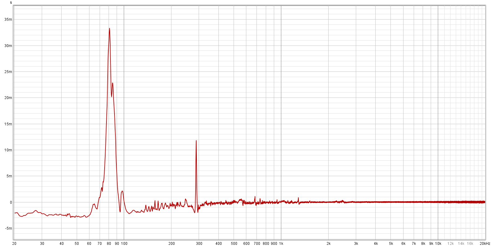

The other bumps are either driver resonances or standing waves in the enclosure, I'd say. I often perform a Burst Decay plot to examine such phenomena further.
The two prototypes are completely different:differences in internal damping

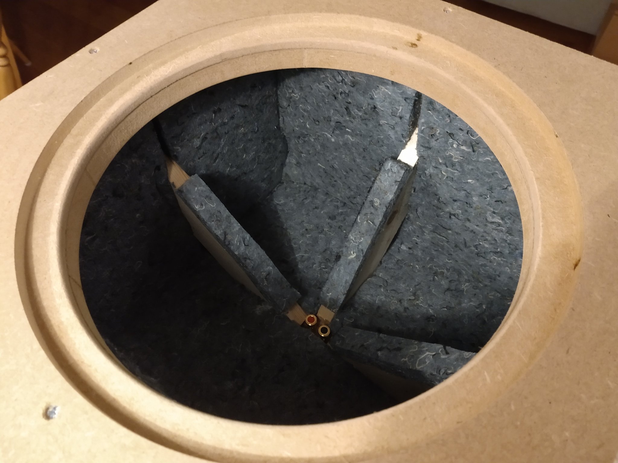

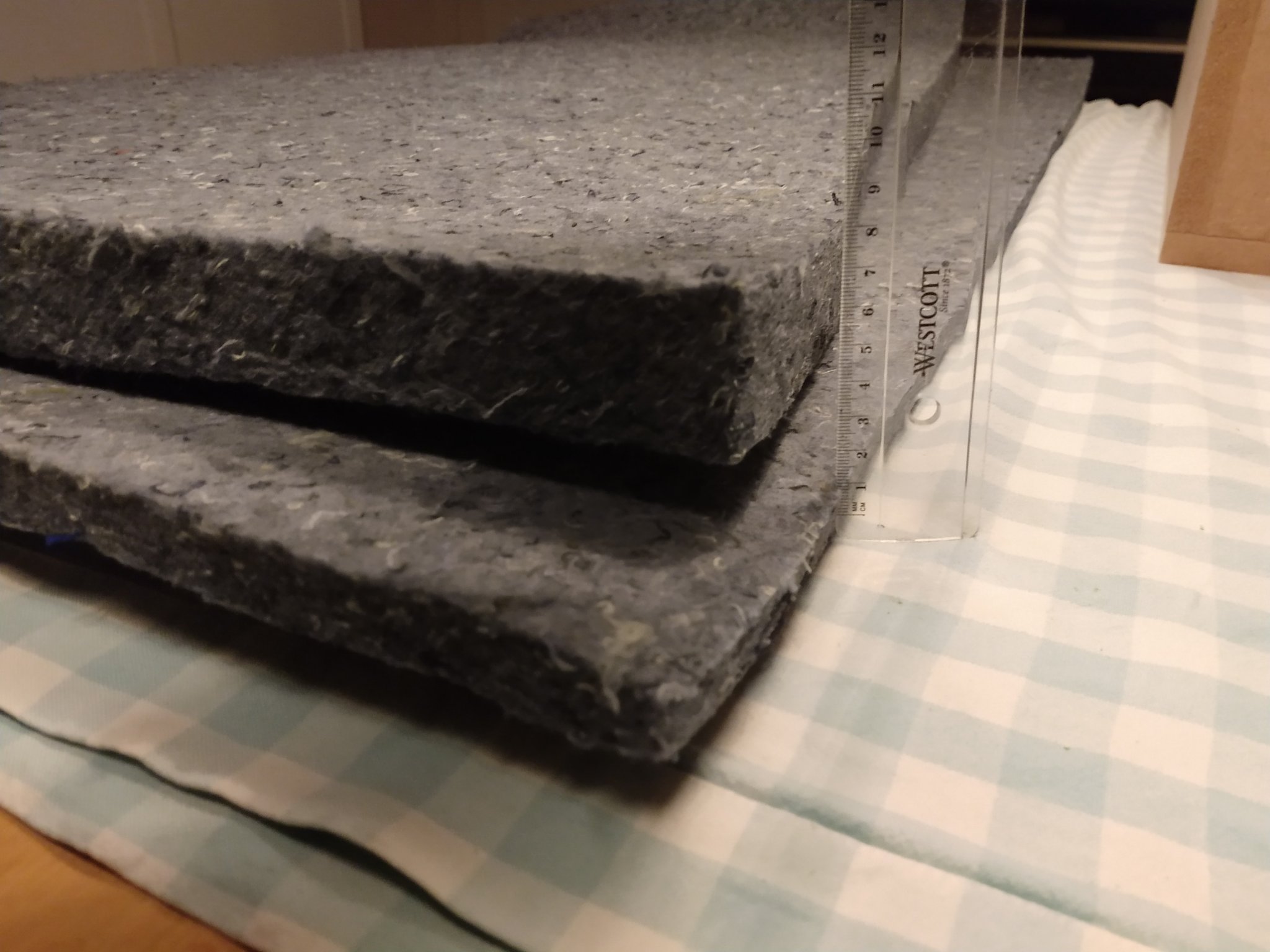

- prototype I has no initial damping nor bracing. I only stuffed the first blanket I could find in it.
- prototype II is braced, has a double baffle and is seriously damped.
The lower impedance peak was expected. But is that good and why? And what about the other features/wiggles/peak?
I'll try to do the test you mention.
I think the other wiggles/peaks are driver related. They should have dissappeared in the seriously damped enclosure, although I am inclined to say the section behind the driver could be stuffed more if you want it to be seriously damped. Did you perform free air impedance measurements?
Yes. Here is a comparison of fee air and prototype I (still without the blanket inside): https://www.diyaudio.com/community/threads/efficient-2-way.380822/post-7237047Did you perform free air impedance measurements?
The obvious wiggles are indeed already present in the free air measurements. I'm nitpicking about the smaller ones in an attempt to learn something.
I think there is too much damping in there, felt is very effective and that is a lot of it. I would probably try a single layer around the outside and a layer on top of the brace for the length mode.

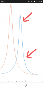

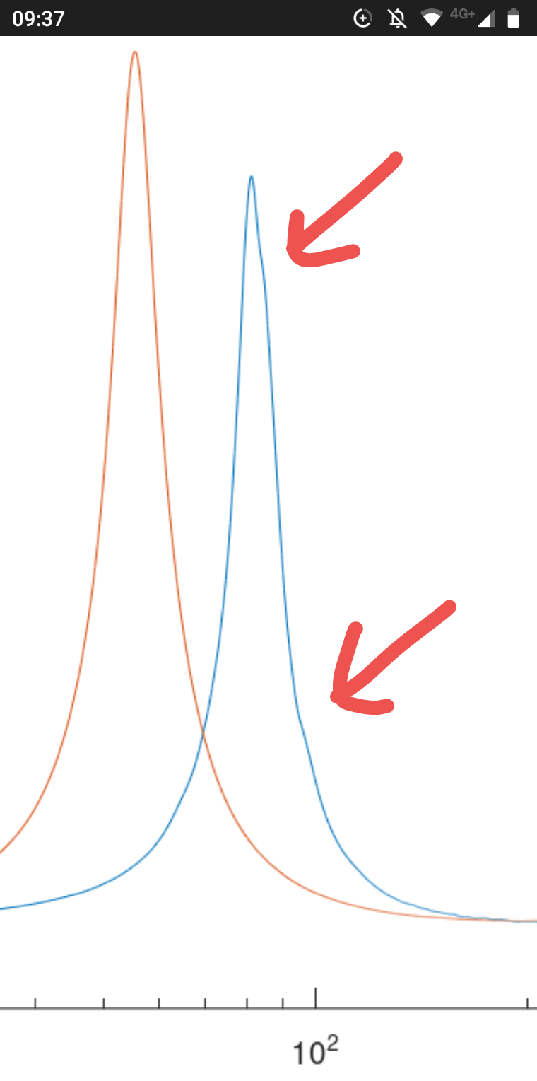

The impedance shape around the peak has become lopsided, the shape to the right is straight and not symmetrical. The damping should widen the sides and reduce the height from lowering the Q but not distort the shape.
The extra stuff other than the driver resonances looks like noise. A clean impedance measurement needs a low impedance source with good current drive like a headphone amplifier or similar power amplifier. Be careful if you go with a power amp not to blow up the soundcard input.
The resistor value should be low too but that puts more demands on the current capability of the driving amplifier. I think extra damping tends to make this look worse too.
It looks to me as the single impedance peak is built up of several peaks: the main peak and some smaller ones. By lowering the main peak (by the damping), the lower peak(s) become more obvious and make the shape lopsided.The impedance shape around the peak has become lopsided, the shape to the right is straight and not symmetrical. The damping should widen the sides and reduce the height from lowering the Q but not distort the shape.
Here is a close up of the impedance peak in an undamped enclosure (early proto 1):
I found out that the GD (group delay I guess) also shows peaks and wiggles where the impedance plot does. The GD looks 'more precise' and might be easier to interpret as ideally it should be a flat line at zero. There is no inherent impedance shape you have to subtract in your head (which I was trying to do by fitting the impedance curve by a model a few posts back).
Unfortunately I'm away from the computer and can't attach a GD graph.
And besides the lobsided impedance peak's origin, why does it indicate over damping and what does that do to the sound? And as the enclosures job is to keep to back radiation from reaching the listener, how can it ever be over damped?

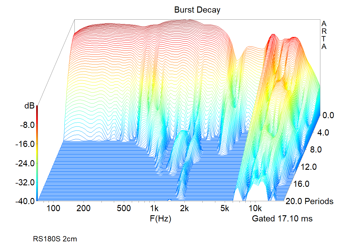

On too much damping: here comes the BD-plot in handy. The enclosure in this speaker (response without crossover) has foam damping on all walls and a piece of foam on a dividing brace. The resonances in the enclosure are obvious and above -30dB plus more than 8 periods. For critical applications I'd add some more here. Point is: measure!

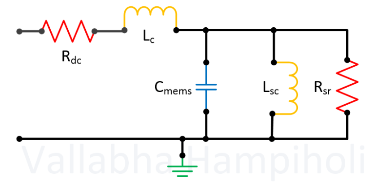

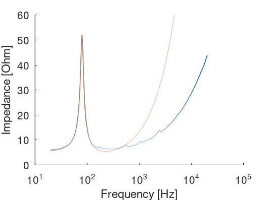

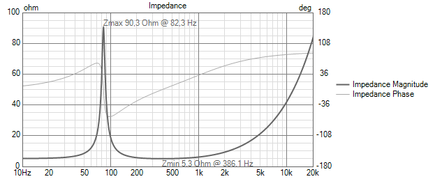

In an attempt to highlight any impedance anomalies I tried to model impedance of the speaker (in a closed box). The plan was to fit that model to the measurement and than subtract it from the measurement.
Unfortunately the fitting does not work well. The model seems off.
Model:
Fit:
Fit was limited to impedance peak.
Full frequency fit.
But the shape of the impedance plot in vituixcad does match my model:
What is going on here?
I found a paper (https://www.researchgate.net/public...uit_Model_for_Dynamic_Moving_Coil_Transducers) that explains this. It is caused by Eddy currents and results in a 'semi-inductor' which introduces a sqrt(jw) term (or sqrt(s) in Laplace) which causes the impedance to rise with 3dB/octave iso 6dB/octave.
I will try to implement the model described in that paper and see if I can get it to fit my measurements.

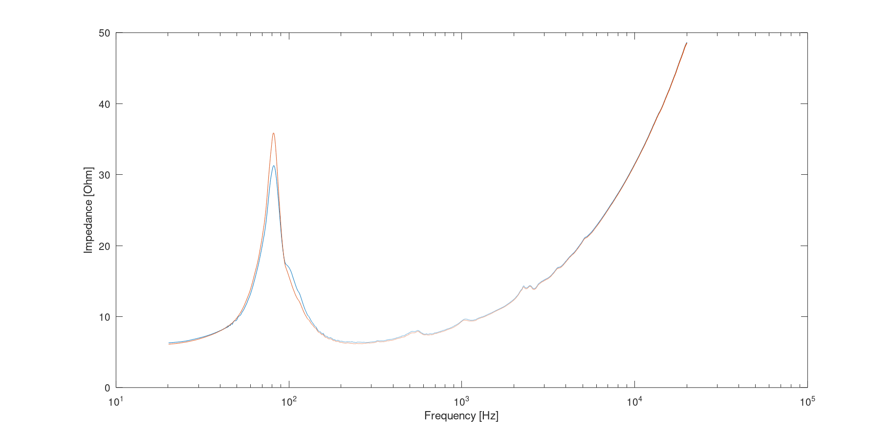

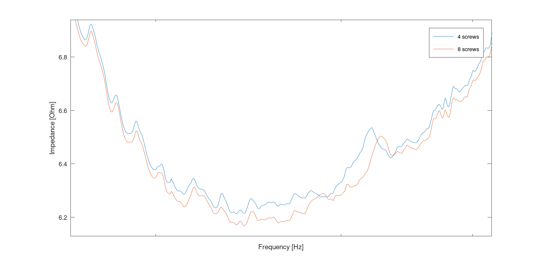

I got my copy of Testing Loudspeakers today and it had one impedance plot that looked kinda similar to mine. It was said the brace divided the enclosure into two resonant systems with their own resonant frequency. That makes sense. That would give me the plot I have.
In the book it was solved by enlarging the holes in the brace, but I didn't think that was my problem. I did have a piece of filt on top of the brace that I could easily remove (as I didn't put glue on it...).
Low and behold:
red: without felt
blue: with felt

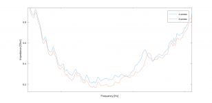

I also did a test with 4 and 8 screws to mount the speaker. Just because. The test results are extremely similar down to the smallest wiggles except for one spot:
difference at 320Hz
So now I have to optimize the amount of screws mounting the woofer to the baffle ;-)
