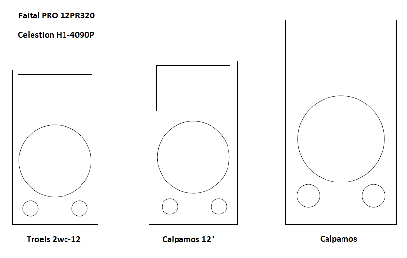

I'm trying to incorporate some of the suggestions above. Here is a new idea: A mix of the Troels 3wc-12 and the Asathor.
For Troels 2wc-12 I've taken the dimensions of the Troels 3wc-12. For the Calpamos 12" I've scaled (the front) by 0.8. Based on these raw sketches, I like the Calpamos 12" best. Width and depth are both around 40cm though. Should I be worried about standing waves?
Is there any reason that you want to shrink speakers?
Small speakers like these require higher speaker stands, so the the space factor would not be that different, and it tends to look somewhat unbalanced in a room due to high speaker stand.
There are some advantages choosing 12" besides space factor, so it's all depends on your goal, but 15"+horn sound different from 12"+horn, and I generally prefer 15".
If you were to sacrifice some depth to suit your needs it would still be a good design
I could go for lower to no speaker stand and use that for enclosure volume. Also limiting the volume to 150l and tuning the ports a bit, doesn't change things that much according to VituixCad. Depth of 40cm should be possible and looks a lot better (using my 'prototypes').
