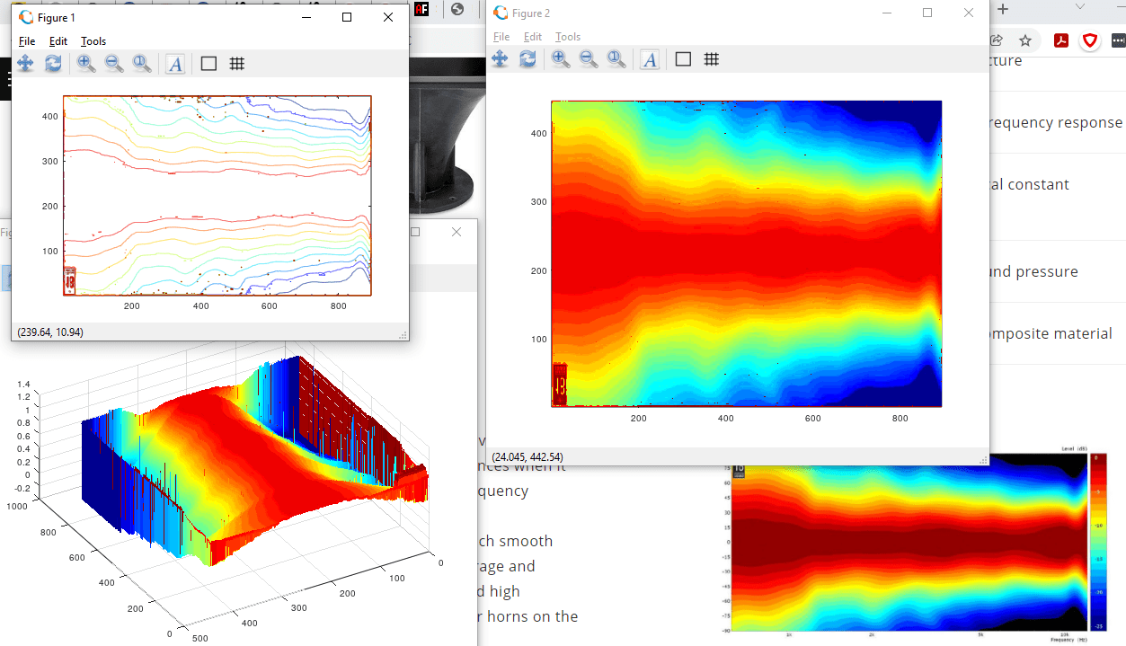

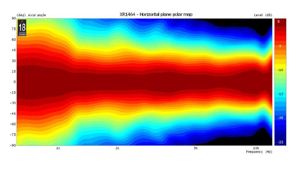

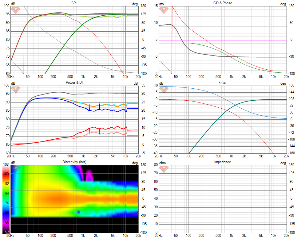

I think I need to get the polar map of the CD+horn into VituixCad. So I made something to get the data from an image:
I think I might be able to generate the frequency responses used in VituixCAD from this. Am I right or should I abandon this?

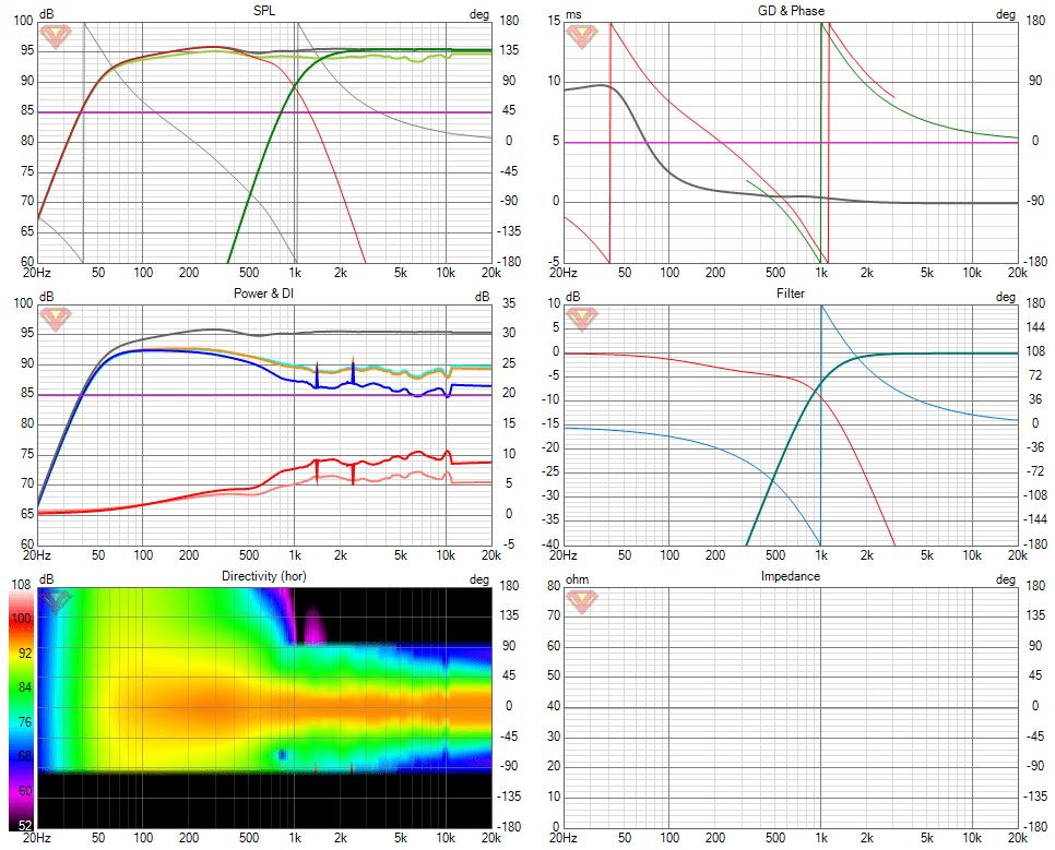

A bit rough around the edges, but i'd call it a proof of principle
Some weird spikes in the directivity, no impedance 🤔
The blue dot is the 18Sound logo in the data source:
What would the directivity look like using a 4th order crossover? The transition looks pretty sharp with that 2nd order filter.
That will have to wait till tomorrow. 4th order would be sharper right? Or am I missing something (because of my English)?What would the directivity look like using a 4th order crossover? The transition looks pretty sharp with that 2nd order filter.
Polar seems somewhat better. More gradual at 1-2kHz. And generally speaking your vertical polars would benefit from higher order.

Tom Kamphuys ... like markbakk pointed out, was curious if the polar transition would relax a bit. I think that horns' directivity is too narrow for home hifi.
