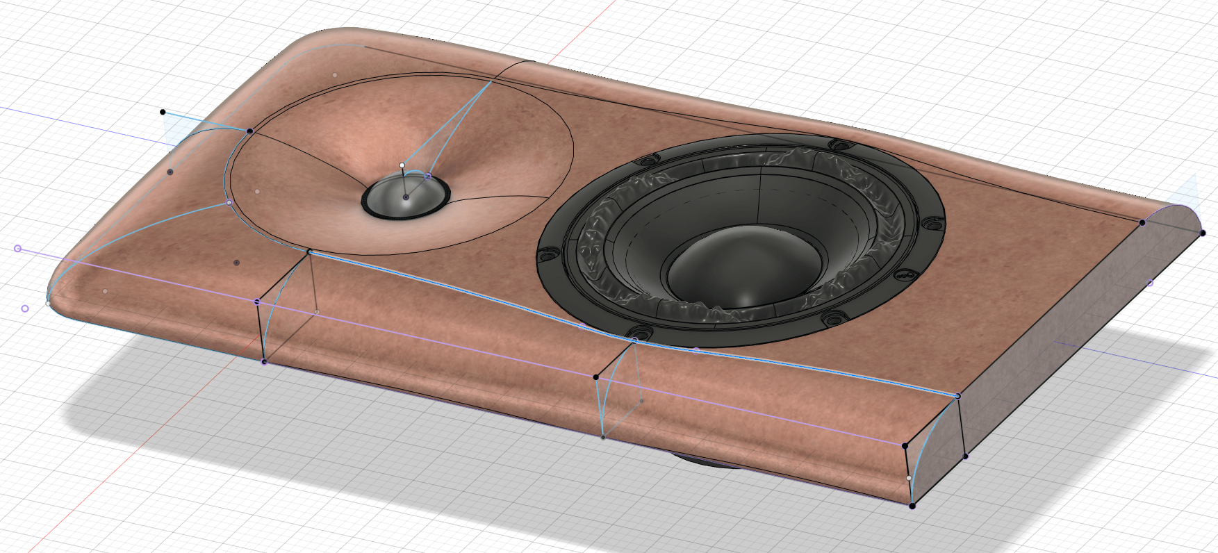

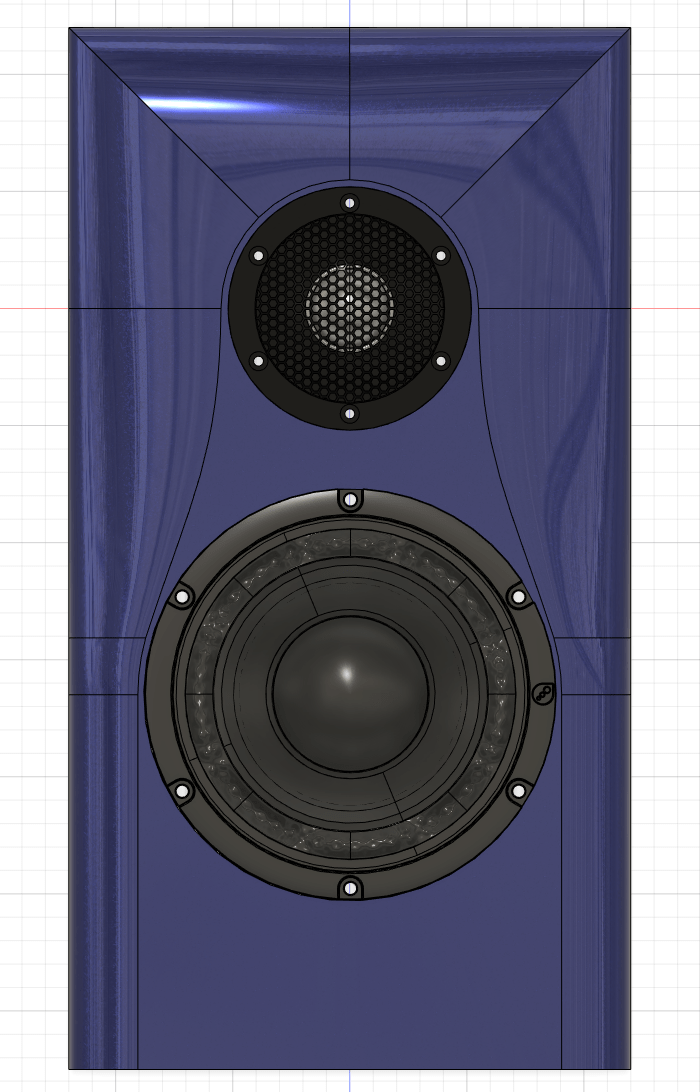

Ohhh this is very nice. I was trying to loft from the wood to the driver. I see you lofted using a rail from the bottom and then used a revolve to cut out the tweeter. Very clever.That will make a difference but it is not likely to be a positive one. Creases are not good and making something like a waveguide start at the edge of the tweeters faceplate is also a way to introduce negative diffraction effects.
This image shows where the edge rounding starts and as close to the drivers as possible is a good idea.
For a non waveguided approach this is an option. The ridges and sharp corners are not ideal and their diffraction effects can still be seen, that can be avoided by rounding all the sides as is shown in the waveguide version above.

Shouldn’t the top be rounded too. Like the Theil? Rounding the sides and top but not the top side edges is maybe not thinking the problem through? I’ve always thought that since sound travels at the speed of sound that loudspeakers should be built more like fighter planes from WWII. Smooth curves no obvious angles or sharp edges.That will make a difference but it is not likely to be a positive one. Creases are not good and making something like a waveguide start at the edge of the tweeters faceplate is also a way to introduce negative diffraction effects.

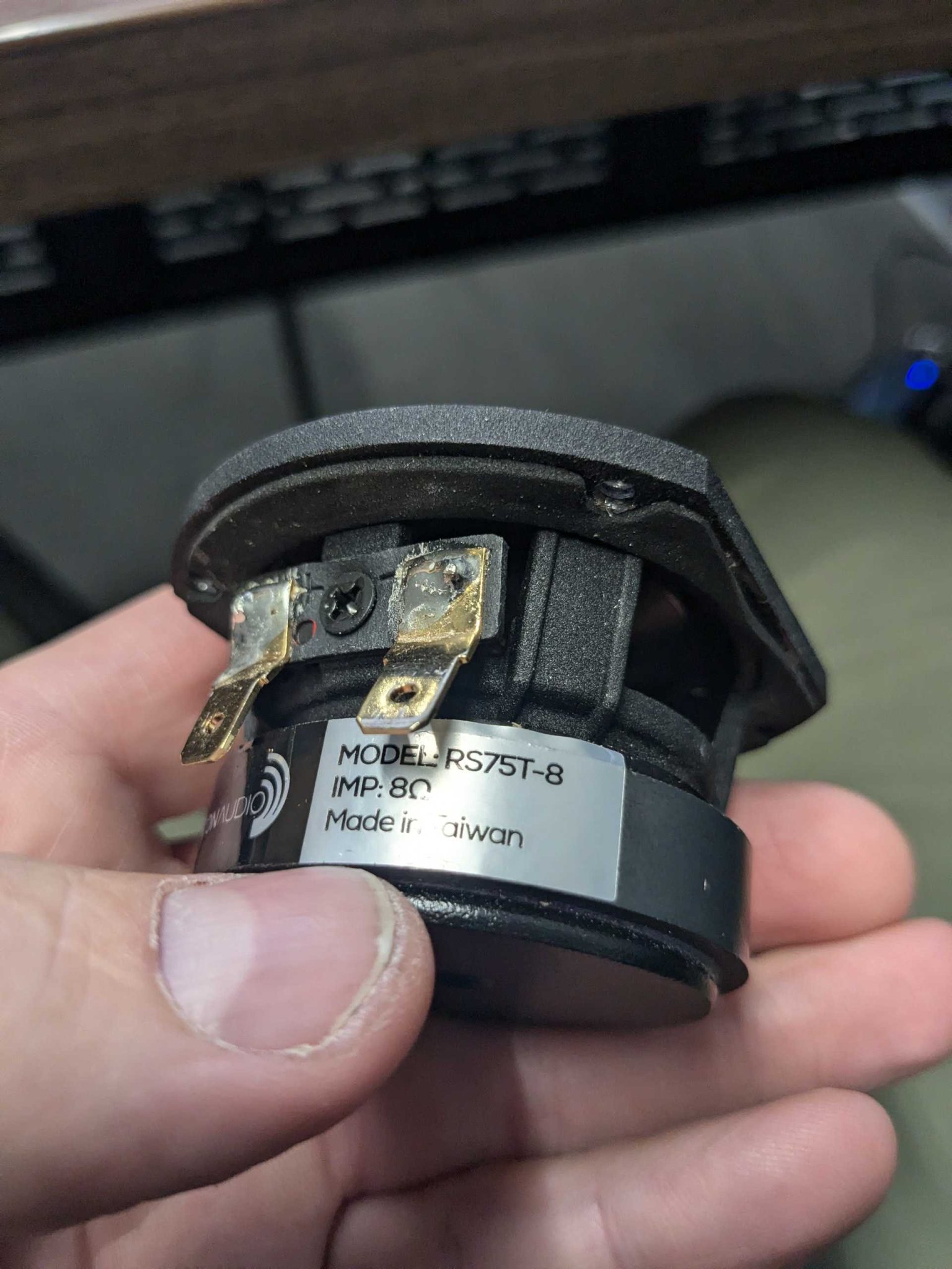

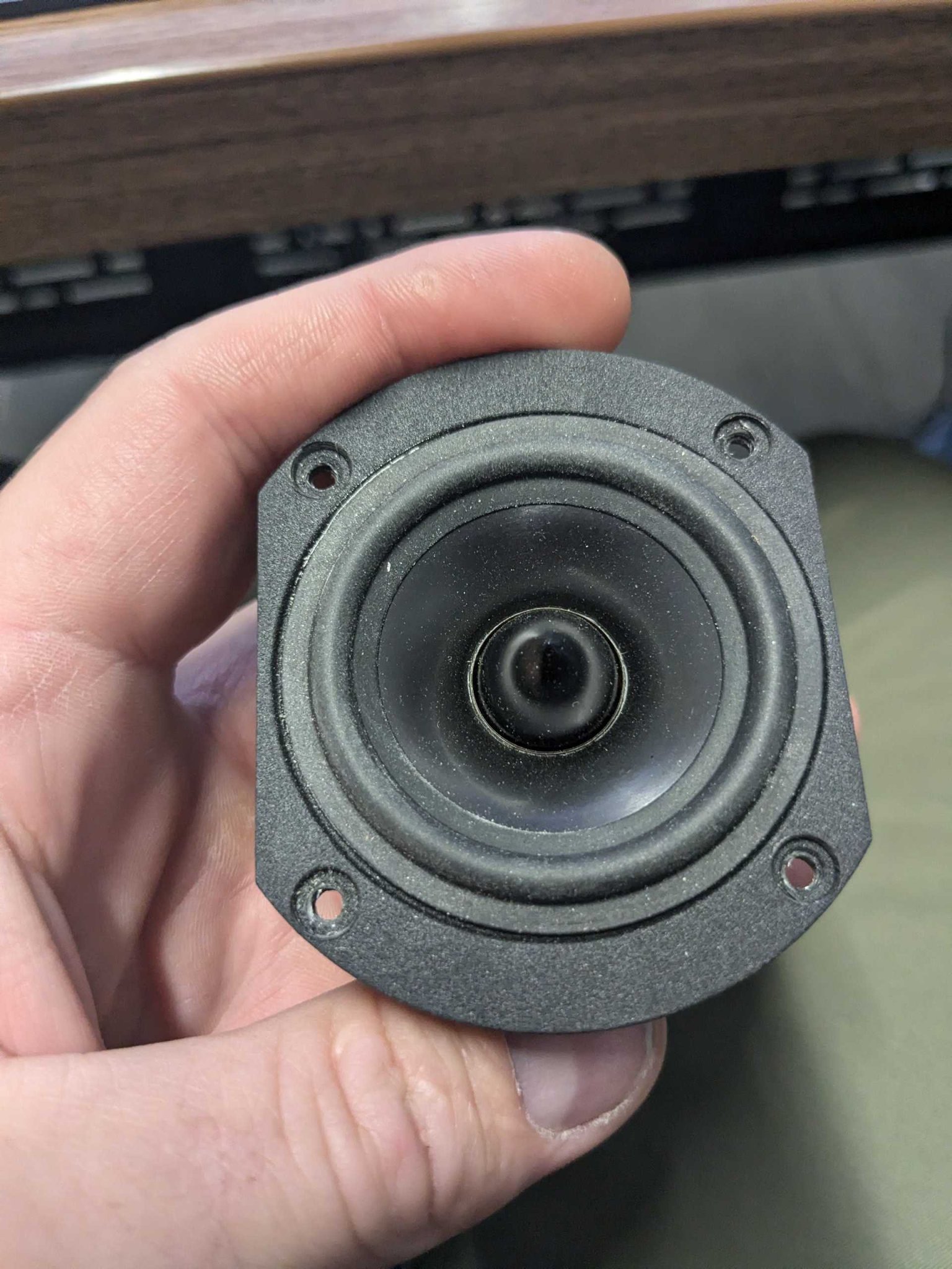

I have the one driver here I can use. I think this is 2"
Would be even better to use a 1" driver.

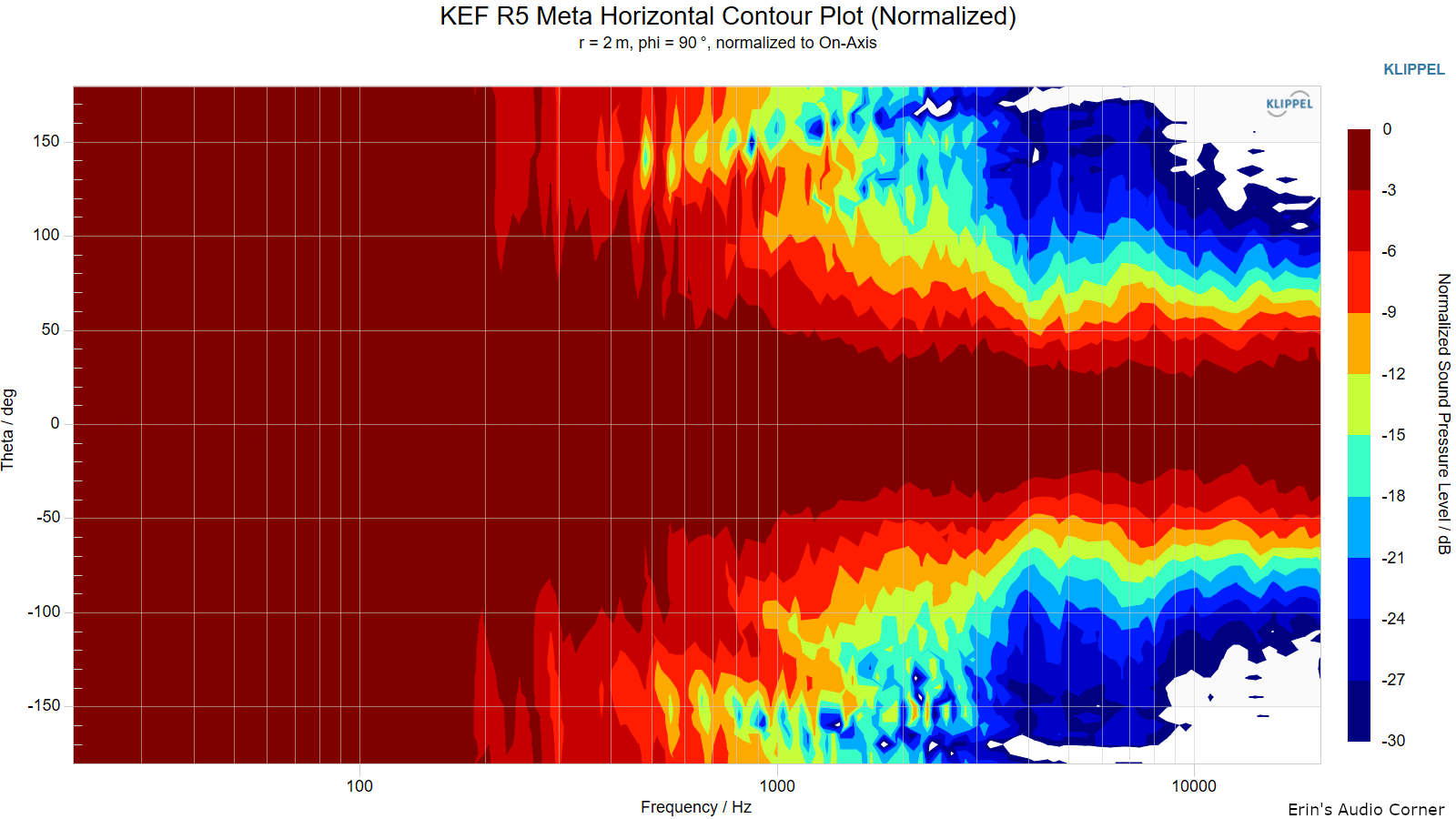

KEF engineers have long tradition with diffraction control. A. Jones was one of them and now J. Oclee-Brown.
KEF R5 coaxial MT with rounded frame, but the box has sharp edges. Excellent outcome, but not perfect! https://www.erinsaudiocorner.com/loudspeakers/kef_r5_meta/

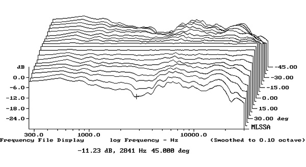

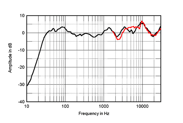

A good bad example are B&W speakers with more or less teardrop enclosures for M and T https://www.stereophile.com/content/bowers-wilkins-801-d4-signature-loudspeaker-measurements

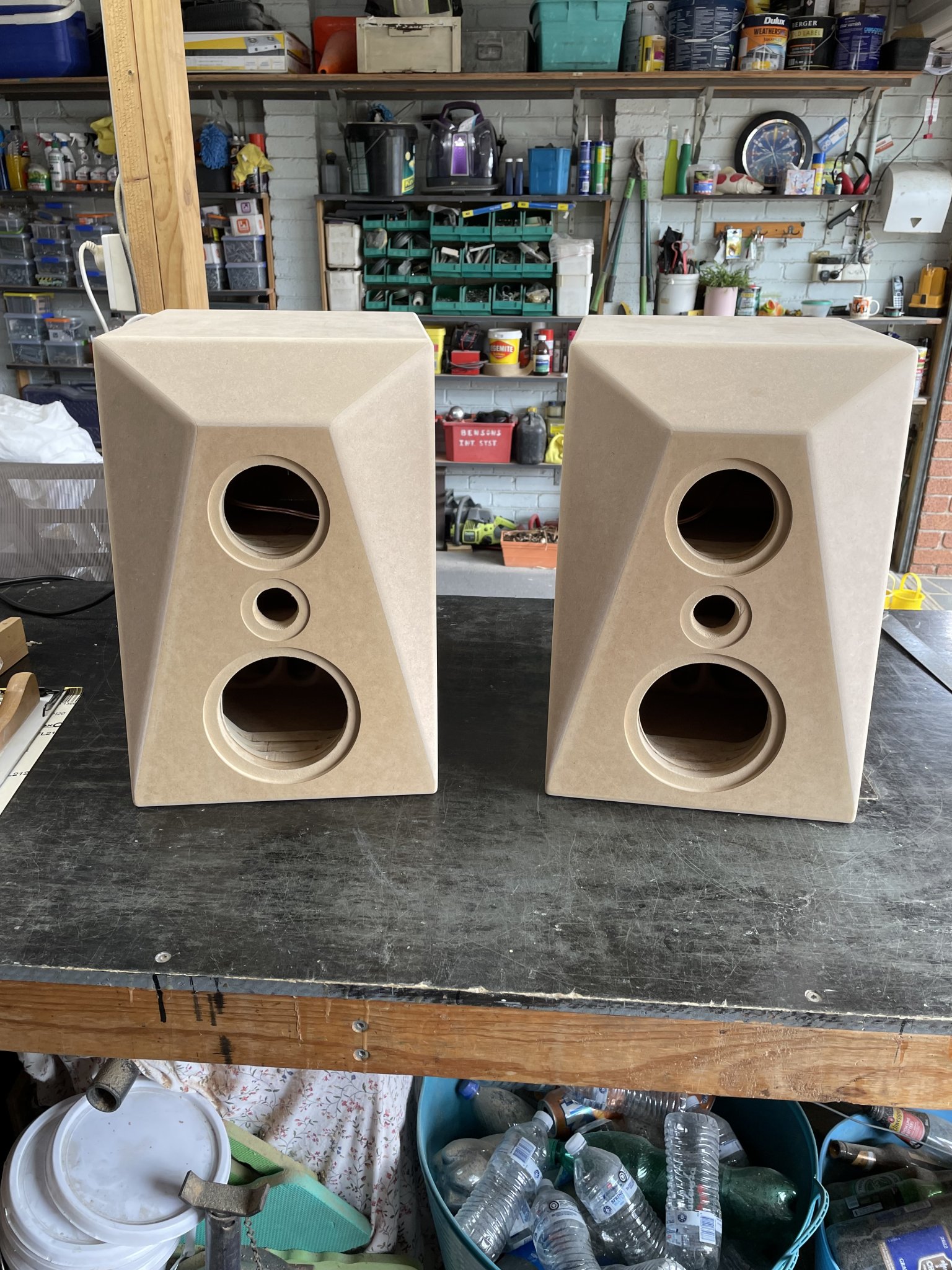

I once chased some sibilance in a small speaker. The low xo, small baffle size, and roundover seemed to be the cause. The round edge of equal distance from the driver caused what I call a "disco ball decay". You get a nice and even power but humps in the decay.

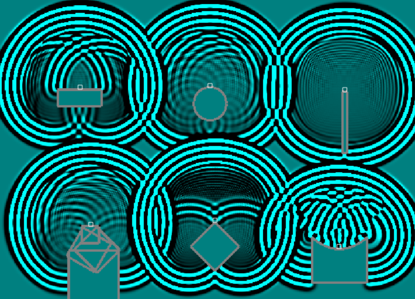

from an old post: A 2d ripple of baffle shapes (this is assuming the driver is a point source)
Thats very interesting and a great help to visualize what is going on. The diamond box makes my head hurt.
The top edge above a tweeter is surprisingly tolerant to less than ideal shapes. Thinking the problem through does not always lead to good answers, acoustics is an unintuitive discipline. There are a lot of interactive factors that can change the result. The best results can be from accidents as they don't immediately look as if they would be a good idea, but actually are.Shouldn’t the top be rounded too. Like the Theil? Rounding the sides and top but not the top side edges is maybe not thinking the problem through? I’ve always thought that since sound travels at the speed of sound that loudspeakers should be built more like fighter planes from WWII. Smooth curves no obvious angles or sharp edges.
A shape that is designed to have no diffraction will also have no directivity. In a design where higher directivity is desired the diffraction needs to be managed rather than eliminated.

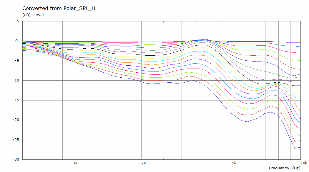

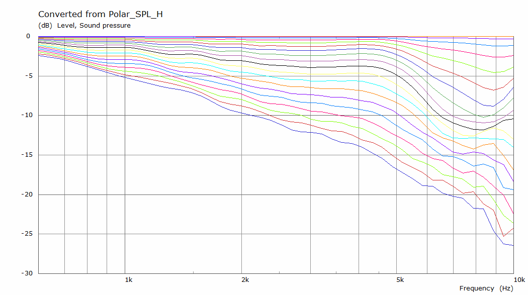

Once you explore how the entire shape of a speaker affects it's response you can see how there are more factors available to tailor the response to a target as well as reduce obvious issues. For a long time on axis measurements were all that DIY designers looked at, diffraction related ripple is very obvious in those. Once you have a full polar measurement set a different picture emerges.
What happens and why after the baffle ends isn't that well understood across the board.
There is an example here of how the overall directivity and smoothness of response can be changed quite considerably from the enclosure shape.
https://www.diyaudio.com/community/...ver-full-range-line-array.242171/post-6524791
I built the uglier looking one as I didn't appreciate or understand the impact of cabinet shape at the time. The 3 to 5K region has always been tricky to equalise and the graphs show why.
