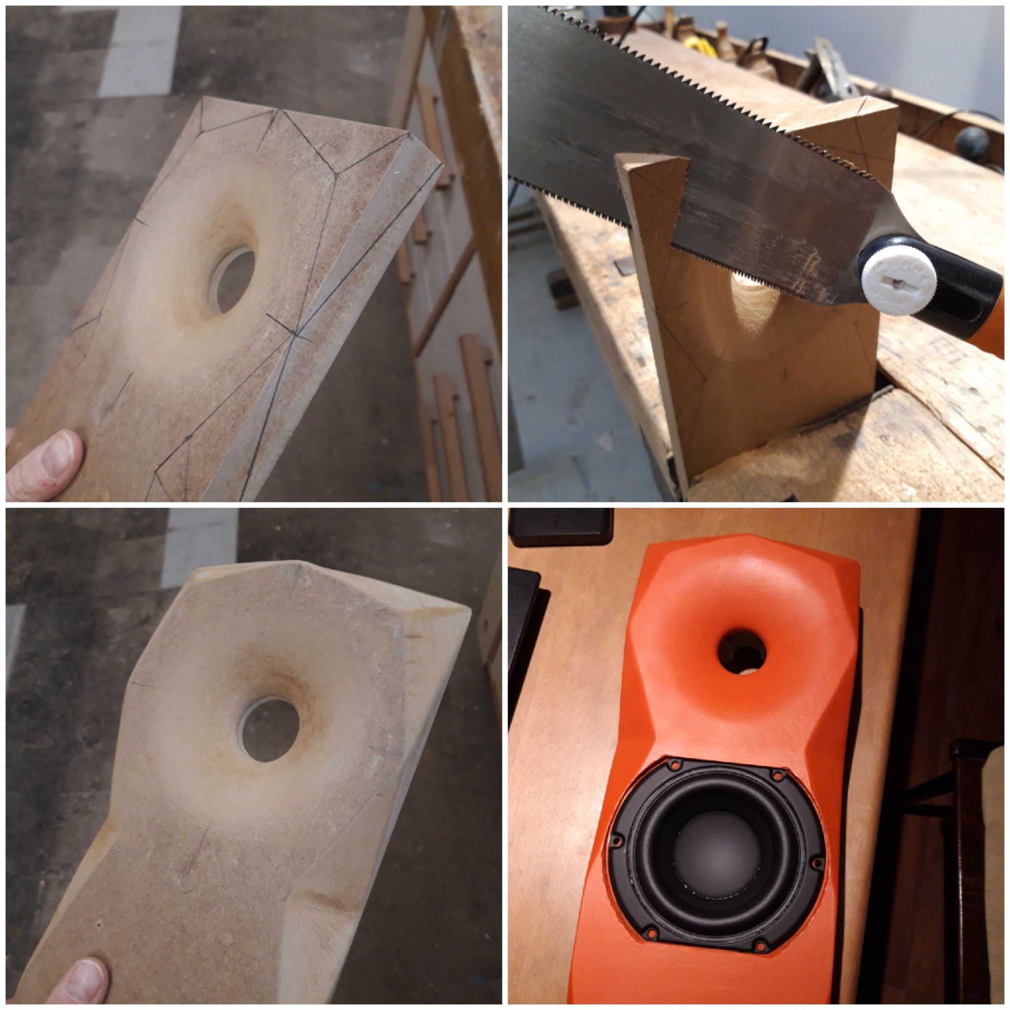

I am going to try these out on the tweeter. I have been interested to see what these actually do. I see them a lot on factory builds. Possibly they are mainly cosmetic. The data will tell the truth.

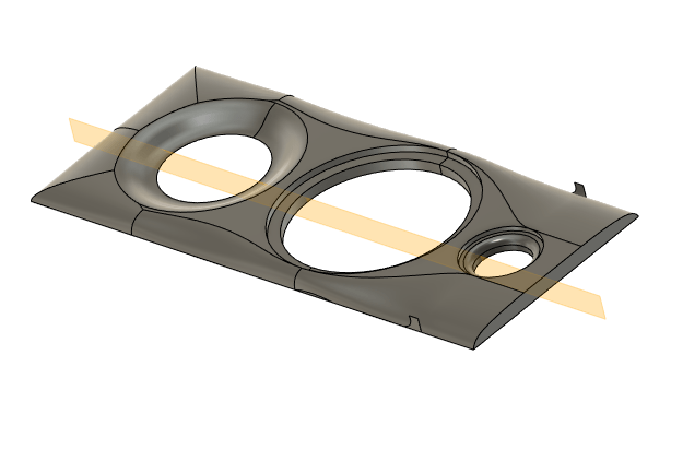

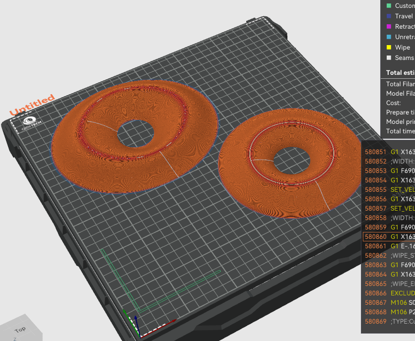

One is oval. The other is perfectly round. Picture is what they look like in the software that slices the model into gcode the printer can use. They will not be orange in real life.
I honestly have no idea what they are. I think it's a mix of wavwguide/diffraction.
The circular one is more tame. The oval one is quite aggressive. Will be interesting to what it does. If it does anything at all

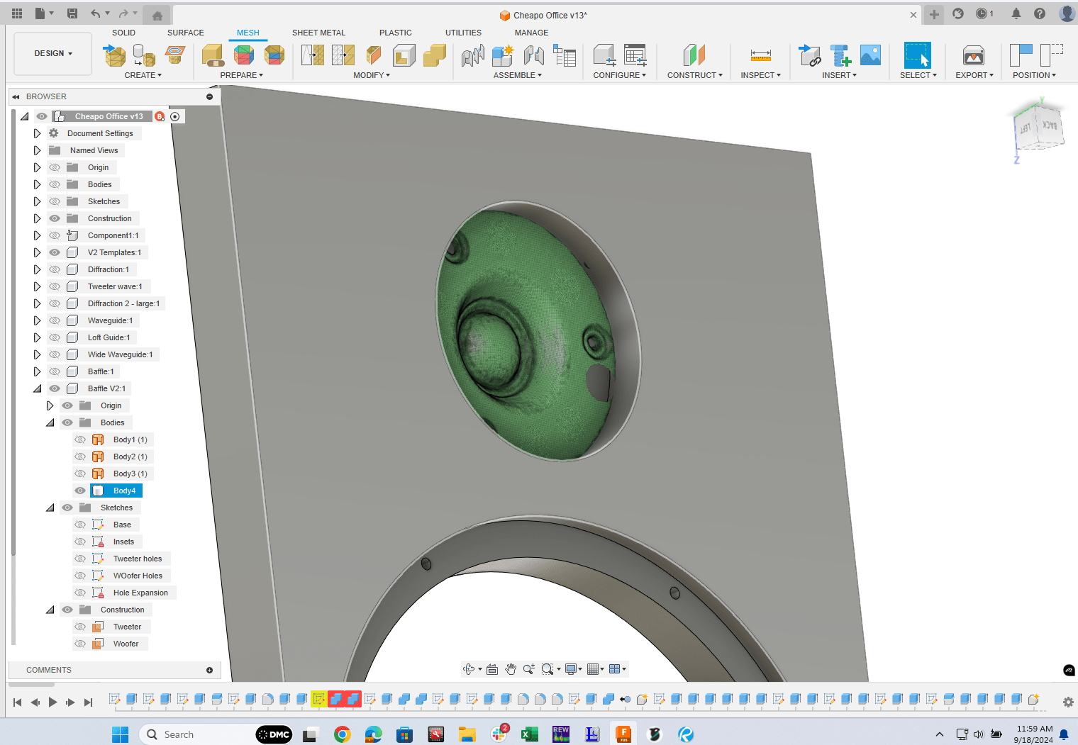

This looks better, but I would suggest that you try and extend the waveguide on the tweeter from where the round over starts. Making a second waveguide some distance from the first waveguide will introduce more negative diffraction than it will solve. A smooth extension of the existing waveguide into a larger termination will have a beneficial effect if done correctly.Well this took forever.... gonna test it.

You can do it that way if it is easier but I imagine it is a simple radius that you could approximate with a ruler or calipers and make a test piece to fit in. It doesn't have to be a perfect match but ideally you would gradually transition from the existing waveguide profile, (which looks fairly conical in the pictures, maybe not in person) in a nice smooth way to the eventual round over on the cabinet edge.

The way I see it, I either leave that waveguide alone and start my new one further out or I spend the time to get that transition perfect.
I'm no expert but I imagine incorrectly transitioning a waveguide is going to have a lot of nasty effects on the response
You have that backwards, Trying to start another guide further out will create more destructive diffraction at a higher frequency, due to the shorter distance than leaving it alone.
The transition does not have to be perfect, the main waveguide sets the bulk of the pattern, all you need to do is smooth out the termination. A little bit of blue tack or putty will work to fill any gap for testing if it is needed.
The other option is to do what you have done with the woofer and mount the tweeter in the extra baffle plate and make the transition from the edge of the face plate into a smooth edge shape as close as possible.
You want to minimize the curvature change as much as possible to minimise diffraction. Once the sound has diffracted from the waveguide mouth to a flat surface such as the faceplate or baffle putting anything else in it's path narrowing the pattern will create a secondary source that will interfere.

The good thing about the whole theme is, if you are into building real speaker cabinets with "normal" tools and equipment, a reasonable 25-35° edge on both sides of the baffle will get you 95% of a perfect result. Not so surprisingly, a compareable rounded shape is just as good as a simple cut. Both can be realized with basic tools. These options are not only simple to do DIYS, they will lead to an accepable look, too.
