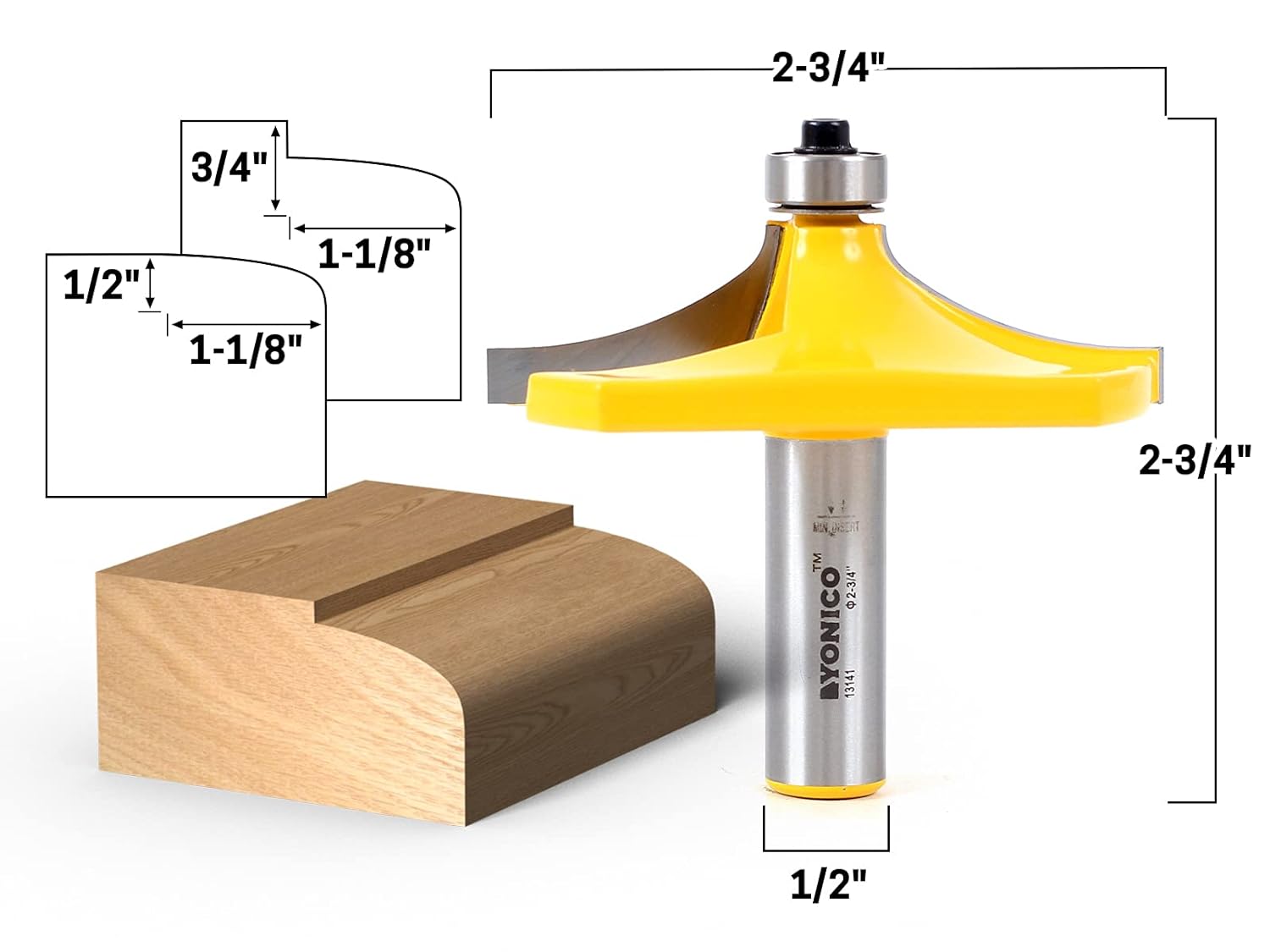

What would be helpfully scientific to compare three edges on a similar box... perhaps like Olson's box "k".
- square edge
- constant radius roundover, maybe 1/2:
- thumbnail (parabolic) roundover
Curves like those Olson published would help with comparisons. Thanks.
- square edge

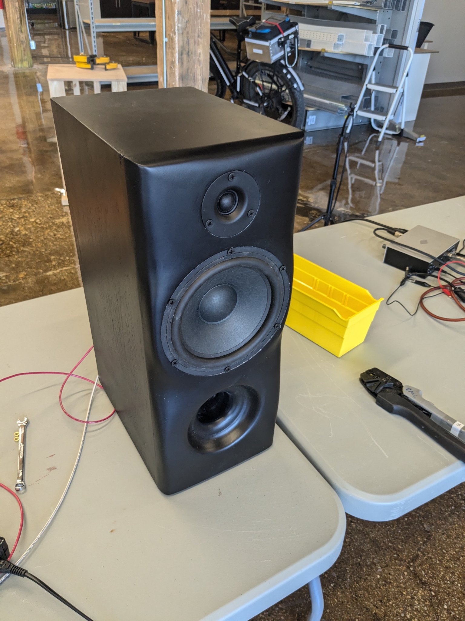

I did the parabolic one and it's about at best a 2 db difference off axis in diffraction. I made a pretty intense baffle, basically best case scenario, and the result off or on axis didn't change much.
I have concluded that small inprovements like these are minimal at best. To get a large improvement the entire shape of the enclosure would need to change. If you search through the rest of the thread you'll see the data

Check post #155. It has the results from the on/off axis between a perfectly sharp 90 degree edge and and that very fancy diffraction baffle I designed and made.
If nothing else, it does look amazing.
This baffle is what was tested. It is very similar to the router bit you showed just 5x more aggressive as the curve starts right at the driver's edge and goes all the way to side in an increasing arc.
