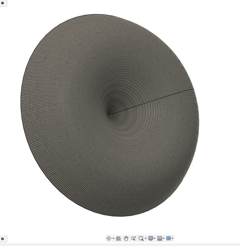

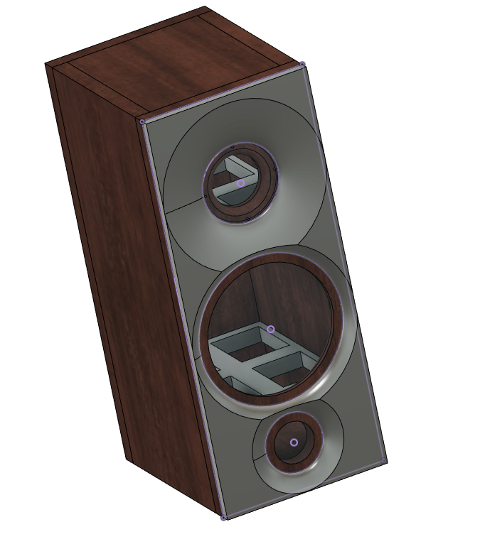

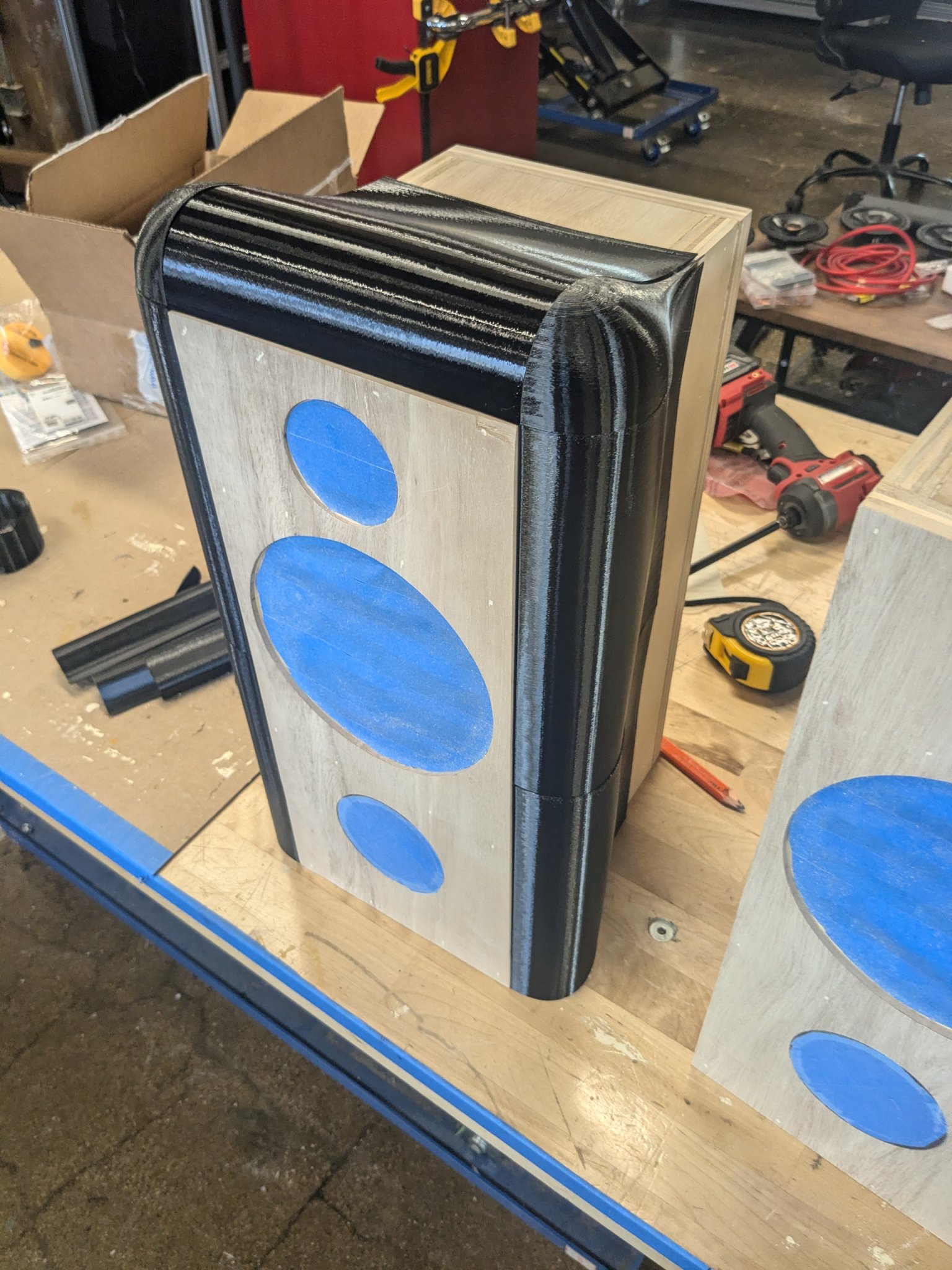

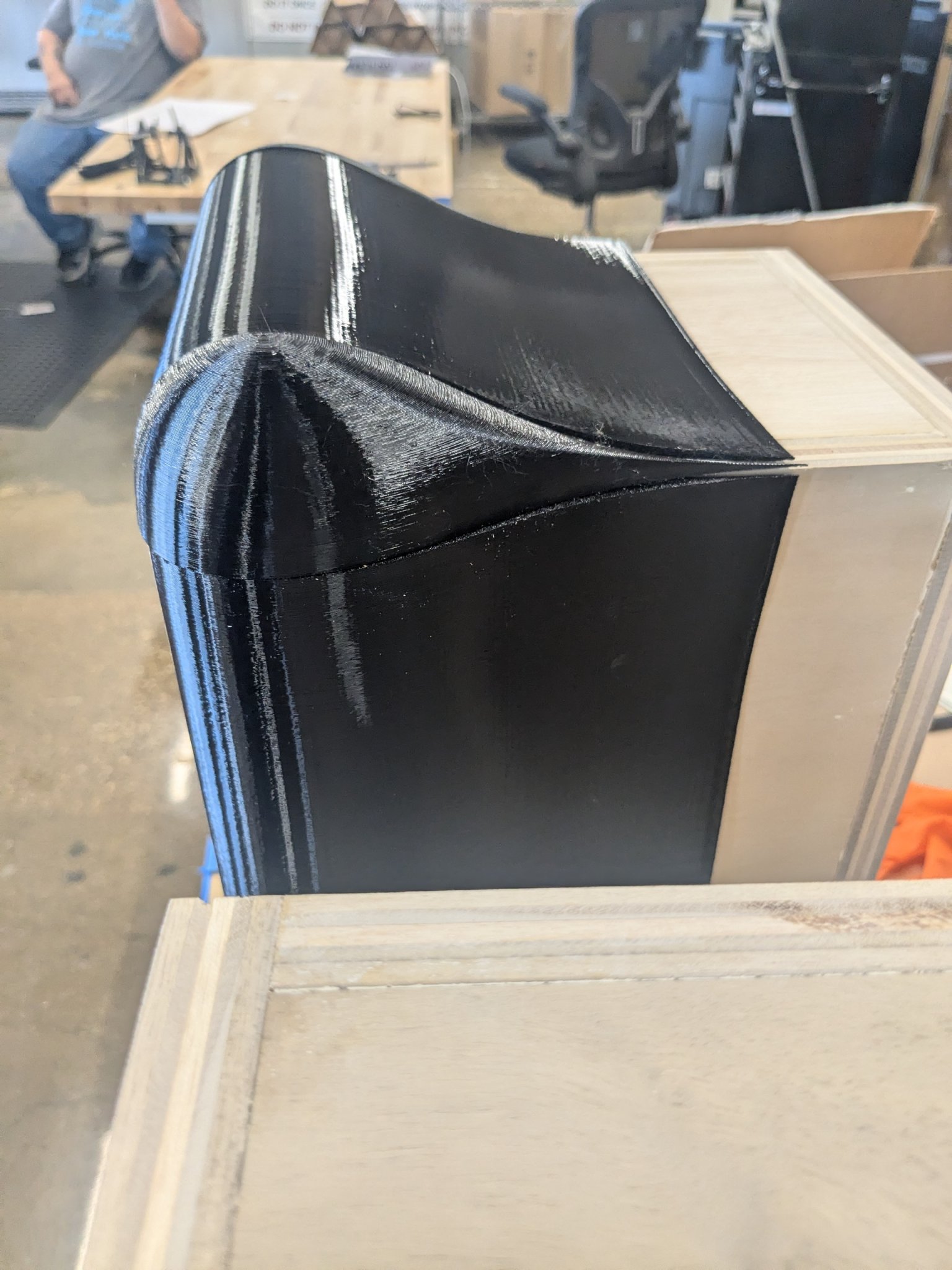

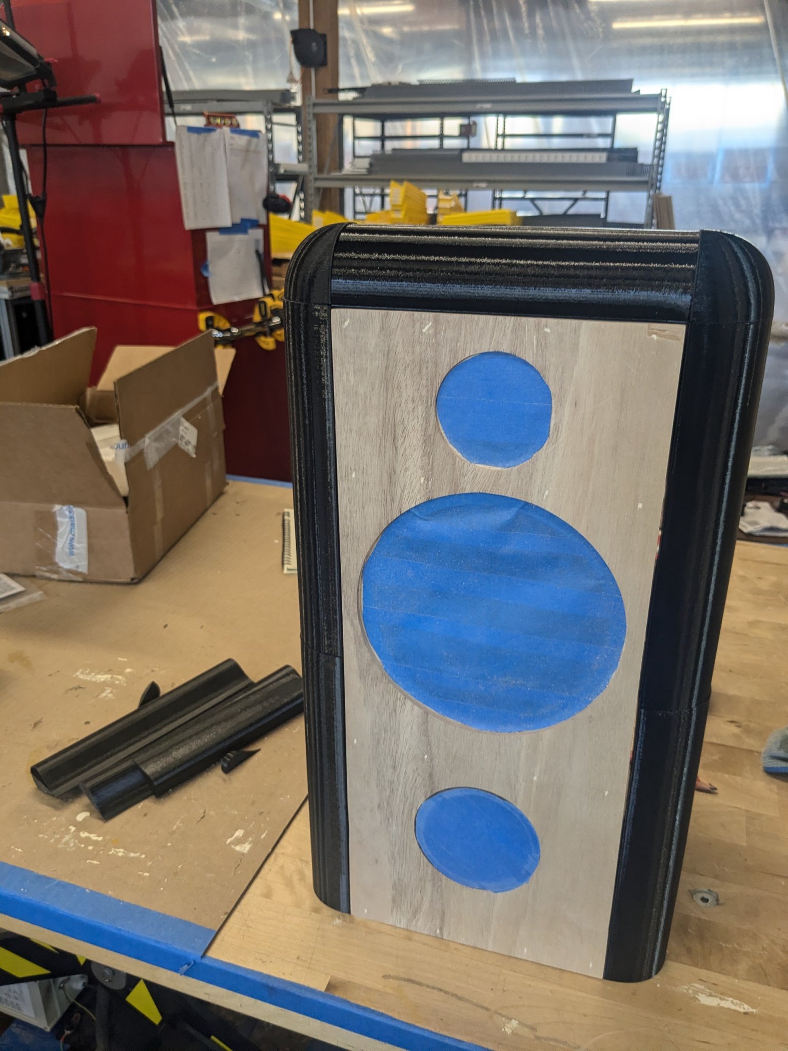

To spice up my boring 2 way build I am going to try some 3d printed edge diffraction pieces to see what difference they might make.
I will be starting with this aerofoil/teardrop shape. This is a pretty small one but I can make it wayyyyy bigger which is probably what I will try next.
Does anyone else have a shape they would like me to test? Let me know. Let's do some science!

Hornresp has a 2d pixel based editor as one of its features, which lets you experiment with various baffle profiles and see what it does to the coherence of the sound waves as they expand out from the cone.
One 'ideal' is probably on a continuum between a heart-like shape and an aerofoil, depending on how much horn loading you want. But I'm talking about a continuous curve with no 'bumps' if you run a finger from the edge of the tweeter dome, along its wave-guide, and all the way out to the back of the box.

I would start with half round or quarter round, I guess eventually you end up with a sphere, then an egg. If you are going to shape the sides and back, then go gradually to a tear drop shaped enclosure. Where it gets interesting is the transition between drivers. Also, it would be interesting to see the difference between a tweeter waveguide turned into a drop shape (Abstract’s idea) and with a highly streamlined no edge tear drop shape like the Nautilus.
Yes, midrange is affected down to 250-500hz approximately, where the room takes over and the enclosure becomes relatively small. For example no one puts edge treatment on a subwoofer, the waves are so huge and the box is relatively very tiny.
There are horns where the trailing edge curls back on itself. Kind of like a fractal or organic curve. Maybe you could print an edge like that? It would be big though, lots of material.

Baffle edge diffraction is red herring…..if a baffle exists, regardless of its edge treatment, there will be diffraction. The issue isn’t or shouldn’t be how it effects the frequency response but instead how it effects directivity and power response. Best case scenario is always going to be no baffle at all……..impractical for most. The effective compromise will be the smallest baffle possible.

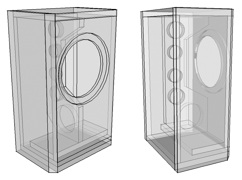

I think you would enjoy learning to model baffles in the available free software. Visaton's boxsim is excellent but some what limited in the geometry you can create but produces every test plot you could want in a single click. You can open the example project and then simply change the shape and size of the box / baffle as well as move drivers around on the baffle and test things in just a few minutes. The example is a two way speaker. You will find that perfectly centered or symmetric locations for the drivers will quadruple or double respectively the baffle effects you see at any given frequency. Move the driver to 1/3 of the baffle width from an edge and see the effect reduced on the upper frequencies. Make the baffle wide, say 50 cm meters or more with the drivers offset from the center and the edges rounded and see the baffle effects reduced to around 1 dB.

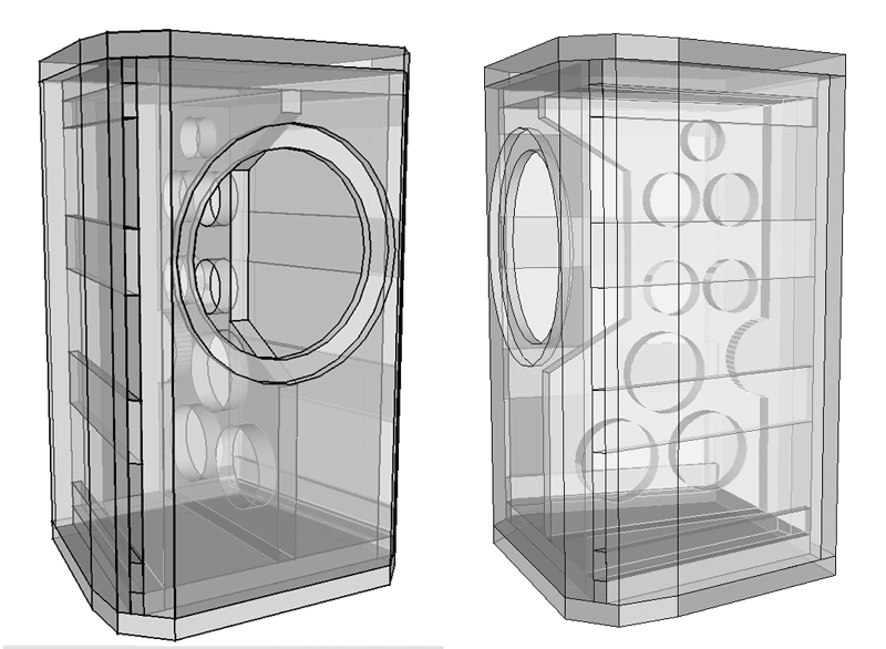

To model more complex baffles the baffle modeling tool in VituixCAD is good. It works on one driver at a time, but allows for more arbitrary baffle shapes. I was able to model the Linkwitz speakers with VituixCAD.
Here's an example from boxsim where I have 3" dome midranges on the front and rear of a wide thin cabinet with beveled edges. The drivers are offset from the center the optimal amount to cancel some of the baffle edge effects.

Hi, roundovers need only be as big as fits: if your driver is 1" and its 5" sized baffle/box, use 2" radius and start it right at the tweeter. If you have 2" baffle for the 1" source, 1/2" radius is as big as fits and pretty much as effective. If you have no baffle at all, no radius fits, and thats best you can do and almost the same performance as the previous two. If you have large flat area around a driver, you'd need very big radius roundovers. The baffle supports long wavelength so high radius is needed to mitigate, slap on roundovers and it gets bigger, so interference gets lower in frequency. Although, you could make the baffle approach room dimensions and any edge diffraction related backwave is mixed into all kinds of reflections from room boundaries and objects.
So, either very big structure around a driver, or as small as you can have. The smaller the sttucture isnthe smaller roundovers need to be for very little diffraction related issues in listening window response.

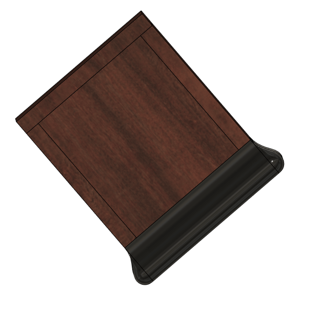

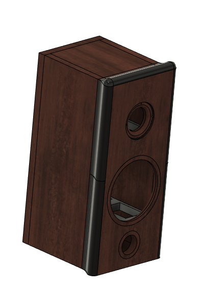

here's one.
a multi-radius round over -- in other words, a parabola -- might deliver aspects of large radius round overs without involving an overly thick front baffle.
if you could model a first approximation -- cut by a commercial large thumbnail router bit -- as well as a comparable mathematical parabola that might be instructive.
