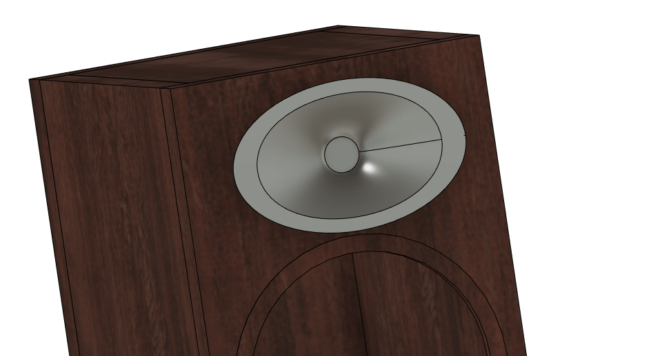

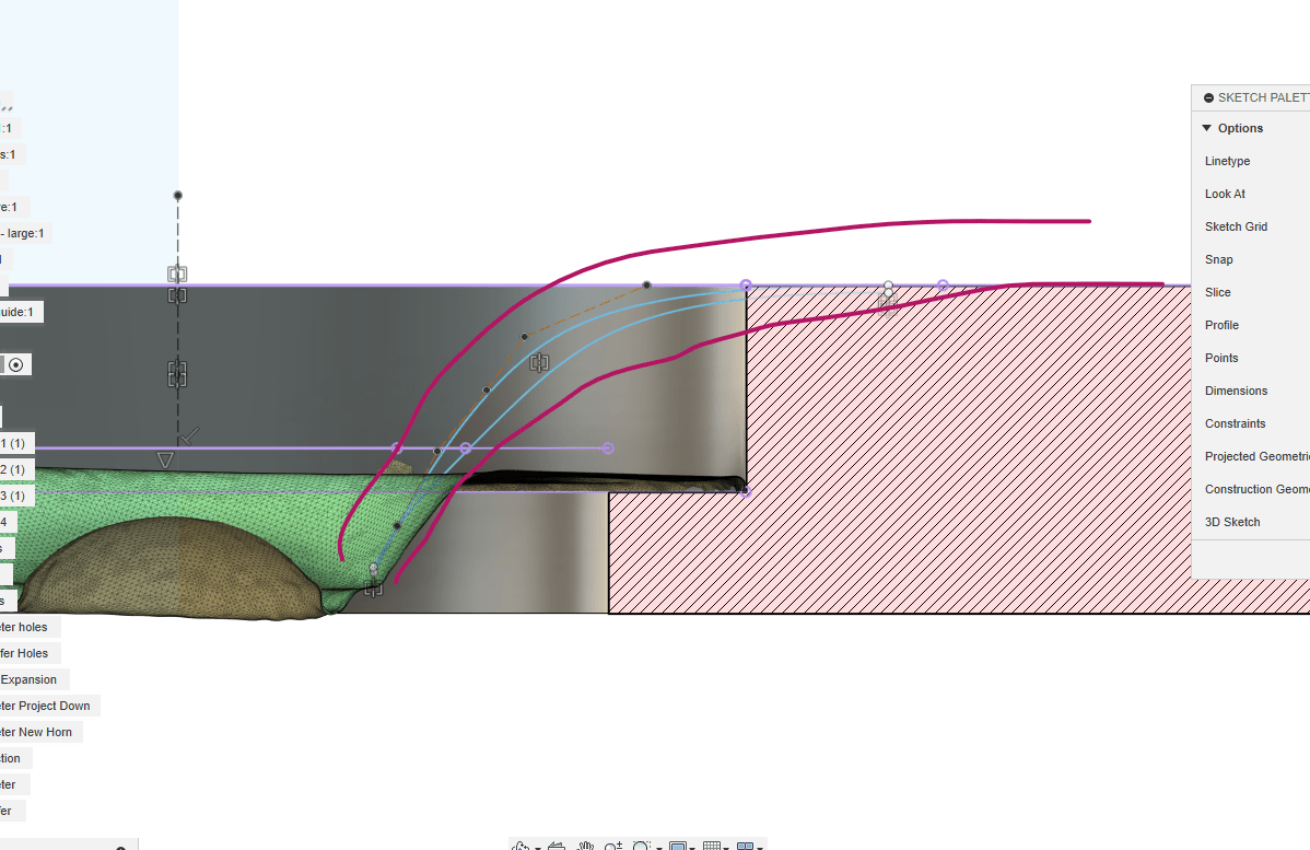

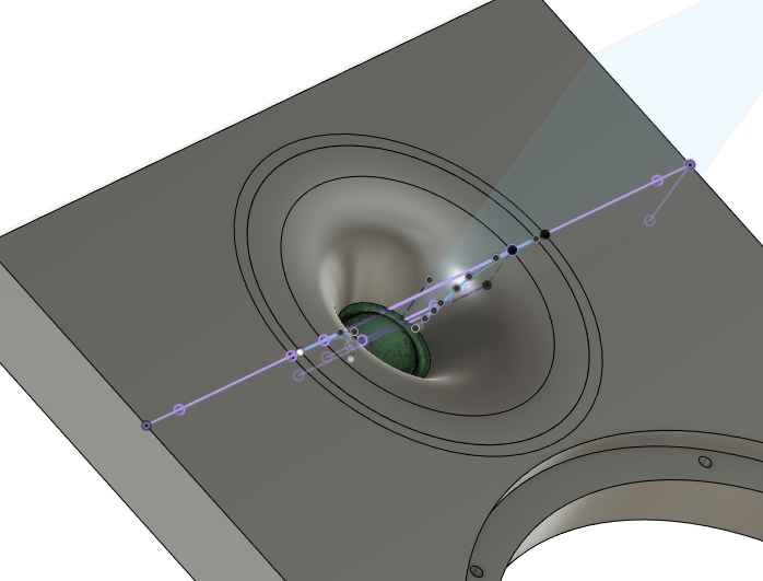

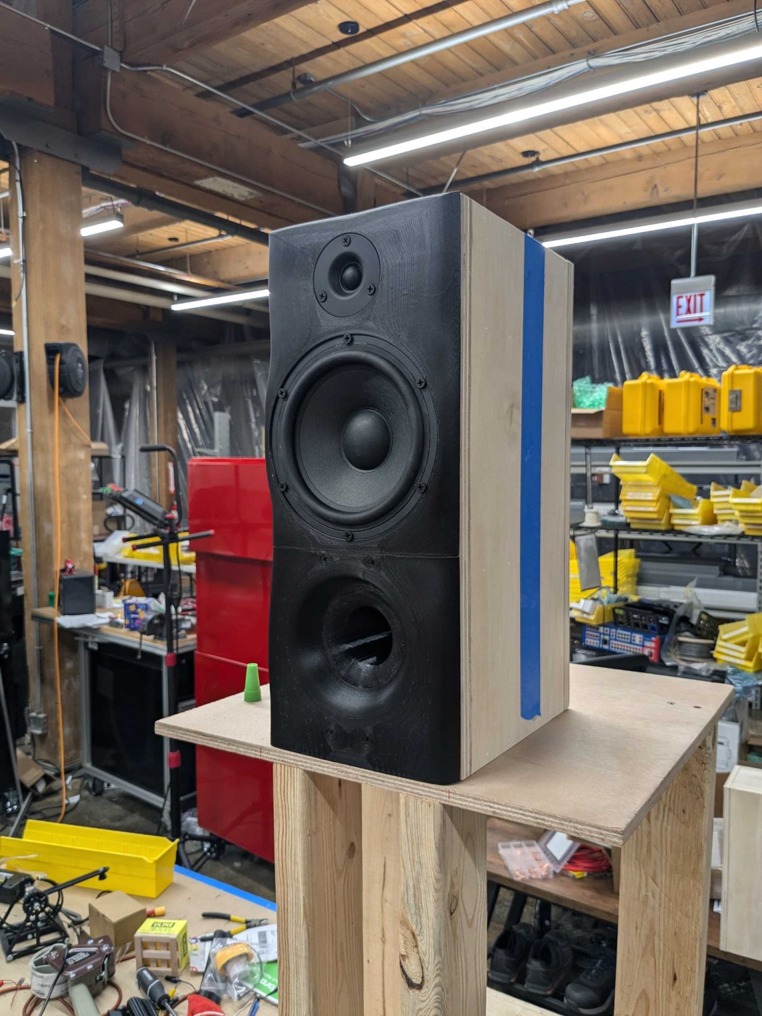

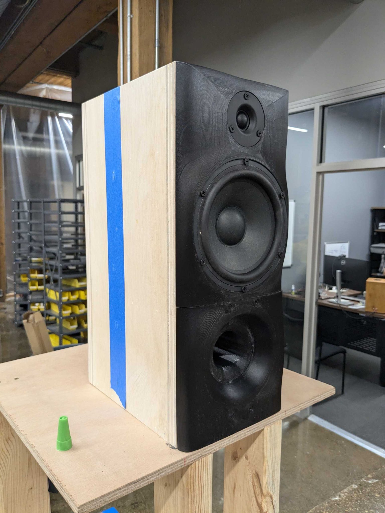

I can't replace the built in waveguide. It's built in. So I can go down around the inside of it or I can just mount the tweeter flush and round over the edges after the fact for diffractionThis looks to be heading a better direction but I can't tell exactly what is being done. making an insert to go down to the surround is possible but could alter the directivity to be narrower which may be good or bad. The existing profile looks conical, adding a larger round over to the edge of it will terminate it more smoothly and make it behave better. replacing the waveguide entirely opens up lots of possibilities but it is not possible to guess the outcome by eyeballing the profile. Soft domes don't simulate very accurately as they are anything but pistonic over a large portion of their range.
Change like these can alter enough that the existing crossover might need to be changed if that is a consideration.

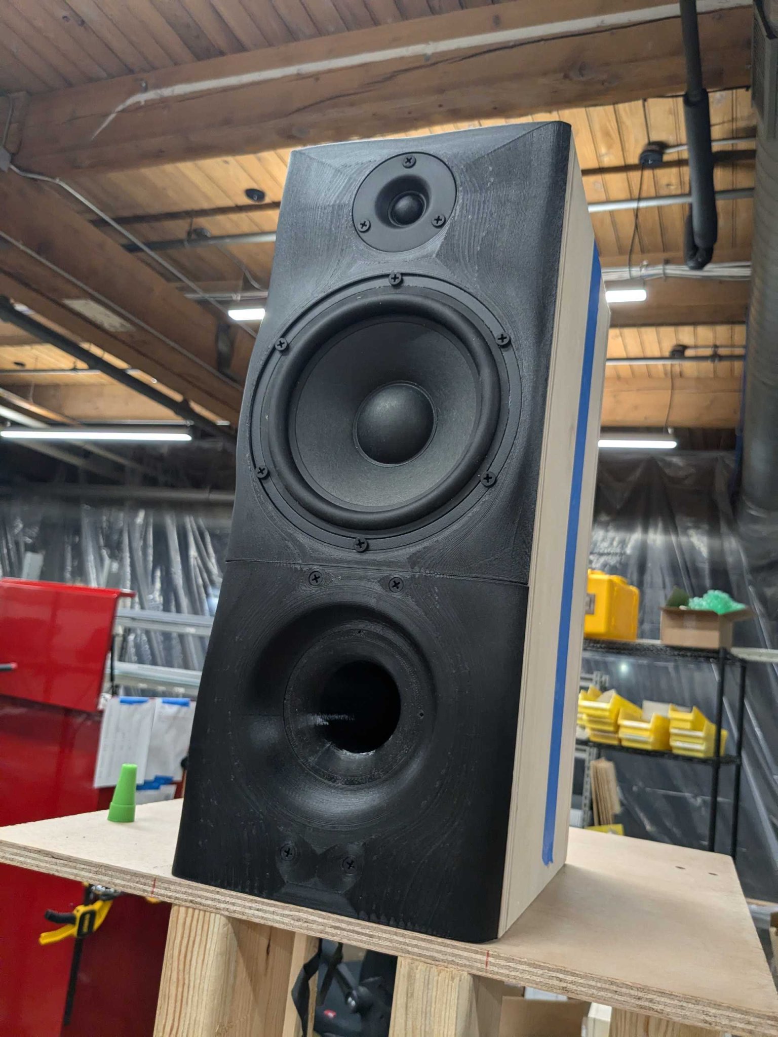

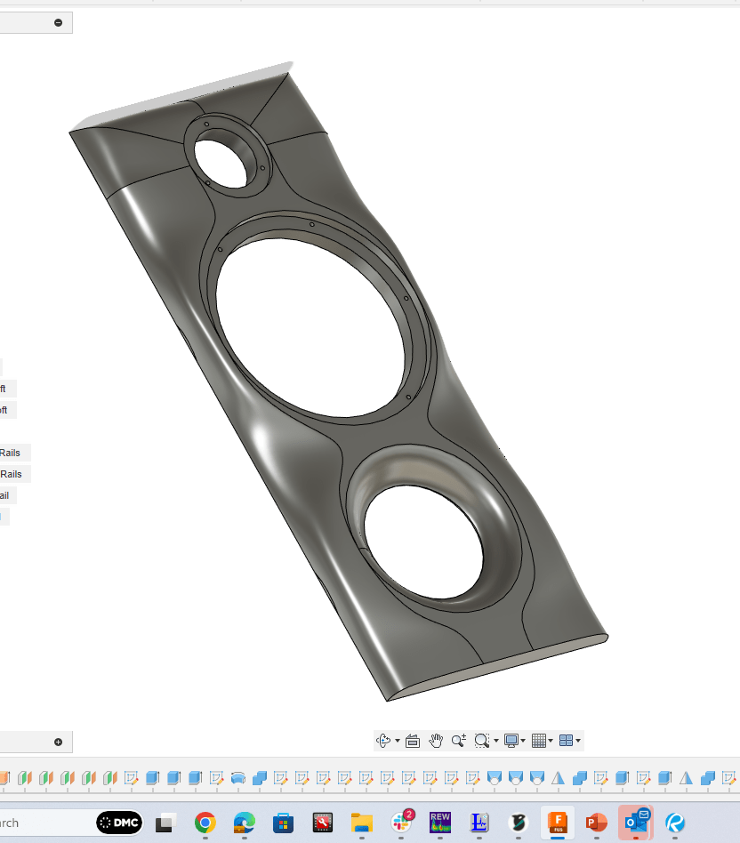

I think making a separate add on baffle that contains all the diffraction control elements is the simplest way to go. Mounting the tweeter flush to that baffle and starting a transition to the baffle edge as close to the face plate as possible. That would look similar to the blue coloured baffle design I showed before and contain some elements that you have already drawn in Fusion.
You could use that as a test bed for different edge shapes or amounts of flat baffle area if you are interested in measuring the effects they have.
If you want to see the effect of sharp corners vs fully rounded on all edges you can make a larger add on baffle and make some add on edges and panels in a similar vein to you first ideas.

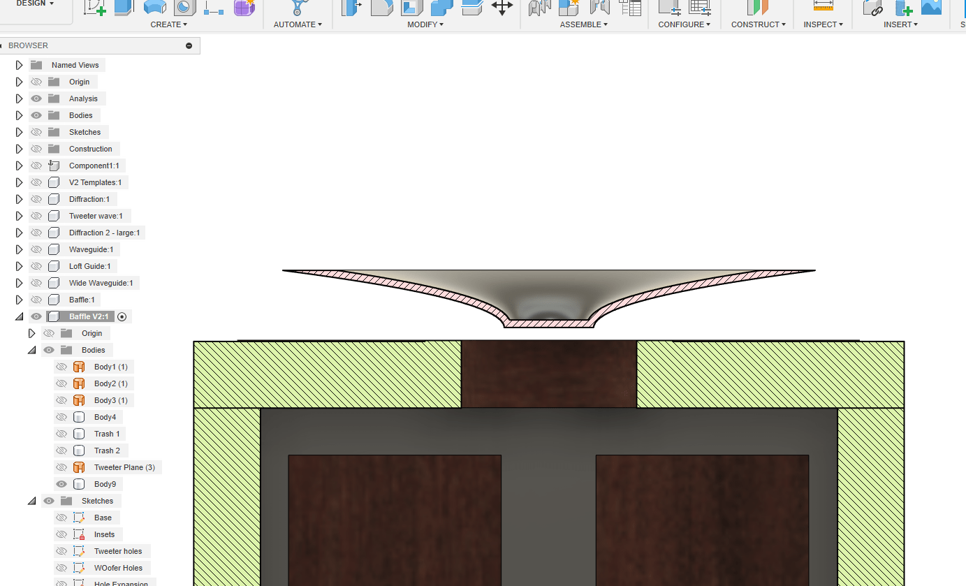

I can do that too. My plan is to make inserts.
So I can make an inter that mounts the tweeter flush to the baffle. And I cna make inserts that mount the tweeter lower down that include all sorts of waveguides
In this way I can infinitely test waveguides while only having to print the big baffle once. Saves a lot of filament

I'll scan the tweeter and try to continue the built in waveguide

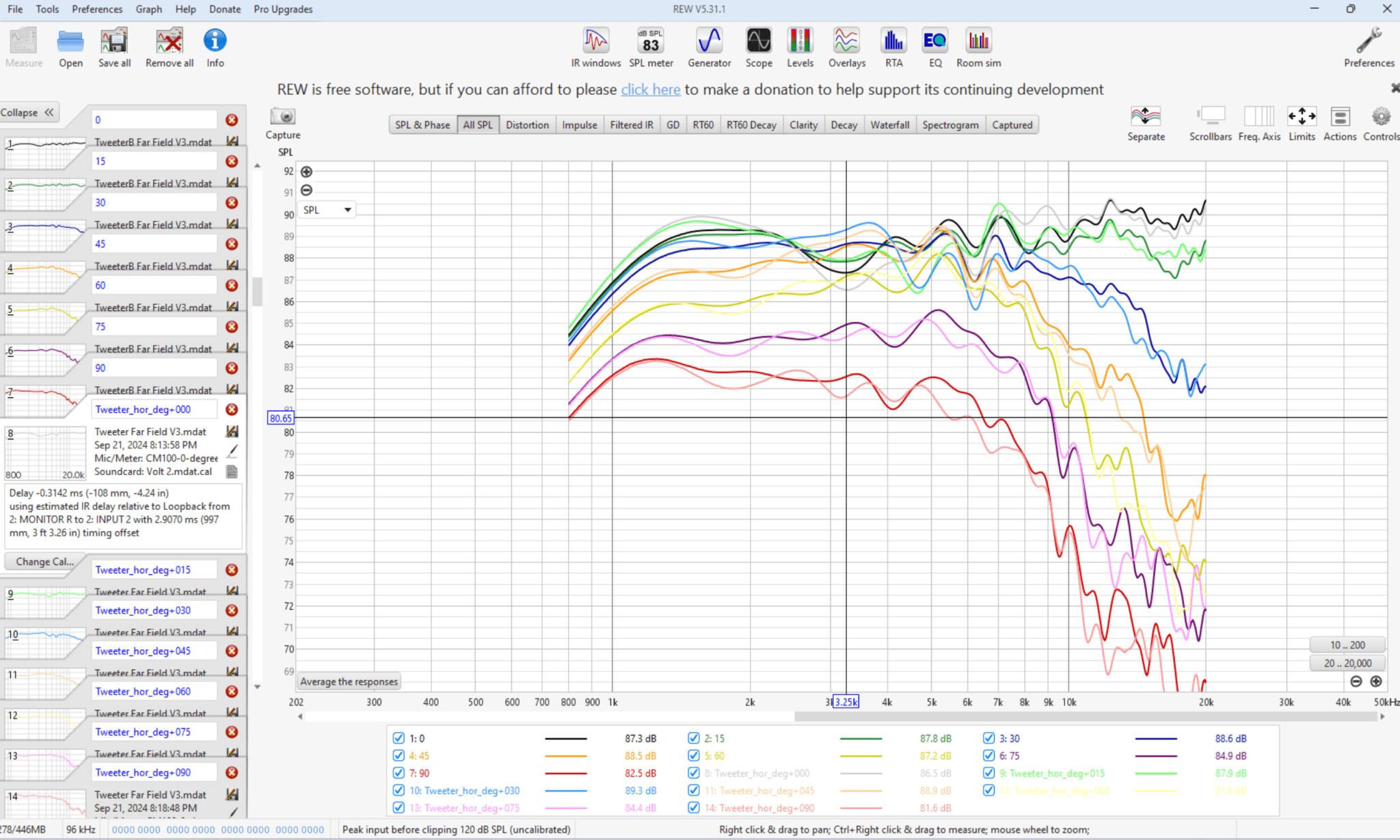

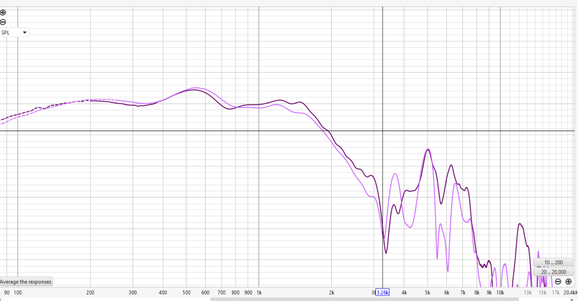

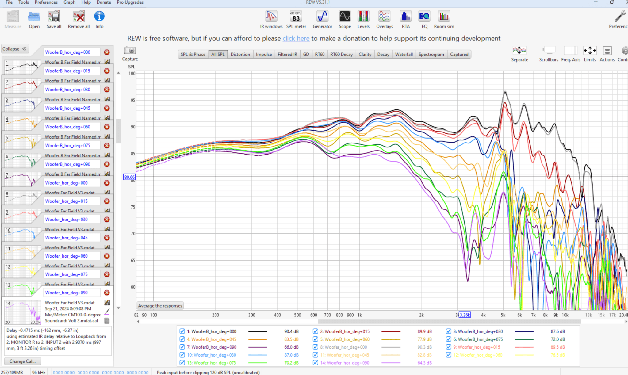

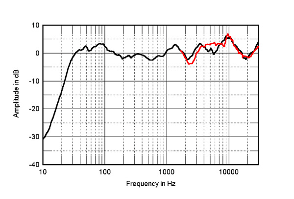

We have data!!!
You can go through them yourself but the pattern I see here is a 1-2 db improvement on the off axis response accross the board. This is especially noticeable in the 800-3k range.
Forum server is saying the MDAT is too large to attach here so I may have to make a google driver folder to hold them for whoever wants to go through it in detail.
I made all the colors the same. The baffle measurements are dark colored and the sharp baffle are the light color of the same color.
Anyways....this is pretty cut and dry.
In my opinion this is a small improvement. Possibly it is a greater improvement to the actual listening experience than is shown in the measurements. Measurements do not tell the whole story. With that being said, they do look ******* awesome. This new filament I have been using is just amazing. I will be wrapping these in alcantara. That may affect the response a bit so I'll probably take another round of measurements being starting the XO.

@Bmsluite
I’m looking at those curves on my phone so excuse me if I not seeing things properly.
If β denotes the measurements with the shaped baffle. of the improvement seems to be in the region above ~1KHz.

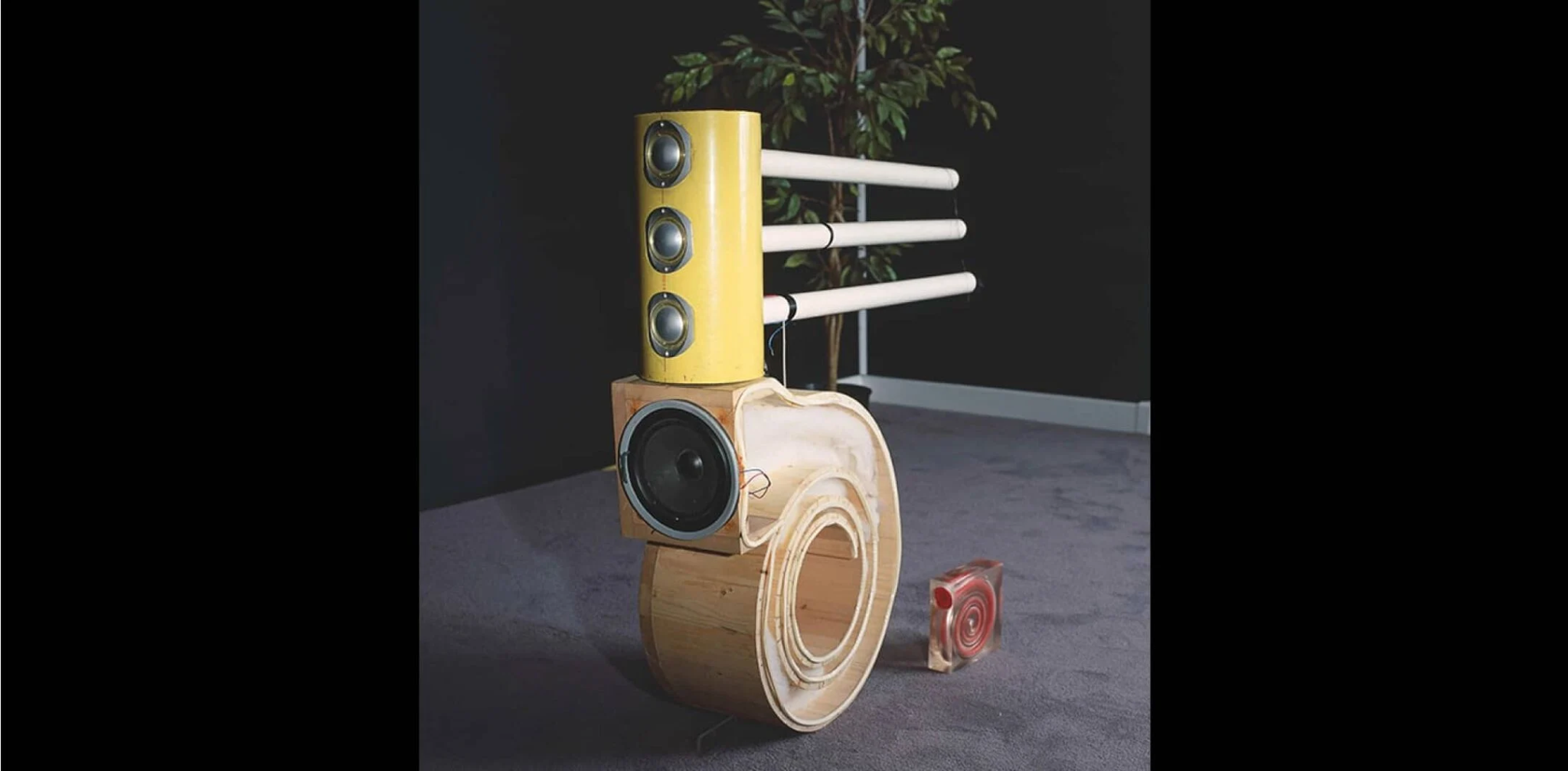

Lawrence continued at B&W, which was now under the ownership Robert Trunz. Here are some prototypes from 1991 and 1992 respectively:

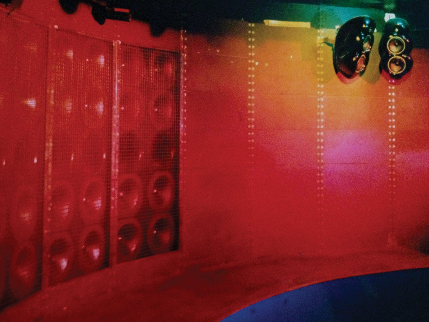

Meanwhile, Simon and Lawrence, in 1992, designed a Sound System for the Great Escape nightclub in Brighton UK, which included a speaker with a sealed MMT layout, named TechnoPod:
with a wall of TWENTY-FOUR 12" (B&W 801) woofers (left)

The in 1993, B&W released their (now iconic) Nautilus:

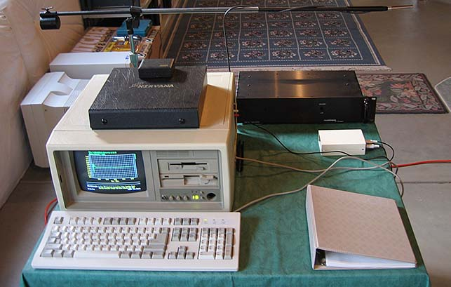

It's amazing to realise that much of the design work was done before the release of MLSSA, a hardware/software to measure speakers on-axis, in DOS
As late as 2014, measurements at B&W were taken on-axis, using WinMLS Pro (personal communication, no reference will be provided)
It's not clear what software, microphone or process is used to measure/design their speakers since 2014... but as late as 2023, it isn't clear to me if other people know either

24 12" subs and those pods!? Clubs are so lame now with their crappy pro woofers

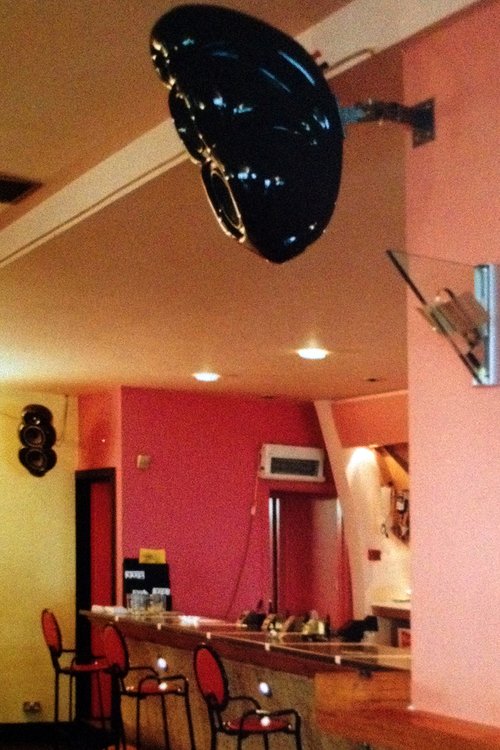

I haven't been to any clubs in the last decade, but I do recall some of the best night club sound systems from the late 90s/early 2000s eg. Twilo @NYC
This was the era of high directivity, thanks to people like Tony Andrews, during his time at Turbosound, and later when he founded Funktion-One.
Here's the phenomenal sound system at Space @Ibiza
