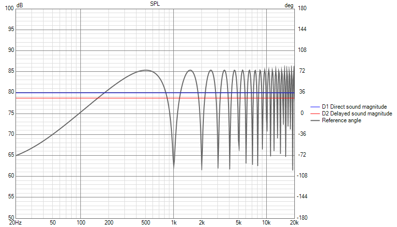

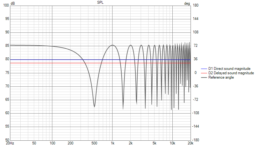

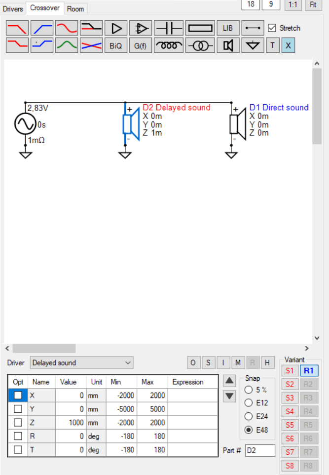

Task, these are two identical ideal point sources both with flat frequency response. What is the delay between them? You can estimate / calculate either distance or time, and convert to the other, both are the same thing through speed of sound, which is 343m/s here.
How about this one?
Now whats this all about?

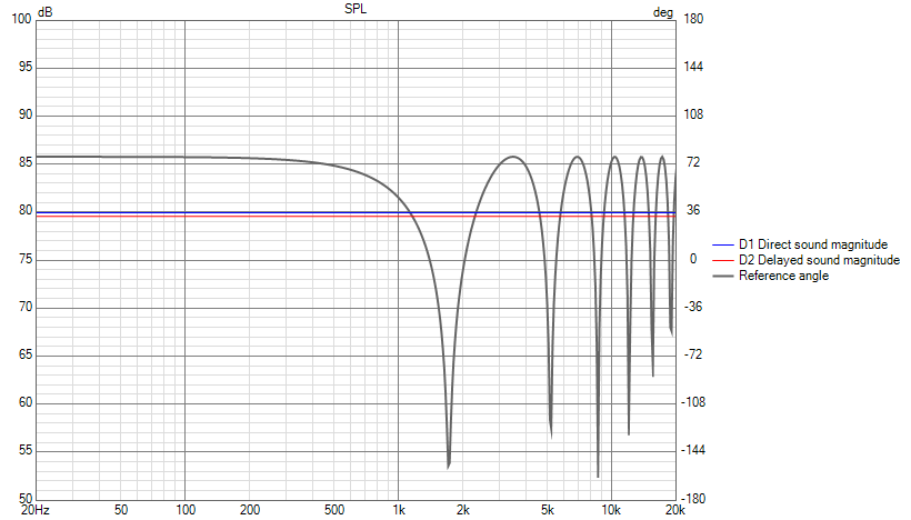

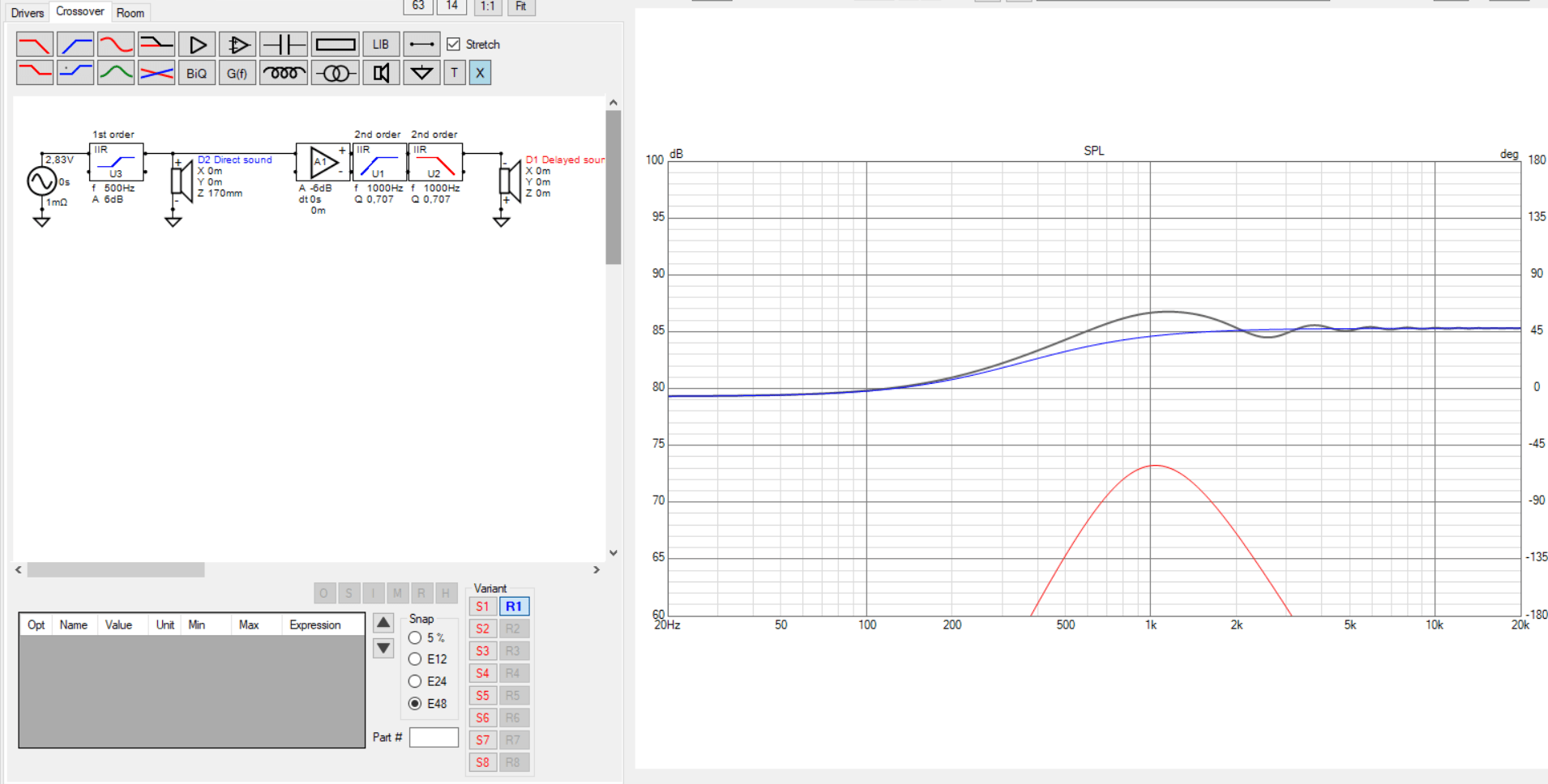

Tip, if it's hard to imagine and calculate these in head try to make a matching interference pattern in vituixcad, here is how to, just add another ideal driver, hook it like so and change the Z value of one of them, or use a delay block if you want to.
How about this?

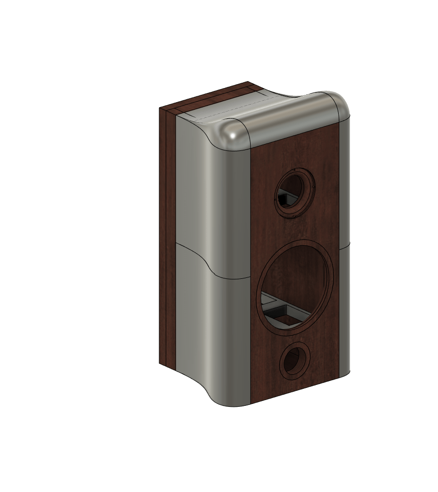

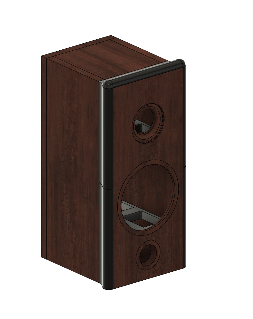

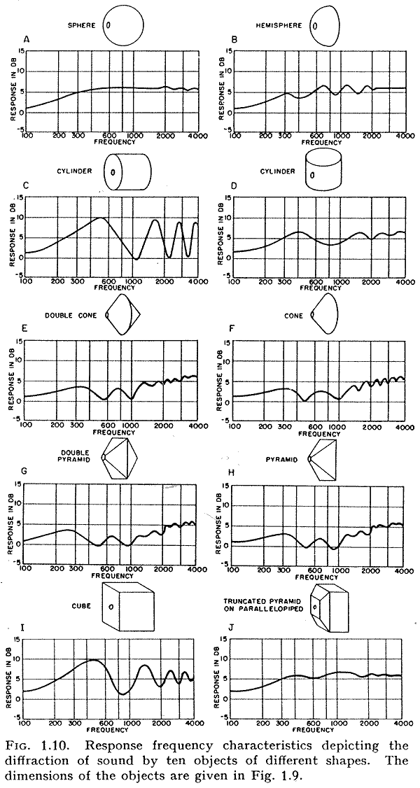

This is what I'm trying to expand upon. We have the ability to use some newer shapes they couldn't test back then.Published in 1951...
https://www.aes.org/aeshc/pdf/how.the.aes.began/olson_direct-radiator-loudspeaker-enclosures.pdf

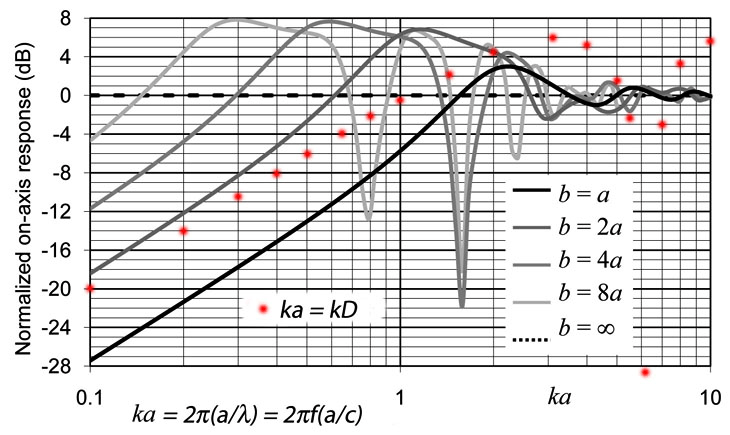

And radiator size vs. baffle dimensions is important too, published in Tim Mellow & Leo Karkkainen, "A dipole loudspeaker with balanced directivity pattern", J. Acoust. Soc. Am. 128 (5), November 2010, pp. 2749 - 2757 https://www.linkwitzlab.com/models.htm
While I am positive the big names have data on this, we in DIY do not.
I may expand upon this and try full shapes around the drivers using a full range.
Exactly.By my understanding, baffle step is responsible for fall of the decreasing frequency on axis response, but the severe ripple with increasing frequency is due to diffraction.
Baffle step is the (rather smooth) transition from 4pi to 2pi radiation.
Diffraction is the interference of driver with "secondary sources" at the baffle edges, similar to comb filtering.

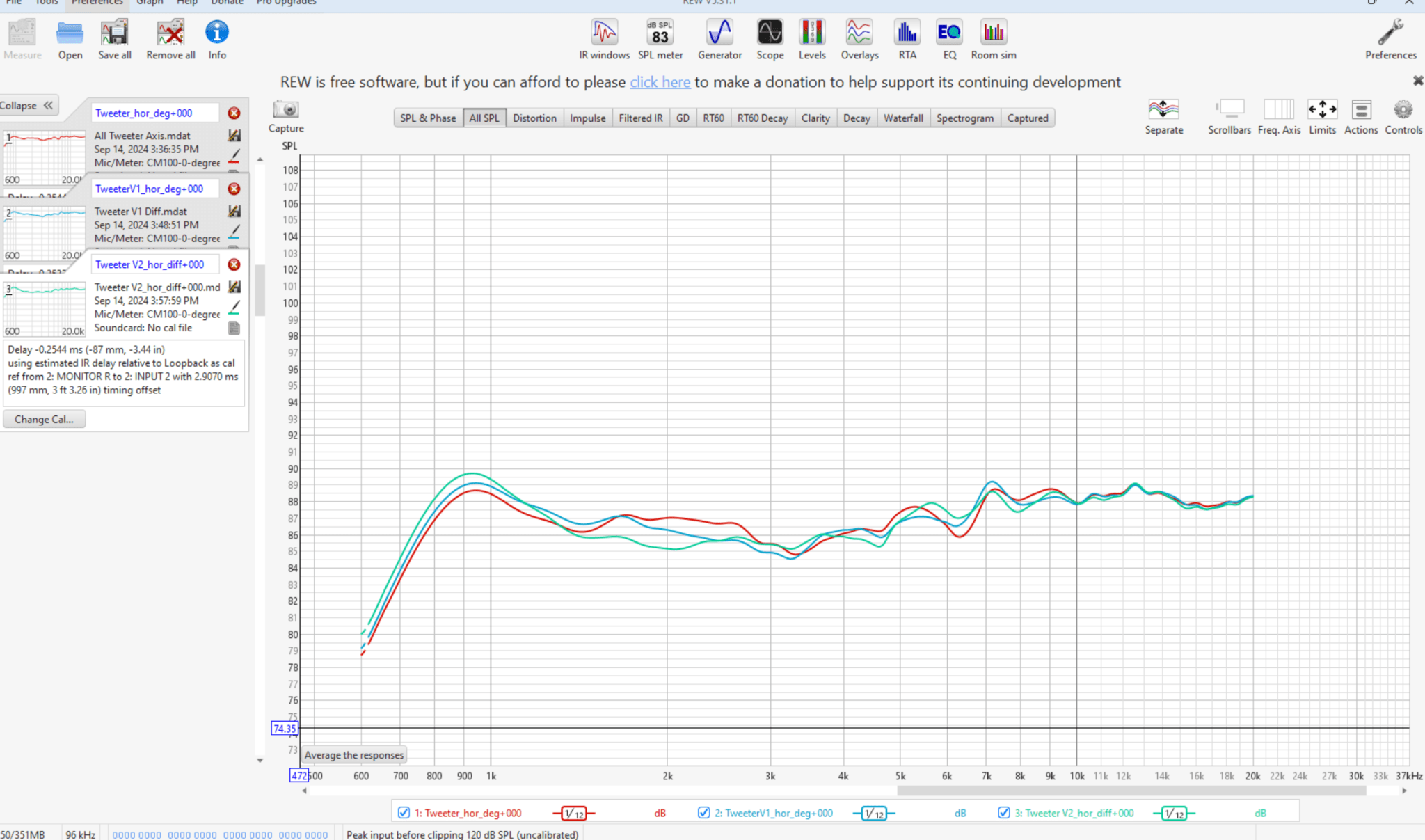

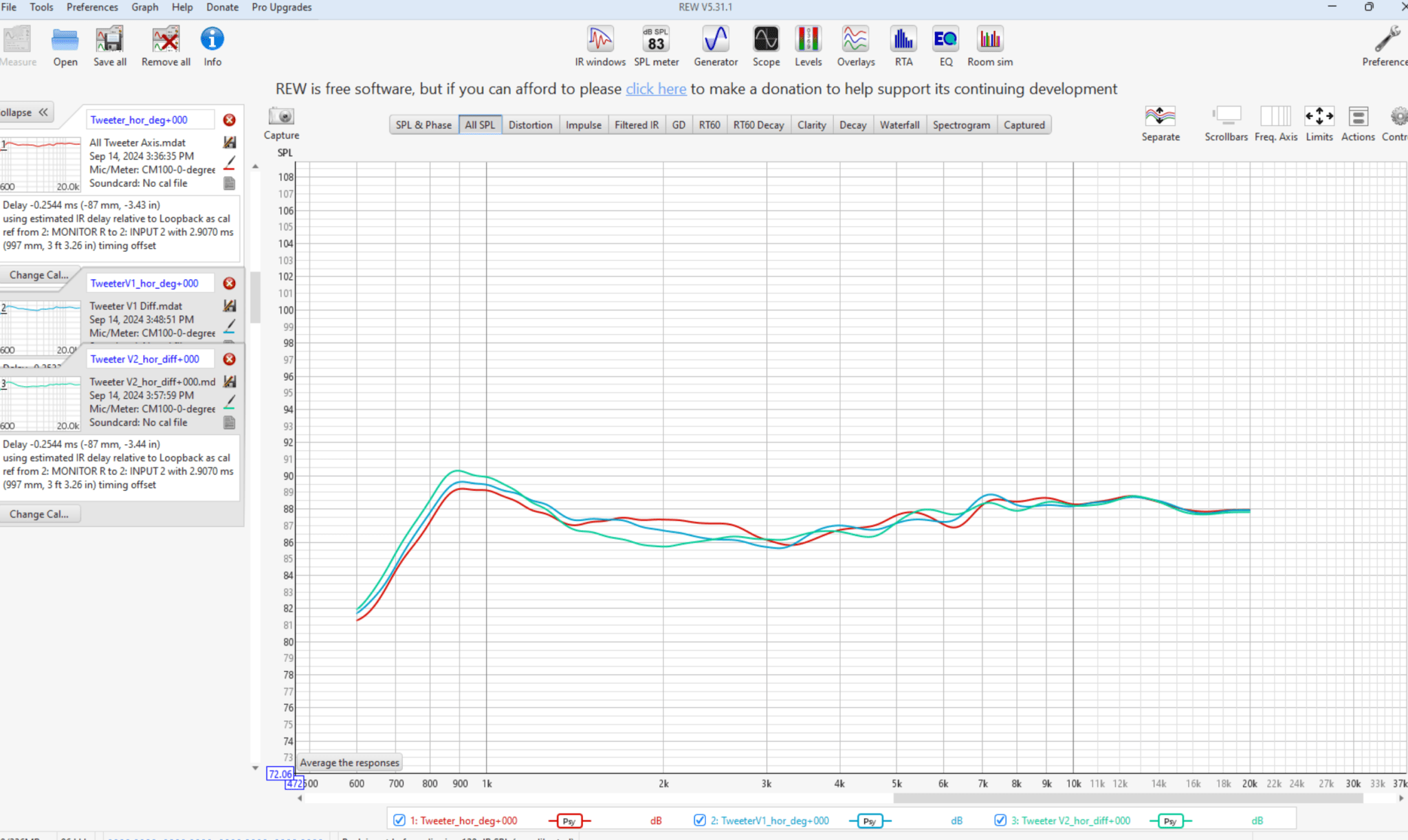

Welp.... here's some data.
Tweeter = sharp edges
Tweeter V1 - small teardop edge
Tweeter V2- big teardrop edge
My super unprofessional conclusion: It does make a difference. I don't think it makes it any "better" but it does change the response.

How big are the small teardrop and big teardrop?
I don’t know if I could hear the difference unless I was told to listen for something specific.
V1 is small, V2 is pretty big.
I guess this goes to show that little round overs with the router are sort of useless..... outside of ascetics of course. At least as far as round ones go. I'll have to test the increase radius ones.
Maybe it needs an entire shape around the driver. At the end of the day these are still square boxes. I think I'll test a sphere vs a cube and see what difference there is there. I have a 1.5" full range driver sitting around I can use for the test.

You probably want to look into your measurement settings. I would gate at ~5ms or so and not do any (or at most 1/12 octave) smoothing. Then post the graph again.Welp.... here's some data.

Yeaaahhhhh.... I already played around it but since you asked.... here ya go. 1/12th smoothing gated at 5msYou probably want to look into your measurement settings. I would gate at ~5ms or so and not do any (or at most 1/12 octave) smoothing. Then post the graph again.

Putting extra shapes or roundovers on a basic box can have an effect but if you really want to control directivity and diffraction it needs to be planned at the start. The simplest solution is to limit flat baffle area and begin the edge treatment as close to the driver as possible, this is why trapezoidal baffles and chamfers are popular when a multiway speaker is used with increasing sizes of drivers. Revel's Salon 2 is another example of a more complicated way to try and acheive the same thing, reducing flat baffle area and having the edge start right next to the driver or waveguide.
The shape of the edge is a secondary factor to it's effective size. In the end all edge shapes that have the same effective size produce very similar results if the intent is to reduce diffraction.

The superposition phenomenon is such that a frequency response ripple is pruduced by two or more interfering sounds whose. In a loudspeaker context direct sound strives for flat amplitude, so amplitude of the reflected soudn and delay between the sounds can be read from the interference. As demonstrated in previous post, there is only one delay that will produce matching ripple interval. Since the delayed sound is reflection or diffraction of the direct sound, the direct sound is loudest and dominates frequency response graph. Any secondary sound must have longer path length so attenuation, and makes ripple on the direct sound.
So, as long as interference is readable from the graph it is possible to see the delay and spectum a delayed sound has, split it in parts like the last image on the previous post does. If it's a polar map it's possible to see what kind of an object it is, from the diffraction interference to various angles. Polarmap is like a fingerprint, no other shape makes it the same, unless it has no diffraction, or very low diffraction.
Analyzing the graphs gets easier if there is visual of the object and knowledge it's a loudspeaker. For example, if you work on a waveguide and see ripple in measurement you can make educated quesses where the problem is. First of all, there must be secondary sound if there is ripple, and second of all, if it's high frequency ripple with long period in Hertz, it must have very short delay so it originated near the sound source, so from the throat or phaseplug or at the interface and you can shift your focus there. If the ripple starts from low frequency it must have longer delay and origin somewhere further in the device. Point is, secondary sound with short delay must be originating from short physical distance from sound source, long delay further away.
Waveguides and horns are special compared to square boxes with flat face, because their wall angle compared to observation point on axis is less than 90deg, the diffraction back wave does not propagate toward listening window but back inside the device, where it reflects and then goes toward listening window. Unless it happened at the mouth on a roundover so that it's great enough angle and also propagates toward the observer on-axis.
Typical speaker where a transducer is not inside a recession, like in a horn, there cannot be reflections so all ripple is diffraction (assuming ideal sources and non radiating surfaces of course).
All low frequency ripple has long delay, short delay cannot do ripple on low frequency. So if you see clearly interference around 1kHz and up, it must be secondary sound with at least half wavelength delay, but could be longer (and reduced amplitude on lows), exact delay you'd read from the period.
