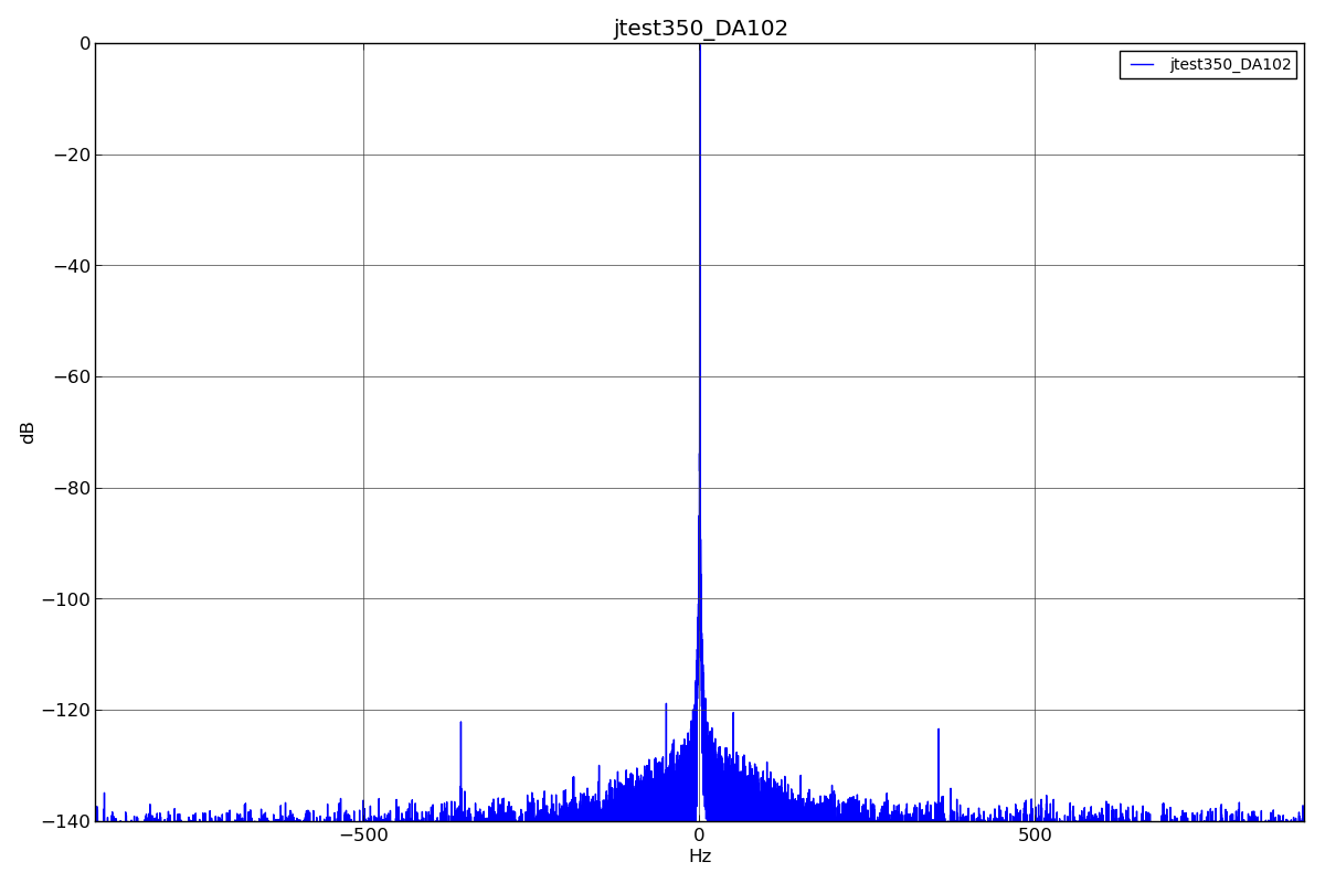

If you want a transformer, use Murata DA102, then read the PDF and use the termination on page 8, with CT equal to the capacitor you put in series with the transmitter. That gave the best measurements, so I'm sharing :D
What you should do is AC-terminate with a 75R resistor in series with the same capacitor value you put in the transmitter.

There's no better chip than the wolfson, it is very effective at removing jitter.
HOWEVER its output is only as clean as its own oscillator, and its internal xtal oscillator circuit is not good. If you use an external canned oscillator, you will get much lower jitter.
The above FFT, which is pretty clean, was done with a Vectron VCC1 which cost about $2 at the time, unfortunately now unobtainium.

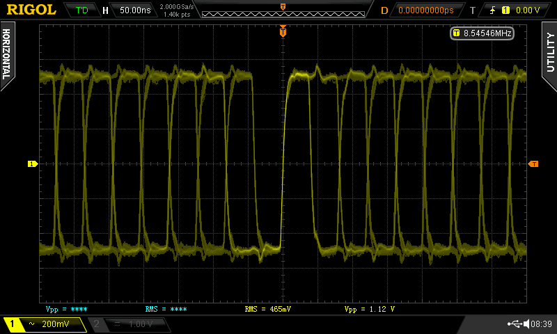

Dude, it has nothing to do with transmission lines...
The transmitter is AC coupled, so if you put a parallel RC termination in the receiver, the signal will be high-pass filtered quite strongly, so the timing of the edges will move depending on what data was transmitted a few bits before, which increases data dependent jitter. Same if the signal is lowpassed (but worse).
Lowest jitter comes when the waveform looks pretty at the receiver, with flat tops, straight edges, and square corners.
Also if you feed two receivers from one source using one cable with a tap in the middle, yeah you'll get lots reflections, but that's another can of worms... Same reason PCI, Ethernet, SCSI, AppleTalk, IDE/PATA, etc, all of them abandoned the bus topology and went point to point.
