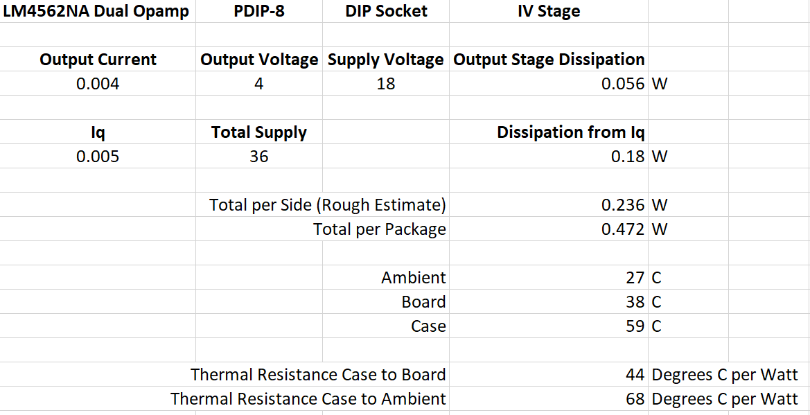

With the PCM1798 the I/V op-amps were pretty warm. Now that I have the PCM1794 in there the OPA1612A are really hot as in hard to touch with your finger. From what I have read this is not really unexpected with the PCM1794. I wonder if I should try to find some sort of heatsink to glue on the OPA1612A or not worry about it? I was thinking of the 7x7mm heatsink used for the network chip in the Raspberry Pi 4 heatsink set with four different size heatsinks.

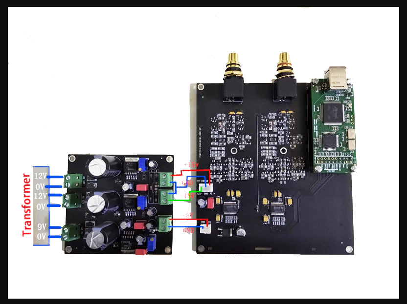

I bought one from Taobao,
dual PCM1794 in a small box,
I added some bypass capacitors,
added 4 high speed diodes,
added a copper wire to grounding,
It sounds great,
I can't tell the difference from my denon dac which use 4 pcm1704 .
this dac use opa1612,
I leave it on 24/7.
there is hardly any warmth.

Since there is about -4V across the IV resistors at idle and the op-amp supplies are +/-18V the op amp has (18V-4V)*0.004mA*2 output stage dissipation just for the output current going into the I/V resistors. Then there is Iq of 3.6mA*2*36V.
So I very roughly estimate 259 mW = 14*0.004*2+3.6*2*36
Perhaps that is a lot for an SOIC-8? Especially soldered onto the tiny SOIC-8 to DIP-8 adapter boards? Maybe that is why so many PCM1794 boards use single NE5534 op-amps for the IV stage?
I found the following from Ti. I am concerned that the junction-to-ambient thermal resistance on the SOIC to DIP adapter boards is going to be a very high number.

With my scope I see no sign of RF problems at the IV op-amps. Sniffing around with the TinySA Spectrum analyzer I see the master clock (and harmonics to hundreds of MHz) at -50 to -60 dBm everywhere near the WM8805 board and PCM1794 board but I do not see obvious problems with the IV op-amp.

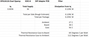

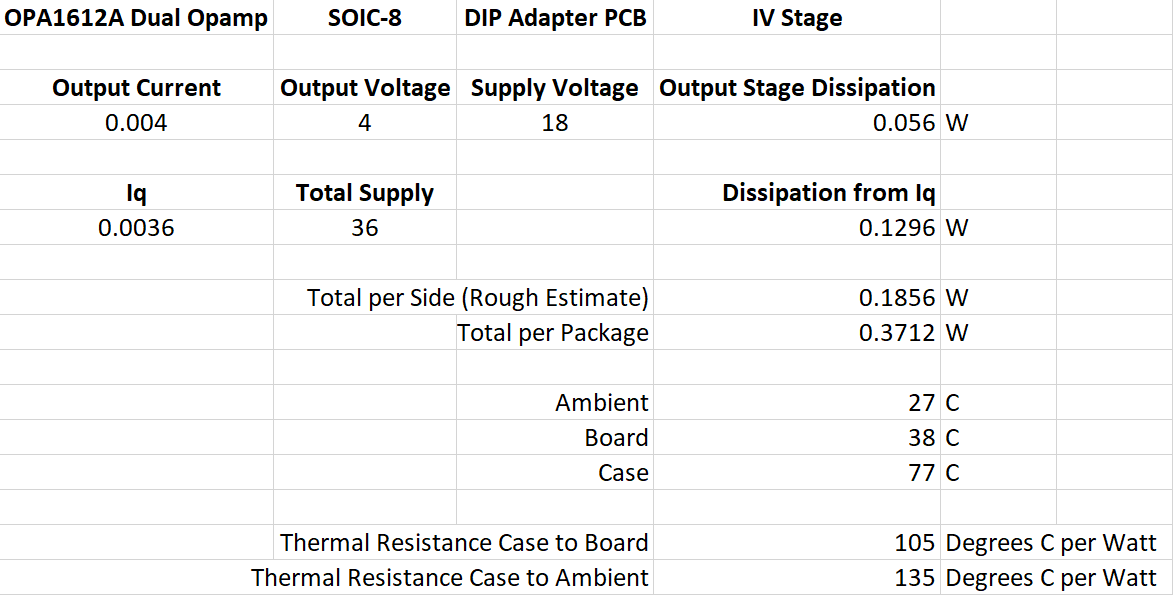

I used my IR thermometer to measure the OPA1612A IV op-amp, then the OPA1612A filter op-amp and then LM4562NA (PDIP) as the IV op-amp.
I have attached the rough estimates for the dissipation and the calculated thermal resistance. I am getting around 105°C per Watt Thermal Resistance Case to Board and 135°C per Watt Thermal Resistance Case to Ambient for the OPA1612A filter op-amp SOIC on the SOIC to DIP adapter board. For the PDIP package LM4562NA I am getting around 44°C per Watt Thermal Resistance Case to Board and 68°C per Watt Thermal Resistance Case to Ambient.
The IV Stage OPA1612A SOIC is measuring 77°C which is unpleasant to touch while the LM4562NA PDIP in the IV Stage measures 59°C which is much less unpleasant to touch.
So maybe it is just the thermal resistance of the SOIC and the SOIC to DIP adapter PCB given that this is a dual op-amp with fairly high output current with 36V total supply (+/-18V)? I guess 77°C feels pretty hot to the touch but perhaps is not a real concern.

Has anyone used one of these DACs (they were on Aliexpress, not sure if they still are now)?
The description reads:
Product design:
This product adopts the FET discrete IV-LPF design 1794 analog circuit, which reduces the various disadvantages of using op amp design. The sound of the FET transistor design is more transparent, loose and natural, and more dynamic.
In addition:
The design of 1794 is designed as a mono mode of MONO, and a piece of 1794 is responsible for the output of one channel, which makes the 1794 show more unique and excellent sound. This is a better work than ever.

You could measure the actual supply current drawn by the opamps, that would answer the question. If the current is suspiciously higher than it should be, then it is... suspicious...
I added 1 Ohm sense resistors between the op-amp power regulator board and the DAC board.
With OPA1612A for the filter and LM4562NA for the I/V:
Clocks Off: 92.4 mA for -18V and 47.1 mA for +18V
Clocks On, Idle: 92.5 mA for -18V and 47.0 mA for +18V
Clocks On, Playing: 92.6 mA for -18V and 46.9 mA for +18V
With OPA1612A for the filter and I/V:
Clocks Off: 91.6 mA for -18V and 47.2 mA for +18V
Clocks On, Idle: 92.8 mA for -18V and 47.9 mA for +18V
Clocks Off: 93.4 mA for -18V and 49.2 mA for +18V (it is heating up)
Clocks On, Playing: 93.7 mA for -18V and 48.5 mA for +18V
Thus I am concluding this is simply heating due to the high output current and low value resistors in this PCM1794 balanced circuit. The SOIC package is not helping plus they are dual op-amps and further they are on the tiny SOIC to DIP package adapter PCB.
As far as I can tell there is no issue with RF in the op-amps.

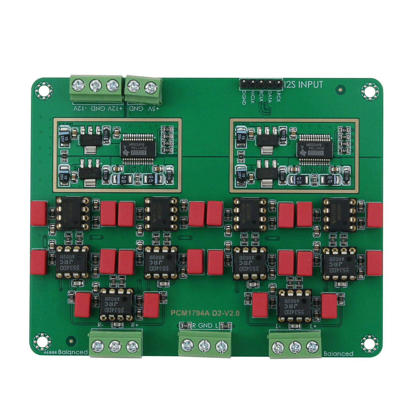

On the Chinese dual PCM1794 boards, the opamps are marked as NE5532 and NE5534, almost certainly low quality fakes.
But what to replace them with? I have seen one example where the NE5532 were replaced by OPA2602 and the NE5534 by OPA1611.
What other opamps have people tried?

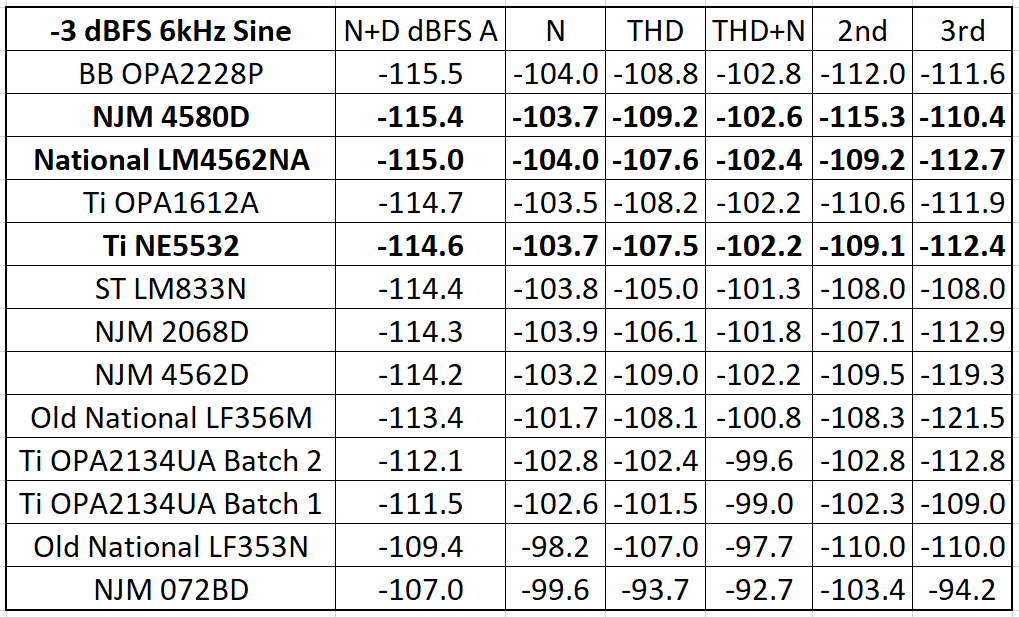

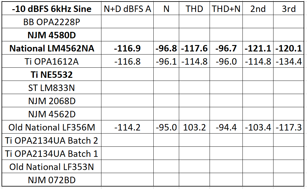

Well on my own PCB using only dual op-amps (and the PCM1798 before I swapped with the PCM1794) the attached show my measurements for a variety of op-amps.
For cost to performance ratio the LM4562 is really pretty good. I am using OPA1612A right now for IV and filter. But that is my own PCB design.
For singles I suggest considering OPA228 family and OPA1611A.
