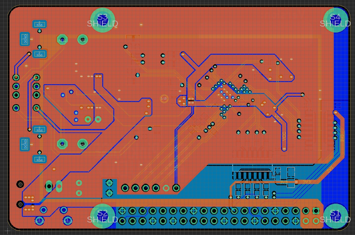

I have too many projects right now but perhaps I should try to layout my own board. The package is not that hard to solder. I wonder if anyone has done a four layer DAC board at JLCPCB? (Setting up KiCad properly might be a good portion of the work.)

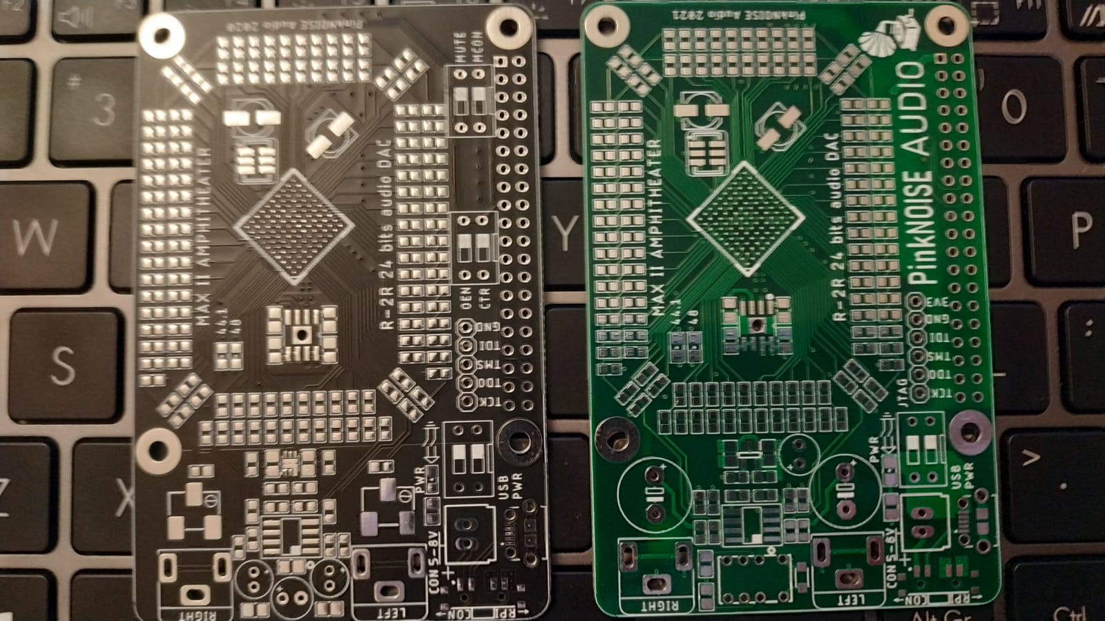

I did a 4-layer at JLCPCB. Worked okay. Solder mask wasn't as robust as a similar board from PCBWay. Pushing a solder iron tip lightly across it, wasn't too hard to scratch off a few little streaks of mask material while hand soldering some fine pitch SMD. Of course, that didn't have anything to do with it being 4-layer.

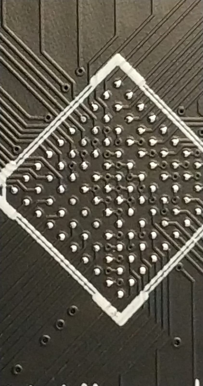

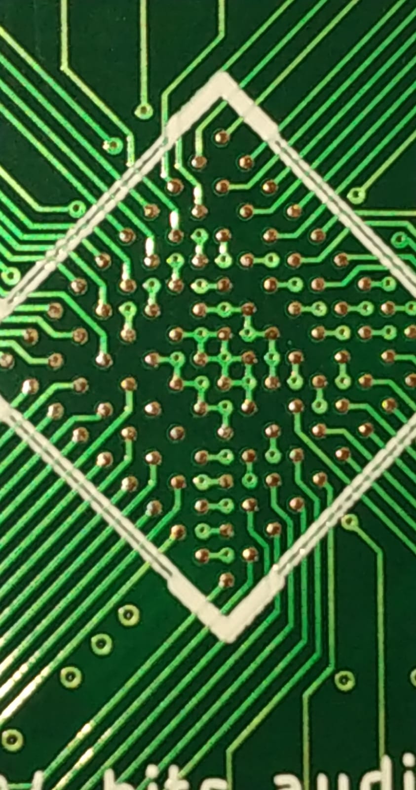

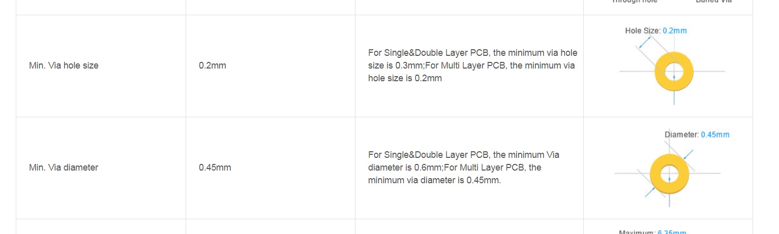

As a side note, might mention to keep costs down I limited via hole sizes to no smaller than 0.5mm. Always good to see what features a board house will charge extra for before laying out a board.

Mark, have you ordered black solder mask? It is not as robust as in green case at JLCPCB. From now, I will order only green solder mask since it is very good.
In case of 4-layers PCB, the minimum holes for vias is 0.2 mm, outer vias diameter 0.45 mm, with no any extra cost. Look at the vias under CPLD, which is FBGA package having 1mm distance between pads.

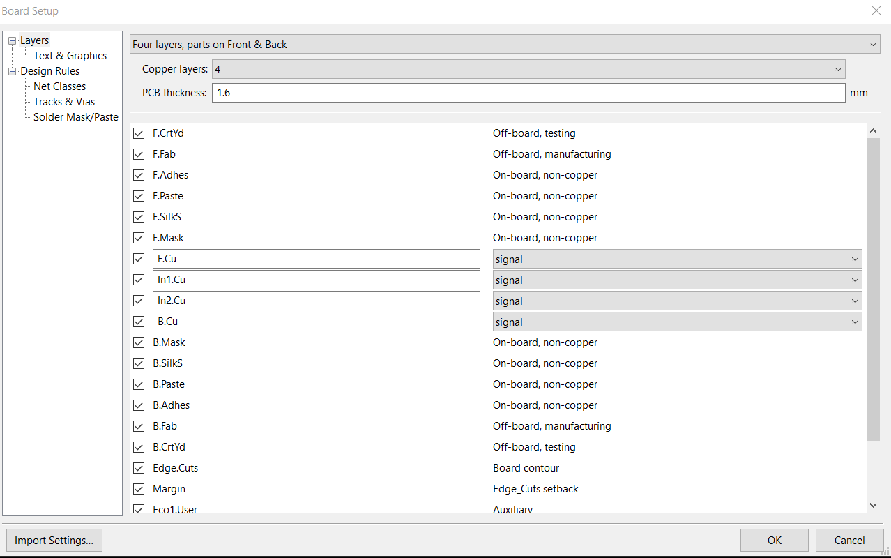

Did either of you use KiCad for the four layer layout?
How did you utilize the layers? Top for signal? Bottom GND? The layer under the top layer for power planes?

You mean the pictured (attached image) board is not recommended? And that one is oscillating? (Even after the X5R caps were added on the bottom side?)
Did you ever solve the oscillation problem or did you have to scrap it?

I use Eagle, but yes, I used top for signal, bottom GND, and the other layers for power planes, and I take care to insert GND in these middle planes, under the signal traces, where this is possible. Look at the picture below. You can figure out what is the GND area in this orange power plane.Did either of you use KiCad for the four layer layout?

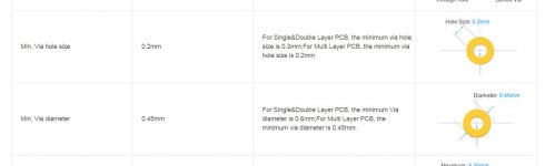

It was green but the cheap boards, not an upscale version. Regarding hole sizes, if you go to the quote page under advanced settings, looks like minimum is .45mm (which I may have rounded up to .5mm in my head). Smaller is optional. To quote:
"High-precision PCBs with 0.2/0.4mm Via are much more difficult to produce. To ensure the board quality, “ 4-Wire Kelvin Test” and “FR4 Tg155” options are automatically selected when 0.2/0.4mm has been chosen."
Could be there are drill charges for that too, dunno.
I recommend KiCad highly, I make mostly 4 layer PCB these days. Top and bottom layers typically signal and ground, inner layers power and sometimes some signals also routed.

The values you reffer to are for vias outer diameter, not for their holes. As I told you, if you have an BGA package having 1 mm pitch or 0.8 mm (hard, but possible) is OK, but if you have one with 0.5 mm pitch balls, the PCBs are very expensive.

Do you use a template to start your KiCad 4 layer layouts for JLCPCB (or do you fab somewhere else?) to help make sure things are setup right? Or do you just manually setup minimum and default via, pad and trace rules yourself?
Having not used KiCad I am a little concerned about messing up the first four layer board order with silly mistake. I am searching online for a KiCad project that I can download and use as a starting point to hopefully avoid a silly (setup) mistake and wasting the boards.

No templates are required with KiCad or JLCPCB, just make sure that you generate standard gerber files at the end of the process. (You need to select the gerber layers when you generate them.) I use JLCPCB for most things these days and haven't had an issue.
The minimums per industry norms are all default settings in the board setup file
You don't want to carry over setups from other boards, this is how mistakes are made. The default settings are fine, and you can review your gerber files in the included gerber viewer. In addition there is DRC (design rule checking) and the default settings are compatible with JLC.
KiCad is open source and free, there is lots of online support. There is a significant learning curve but I have managed good results on more than 70 PCB layouts so far.

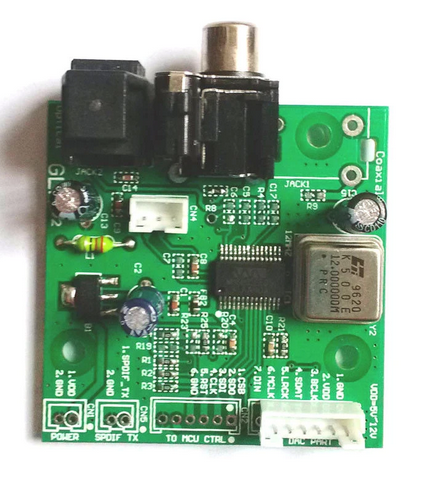

The WM8805 is not on my own board. My own board just has the PCM1794/8, I/V stage and several very low noise regulators.
I have bought WM8805 chips but I have not done that board yet. I just bought a simple WM8805 board to debug my DAC design. (Picture attached.) Later I plan to design a better board or buy and use a better SPDIF to I2S receiver. Right now I have not dug into WM8805 datasheets or the design of the board I am using. It was intended as something temporary to test my design for signs of life. So far with even the PCM1798 test chip installed the performance exceeds my E-MU 1616m ADC which is the best I have. When I get further along I will test with OAP1612 and with the hall notch filter.
Basically I am making my own PCM1794 board and then comparing it with my LJM CS4398 and the modified ES9038Q2M. When I decide which is the best of the best I will make a second spin for the one that I like best. I am also comparing it with the CS4398 inside the E-MU 1616m which has had some upgrades and is awaiting op-amp upgrades. The 1616m has (as far as I can tell) very low noise supplies and low jitter clocks (at least claimed and well regarded). I like my modified ES9038Q2M but I do like the BB parts in my Denon receivers so I thought I would compare the different designs leisurely over the next year or so. I have upgraded various bits inside the Denons and they are also slated for op-amp upgrades next for the BB PCM DACs.
Recently I obtained real OPA1612 and OPA2134 to add to the mix also. (Previously my best were LM4562NA and then the old NE5532.)

I ran two PCM1794A in mono mode and had a lot of problems until I added 22R (IIRC) series termination resistors at the WM8805 I/O.
