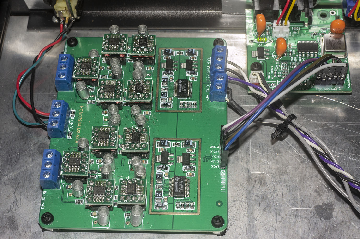

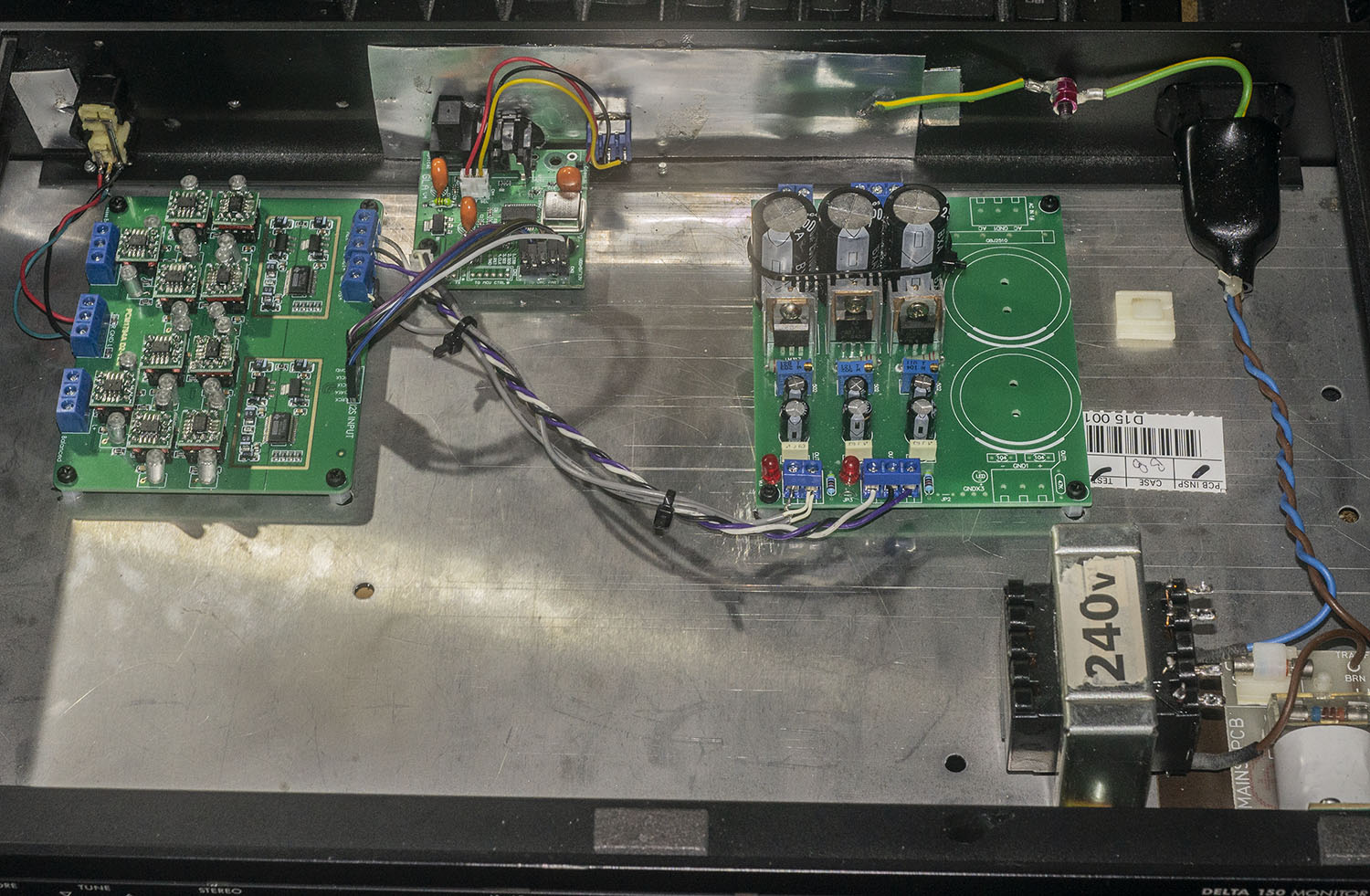

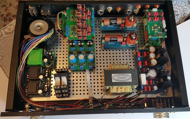

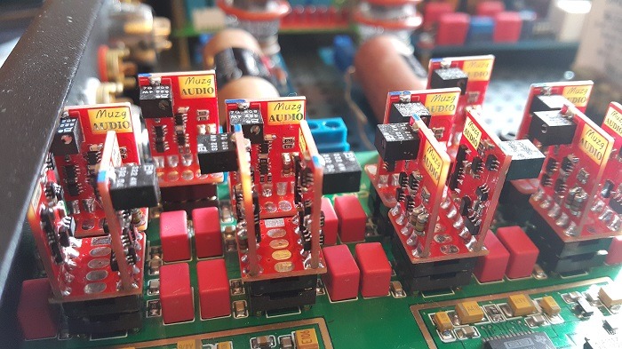

The OPA604 and OPA2604 arrived and have been soldered to adaptors and installed.

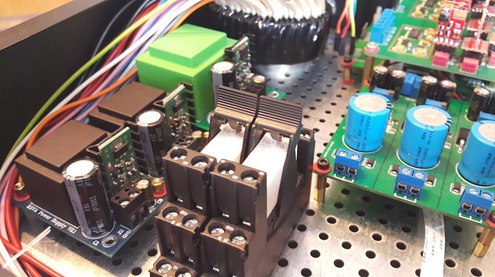

The only thing left to do now is to sort of the transformer. The one currently installed is the Arcam original which has two secondaries - 12v and 5v, so I'll either have to replace it or add some circuitry to split the single 12v rail.
The receiver board is a WM8805.

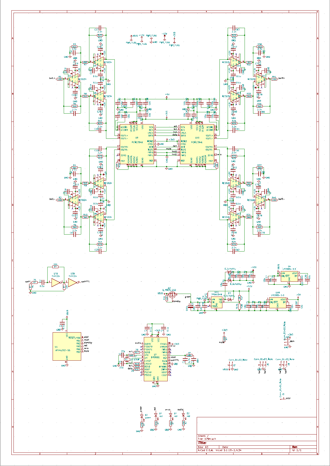

Although there are some reasonable ideas with the board the cost cutting is too evident. You've resolved the capacitor values I guess but the 5v chip feeding the analog side of the PCM1794A is weak. Replace with LP2985-5.0 for 1/10 the noise.
Here's my 'final' schematic. I'm building it up and will run it off at jlcpcb. It's just a hobby board so I'll make everything available. Every chip is Texas Instruments. Input spdif, Output balanced. Single 5v supply at about 0.55A. Supply can be noisy, USB based etc.
DIR9001 - 50ps, I don't think USB v2 Async can beat this so it's as good as it gets?
PCM1794A - arguably as good as it gets
TPS61048 - +12v/-12v generator, efficient
LP2985 x2 - very low noise LDO's
NE5534 x12 - or equivalent + 2% panasonic film caps.
ATtiny202-SS - mostly to handle standby. The op-amps are current pigs and I don't want it wasting 2.5W of power when nothing is playing. This shuts down the 12v, -12v and 5v lines a delay after the PCM1794 reports no signal.
